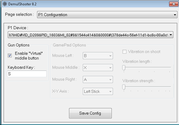

gstav
  • Posts: 217
  • Last login:October 06, 2025, 02:10:15 pm
    • forum.arcadecontrols.com/index.php/topic,157861.0.html
hehe my bad. missed the correct directory in my go.bat  :banghead: works now

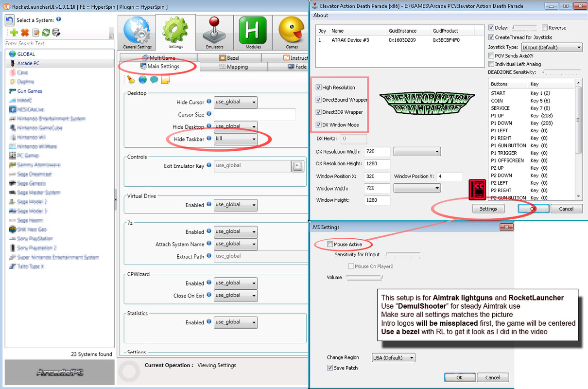

I got the Elevator action Death parade to work, non rotaded, so a slim screen to play with and no 2nd screen attatched so the elevator ride is black only, but with sound. guess this is the best you'll get 1 monitor non rotaded. BUT, I would love to have crosshair option... Any way to get this working in RL or DS or something?
Any help appreciated. Also would be great with some working bezel artwork if anyone have that too! *fingers crossed*
edit
Fixed it all, window mode works so your custom crosshair stays on in Rocket Launcher + a RL bezel I did.
Looks like this now. Pretty fun with bezel and dosen't feels that narrow when gaming now either.

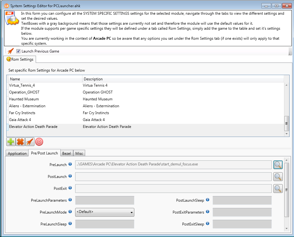

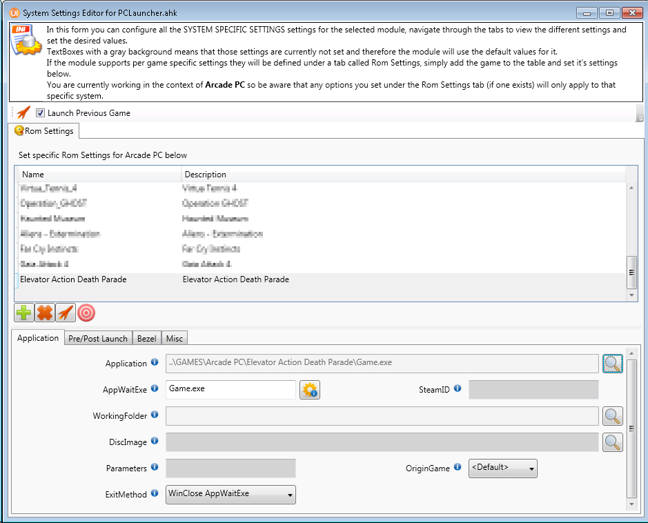

Hi! Yes, I have not got around using just one instance of Demulshooter but using a per game one, no a biggie as it takes minimum place.
Your're right that it is made for emus, demul as a first I guess(!)  :angel: But, also separate ArcadePC-light gun titles like Gaia Attack 4, Music GUN!GUN! 2 and Operation G.H.O.S.T..
Also Dolphin looks like it is supported and I will look at it later on today if I have the chance as I think my Aimtraks is oversensetive as it is. So not only do you use Demulkshooter to hide the crosshair which many seem to believie it is only thing, but also enable 2 player functionality to games end emus which did not work in 2 player mode. Also the mouse sometimes works but the Aimtrak goes bananas in sensitivity, Demulshooter also fixes this. Great stuff  :applaud:
Now, back to the question for this game:
I have an instance of demulsooter in the games directory whit this settings, just enable the gun and a key for the flashbang as I only have one button on the NAMCO gun
Futher more I did an ahk file made to exe with ahk2exe compiler as I got fucus problem. This starts the Demulshooter and then wait and mousclicks on screen and sleeps again.
Dont know if all the sleep is necessary, but I had to do this in Music GUN!GUN!2, and it was a bit handy just copying it as it worked directly.  ::)
Run, E:\GAMES\Arcade PC\Elevator Action Death Parade\DemulShooter\DemulShooter.exe -target=ttx -rom=eadp
 Sleep, 100
 Send, {ALTDOWN}
 Sleep, 1200 ; to give time for the Alt + Tab window menu to come up
 Send, {TAB}
 Sleep, 1200
 Send, {ALTUP}
Return
in RocketLauncher i have this settings in the ArcadePC.ahk module
