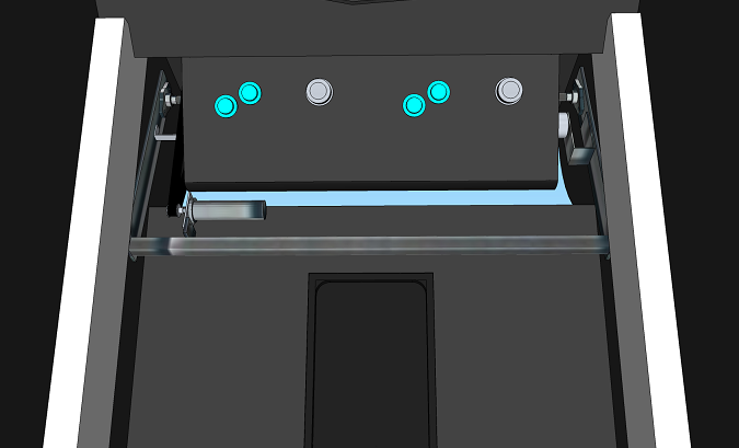

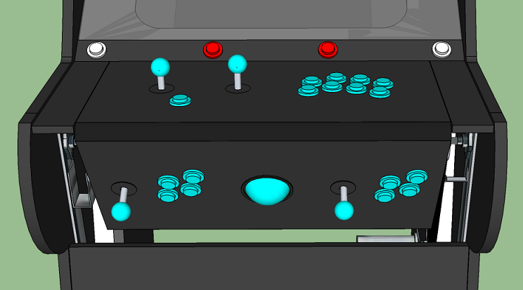

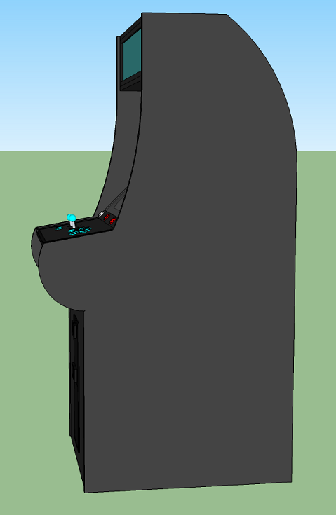

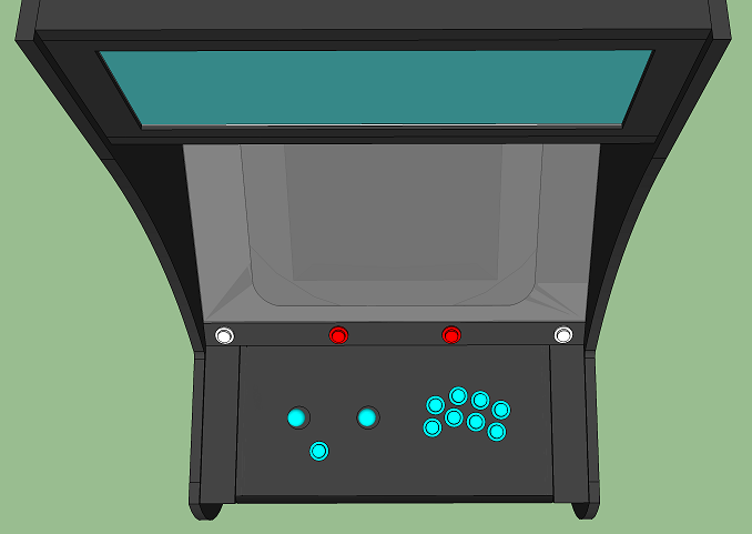

I've taken some pics of how the CP unit sits in the cab, to give a better idea of overall look.  Yes, it does move the monitor back/up a little, but I don't think its too far. I've tried to minimise the boxy look by having a circular front plate to cover the hidden control panels (missing in these pics).
As you can see from the top view, there is a static 6cm ledge each side of the rotating unit. I am planning on hiding this "join" somewhat with strategically placed artwork, or I may put El wire along the sides where the joins are so that they illuminate the plexi on the CP top.  I ideally wanted the whole width to rotate, but this is the trade off (either this or as you say, add width to the cabinet).
Here you can see how the unit sits in the cab. The steel frame will be mounted at an angle so that the front/bottom panel of the cab (with the coin door) doesn't stick out too much.  I actually think I'll probably end up mounting the top 6mm ledges on each side of the panels to the steel frame itself, so the whole thing is then one unit that can easily be taken out in one piece.
Here's a shot of inside the cab, you can kind of see the angle the steel frame is mounted at, with enough room still for the coin mechs/door.
Finally here's a side on profile so you can see how compact I'm trying to keep it.

Typically you will need to have enough space between the cp and monitor for the panels swing.
In my opinion, it makes for a goofy looking cabinet because of that space
I had this problem as well, it looked like everything would work on paper but when I built it, I needed that extra space under the monitor for clearance.
Yeah I'm concerned about this also.  I've tried as much as possible to prevent this from happening too much in the design...
There is just enough clearance for the rotating CP unit in the current design.  Hopefully I won't need to make too many modifications as I don't think it sits too badly at the moment.
