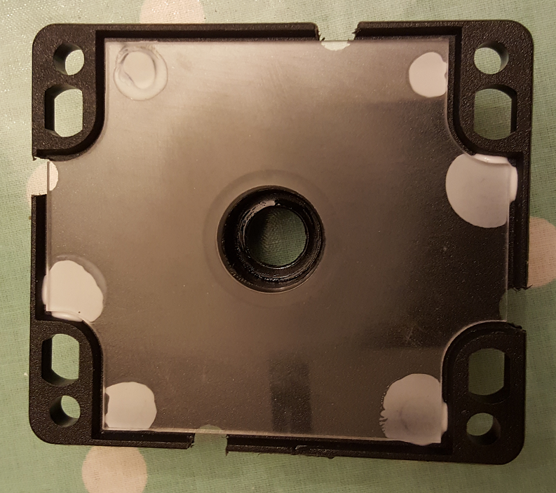

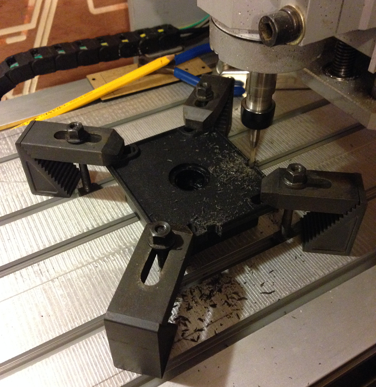

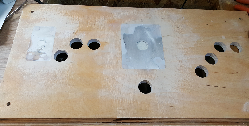

OK, first proper update in a while!  Finally getting back in to this now :)

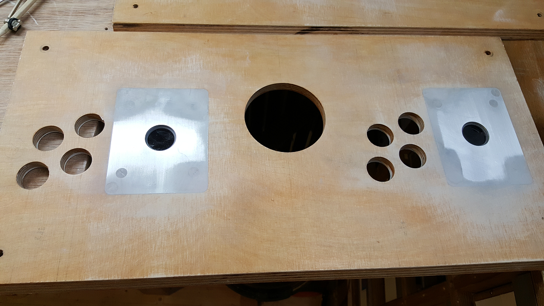

I have all the controls now ready for edge-lighting, but the pac-pro needed mauling so that the LEDs can reach the plexi...
Then some high strength PVA to lock the plexi in place.  The metal mounting plate will go over this leaving a nice edge-lit RGB ring in the middle...

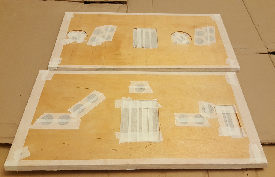

Next up, (skip forward 13 months!) I decided to spray paint the backs of the panels white because, well, I want it looking nice :)
Masking taped over the control holes on the front and then sprayed a few thin coats of white gloss Rustoleum Universal All Surface Paint.  Backs look great now for wiring :)
Time to finish prepping the panels for the artwork.  I needed to get them filled and sanded so that there are no ridges around the control mounting plates (and plexi inserts) and the panel.  I used some Isopon P38 for this.  Seems to have worked great, now the panels are dead flat with no ridges :)
You can see that I masking taped the visible edge-lit plexi parts in the middle of the joysticks and spinners.

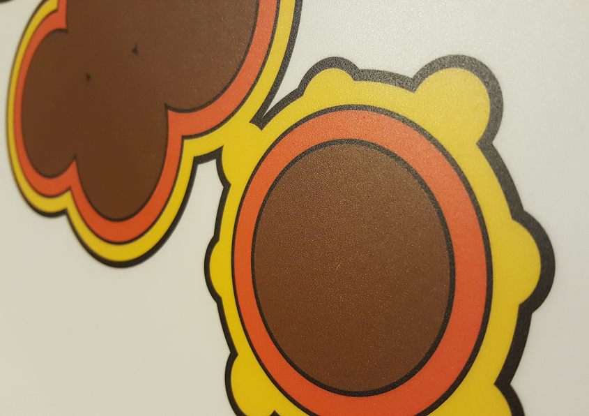

The panel artwork overlays from gameongrafix arrived some time ago and look awesome...
It's hard to portray in a photo just how nice this looks and feels...
Next to do: -
I need to make sure no LED light can get through the panels/plexi inserts as it will show through the artwork.  For this reason, and also to give a good surface for applying the adhesive-backed artwork, I'm going to spraypaint the panels black.  A few coats of Rustoleum I'm hoping will stop any light getting through.
Also, wrapping the artwork around the top/bottom edges of the panels is a no-go without some contact adhesive.  I've tried this out with a spare panel and some spare cut-offs that Scott from gameongrafix was nice enough to include with my order for free, and it works great.
Once I have the panels painted black, the artwork will be applied (scary!) and then it's time for wiring.
I'll post the plan for wiring soon.

This weekend I got some spray painting done.  3 coats black Rustoleum and now no LED light shines through where it shouldn't :)  Surfaces are nice and smooth with no lumps and bumps...
I also started to cut the holes in the artwork. A little scary but the compass-with-a-blade tool I used was excellent!
The two-player panel lines up perfectly - very happy! For the joysticks holes, I cut them very slightly smaller than the actual holes for some wiggle-room (1mm diameter smaller).  I plan to use a stanley blade to cut them perfectly around the edges of the holes once the artwork is applied...
The defender panel lines up perfectly too (ignore the messy looking defender edge-lighting opening on the left, I have to clean up the cut on the left side of the artwork for that...
The 3rd panel, the spinner one... hmm... it was all going so well :(
As I peeled away the masking tape I realised I forgot to paint the wood underneath the plexi edge-lit insert.  It still shows the unfinished plywood underneath...
As you can see when the spinner is in it's not terrible, but still not what I want. It actually looks great in the dark when shining an LED on it from underneath, but in daylight it looks pants...
I can think of 2 things to help... Firstly, rough the plexi up a bit more to make it more opaque.  Secondly (as I've not cut the holes in the artwork yet), make the visible edge-lit circle a little smaller, so for example make the diameter the same as the widest part of the spinner flange near the bottom.  This would (I hope) still give a nice edge-lit effect as the spinner would cover most of it when looking from directly above.
Bah, I'm such an idiot. :(  If anyone has any better ideas I'm all ears.
Other than that, it all lines up perfectly and is looking great so I think I'm pretty much ready to put the artwork on.
Depending on the look/finish you are going for, here are 5 ways to proceed:
1. Mask the panel (and LEDs?) so you can spray paint the bare wood.
2. Hand-paint the bare wood with a small artist's brush.
3. Mask the lit edge of the plexi insert with tape then paint the back.
(the bare wood edge might still show if the insert outer edge is left un-sanded or un-painted)
4. Sand the back and outer edge of the plexi insert.
5. Some combination of 1-4.
« Last Edit: September 25, 2016, 05:07:47 pm by PL1 »
Jimbo
  • Posts: 1014
    • Wood Finishes Direct
Re: JIMBOVISION: Rotating CP [an update at last!]
« Reply #151 on: September 26, 2016, 03:51:12 am »
Thanks...
Unfortunately I don't have simple access to the back of the plexi insert as it's glued in with PVA and has been filled/painted over.  The bare wood is underneath.  I think I'm going to have to prise them out and re-prep the entire spinner areas. :(
My head is saying accept and compromise but my heart is saying do it properly.

You know what you have to do...
Jimbo
  • Posts: 1014
« Reply #154 on: September 29, 2016, 08:51:46 am »
yep.  no compromise.
I might try using a syringe full of black wood stain, and see if the ply will soak up the stain enough to cover the exposed area.  Worth a shot.  If that doesn't work, out pop the plexi inserts!  Gah!

Couldn't you just pva solution coat the surface first then paint it black? The PVA would seal porous wood. Apologies - haven't read the problem fully.

Finally got the CPO installed on one of the panels! :)
Scary night - one that was made miles easier by having two people instead of one!
First I had to trim the CPO down using a craft knife, I left a little black overhang over the top and bottom edges which I will trim off later.  We (very carefully) scored the back along the top/bottom black edges of the CPO so that we could deal with those angled edges after the main CPO application.  We also scored a line about 2 inches from the top black edge (just above the top buttons) all the way along.  Plan was to line up the joystick holes (they needed to be spot on) then clamp the bottom edge so we could pull the top 2 inches of backing off and stick just that bit first.
Following this, the clamps were removed and we could peel back the rest of the backing and carefully apply the rest of the CPO, down to the bottom black edge.  We then used some impact adhesive to stick down the 2 black edges. Seems to have worked great and it's now sitting there for 24 hours to fully set.  Then I'll cut the overhang off with a craft knife and get the controls in there :)
Very happy with how this turned out, it's so vibrant and colourful. :)  Luckily the artwork went on great but it was a stressy evening since I'd never done it before.  Learned a lot - the next 2 panels should be a lot less stressful!
