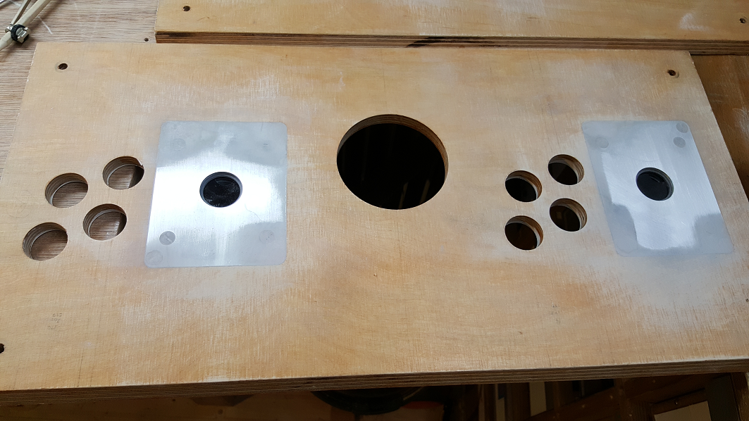

Routed out for the defender joystick and the pac-pro on the middle panel.  That's it!  That's the last bit of routing on the panels - well, apart from making holes on the underside for some LEDs to go.  Woooooh!
I will be posting the final panels soon explaining all the controls and showing the proposed artwork for each panel.  It would be great to have your feedback on that before I order the artwork.
I'm thinking to get all the panels flat for the artwork I'll use some epoxy filler/resin to cover it all and then sand flat.  Not done that before so any hints/tips etc appreciated.

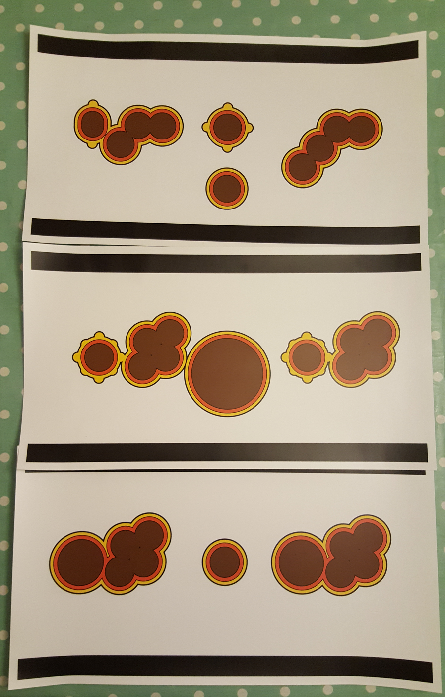

Here are the final control panel layouts, and the planned artwork.  Feedback welcome! :cheers:
PANEL 1
  • TurboTwist 2 Spinner, RGB edge-lit (x2)
  • Ultimarc U360 Joystick, RGB edge-lit
  • Electric Ice 2 w/True-Leaf Pro, RGB-Drive II (x8)
This panel is for driving games (with the mini-racer wheels), spinner games, and any games requiring the analog joystick (i.e. any non 2/4/8 way games).
PANEL 2
  • Defender Joystick, RGB edge-lit
  • Pac-Pro Joystick, RGB edge-lit
So this panel is for Defender/Stargate, Asteroids, and any other 2 or 4-way games.
PANEL 3
  • Dominux 8, RGB edge-lit (x2)
  • Ultimarc U-Trak Pearl
This panel is for all 1-player 8-way games, 4-way or 8-way 2-player games, along with any trackball games.  It's also for Robotron :D and I'll use it for any other emulation systems that need 8-ways.  Having the trackball on this panel means it'll be suitable as the mouse for Amiga/ST games etc.
I'm gonna order the artwork soon, so any feedback now's your chance! :)

« Reply #132 on: May 11, 2015, 02:50:32 pm »
I really dig the retro color scheme and simple art. One thing stands out to me as looking kind of off though. The directional artwork around the joysticks looks a bit too "snow-flake"ish to me. It also looks a little too busy where the button art and other control art meet. I think it looks like 1 too many colors in those spots. Maybe if the orange were thicker so that the yellow wouldn't show up in the tight spots or if the yellow were all one background color or bigger enclosure shape (like an oval something) so the black outline didn't carry into the tight spots.
On another note... I've been working on coming up with a clean edge-lit joystick, spinner and TB system and now that you've posted yours, anything I come up with is going to look pretty shoddy. Good work on this awesome project.

Thanks for your feedback guys.  :cheers:  On reflection I agree it is looking a bit busy... trying out some tweaks...  how about this for the 4-way, 8-way and defender joys...?

OK here are a few alternate designs.  Personally I like the bottom ones best (subtler, less busy) but interested to hear your feedback or suggestions.
Panel 1 (U360 in middle)
Panel 2 (defender joystick and 4-way pac-pro in middle)
Panel 3 (2 x dominux8 8-ways)
Thanks a lot for any feedback you can give.

I think the bottom option on panel 2 and 3. Is there a version with the little nub directions for panel 1? I'd assume I'd vote for that too.

Hmm yeah I'm leaning towards the bottom ones too...   the panel 1 joystick is a U360, which is why I left it as a circle.  My thinking was with the nub directions it would either look like it was indicating the joystick is a 8-way, or would just be too busy.

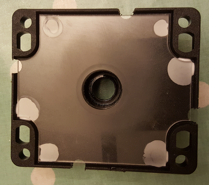

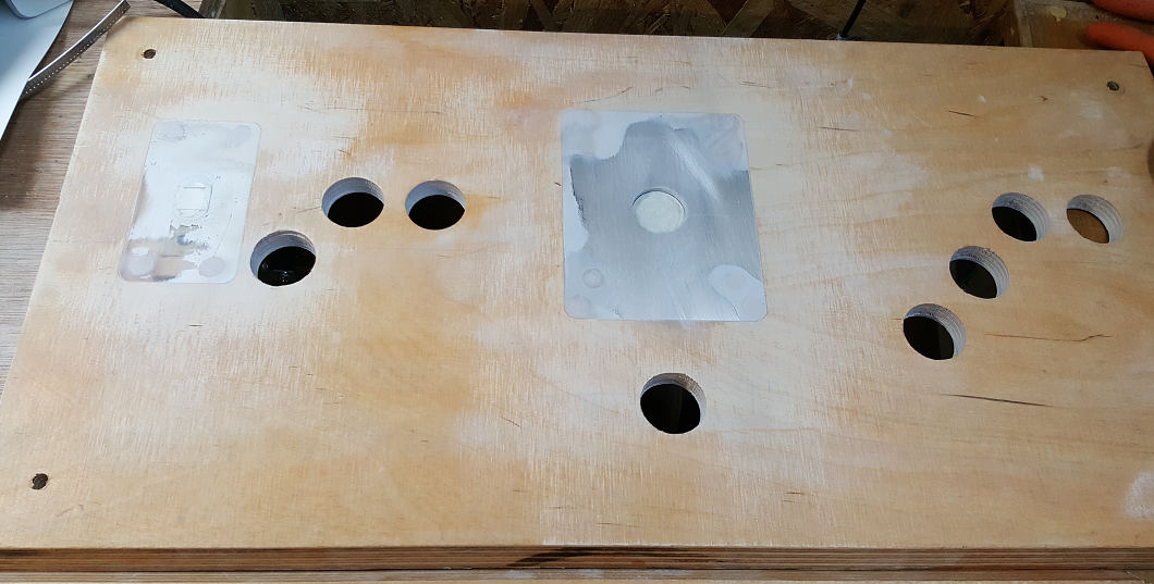

I have all the controls now ready for edge-lighting, but the pac-pro needed mauling so that the LEDs can reach the plexi...
Then some high strength PVA to lock the plexi in place.  The metal mounting plate will go over this leaving a nice edge-lit RGB ring in the middle...

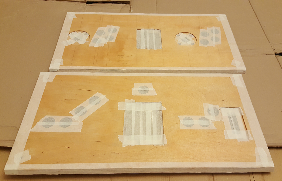

Next up, (skip forward 13 months!) I decided to spray paint the backs of the panels white because, well, I want it looking nice :)
Masking taped over the control holes on the front and then sprayed a few thin coats of white gloss Rustoleum Universal All Surface Paint.  Backs look great now for wiring :)
Time to finish prepping the panels for the artwork.  I needed to get them filled and sanded so that there are no ridges around the control mounting plates (and plexi inserts) and the panel.  I used some Isopon P38 for this.  Seems to have worked great, now the panels are dead flat with no ridges :)
You can see that I masking taped the visible edge-lit plexi parts in the middle of the joysticks and spinners.

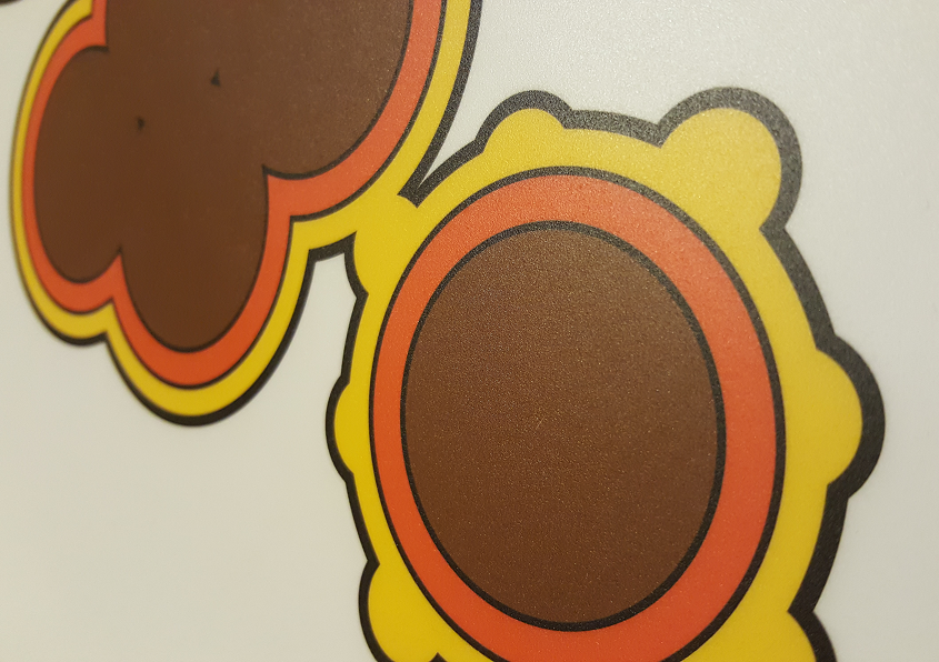

The panel artwork overlays from gameongrafix arrived some time ago and look awesome...
It's hard to portray in a photo just how nice this looks and feels...

I need to make sure no LED light can get through the panels/plexi inserts as it will show through the artwork.  For this reason, and also to give a good surface for applying the adhesive-backed artwork, I'm going to spraypaint the panels black.  A few coats of Rustoleum I'm hoping will stop any light getting through.
Also, wrapping the artwork around the top/bottom edges of the panels is a no-go without some contact adhesive.  I've tried this out with a spare panel and some spare cut-offs that Scott from gameongrafix was nice enough to include with my order for free, and it works great.
Once I have the panels painted black, the artwork will be applied (scary!) and then it's time for wiring.

This weekend I got some spray painting done.  3 coats black Rustoleum and now no LED light shines through where it shouldn't :)  Surfaces are nice and smooth with no lumps and bumps...
I also started to cut the holes in the artwork. A little scary but the compass-with-a-blade tool I used was excellent!
The two-player panel lines up perfectly - very happy! For the joysticks holes, I cut them very slightly smaller than the actual holes for some wiggle-room (1mm diameter smaller).  I plan to use a stanley blade to cut them perfectly around the edges of the holes once the artwork is applied...
The defender panel lines up perfectly too (ignore the messy looking defender edge-lighting opening on the left, I have to clean up the cut on the left side of the artwork for that...
The 3rd panel, the spinner one... hmm... it was all going so well :(
As I peeled away the masking tape I realised I forgot to paint the wood underneath the plexi edge-lit insert.  It still shows the unfinished plywood underneath...
As you can see when the spinner is in it's not terrible, but still not what I want. It actually looks great in the dark when shining an LED on it from underneath, but in daylight it looks pants...
I can think of 2 things to help... Firstly, rough the plexi up a bit more to make it more opaque.  Secondly (as I've not cut the holes in the artwork yet), make the visible edge-lit circle a little smaller, so for example make the diameter the same as the widest part of the spinner flange near the bottom.  This would (I hope) still give a nice edge-lit effect as the spinner would cover most of it when looking from directly above.
Bah, I'm such an idiot. :(  If anyone has any better ideas I'm all ears.
Other than that, it all lines up perfectly and is looking great so I think I'm pretty much ready to put the artwork on.
Depending on the look/finish you are going for, here are 5 ways to proceed:
1. Mask the panel (and LEDs?) so you can spray paint the bare wood.
2. Hand-paint the bare wood with a small artist's brush.
3. Mask the lit edge of the plexi insert with tape then paint the back.
(the bare wood edge might still show if the insert outer edge is left un-sanded or un-painted)
4. Sand the back and outer edge of the plexi insert.
5. Some combination of 1-4.
« Last Edit: September 25, 2016, 05:07:47 pm by PL1 »

Thanks...
Unfortunately I don't have simple access to the back of the plexi insert as it's glued in with PVA and has been filled/painted over.  The bare wood is underneath.  I think I'm going to have to prise them out and re-prep the entire spinner areas. :(
My head is saying accept and compromise but my heart is saying do it properly.

I might try using a syringe full of black wood stain, and see if the ply will soak up the stain enough to cover the exposed area.  Worth a shot.  If that doesn't work, out pop the plexi inserts!  Gah!

Couldn't you just pva solution coat the surface first then paint it black? The PVA would seal porous wood. Apologies - haven't read the problem fully.

Finally got the CPO installed on one of the panels! :)
Scary night - one that was made miles easier by having two people instead of one!
First I had to trim the CPO down using a craft knife, I left a little black overhang over the top and bottom edges which I will trim off later.  We (very carefully) scored the back along the top/bottom black edges of the CPO so that we could deal with those angled edges after the main CPO application.  We also scored a line about 2 inches from the top black edge (just above the top buttons) all the way along.  Plan was to line up the joystick holes (they needed to be spot on) then clamp the bottom edge so we could pull the top 2 inches of backing off and stick just that bit first.
Following this, the clamps were removed and we could peel back the rest of the backing and carefully apply the rest of the CPO, down to the bottom black edge.  We then used some impact adhesive to stick down the 2 black edges. Seems to have worked great and it's now sitting there for 24 hours to fully set.  Then I'll cut the overhang off with a craft knife and get the controls in there :)
Very happy with how this turned out, it's so vibrant and colourful. :)  Luckily the artwork went on great but it was a stressy evening since I'd never done it before.  Learned a lot - the next 2 panels should be a lot less stressful!

« Reply #158 on: October 16, 2016, 10:53:24 am »
Just waiting on a few bits from ebay so I can continue with decimating the other 2 panels because of my stupidity in forgetting to paint under the plexi...
In the mean time, made some "jigs" so I can work on the panels for wiring and testing etc.  These are angled at 10 degrees, and are handy as I can flip the panels on them so the undersides face upwards to work on the wiring.  I got the controls all mounted now on the 2-player trackball panel, so this one is ready to wire up...
Those dominux8's feel great :)
You can see I had to make small mounting blocks to give space for the controls right up to the edges of the panels...
I made 3 sets of these jigs so I can have all panels resting somewhere sturdy until they are ready for the rotating contraption.
Next update will be about decimating the other two panels to re-prep them.
