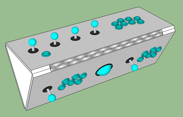

OK so call me over ambitious, but after some inspiration from darthpaul's ridiculously cool automated cabinet, I've decided I want a piece of that pie too.
Here comes the rationale on the controls I've chosen for the 3 sides.  I'm aiming for all joysticks to be leaf-switch ball-tops, and all controls to be LED illuminated (if I can).  Comments/feedback/criticisms welcome, of course...

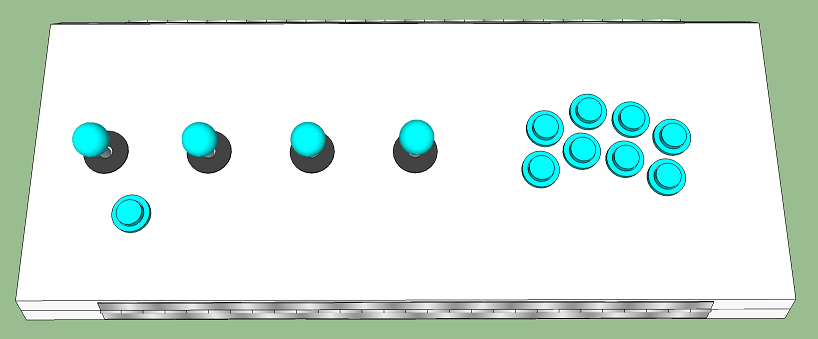

SIDE 1 - Single Player Dedicated
From left to right:
 - 2-way vertical joystick (for Defender) along with dedicated reverse button
 - 2-way horizontal joystick (for galaxians, galaga, etc)
 - 4-way joystick
 - 8-way joystick
 - 8 buttons - should give me enough for most games I can throw at it... the extra buttons will also come in handy for C64 emulation (e.g. buttons for Spacebar, Run-Stop, arrow keys, Return etc)
SIDE 2 - Two Player + Trackball
From left to right:
 - Player 1 controls (8-way leaf, 6 buttons)
 - Trackball (will use this also for Star Wars, and probably some ScummVM games)
 - Player 2 controls (8-way leaf, 6 buttons)
This will be my robotron panel! :)

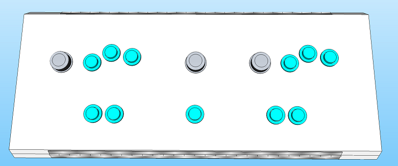

SIDE 3 - Spinner/Various
 - The top half of this panel is for 2-player spinner games such as Blasteroids and Two Tigers, plus with mini-racer wheel can be used for Super Sprint etc.
 - The spinner in the middle would be for dedicated arkanoid or various single player driving games (TT2 w/mini-racer wheel)
 - The bottom 5 buttons are for dedicated asteroids :)
 - I can also play Tempest on this panel :)
Can't play Tron. Can't play QBert.  Most of the other games I care about I can play though.  I don't think I've missed anything out but if something is glaringly obvious I'll be happy to hear it.
It's a bit snug under the panels, but all the controls fit and I have an idea or two on how to rotate it (thinking: stepper motor again). Keeping the CP securely in place after rotation is another concern... electromagnets maybe... needs more thought.
I haven't specifically allowed space for an interface such as IPac yet either... and I'm sure something else is going to come and bite me in the ass too.

Love the arcade design. The new updated rotating control panel does not follow the keep it simple rule. It's crazy, but not in a good way. You don't need to play every game. Focus on playing most games well.
Keep up the amazing renderings!

It just amazes me, the sheer amount of money that gets spent on buttons and encoders and joysticks just to play everything.  :dunno
mgb
  • Posts: 3500
  • North East, US
Re: Cab 2.0 (upright new build, motorised rotating CRT+CP, LCD marquee panel)
« Reply #14 on: September 29, 2014, 10:18:20 pm »
What the hell,
  I check this thread out one day and the cp is on the simpler side with only 4 buttons per player.
Then it gets a little more busy with an extra joystick then an extra spinner and I stil liked it.
Now this.
edekoning
  • Posts: 609
« Reply #15 on: September 30, 2014, 02:30:15 am »
That CP with 4 joysticks in a row looks like a big WTF. If you really really need that many different controls than go with modular panels (Switchcade style http://forum.arcadecontrols.com/index.php/topic,112889.0.html). Or go with swappable panels (Blip style http://forum.arcadecontrols.com/index.php/topic,137295.0.html). In any case try to keep those CPs simple and obvious.
ballboff
  • Posts: 194
  • Last login:July 22, 2024, 02:25:17 am
« Reply #16 on: September 30, 2014, 02:58:42 am »
This is way overkill.  You can play defender with a 4-way joystick, I don't see the problem to warrant an extra joystick.  Hell, most of the spinner games you can control with a 4-way too.  I don't think there was anything wrong with the control panel you had before.  I hate overloaded control panels with hundreds of bloody lights, like a las vegas show or something.  Why can nobody keep it simple?!!  :soapbox:

OKAY OKAY... so I may have overdosed on the caffeine yesterday.....  we all get a little over excited sometimes, right?
On reflection (good night's sleep followed by a bacon roll)... you've convinced me to ditch the 2 x 2-ways, so the single player panel will have a 4-way (with defender reverse button) and an 8-way.
I'm fine with the spinner panel so I don't think I'm going to change that. The controls don't get in the way of each other and I've seen much much worse.
To minimise any confusion I'm planning on using LEDBlinky to highlight which controls to use with each game.
It might not look so harsh once you see the render of the panel in-situ in the cab.  I'll get a pic uploaded soon.
Have I earned an ounce of forgiveness now?  :cheers:

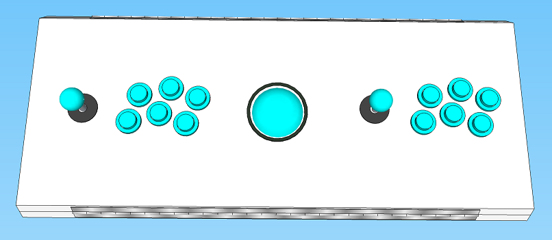

Here's the rotating panel in-situ...
Panel 1 (1 player dedicated)
Panel 2 (2-player)
Panel 3 (various)
Still a bit of shifting around to do with the monitor to make room for the rotating CP inside the cab, but hopefully not too much.
Still also got to decide where to put start1 and start2 buttons, and I want a 'Pause' and an 'Exit/Back' button.  Don't really want to duplicate them on each panel but I can't think of a viable alternative right now that I'd be happy with.
Oh, and ignore the metal piano hinge on the front of the panels... that will be covered up :D
