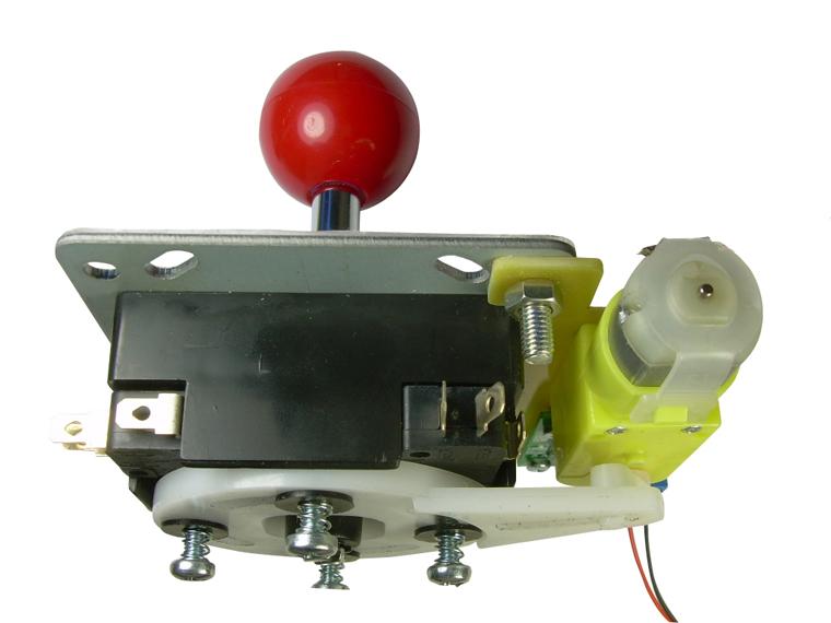

As for your CP. If the layout works for you then go with it. I do prefer symmetry when I build things, but I am not the one playing your cab and with all the effort you've put in this far, I am confident you're not the type to leave something if it isn't to your standards.
As skilled at yamatetsu is, I would have thought a switching Servostick would have been a better option for P1 than two joysticks. Yeah, I get it, it's his cabinet, blah blah blah, but Rodney's right. Visually, I don't think it works. I don't have to play it, either, so yamatetsu can tell us to go pound sand, but I think he's appreciated our previous honest opinions, so  :dunno

This may suck a major big one, but before you go any further, widen your cab to give yourself space for the your jsticks.
You've put waaaay too much work into this to ruin it with a CP like that man....Your work so far has been spot on.
Yots suggestion of a servo stick is a great modern idea.  I think the days of the double stick have kinda surpassed us.  Even so the placement is so tight you will not be happy playing-wise i can promise that.  Another option is to have the CP easily unlatched, pop it open switch your 8way stick to 4 way and done.
http://www.ultimarc.com/servostik.html
Widen your cab man, and place your 1p 2p symmetrical to one another.  You mentioned the stick being in the way of your t-ball well your buttons on plyr 1 are in fingers shots distance, so that could cause havoc in game play as well.
Err, thanks for the praise, but I'm not skilled. My woodworking experience prior to this consists of helping my Dad build some kind of shed, i.e. cutting support beams and putting screws into them, that's about it.
I have looked up the Servostik at Ultimarc, while this sounds like a good alternative, judging from this picture, this looks kinda hard to top mount without a router. I dunno.

If I go the Servostik route, I could remove the restrictor plate from the 4/8-way and make that the P2 joystick. That would leave me with two U360s which I paid 120 bucks for  :-\

I forgot you are using u360's for the main sticks.  I have used both the u360 and the servostick, and while the 4 way restrictor feels good on the servostik, I had a hard time playing 8 way games it for some reason..  I prefer the u360 over it, and on my current build I am trying the octagonal restrictors which I think will be that happy medium between the top mount restrictor and no restrictor.  The top mounts do work well, but under hard use they can come loose (and you have to explain them to guests, where you don't on the other options).
What I am getting at is that with the software restricting the 8 way movement on the u360, you don't NEED a restrictor plate, and hence you don't NEED a dedicated 4 way stick.  I have found that I don't notice much difference in game play between the u360 and the servostik when playing pacman, although the feel of the stick is very different.  So frankly, with 2 u-360's, you could scrap the 3rd stick.  And if you really insist on having some physical restriction, use the octagonal restrictor plates or add the top mount restrictors (top mount restrictor allows for undermounting the joystick too, so no routing, no covering holes.)
Re: My first build : Clint.
« Reply #57 on: September 02, 2014, 06:25:38 pm »
Yeah, Dave's right.... if you're using a U360, you really don't need a dedicated 4-way, unless you're a hard-core dedicated type, and you'd probably be best served building a 4-way only CP or cabinet anyway.  :cheers:
