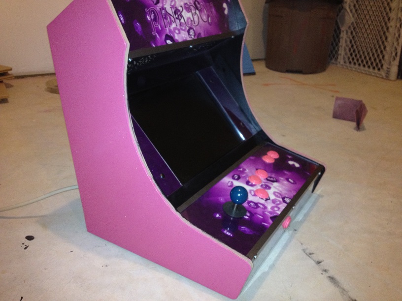

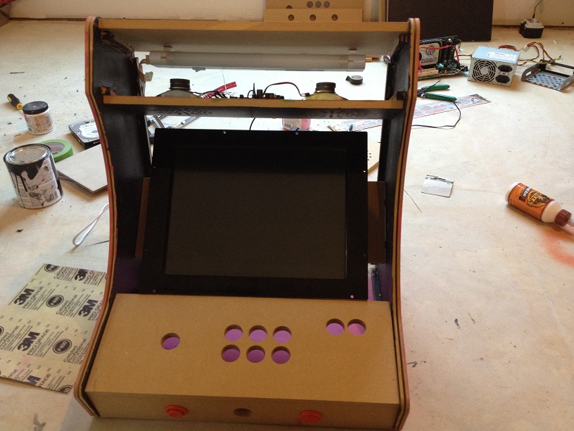

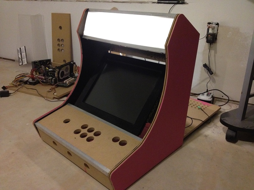

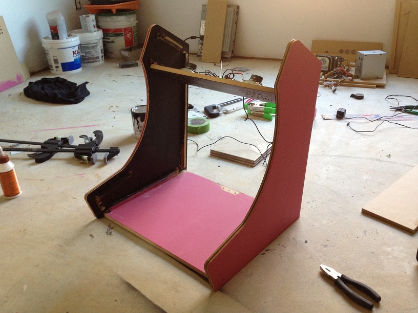

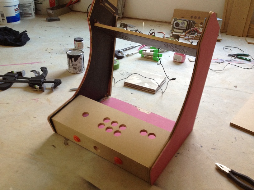

So I basically tossed the old cab, The nemiah 1Ghz was too crummy to run anything worth running, and no controls made it touch only, which kinda sucked.  Fast forward what... 2 and a half years? Haruman starts slinging weecade style kits (He's now selling version 2.0 kits, tell him I sent you http://forum.arcadecontrols.com/index.php/topic,130522.0.html ) I got a version 1.0 cab and went to town. This is over the course of about 3 months. Keep in mind my crummy iPhone cant really capture the pink color very well, so Im gonna borrow a real digital camera and take some more pix. Tmolding is the only thing left to put on it.
Here are the pix: (videos at the bottom)

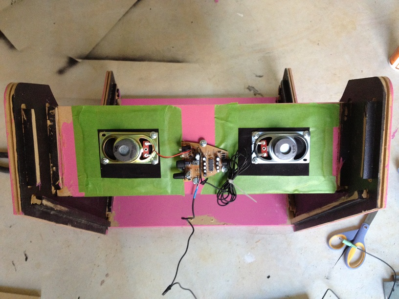

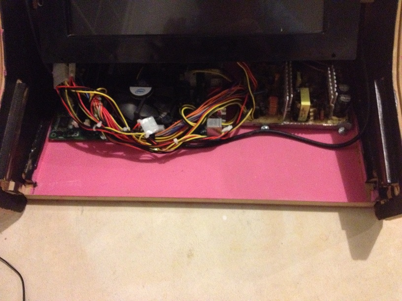

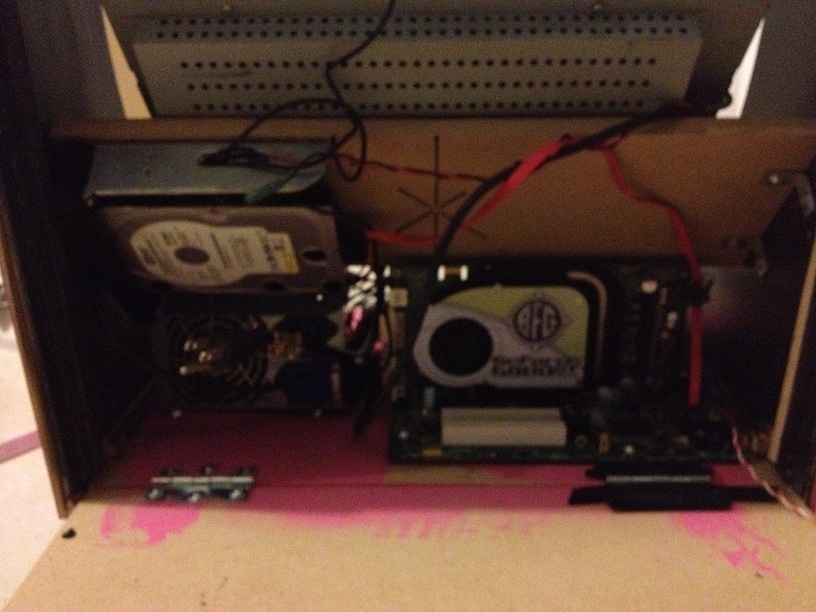

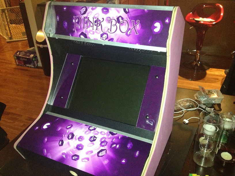

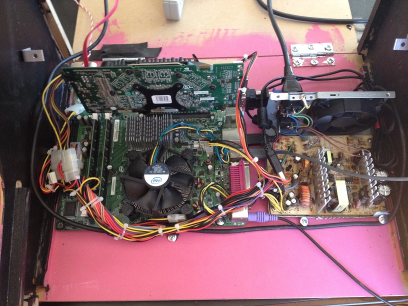

Here are some  "mostly done" pix, mostly showing the guts. Core2Duo and an Nvidia 6800 GT. Power supply had its casing half removed to make it fit. The reason it went from a "street fighter" layout to a jamma 3 button layout is because my fiancee didnt want 6 buttons, shes more of a PuzzleBobble kinda girl, not a Chun Li user, lol

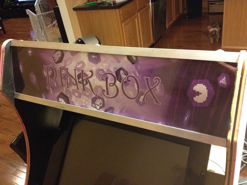

Home printed art, you can see the space in the 2 pieces of paper, heh:
Kinkos printed art, camera doesnt capture the pinkness very well:
Heres pretty much what it looks like now, Blue stick has been replaced by a pink one. Shiney pink ball top will be ordered, and a custom washer is on the way:
Touching Bonnie's Pink Box:
Using the stick with the Pink Box:

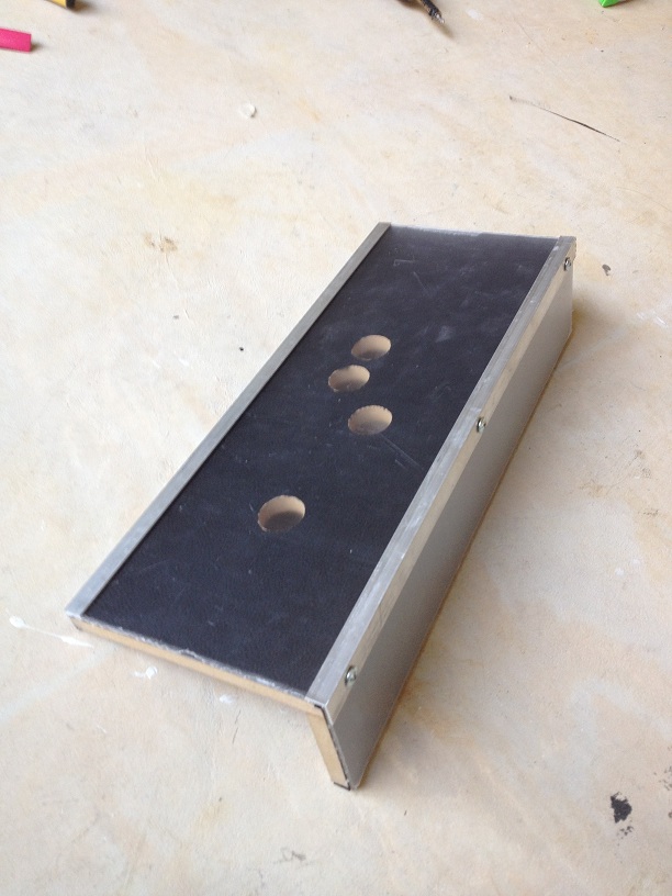

I missed the first pink box....what the model of that screen...
And what are you using to fill in the gap between CP and the monitor...
Awesome build... :applaud: :applaud: :applaud: :applaud:

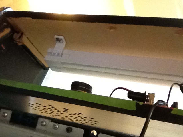

The plexiglass screws into the monitor bezel, the bottom of the plexi sits flush with the top of the control panel. 3 lathing screws hold the metal L brackets into the control panel. The plexi from the monitor sits on top of the screws so it looks nice. If you push on the bottom of the plexi it will flex and look goofy.  Control panel is attached to the body of the machine with industrial velcro.

Is it because i am using an iPad this looks purple?
Drnick
  • Posts: 1642
  • Plodding Through Life
Re: Bonnie's Pink Box Part 2: The TOUCHING Return
« Reply #17 on: March 11, 2013, 12:59:43 pm »
Nope, looks Purple to me too  :dunno  I'm sure it is pink though. First few pictures are definitely all pink.

« Reply #18 on: March 11, 2013, 01:17:28 pm »
Its because of my iPhone it looks purple, it just cant seem to take a picture of the pink very well. The art is purple base with a ton of pink highlights, the sides are bright pink with a sparkly glitter finish (like a girly bass boat, lol) I found my samsung camera but Im holding off on new pix till I get the front end finished or till the clear pink ball top gets here.
