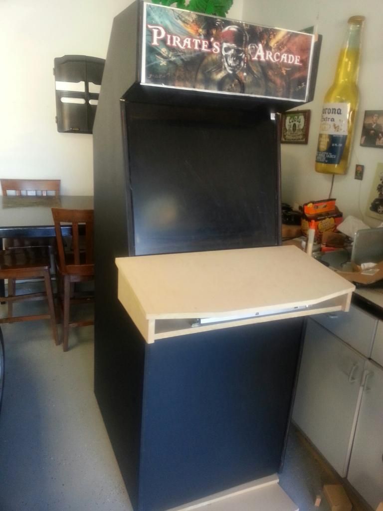

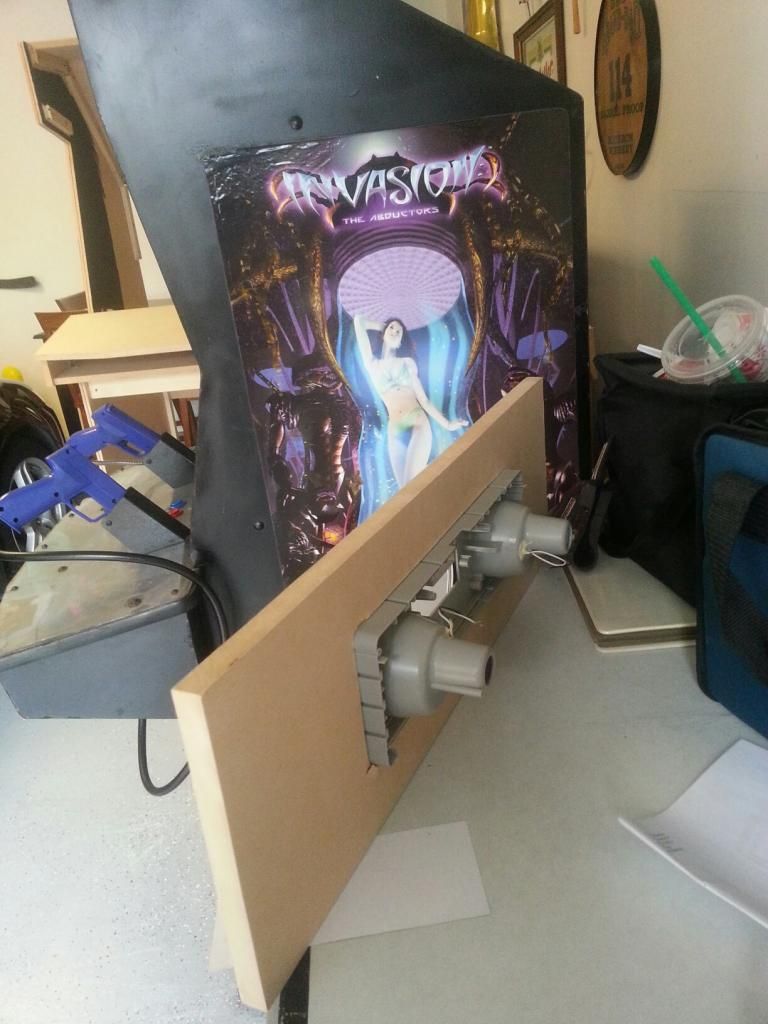

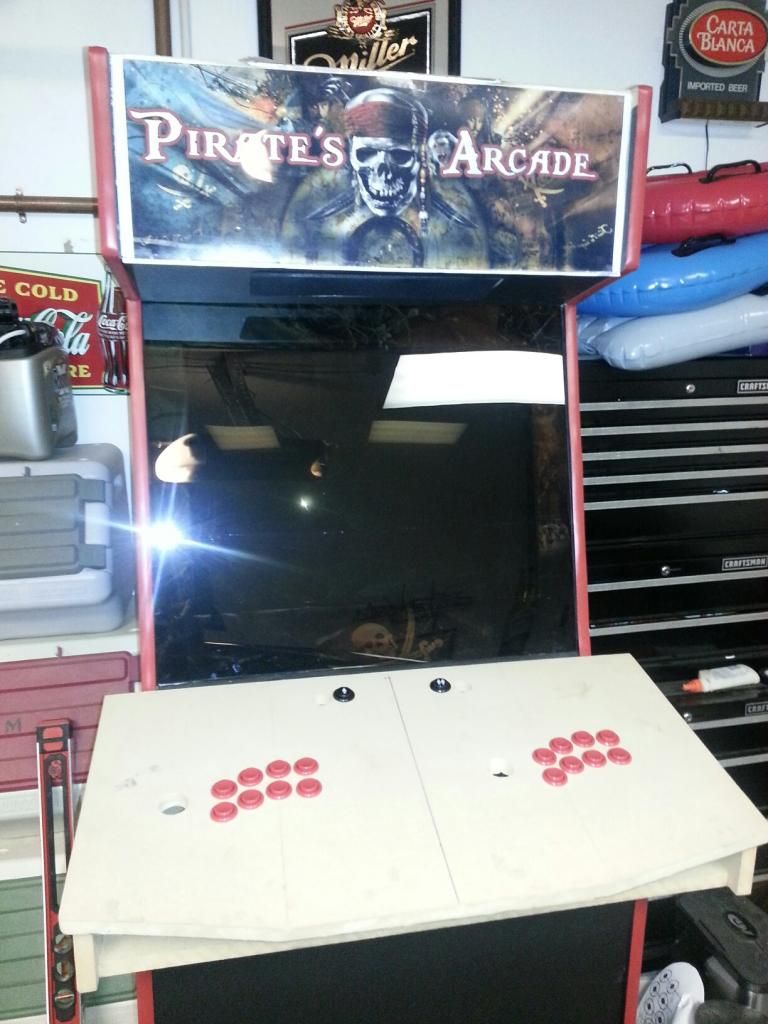

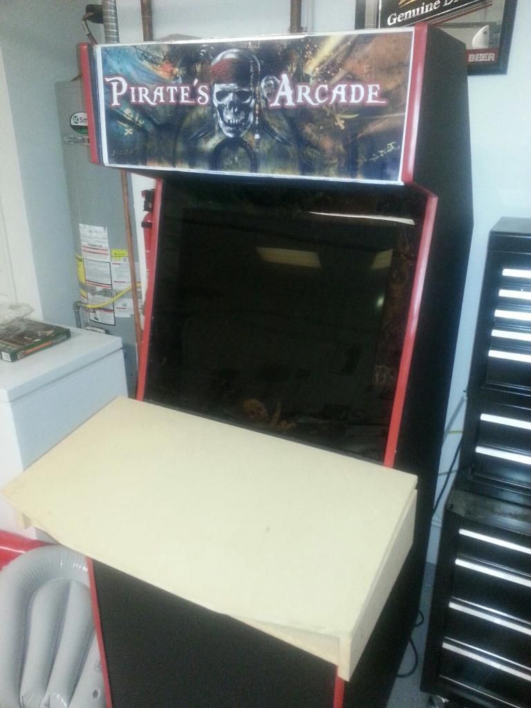

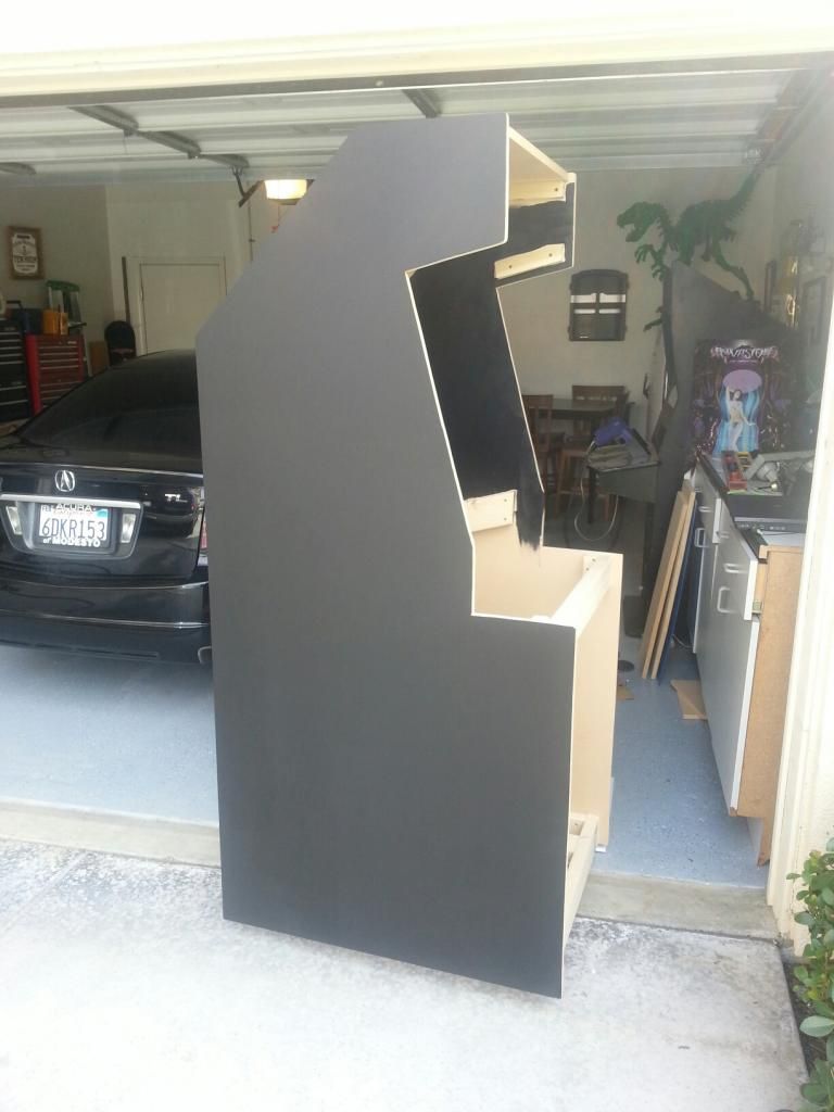

Hello, my name is Dan.. After coming across a free 29" arcade monitor, that needed some minor work, figured might as well build a cab for it. Basically, I am one of those fools who decide to build a cabinet on pretty much no budget, with half ass wife approval  >:D and the kids cheering you on for motivation  ;D

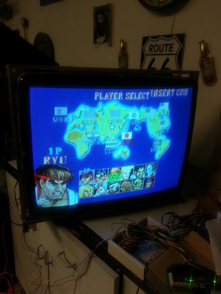

Here is the monitor connected up to the dedicated Invasions PCB (I have since worked on the color levels and got the display perfect as the white was washed out when taking this picture)

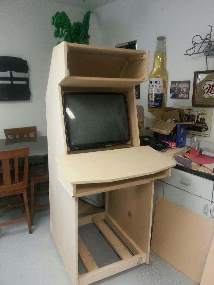

Like most arcade builds, one has to have a theme in mind on where they want this to go, so here is the artwork I created thus far for the Marquee:
Here is where I am at now:
I just received the slot bit in order to do the t-molding groove. I am a bit nervous on this one as the blade I received: 3-wing, .062" (1/16") Slotting Cutter, Whiteside# 6700A
cuts through the 3/4" MDF like it isn't even there, so worried about rocking the router one way or another. I have had that bit now for a week and keep putting it off, it would be a $40 boo boo.
I keep going back and forth in regards to the coin box. I would love to see an over/under installed, but again, the $$ just isn't there and easy enough to add when it is. I am awaiting this weekend to pickup the final sheet of MDF needed to button the wood portion up (front/back). PC is pretty much ready to go, which is a WinXP 64 bit, 8 GB RAM, Core 2 Duo  spare I had, so no extra cost there.
I'll be updating the post as I keep tinkering and changing things up on the fly, which means plenty of standing around drinking beer, thinking of ways to do things. Since I have 2 kids, 3 and 7 I don't get dedicated time on it, so work on it as I can.

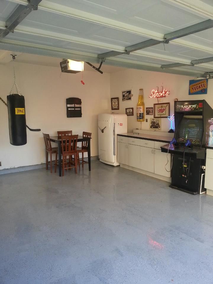

Here is a pic of the garage it will be going in:

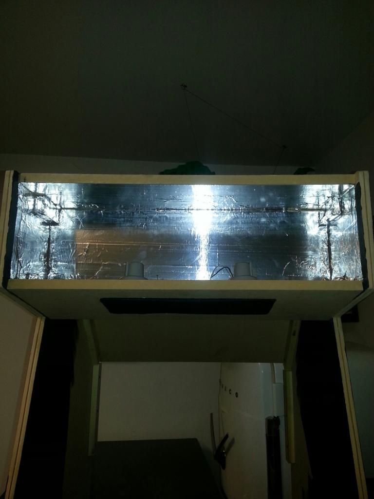

Looks like a good start.  You may want to trim back the braces behind the marquee so they don't cast shadows on the front.
Cool fridge.  Those old ones run forever.

« Reply #2 on: February 27, 2013, 05:01:41 pm »
good point on the trimming! I was looking at that, wondering myself how that will probably be a dark spot on each corners. It's sort of seems like you have to have most of the stuff to fit and feel everything.... but still fun build none the less!
Fridge is a beast! can cool  fully loaded shelves pretty quick.

You could cut/trim the nailing strips behind the marquee or just route out a piece to hold the marquee (this is what I did seen in construction here http://forum.arcadecontrols.com/index.php?action=dlattach;topic=128354.0;attach=272544;image and somewhat finished here http://forum.arcadecontrols.com/index.php?action=dlattach;topic=128354.0;attach=276549;image)
Personally, I like the routing more because it gives a more "finished" edge look with a slight curve bevel, and I also didn't want screws showing or a different material such as plastic or metal.  However, the way most do it on here looks pretty slick as well.
Best of luck with your build and welcome to the fun!

I found a great piece of metal trim at Home Depot the other day, it's called "Bar Nose Trim". It's aluminum and sold in 8' lengths for $8.50. I plan on using that for the Marquee retainer. Just have to spray it black, but plan on routing the edge flush, so it's not just stuck on top of the wood. Oh wait, dammit, is that another router bit to purchase?!? LOL *sigh* time to go to the store and buy a $25 gallon of milk, $4.99 for the milk and $20 cash back  >:D

Do yuo park in that garage, or is that space for pool table/skeebal/arcade machines/air hockey?
dandro
  • Posts: 208
    • Link To project
Re: New Member and new build - Pirates of the Arcade
« Reply #8 on: March 01, 2013, 09:04:08 am »
We park the wifes Acura TL in the garage.

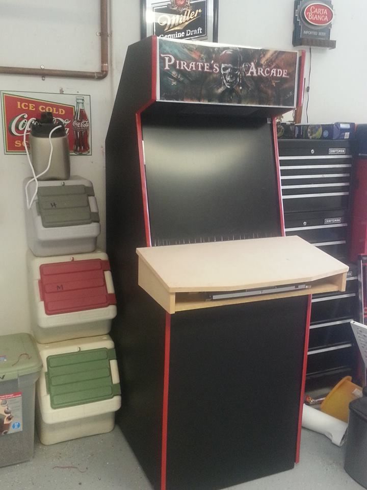

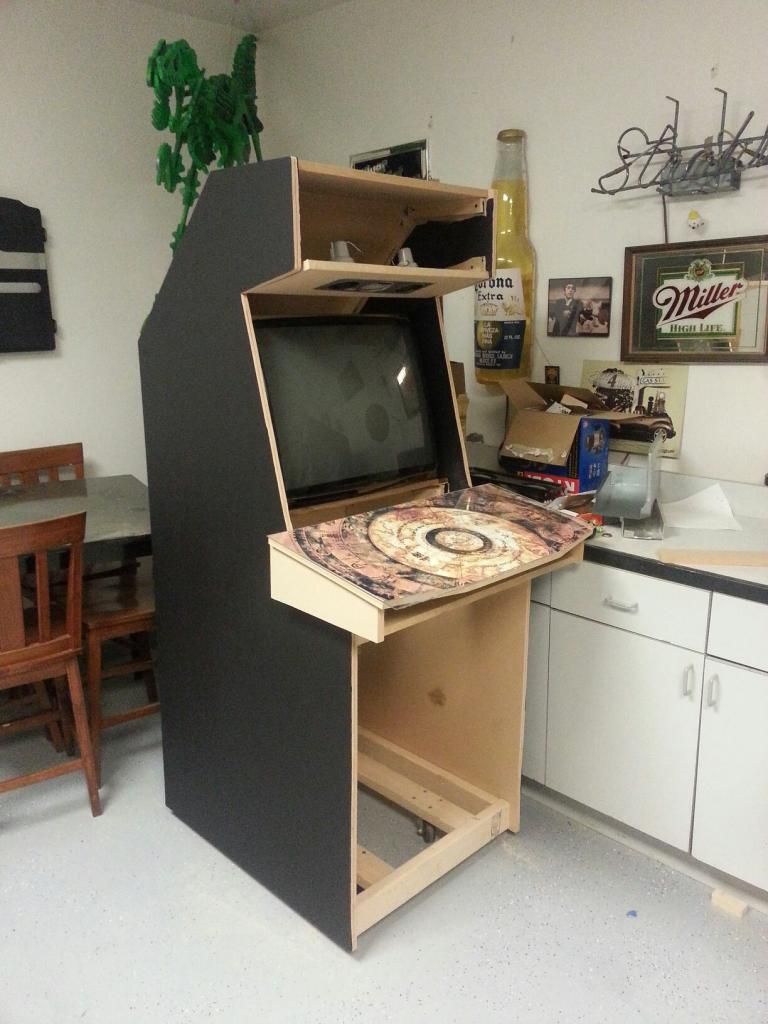

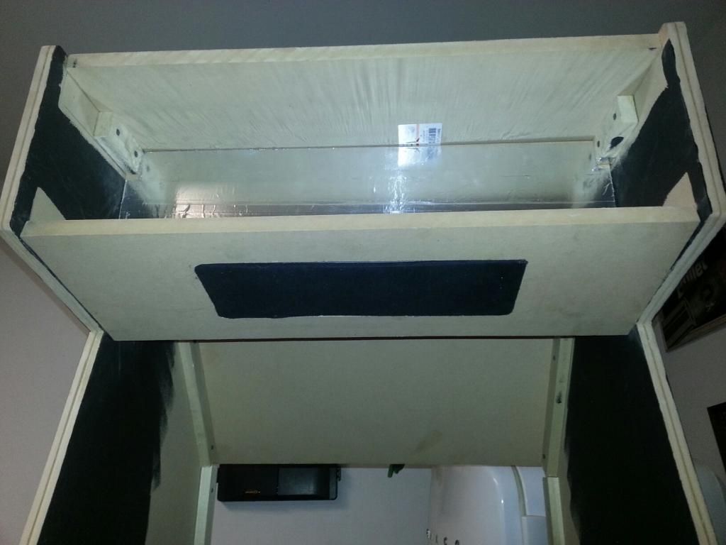

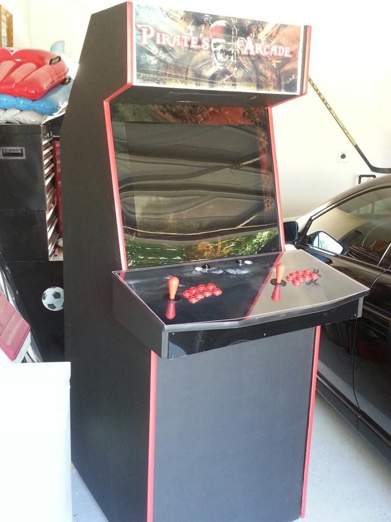

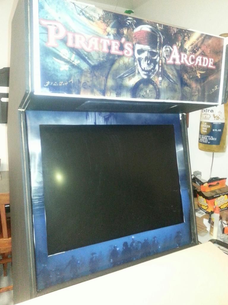

worked on the project some more this weekend for a few hours:

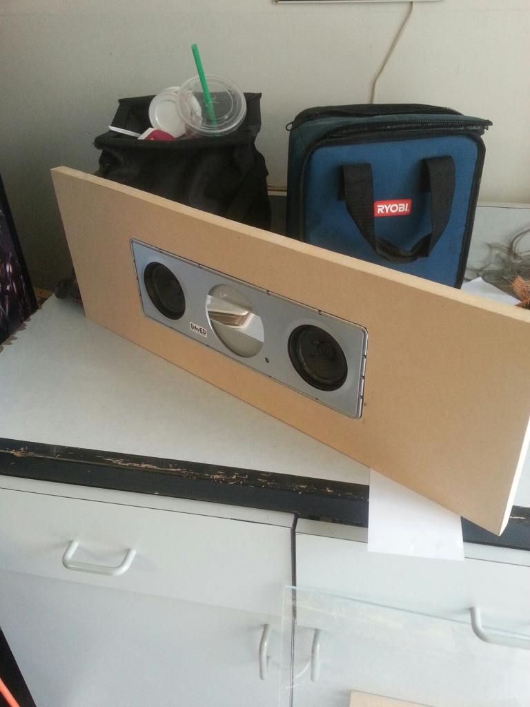

Worked a bit on the speaker shelf. I used the speaker assembly off of a Marantz DAVED unit (http://www.crutchfield.com/S-Itx3y6wevxm/p_642ZR6001S/Marantz-ZR6001SP.html). I got the remote unit free as brand new, but since it needs a head unit to function, was only worth the parts.
Back end, or top:
Grabbed some of Home Depot's best quality paint, which was BEHR Premium, Black Enamel plus primer. Using the best foam roller, I think the first coat looks spectacular!
Printed off some of the artwork on HP Photo Paper, using the HD plotter and mocked up what I have so far.. Unfortunately, when I turned my back the plexi slid off and hit right on the corner. It must have hit right on the spot the caused it to break, you know that ONE and ONLY spot, where it never happens, in a million years!!! that spot.. meh.  :banghead:
Ran out of time and funds are being redirected this week to the wifes birthday present.. She wants a rear spoiler for her car. 2008 Acura TL, she wants the Type-S spoiler for it, so I'll order that up and install that for her.  ;D  Keep the wife happy! Also my 7 year olds birthday is this weekend, turning 8, so will be busy with that.
Until then, I'll order some 3/4" black tmolding and some a Nova Matrix marquee setup from GGG.
« Last Edit: March 04, 2013, 09:41:20 am by dandro »

Ohhh,.. and by the way, I think routing that Tmolding slot, was about the most stressful thing I have yet to do with this whole project.. I starred at that router for 30 minutes, had a beer and starred some more before tackling it.... I had minor oops, but luckily it was on the backside..  Glad that is over with!!!! LOL  :applaud:

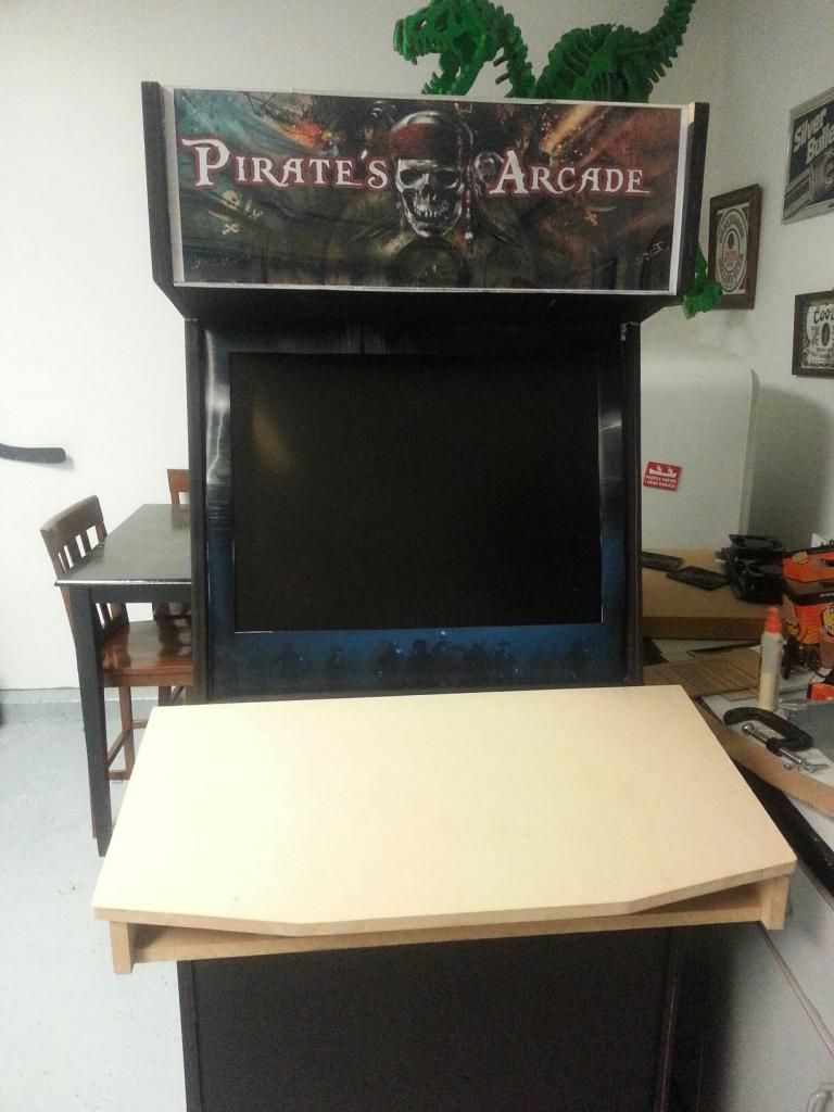

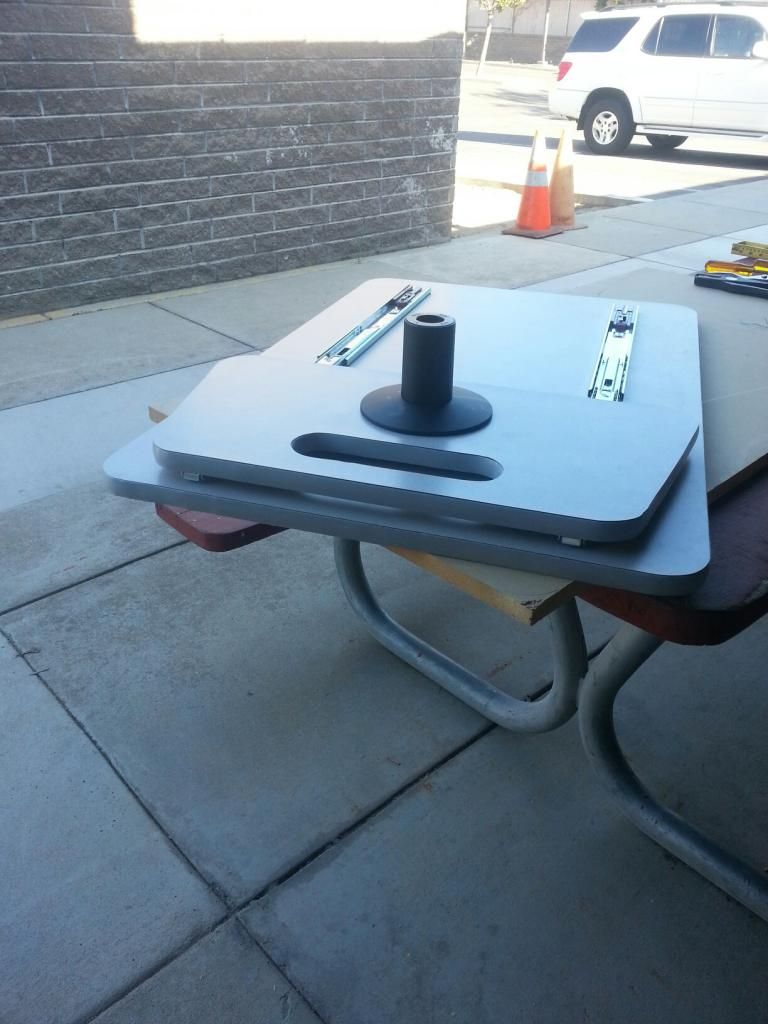

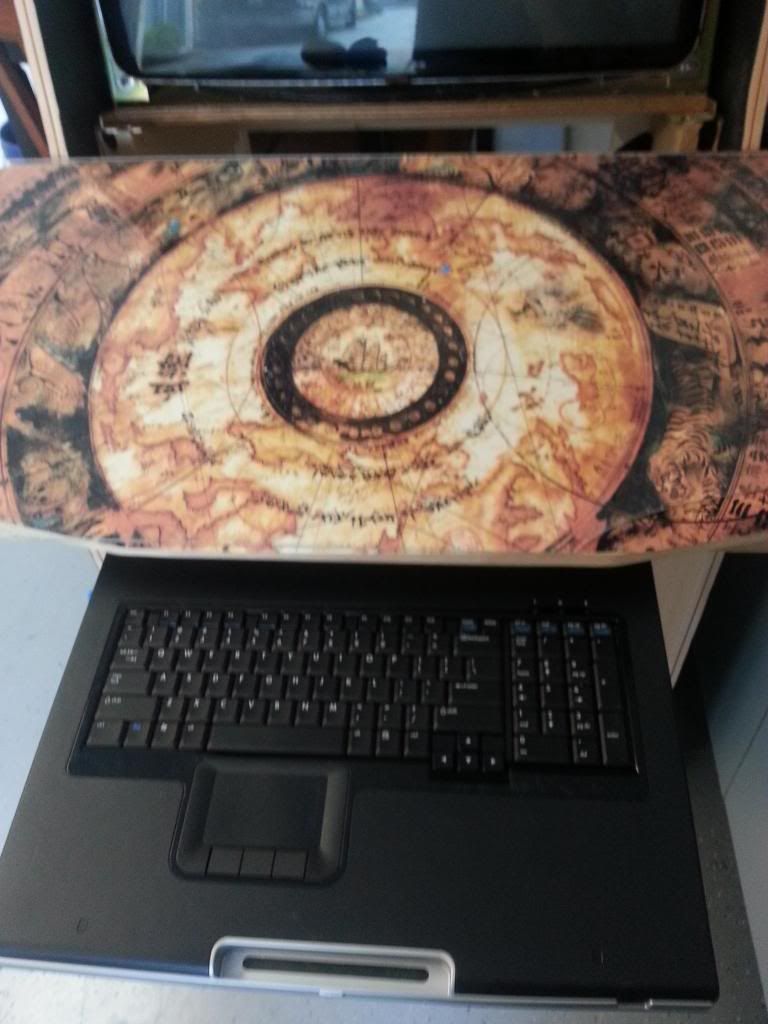

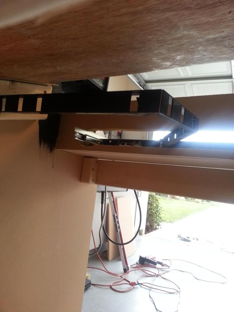

Got an hour or less in last night in regards to the keyboard. Rack mountable keyboard/touchpad combo.
Made some cuts to the back of the CP, forgetting that I have a cable management tray to attach,.. DOH! :o
Better. I'll have to clean up the sloppy cut job in the back, got in a hurry to see if it would work or not. The cable tray is crucial for cable management so nothing will get crimped as the drawer slides in and out.
view from behind. This particular assembly can either be installed with PS2 or USB, I have cables for both.
weird angle for the camera, I was trying to balance the control panel while the keyboard was slid out, it wanted to fall.. LOL. I assure you, the keyboard comes out straight and centered  ;D

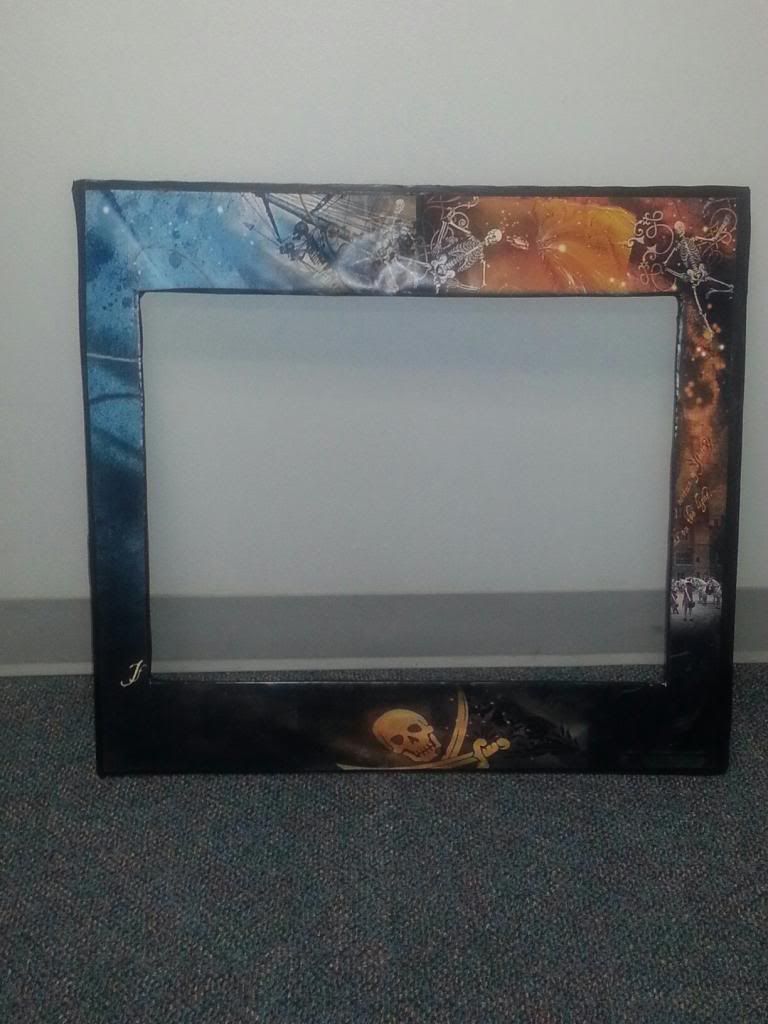

Question in regards to Bezel / glass: I cut out a large piece of cardboard last night just to see what I am up against for a bezel, it seems there may be about 1/2" from bezel to glass when said and done. I am open to suggestions on this one. I haven't purchased anything yet because I keep going back and forth on a plastic based glass or glass. Lowes (home improvement store) sells a sheet of glass that would fit perfectly for $8.88, I could tint that myself. Tap Plastics could cut a sheet of solar grey for about $45, but that's Acrylic. I keep reading how some people are reporting that while cleaning it can get all scratched up.. They sell polycarbonate, but cha-ching!!! like $70..... So again, on a budget I was thinking of going with that sheet of glass, self tinting it and using something like black, poster board to make a bezel?? Maybe no bezel is needed with tint?

Glass all the way.  You are lucky that Lowe's has a piece ready to fit.  I got mine cut by a local glass shop (still only cost about $50) but it is smoke and tempered which I am extremely happy with.  Not to mention, it supported a local business.  For the bezel, I just painted the back of it black, and I love the look of it.

oh yeah, I forgot to mention that one, about painting the back of the glass, that came across my mind as well... seems that it could be a nice touch! Is the technique still painting it black, then shooting silver over that to prevent light? Appreciate the feedback!

Cab is about 74" high x 27.5" wide. A bit large but seeing I am 6'0 tall, it fits me well. Kids will stand on chairs.. this is daddy's cab!!! LOL Oh and the monitor is a BEHEMOTH! it is very snug in that thing.

My now 8 year old son had a sleep over party this weekend, so between the house full of kids, cleaning up, etc.. not much time to work on the build. I did manage to do some minor work on the marquee area.. Funny, what seems like a job that should only take a few minutes, takes an hour.. time flies when working on these.
and lined it with duct tape, the real duct tape. Left over from when I installed the new oven exhaust hood.

Progress!
Yesterday when I got home, the Jamma harness was in the mailbox (yay!). Had to cut off the molex connector for the video and solder on the one from the monitor, 5 minutes. Started looking at the harness and realized that I need to brush up on my Japanese, apparently Paradise Arcade understands this language better than I. Back on track, figured out which way was what on the harness, connected it up to the JPAC. After 3 hours of *^$#ing around with the video, resolution, etc., I have this:
Let me tell you, this was a pain in the --I'm attempting to get by the auto-censor and should be beaten after I re-read the rules--. I am still seeing something weird. Since I had my LCD attached to the DVI port of the video card (Radeon X1600 Pro) and the JPAC connected to the VGA port, the video displays on the arcade monitor just fine (@ 320x240 32 colors). When I disconnected the LCD via the DVI port and even disabled the screen in the display properties of Windows, the arcade monitor won't come on. Plug the LCD back in (still disabled) and the arcade monitor works flawlessly...  :cry:  so..at that point I was pretty tired 10:30pm and had to be up at 03:30 this am.. I'll have to play with this more.
Monitor Calibration Question:  If anyone is using an arcade monitor with the 320x240 resolution, what on earth are you using to calibrate the colors? Guess connect, re-enable LCD and get something over to the other screen? The resolution is so horrible for Windows, that it really renders a keyboard just about useless... Which reminds me, that cool slide out keyboard tray may very well just come out, I can't see any reason for one on these things. I hadn't expected to network this PC, but it appears i'll be tossing in a wireless card for VNC'ing into it (remote).

Since I am waiting for $$ and parts, I gave the cab another 2 coats of paint and added the front panel. I also managed to score a free sheet of tinted Lexan from a buddy who had left overs. I went to Lowes home improvement store on Friday to see about the glass, HOLY COW!! you def. get what you pay for! That sheet of 24"x26" glass was as thin as paper, no way would it have survived the ride home and if it managed to do so, first time someone smacked it (kids) it surely would have broke.
The marquee is just a printed off version for mock up.
Anyway here it is today:

Re: Pirate's Arcade - Bezel
« Reply #162 on: July 05, 2013, 04:03:59 pm »
Printed out the Bezel artwork on Photo glossy, attached to art board.. ready to mount. the sides and everything will be trimmed up once I get home and access the cutter...

and, installed:

Made more progress and got the button holes drilled out..

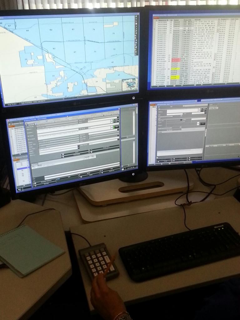

also they have me busy at work making quad monitor slide trays that I designed to solve a few ergonomic/technical  issues at work.. This all started form a 2'x4'x3/4" sheet of MDF. I designed, built and installed these here at the 911 Dispatch center where I am employed as a Network Engineer...  :dizzy: don't get me started on how all of a sudden I am local carpenter.. LOL  Basically we have 3 monitors, needed a 4th but no room on the desks so had to get a quad arm. This slide allows them to bring monitors closer or further based on vision needs, so that the backs can remain against the rest and limit the ergonomic issues we are dealing with. Watson Furniture wanted $2000 per position, I did this for $75/position (both $ not including monitors).

Some more work to the CP. The front of the CP, has a routed out section behind the tinted plexi to hold red LED lighting. I made a custom vinyl decal that a local person is working on that will affix to the front of the plexi that will have the words "Dead men tell no tales" and will be lit up with the LED.
and cooling system, a little over kill, but it gets warm in the garage where this will live.

Just spoke to a friend that lives in my hood who makes custom air filters.. He and I are going to fabricate an air box that will surround the fan assembly and have removable air filters to keep the dust from being inhaled into the cab. Since these fans push a ton of air, I feel it's necessary to have some protection. The cost, some beer!  :applaud:  :cheers: The universal bartering tool... a brewski

Air filtration in a cab, this is the first time I've heard someone doing this.  Build is looking great, keep powering through it!

yeah, normally I wouldn't give a darn about some dust, but since this is in the garage and I live in one of the most windy places ever, they actually put wind turbines on the hills nearby, that it makes sense here.
