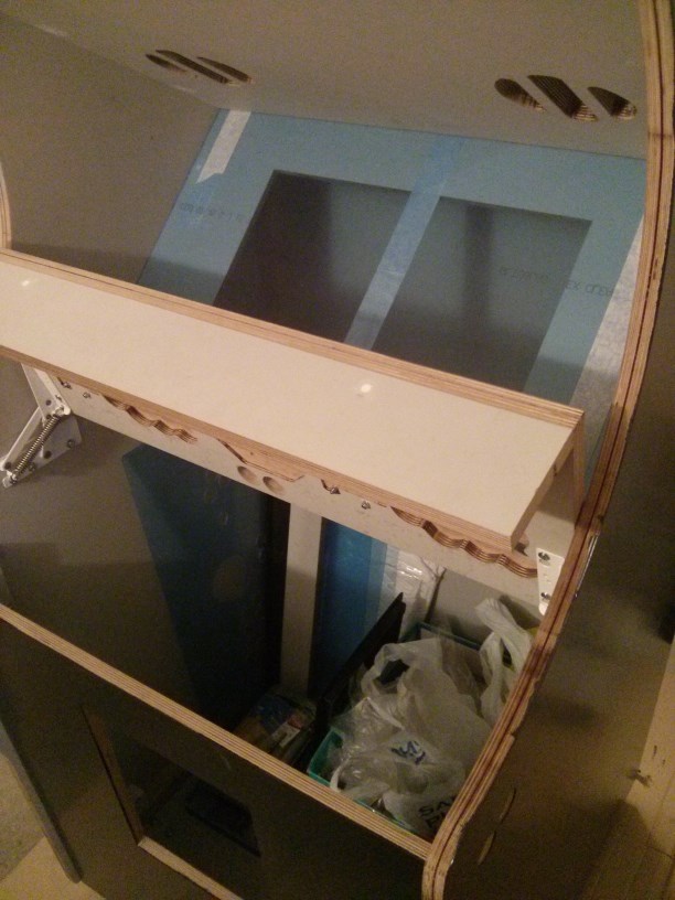

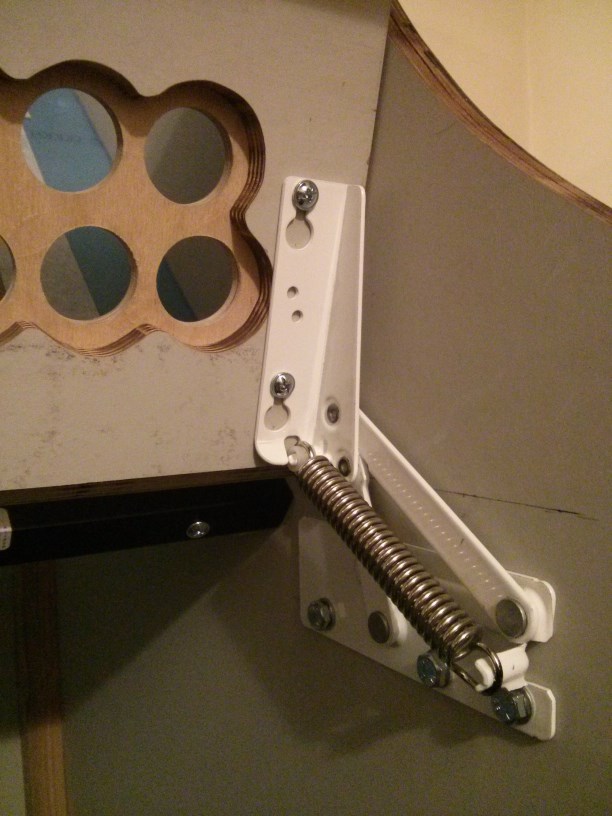

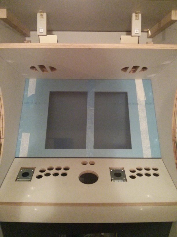

« Reply #23 on: July 14, 2014, 09:56:13 am »
When I initially planned the different parts of the cab, I did not foresee that the shape of CP would severely limit my hinge choices, as there is nothing on the front side of the cab to attach them to (only the side panels). For a while I thought that pivot hinges are the best way forward, but it turned out that the local hardware stores had a really limited choice if any at all. :banghead:
Luckily I ran into a solution I had not even thought about in the first place: swing-up fittings. All I can say is that they function really great and give an easy access to CP internals.
Swing-up fitting:
CP open:
CP closed:
I have not added additional supports and latches yet, but that is a minor issue.

Thanks! The CP is 724 mm wide. Cabinet sides are 18 mm wide each, so the total width of the cabinet is 760 mm. That's just a little below 30 inches.
Re: Taito inspired first build
« Reply #26 on: July 21, 2014, 07:48:41 am »
Never would have thought of those swing up fittings.  How much bounce is there in the down position?  Any play at all or are they rock solid?
Are these the ones you used? http://www.amazon.com/Selby-Hardware-Swing-Up-Fitting/dp/B0006LBUCU
I haven't tried them with a fully populated CP, because I'm still in the middle of painting process. Right now it does not take a lot of effort to open a bare CP. They are stiffer than eurohinges, that's for sure.
The combined added weight of trackball, joysticks, buttons and acrylic will require more effort to lift it up. However, I'm still going to add latches to prevent the CP from accidental opening (because when it opens, it pops up!)
I bought Häfele brand swing-up fittings:
(PDF) http://easylink.hafele.com/is-bin/intershop.static/WFS/HDE-INT-EasyLink_HDE-INT-Site/HDE-INT-EasyLink_HDE-INT/en_EN/pdfcatalog/TCH-FF2009/blaetterkatalog/pdf/save/bk_627.pdf
