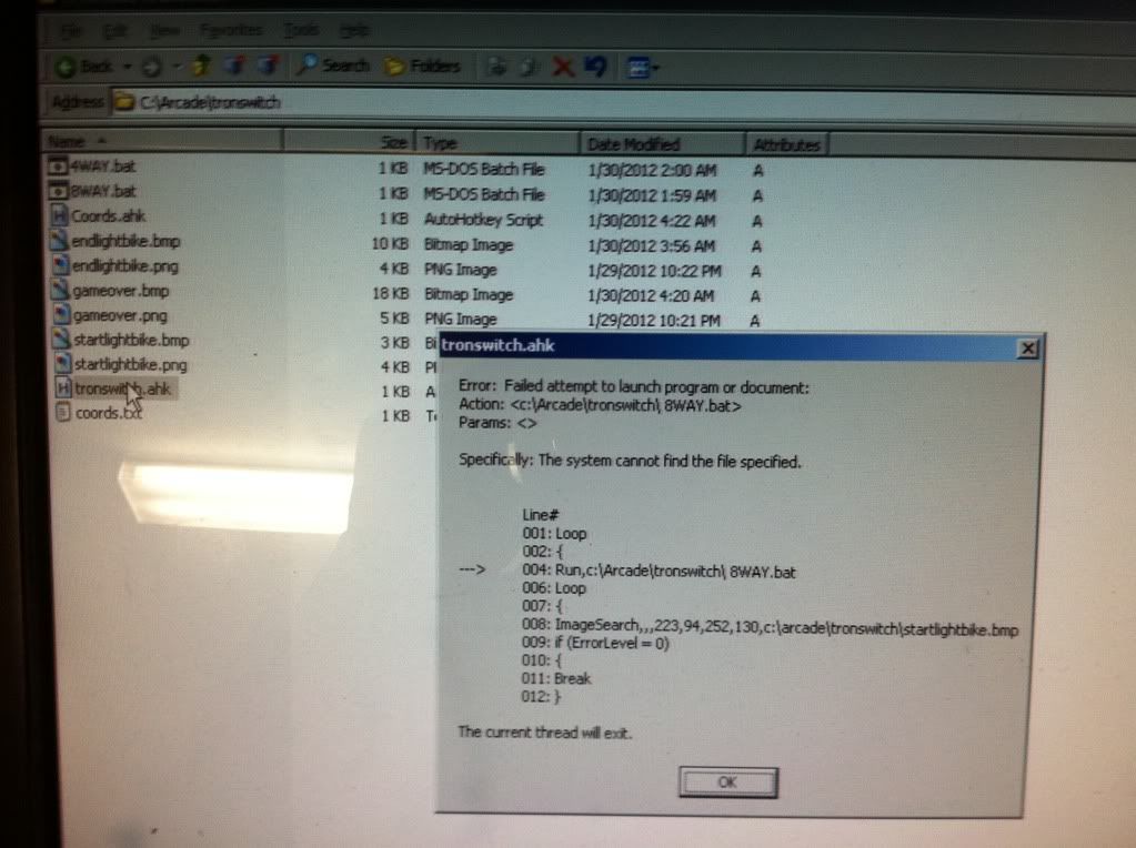

What I'm thinking:  It would be nice if a program running outside of MAME had a way to tell the lightbike stage apart from other stages
You can do this with AHK (I've done something very similar to this) provided the following 3 things are true:
1) There is some portion of the screen that is exactly the same everytime the lightbike stage comes up and is not that way anywhere else in the game.
2) There is some portion of the screen that is exactly the same everytime the lightbike stage is finished.
3) You don't mind doing some work. ;)
Take screen shots using the printscreen key to satisfy both 1 and 2. Use paint to cut out just the part of the image you need - the part that is always the same. Make sure you save them as bitmaps. Let's call them lightBikeBegin.bmp and lightBikeEnd.bmp
Then try this script:
Loop
<run batchfile to switch to 8 way>
Loop
If (ErrorLevel = 0)
break
<run batchfile to switch to 4 way>
Loop
If (ErrorLevel = 0)
break
$esc::
send {esc}
exitapp
If you're not already familiar with imagesearch, see the relevant section in the AHK help file.
Basically this script sets it to 8 way, then the first imagesearch loop waits to see the lightbike part, that loop exits and sets it to 4 way, then the second imagesearch loop waits to see the lightbike part end, then jumps back to the top of the main loop to set to 8 way and start the process again. The esc hotkey allows you to exit mame and the script by pressing escape. Obviously you need to change this if you use something other than escape to exit mame.
A couple of points:
The image on screen must match your bitmap image EXACTLY. So if you fiddle with mame's brightness, try some new scanlines or change your resolution, the script will stop working.
The portion of the screen you search for should be as small as possible. You don't want the script to spend time searching a part of the screen where the image does not appear, because then the image may go away before the script sees it.
This should work for you if you want to take the time to try it out. :cheers:

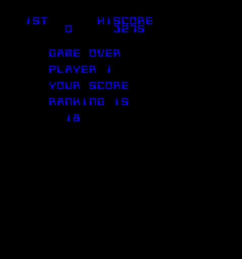

If you want to avoid having to exit and restart when it's game over on the lightbikes, try changing this
Loop
If (ErrorLevel = 0)
break
to this
Loop
If (ErrorLevel = 0)
break
If (ErrorLevel = 0)
break
where gameOver.bmp is an image from the game over screen. Then it would jump back to the top and change back to 8-way for you to start over again. :)
The only problem is, you are now alternating between two images instead of searching for just one, which could slow things down a bit. However, if your search areas are small and the image appears on the screen for at least a couple seconds, you should be fine.

Nitz, I'll be getting the screen shots I'm using here soon... From there I just need to crop them down to a small unique trait or do I leave the image size alone but white out or delete everything that I don't want?
I think that this will work out pretty well once i get the trick of it so to speak.  I wonder if there are any other in game applications that this would be beneficial for?

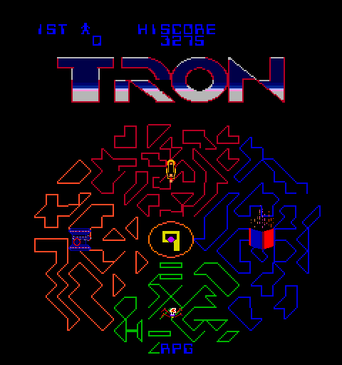

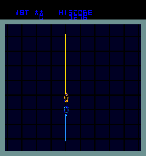

Captured the images that I'll need.  I'll get them cropped down and start experimenting.  Should be pretty straight forward.
I'll use a portion the lightbike field wall for activate 4 way
Pieces of T in TRON and G in Game Over will both key back to 8 way
The only downside is that the servo will be called after every level.  If it's already in 8 way it will just buzz for a second and turn itself off but still.

Hmm, am I missing something? I'm not sure why it would run after every level. Once it changes back to 8-way, the script should just stay in this loop:
Loop
If (ErrorLevel = 0)
break
until it sees lightBikeBegin.bmp again.

That said, I'm still Forrest Gumping my way through this and need some help.  Again.  Because I'm dumb.
This is the error that I am getting.  Is it syntax?  Because the file is right there.

I have a feeling you need to change this
run c:\arcade\tronswitch\ 8way.bat
to this
run c:\arcade\tronswitch\8way.bat
and probably do the same with c:\arcade\tronswitch\ 4way.bat as well. :)

Either
you're a genius or <and> I'm retarded.  Thanks man that did the trick!
