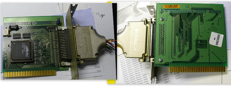

Perhaps tangentially on topic:
I found this controller card in a "Silverball 3" cabinet.  I can't find that particular model online, but here is a more modern iteration: http://www.tab.at/tab/en/Desktopdefault.aspx/tabid-63/33_read-23/
It's an ISA card in a beigebox PC that runs the actual game. The Actel chip is a FPGA.

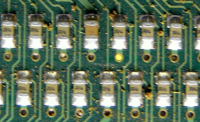

Those array of SMD components along the edge connectors are marked A4 which according to this:
http://www.repairfaq.org/REPAIR/F_SMD_trans.html#SMDTRANS_008
Lists them as BAW62 / 1N4148 diodes.
Obviously this not a parallel port, however the implementation is obviously identical, it's just a question of buses.
Just thought it might be interesting to see how this is done in a commercial product..
edit: Here's as close as I could take a picture of the SMD components:
http://lh5.ggpht.com/_xyVxXgjibE0/TJn9puL1nVI/AAAAAAAABkc/CZHCcSmt7RE/s800/P1080172.JPG
