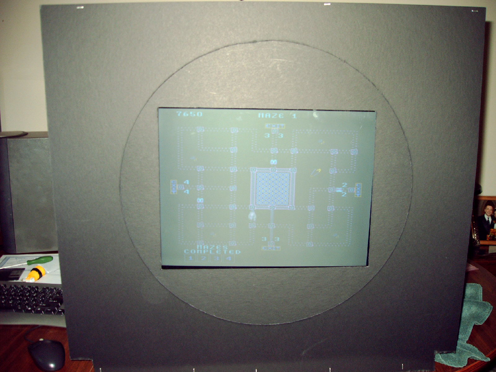

Thanks CC..
The one on the lower right is the view you would get if playing games with the monitor turned vertical.
People should realize this before they place an order for one.

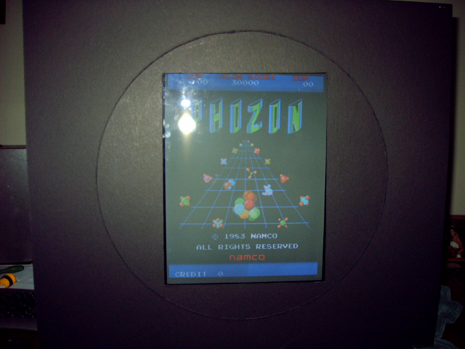

Re: Rotating monitor construction *Got the LCD*
« Reply #163 on: March 21, 2008, 02:01:20 pm »
I looked at the LCD I have at work this morning. Nothing wrong with it horizontal. Rotate it and it's not bad 15 degrees to the right (facing the screen) and washing out immeadiately as you go left. I honestly didn't think this was a problem. Worth checking out if your LCD views decently when rotated.
 Note....the LCD that I have is a LG 1918S. I wouldn't recommend it for this use.
I looked up the specs on that monitor, they say viewing angle 160 degrees horizontal, 160 degrees vertical.  Looking at those numbers I would never have imagined viewing angle could possibly be a problem.  Are the official viewing angle specs for monitors basically worthless for our purposes, then?
The one I've had my eye on is rated: up 80deg, dn 75deg, lt 80deg, rt 80deg.
For whatever it's worth, my ancient Apple Cinema Display has excellent viewing range in all directions.  I can rotate it (using a special stand I had made) and it's no problem.  I had sort of naively assumed that LCD viewing angles were a long-ago solved problem.

Re: Rotating monitor construction *Monitor plate test fit*
« Reply #174 on: March 27, 2008, 05:17:20 pm »
I didnt get a lot done today. been threatening thunderstorms all day.
I did get the holes to mount the monitor drilled in both circle plates.
I intend to run four bolts through the first plate, through the monitor mounting tabs, and through the back plate.
Here are some pics of the monitor plate mounted to the monitor, so I could mark it to cut out for the screen
This is a pic of the side of the monitor (camera was turned sideways.) you can see the line I made with a sharpee marker.
Here is the front of the monitor plate. I attached it with 1/4" carriage bolts.
I put paper towels over the screen to protect it from scratches.
And here is the side. You can see the black mark. This is where I will cut for the monitor to fit into the plate.

First of all a look at the front, horizontal position.
I dont have plexi glass in front of the screen yet, that is coming.
Here is the front, in vertical position:

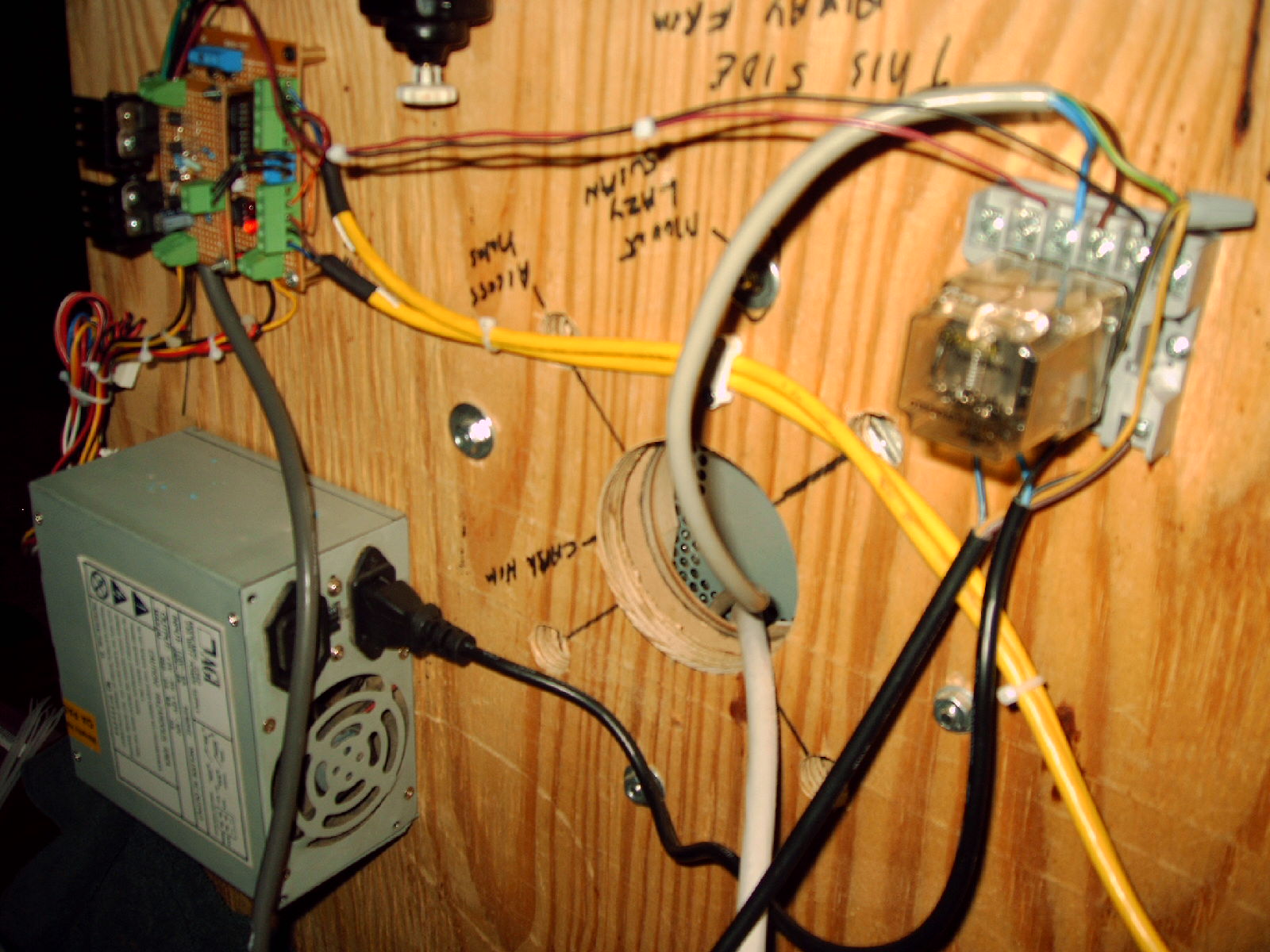

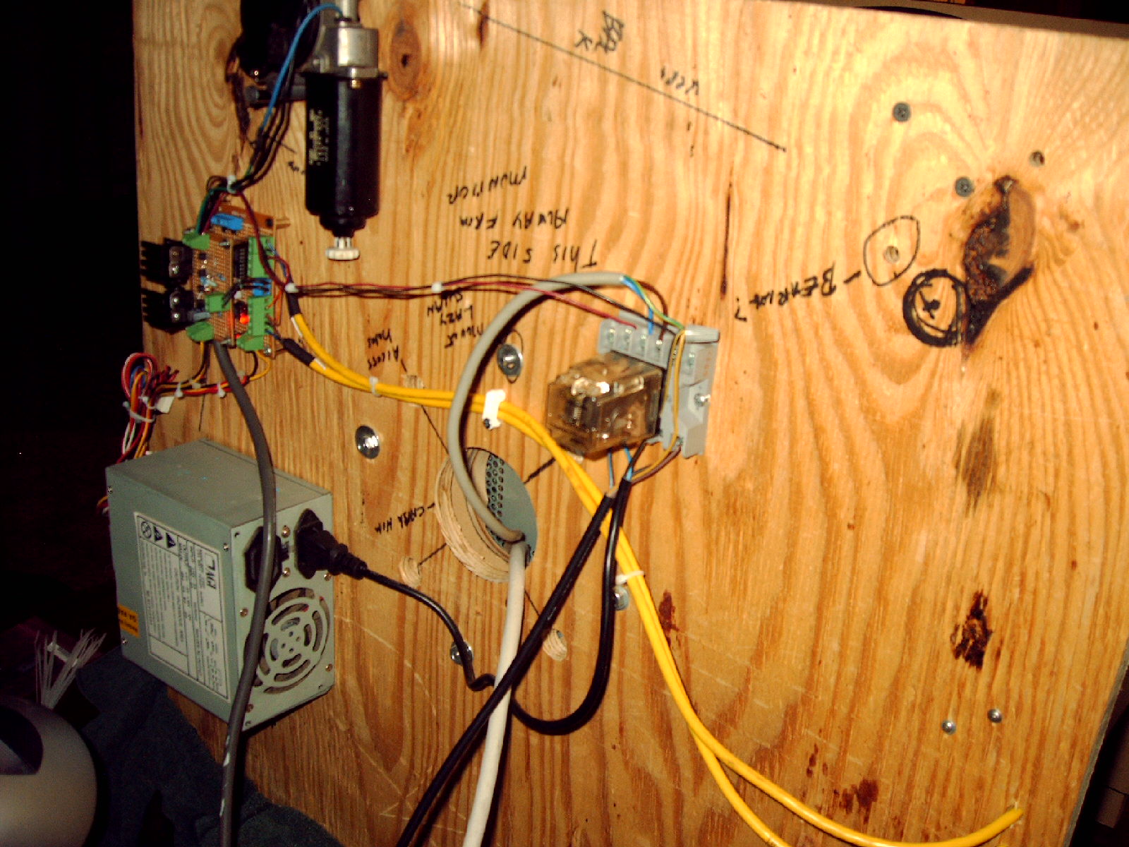

Here is the back. i went with plywood for the back, you cant see it, but there is a lazy susan bearing between the ply and the back circle of MDF.
The hole in the middle is to let the cords exit, and to allow air to flow to the back of the monitor.

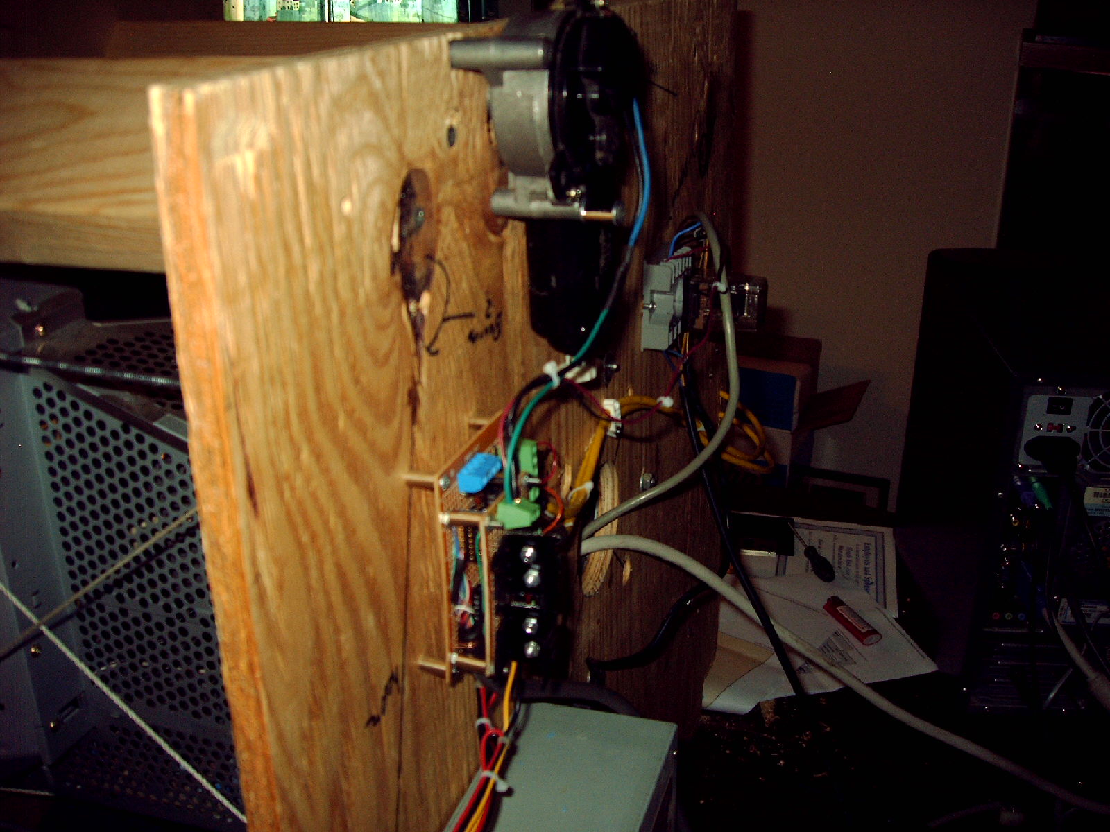

And here is the other side of the back, you can see teh motor mounted to teh plywood and teh H drive and interface board mounted below it.
Here is the back, with the monitor off relay mounted and wired into the monitor power cable.
You can also see an AT type power supply.

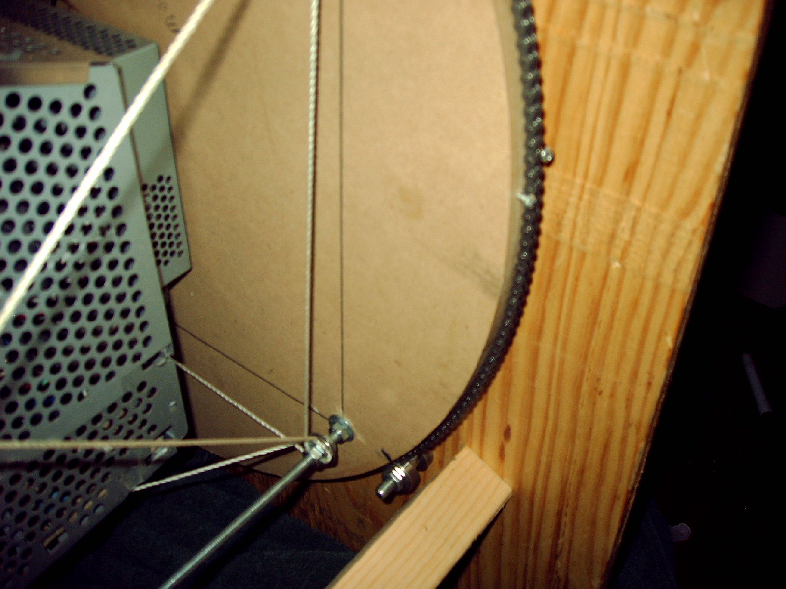

Here is one of the skateboard bearings, with the front MDF disk riding against it.
I used 5 bearings on the front disk, and two on the back.
And here is one of the back bearings, riding against the back MDF disk.
Notice the #25 chain attached to the perimeter of the disk.
This is how the motor turns the disk.
The end of the chain also provides a mechanical stop when it gets to the bearing.
Here is the motor drive. The nylon sprocket rides in the chain, and pulls the MDF disk clockwise and counter clockwise.
This setup works well, but it is a little noisey.
Here are the limit switches. These are paddle micro switches, like the kind used on some joysticks.
I put a screw through the MDF disk to strike the switch paddle when the desired position is reached.
The switches are wired back to the isolator board mounted on the back.
And here is a side view. The monitor is sandwiched between two round MDF disks.
The disks are attached with 1/4" all thread bolts.
I had to use nylon cord as bracing to keep the disks from twisting when turning.
This worked out better than I expected.
You can also see in the last picture a block mounted to the front disk.
I cut out a circle of black poster board, then cut out the monitor screen in this disk.
This disk attaches to 4 of these blocks.
You can see this setup better in the first two pictures.
Im using a mala plugin that Loadman made for me. This plugin calls my program, mrotate.exe, which turns the motor on and waits for the monitor to reach its new position. If it doesnt reach the limit within a customizable time, it will turn the motor off.
The monitor takes about 12 seconds to turn from horizontal to vertical, then about 10 seconds vertical to horizontal.
The monitor off relay turns off the monitor while it is rotating.
I had provided an output for this relay, but it is not working, I think it may be a bad opto isolator.
Rather than to take the H drive off the isolator board to gain access to the chip, I just wired the 12 volt relay to the H drive output. This works good because Im not using speed control.
The motor stops good and holds the weight of the monitor, probably because of the right angle gearbox, and the large ratio between the motor gear and the MDF disk, so I dont need a brake.
The whole monitor unit is self contained. I have installed it in Benny B's arcade. It doesnt fit perfectly, and I will need to modify the cabinet to look good. But it is working great.
I plan to document this modification in my thread I started earlier:
Extreme makeover: Benny B's Arcade
So stay tuned to that thread.
Thanks again for everyones input. The idea of the lazy susan was not mine.
Neither was the idea of the chain around the perimeter of the disk.
Im sure there are other ideas I borrowed too. maybe I will go back and give everyone proper credit here soon..
I like the rotating monitor. It is 19" CRT monitor so the vertical looks like a very big improvement with vertical games.
If I build another cabinet, I may go ahead and incorporate the rotating monitor in it. But I may try an LCD monitor next time.
