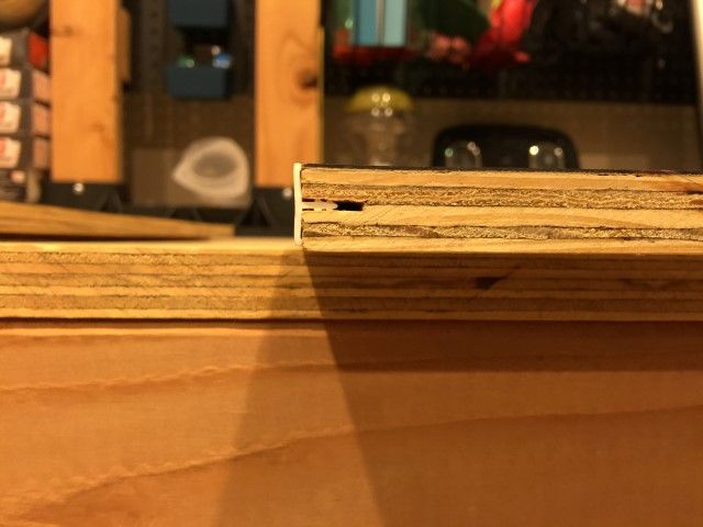

Thanks for your compliments! Taking the t-molding all the way around was nice because then I didn't have to worry about getting the edges of MDF smooth. For a replica, it will just depend on how really accurate you want to be. As another example, the back door on a DK cab has some "corner halving" and "grooves" that could be tricky to pull off without the right tools. Here is picture to better explain:
The above picture is the back-bottom-right-corner of a DK cab. You will notice that there is a groove for the right side and bottom side of the back door to rest. If you take the t-molding all the way around, it will actually make your life easier because then you don't have to deal will all these goove cuts.
Sorry, probably too much info right now for you at this stage but I'm just thinking out loud in my own head. Looking forward to watching how you sort out all the details.  :cheers:

You are lucky that you are building your own DK cab and can slot cut it down the center.
I have a DK cab that uses the bazaar off-set T-molding and ChompingQuarters is out of stock. AFAIK, they are they are the only guys making off-set.

There's a guy on KLOV looking to make more offset too. Can't find the link right now. But it's in the main forum.
Bondo the slot and cut a new one.  :cheers:
Dude...seriously. Do you think that I can get the bondo squeezed down far enough? I've REALLY been considering this but I wonder how it will hold up when I go back to slot cut it again.
Mofos do it all the time. Just use Bondo and let it dry. Hell, I've done it with regular  Elmer's wood filler with great results.
Suh weet! Thanks Yots! I have to bondo the snot out of the entire cab anyway so might as well.

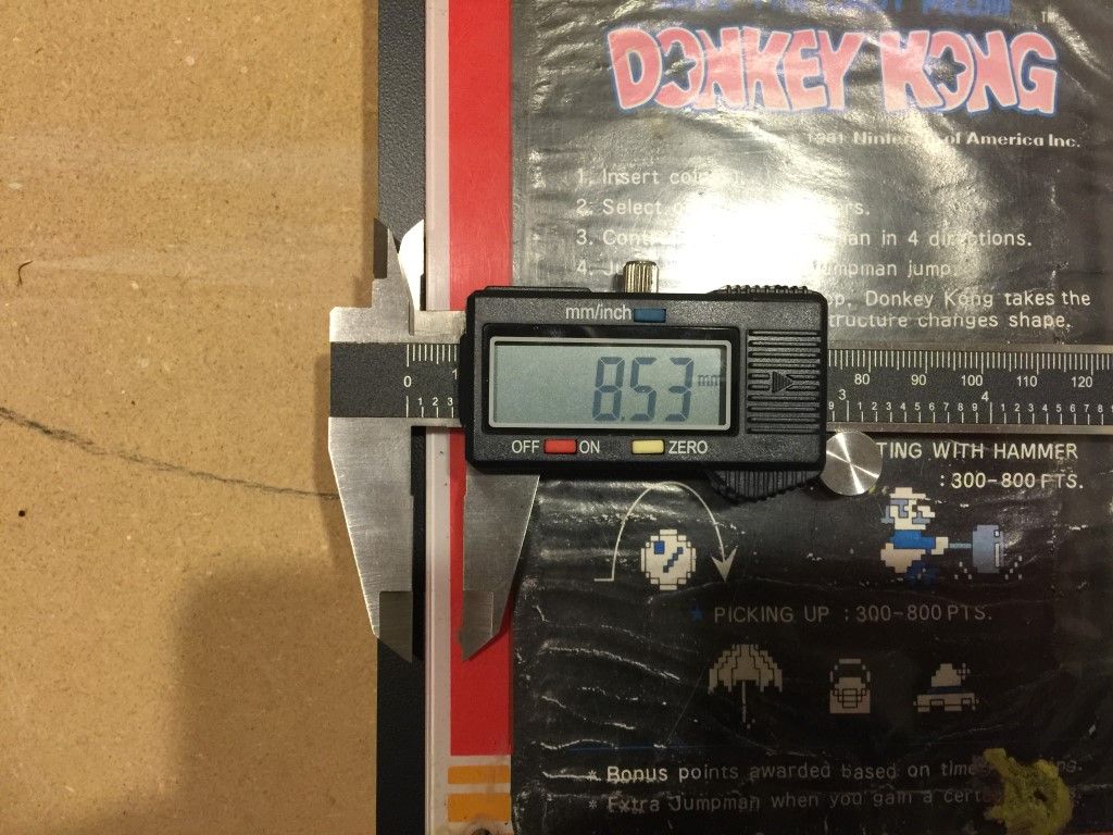

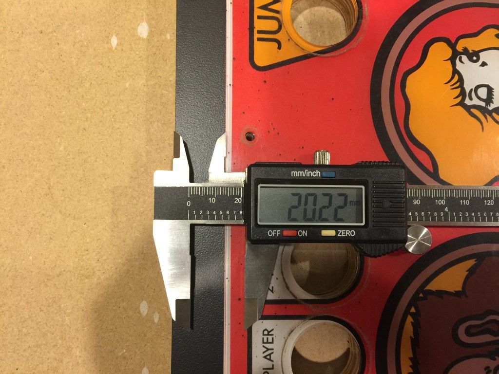

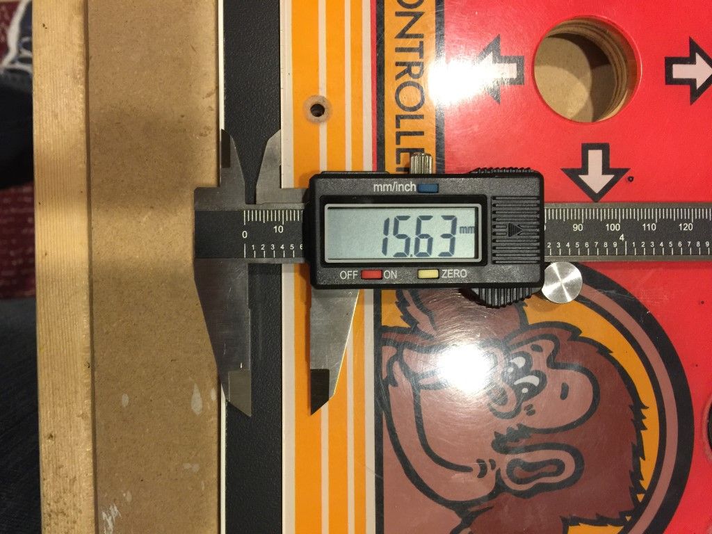

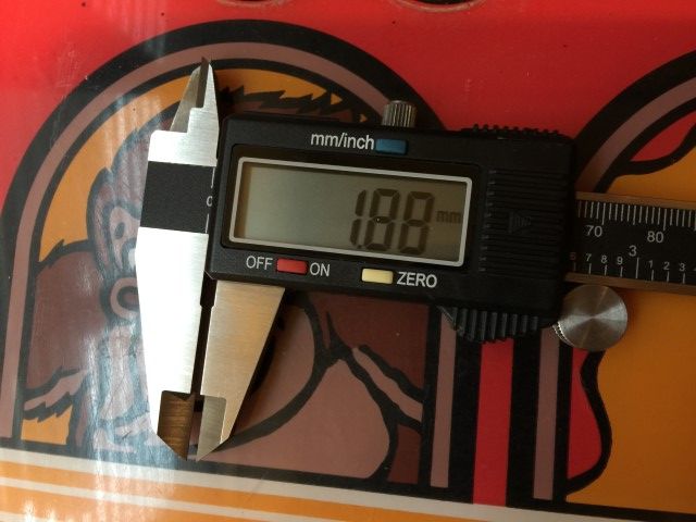

I just took some measurements on my DK cab this morning for you:
I used the depth gauge on my caliper to measure the thickness of the cpo:
The thickness of the cpo plexi is 1.88mm
I also measured the width and height of the cpo plexi and it comes out to:
Width: 549.275mm
Height: 174.625mm
Another item to note is the total thickness of the control panel with black laminate installed (on my reproduction CP) is: 16.03mm

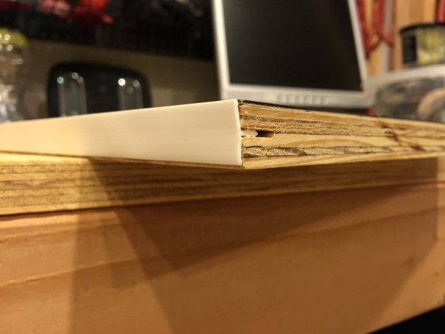

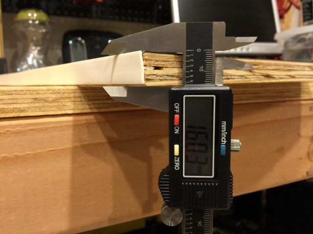

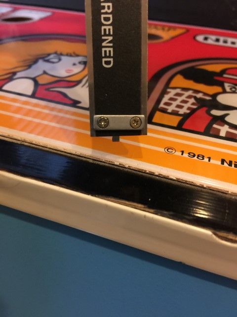

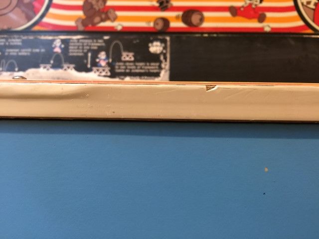

Here is a shot of the front edge of my original DK control panel. You will notice that the t-molding does not cover the entire edge but is slighly off-set and favors the top laminated side
Here are 2 more shot of my reproduction DK panel and you will notice that the t-molding favors the top side to avoid a sharp edge where you wrists might hit.
Here is a really good shot showing the very small exposed edge on the bottom side. But the top edge of laminate is nice and flush with the top edge of the t-molding.
« Last Edit: September 30, 2015, 11:17:32 am by vwalbridge »

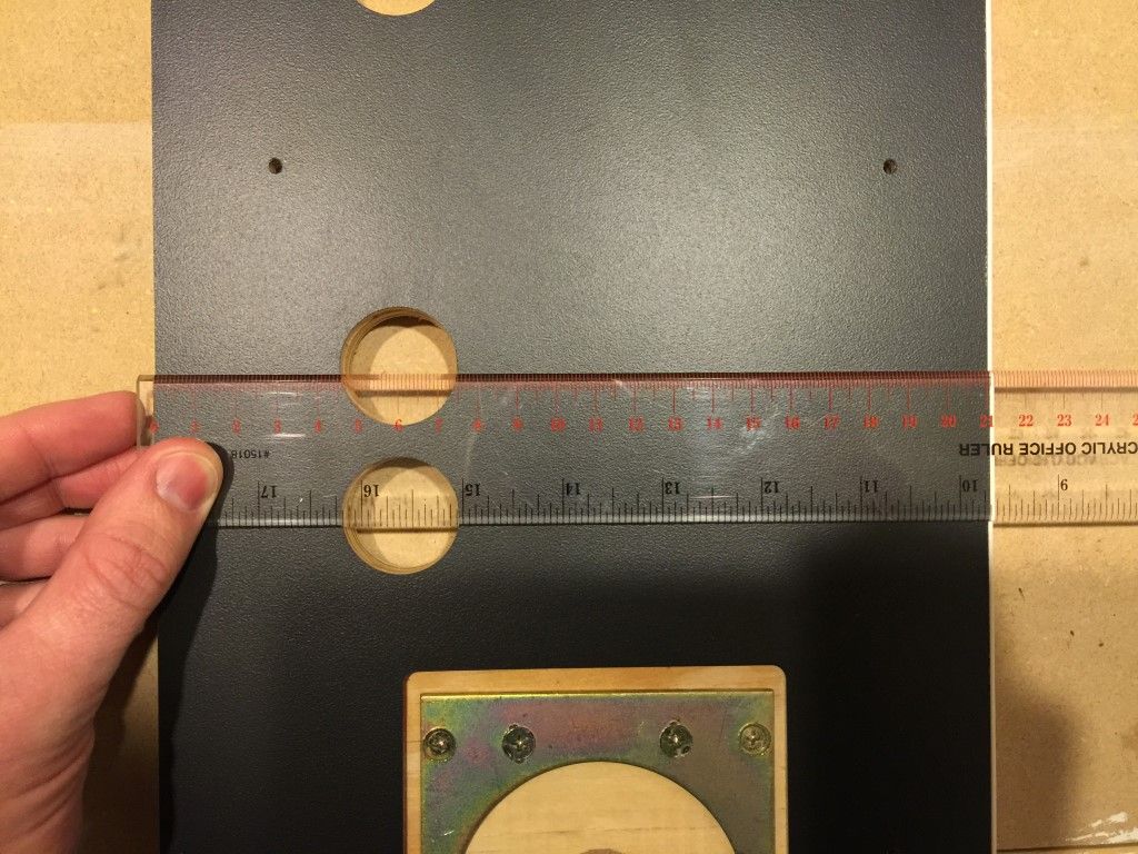

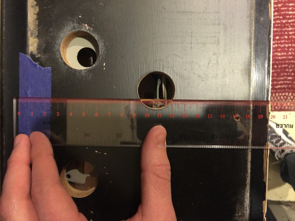

No, the cpo does not cover the entire cp.
Here is a top-down shot of my control panel.
Here is another shot of the control panel outside of the cabinet. (Not mine) The cpo is smaller than the control panel and mounts over the top with 8 small carriage bolts.

The flat 15mm T-molding (from t-molding.com) requires a 2mm slot width. The one I've got is 1.6mm. Well, I just placed an order from toolstoday.com including that one along with a 8mm straight bit for the speaker grill and a wider ball bearing (so the slot doesn't have to be that deep). Man, this hobby is expensive!  :dizzy: On the positive side: There's always new gizmos arriving in the mail.  :lol
« Last Edit: March 04, 2016, 09:14:33 pm by johnrt »

Made the lower marquee panel today. Also the back door (but I forgot to take a pic of it).

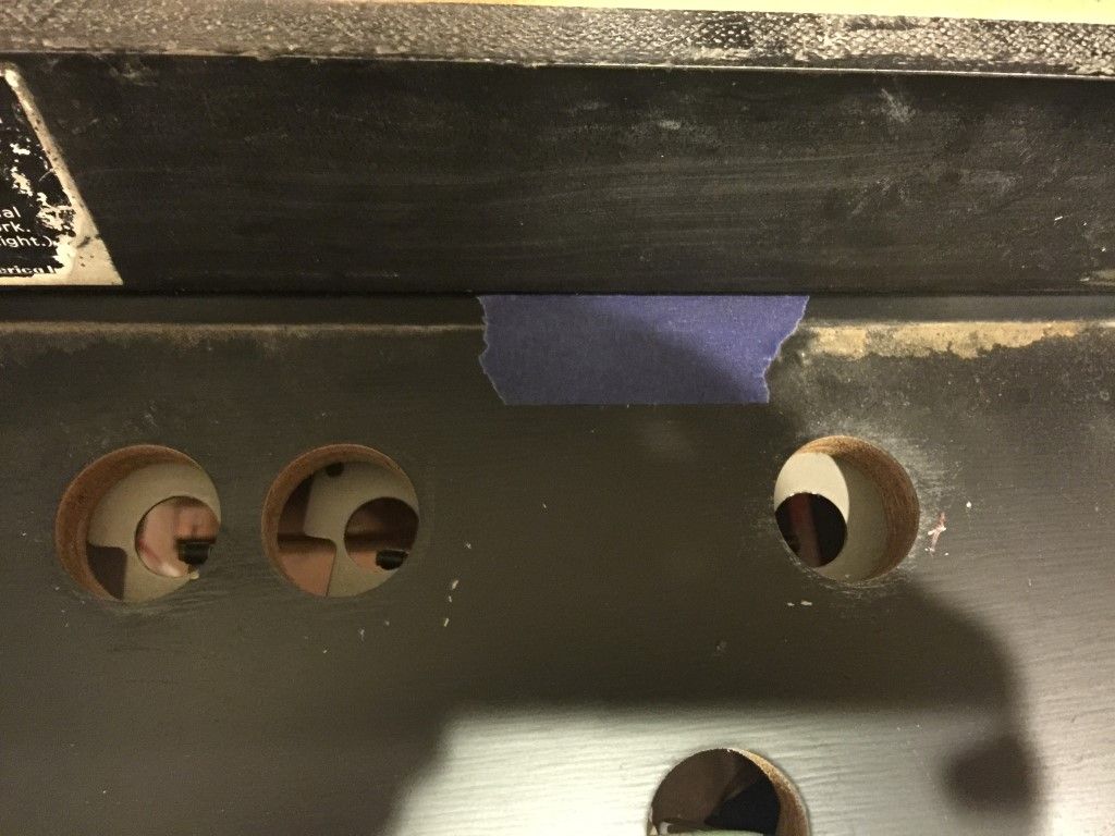

Chance: I need some measurements from you. Could you please, pretty please, provide these:
A. The back door:
B. Marquee area:
Diameter and position of these holes (I know it doesn't matter... it's just some minor OCD):
« Last Edit: March 04, 2016, 09:16:17 pm by johnrt »

ChanceKJ
  • Posts: 3229
Re: Donkey Kong Replica: Scratch build using Gaetan's plans - It stands!
« Reply #114 on: October 05, 2015, 04:28:01 pm »
A: 119mm
B: 349mm
C: 49mm
D: 115mm
The "Vent cover" on the inside of the door is 400mm X 102mm, made from 12mm ply. With a pair of small risers on each end that are 15mm X 102mm, made from 20mm ply. Staples and glue are used to attach the "vent cover" to the back panel.
The holes are 30mm, centred from top to bottom on the panel and the centre of each sits 55mm from the side wall edge.

Thanks Chance!

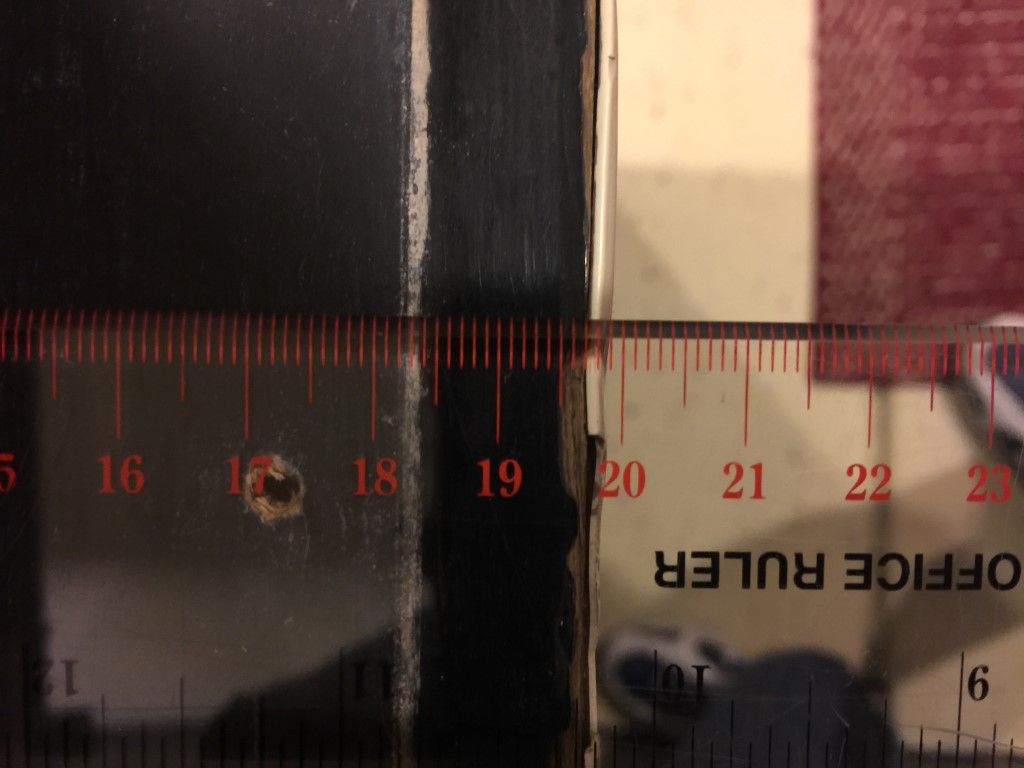

And if you could check this also I'll be super happy! No rush though.
« Last Edit: March 04, 2016, 09:16:38 pm by johnrt »

ChanceKJ
  • Posts: 3229
« Reply #118 on: October 05, 2015, 06:32:16 pm »
Just checked again. Should be 523mm.

Shouldn't be hard to make one. you have a choice:
The one from my Japanese DK cab is on the left, and the one on the right is from my newer US made MarioBros.
they're both 100mm wide and approximately 18mm x 18mm. Just two different styles.  They shouldn't be hard to make.

Then I turned my attention to the slot where the CP will slide in to. I had a routerbit that was angled, but not enough.
So I decided to angle the router itself a little to increase the angle:
After I did the angled routing, I routed the rest of the slot with a 12mm bit.
This is the "jig" I had to make before routing it. Just to keep things in it's place during routing.
Distance to the slot should be 59mm. This is dead on.
Testing the finished angle:
Once again, dead on.
Testfitting in cab:
I think I did a decent job with this if you consider the tools I have available. You will have to find untraditional solutions yourself when you're missing the right tools. I think it turned out very nice in the end.
At last I made the control panel board and testfitted it:

Man, I have not been looking forward to the making of the speaker panel with the famous grill. But I nailed it tonight. I spent 4 hours on this!
First I found that this old kitchen door (or side) panel is exactly 16mm thick. That is exactly the same as the space between each cut.
From this I cut myself 6 spacers. The plan is to add a spacer after each cut.
Then I spent a lot of time on the "jig". Here's the first and second cut done. Note the spacer.
Next cut, new spacer. Also note the little Lexan guide that is screwed to the jig. This makes is possible to move the router back and forth.
The finished grill, front:
The finished grill, back side:
The finsihed speaker panel:
At last a tip: Don't plunge the router bit through the wood. Route back and forth while increasingly pushing the router downwards. I did a test run on some scrap wood to find the best way to make the cuts.
Edit: I forgot to mention, also add something to prevent the router going more sideways than the width of the slot.

OK, johnrt, I hope this all makes sense.
I placed a piece of blue tape on the visible edge of the control panel next to the lower bezel mount to represent the visible edge:
Then I pulled out the CP a little and measured the portion of the panel that is tucked under the lower bezel groove: 12mm
Then I placed the ruler across the entire visible area like seen here:
...and zooming into the front edge. The total visible area comes out to: 197mm   (you will notice this measurement does not include the t-molding on purpose)
I also placed the ruler on my reproduction CP (Identical to my original CP by the way) to measure the total height of the control panel:
...and zoomed in the measurement of the entire height of the control panel is almost exactly: 210mm
I also screwed in my crappy CPO and measured the wider top edge. (Distance from the top edge of the CPO to the edge of the CP tucked under the lower bezel): 20.22mm
And here is the meassurement of the opposite side. (Distance from the bottom edge of the CPO to the edge of the CP with t-molding): 15.63mm
And in case you need it here is the distance from the left/right side of the CPO to the edge of the CP: 8.53mm
Hope this helps. Glad to take any other measurements you need.

Tonight I've been gluing the parts together. It's been like point of no return. Now it's a couple of days (at least) with more filling and sanding.
« Last Edit: March 04, 2016, 09:21:55 pm by johnrt »

Looking good! But is your camera teabagging us?! :(

Yeah haha! That looks frightening similar to those rubber testicals you can get for your pickup truck out here. Haha. Related to my other thread at all John?  :laugh2:
Well, I'm a modern man(!). And I was just trying this new selfie trend on social media these days called "nutscaping" (google it). At least it's become very popular in this country. And since it's "movember" (google that too) and everything this should be appropriate.
But seeing the pictures make me wondering if I've aquired gangrene on my balls.

Time for T-molding. Cabinet laid down on a duvet(!) before applying it.
T-molding was applied all the way around (sorry for deviating from the original like that), but I think it adds a little strength to the edges also on the back side.
Even the CP has T-molding now:
As you can see, the T-molding from t-molding.com isn't completely flat, but it looks good nevertheless.

Re: Donkey Kong Replica: Scratch build using Gaetan's plans - Need measurements
« Reply #261 on: December 14, 2015, 08:36:05 am »
I need some measurements, please. Can somebody measure the red, blue and green lines on this pic: Please???  :notworthy:
I know they wont be exact, but it would help nevertheless.
« Last Edit: March 04, 2016, 09:27:31 pm by johnrt »
ChanceKJ
  • Posts: 3229
« Reply #262 on: December 14, 2015, 09:35:26 am »
« Last Edit: March 19, 2021, 03:22:18 am by ChanceKJ »
johnrt
« Reply #263 on: December 14, 2015, 09:36:58 am »
These measurements are taken from the centre of the monitor, not the corners of the tube. They are approximate.
Green: 9 inches
Red: 20.25 inches

I took the pic into a graphics program, enlarged it proportionally and drew the three lines. According to the program,
green is about 210 mm, red is about 518 mm and blue is about 62 mm.

« Reply #267 on: December 14, 2015, 11:01:07 am »
« Last Edit: March 19, 2021, 03:22:06 am by ChanceKJ »

So it's time to restore progress on this build also. And now I need these measurements for the service button bracket(A, B, C, D): Chance? Anyone?
« Last Edit: March 04, 2016, 09:28:19 pm by johnrt »
ChanceKJ
  • Posts: 3229
« Reply #277 on: January 02, 2016, 04:51:59 pm »
« Last Edit: March 19, 2021, 03:20:02 am by ChanceKJ »

ChanceKJ
  • Posts: 3229
« Reply #279 on: January 02, 2016, 04:53:32 pm »
« Last Edit: March 19, 2021, 03:19:50 am by ChanceKJ »

Minor update: Marquee LED strip mounted.
It resulted in a nice and even marquee light.
Although a little bright, so I mounted this dimmer:
The wires to the marquee are hidden in this cable channel:
Too detailed?
