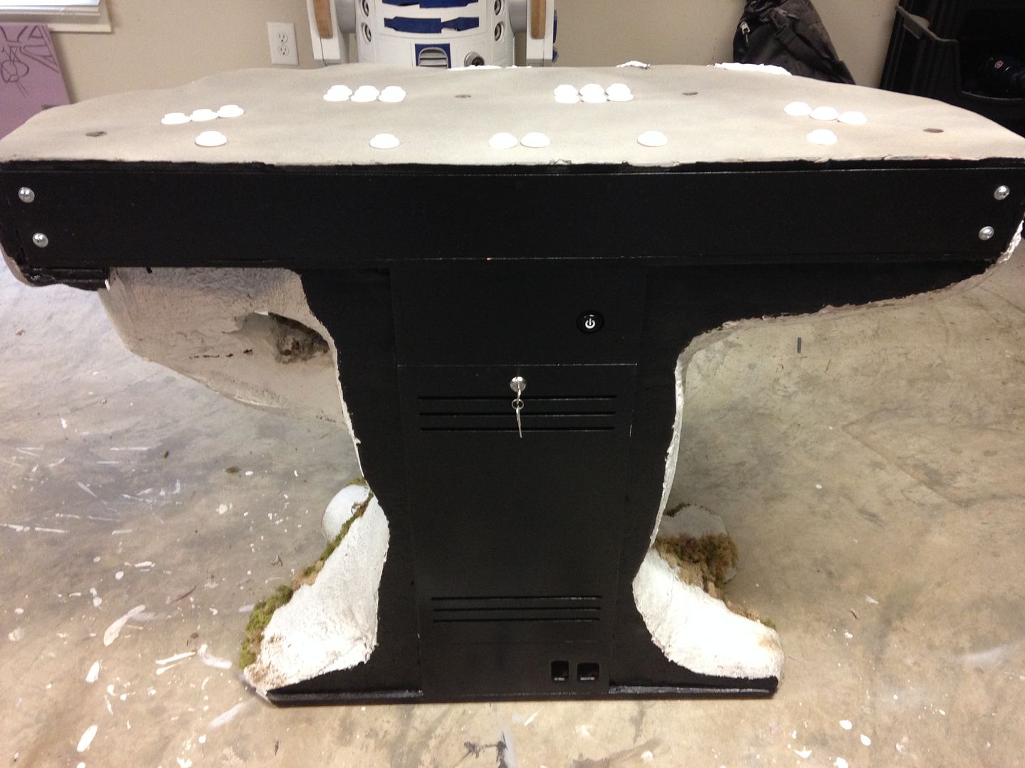

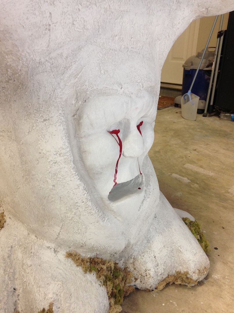

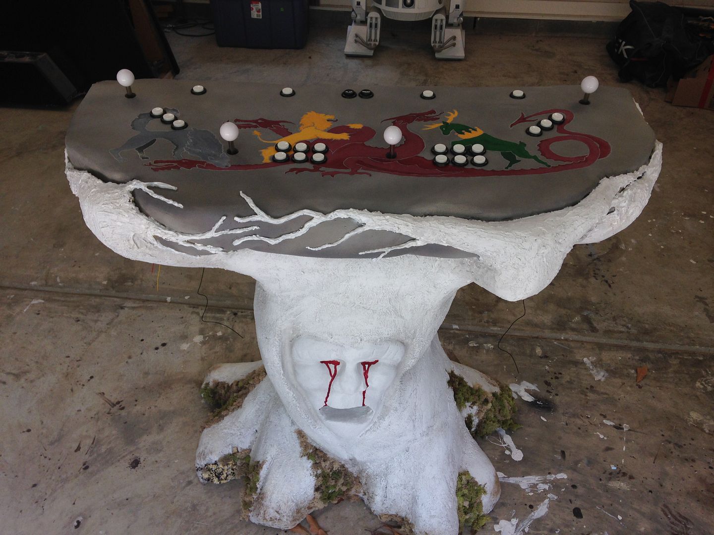

Game of Thrones Pedestal officially complete on 13 June 2014.  A few pics...
Original Post:
No - I'm not going to start watching the series or reading the books...which I really should do btw.  I've got another commission piece to tackle.
Just got done doing an art piece for a friend in Cali and shipped that off on monday, just finished a furniture piece for the wife's friend (well need to do the shelves but that's tomorrow) and all I have on my plate right now are a handful of half built micros, my son's build that isn't even started, and Idle Fingers Starfighter...so yeah, it's a perfect time to start another project  :banghead: lol.  It's all part of the master plan and May is Game of Thrones build.
Client wants a 4 player pedestal.  Yes we had the conversation about how much play 3P and 4P see, so he knows what he's buying into.  Pretty much it's a straight forward build.  Here's what we're looking at:
All 8-way joys
P1&P2 6 buttons
P3&P4 3 buttons - that fourth button for the few games that need it will be a 1&2 combo or a 2&3 combo - either or.
Two admin buttons.
Four player/coin buttons.  Anybody had any issue doubling these up on 4p panels?  Seems the easiest way to limit button count and encoder whatnots, I'm trying to limit clutter, make idiot proof, and hit the 40 input sweet spot. If there's a good reason why making double use of the player button won't work I'll adjust.
Size - neighborhood of 48"x 18" and 36" tall.
Theme:  Game of Thrones.
Trickyness:  Base is sculptural, as is CP.  Looking to incorporate series imagery that is more evocative than just plastering pictures on it.  Current design is a weirwood tree supporting either a stone slab with runic carvings or wooden slab with inlay.
Houses to be represented:  That one with the dragons, that one with the stag, that one with the lion who seem to all be into sleeping with eachother, and that one made by the client to represent his family, a griffin (He gets to be P1 of couse  ;D )
So, yeah, this weekend I'll do the rough construction, start laying wire and foam on the base, maybe do some fibreglassing, may or may not set the garage on fire.  Should be fun!

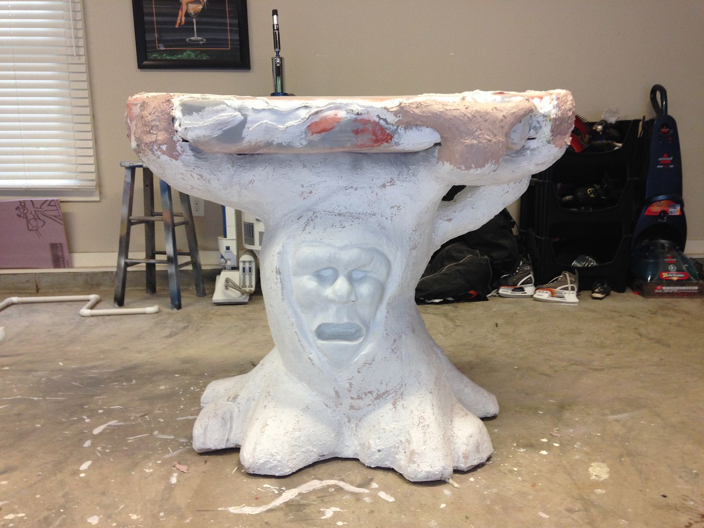

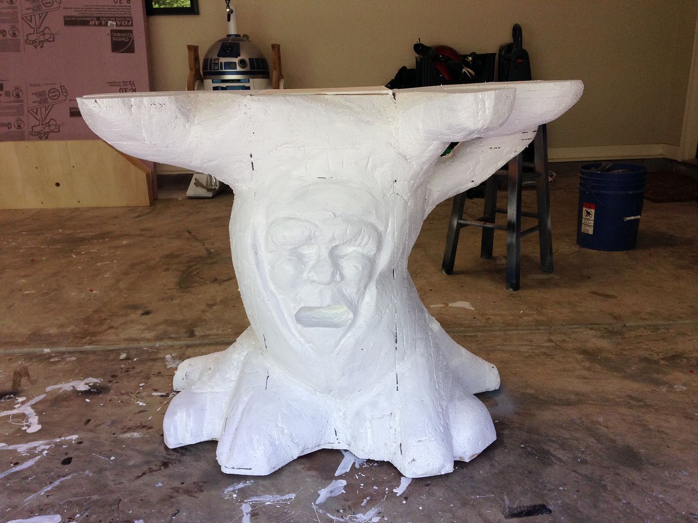

Step 1. Make a box.
Step 2. Make a 4p cp.
Step 3. Foam!

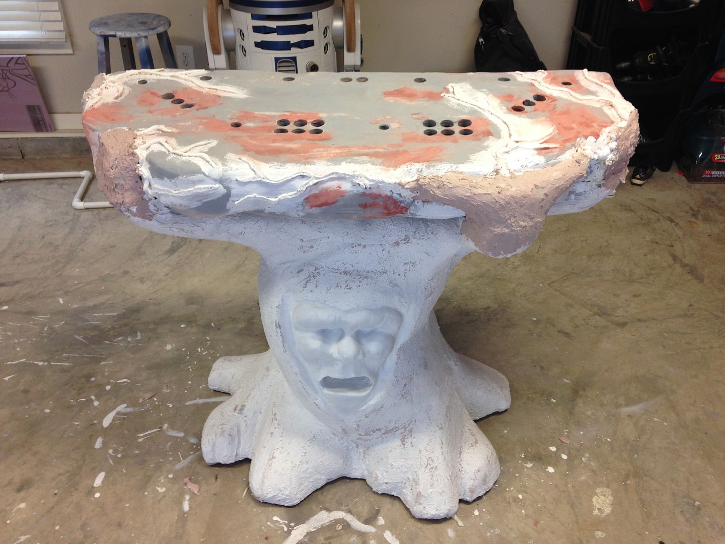

Umm . . . Why are P4 joystick and button positions swapped? (stick on right, buttons on left)

Several reasons.
1) it's more comfortable for the 4p position which is the most awkward on a 4p panel. For go right and fight brawlers you adjust instantly.
2) it looks better. Subjective answer is subjective.
3) it'll help me out on the CP design. These pictures are armature.

@rablack - thanks for the kuddos  :cheers:  I'm sure it's all preference but on brawlers I really can tell no difference between lefty and righty setups.  They're all quarter munchers.  At least I didn't angle it  :lol
I am using Glidden Gripper to laminate the foam board into blocks.  It's on the drying cycle right now.  Gorilla glue (expansion low foam) is way faster and about the same grip but waaaaaaaaaaaaaaay to expensive so hopefully this glidden primer will do the trick.  I really can't wait to start carving.  It's been years since I've done any and I definitely have the itch.  Getting my creative juices flowing on all kinds of stuff.

Step 3.5
Put foam on the box thing
Step 4.
Cut away anything that doesn't look like a weir tree.
Next up, "fun with bondo"!

Re: Game of Thrones - let's see how far I get in a month
« Reply #46 on: May 19, 2014, 07:54:48 am »
Thanks guys!  It's a lot of fun and very forgiving, I recommend that everyone try it - you'll really be amazed what you can crank out.  All of that was done with the following tools:
Wood saw
2" paint scraper heated with blowtorch
Sureform rasp (an absolute must have when working with foam)
Dremel with drum sanding head and 1/8" spiral cut bit.
120 grit sandpaper
I put some of the primer/glue on a bit thick for a few panels and it was still wet when I started carving.  Some started to de-laminate a bit but a squirt of Great StuffTM and a few toothpicks locked everything back down.
Also, as a note if anyone is looking to start working with foam, bondo disolves polystyrene.  You have to seal the piece before you coat it (and that's only necessary if you have a lot of laminate sheets like I do, or want to change the surface texture).  I used the same Glidden GripperTM to seal the piece as I did to glue it all together.  I used a foam roller and then went in with gloved hands and used my fingers to really work the paint into the cracks so that way when I go to bondo over the whole mess it doesn't shrivel up and disolve away.
If you wanted to make the whole thing hollow you could bondo it all then drill a few holes and pipe in acetone and wash the whole mess out.  Also, if you want the styrofoam to be super hard I recommend using half bond and half urethane resin mixed together with bits of fibreglass sheet cut up and mixed into the compound.  The bondo activator will work on the resin also - it's called "bondo-glass" and is pretty much the hardiest stuff around, but is total overkill for this application.
Anyway below is a pic of the stand sealed and drying.  Tonight I'll be able to apply the bond and start doing some of the bark effects on the build.  I'll also start foaming the CP and may start on getting it shapped as well.  You can see R2 in the back, the drink tower is back to chrome now (I keep changing things on it trying to get the look just right) and I still need to make the updated drink tray - so busy right now), but he serves beer and should also serve as my jukebox here shortly...or whenever I find time to mess with him lol.
« Last Edit: May 19, 2014, 08:01:03 am by Le Chuck »

Step 5: lather rinse repeat on the CP but make it like a big rock.
 I'm in the middle of Step 6 which is to join the two but I ran out of bondo tonight. That's why it all kinda looks kerfuddled right now but I'll get that sorted this week. Next weekend should be detailing, texturing, weathering, leafing, and painting. Oh and pesky assemble of the arcade controls.
I might need one more weekend after all  :lol

We're a week out from the one month mark.  Still a lot to do but hopefully we are looking less bird-bathy.  This next week I need to dye the plastics, hook up all the controls and paint the sigils and runes on the CP.  Minor touch up needed here and there as always but the client is happy and so am I.
Too many steps at this point...Pics!
Looks like there is a red mark on the forehead, I didn't notice it in the garage but it is sticking out a bunch in the pics, probably a finger print from when I was using the cut up visine eye dropper to do the red paint and it got all over my hands.  I'll have to go fix that.
« Last Edit: June 01, 2014, 06:20:22 pm by Le Chuck »

I missed doing my Sunday update but here's where I am at for the one month mark.  I'm not 100% complete (trim the moss, add more moss, add more weathering) but I am wrapping up.
Went back and forth on the button painting a lot, tried a few examples and really found that if you try and make the buttons disappear into "stone" it just looks like you're trying really hard to make the buttons disappear.  The effect is...poor.  So I did a simple treatement that I thought looked nice and tied in with the base.  The black surrounds are a metallic flake, bad pic tho.
I haven't painted in years, well nothing besides solid colors so it was nice but I was certainly rusty.  It's not "hang on the museum wall" quality but I think it looks good and fits the theme very well.  The shading doesn't show up well in this pic but there is some reasonable depth to it.  I also got the MALA Layout together so here's the background for that.  PC is in, controls are wired, just need to clean things up and will be ready for delivery.  I'll waiting on a USB audio dongle right now to come in from Amazon - PC had a borked audio lineout jack, then it'll be out of my life *sniff sniff*
I'll get better pics before that day tho.

We're complete.  Delivering tomorrow, pretty psyched.  Pics and first post updated with the same.
ChanceKJ
  • Posts: 3229
Re: Game of Thrones Pedestal - Commission, sculptural build
« Reply #92 on: June 13, 2014, 07:30:18 pm »
Every time I look at this I keep having to remind myself that the tree is supposed to be that colour.  :D
Great job on this, love the clever use of what looks to be Woodland Scenics model railroad decorations. The originality all around is fantastic.
Agreed.  Every time I see a tree my brain automatically thinks brown.  Not ghost white.  LOL.

Thanks gents, the colour definetely gives a bit of a double take at first but now that I'm totally used to it I couldn't imagine it another way.  The moss isn't Woodland Scenics (love their stuff) but a much cheaper set that I got over in the craft flower dept for $6 to do all of it ;) .  What really fixed it was taking a pair of my wife's good shears and going over all of it for a close crop haircut.  That really helped the scale of it and gave it a much more natural look imo.
