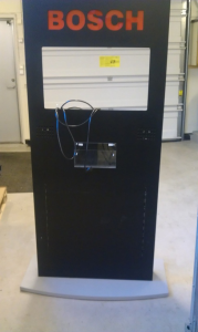

Stuff i already had:
-27 inch lcd tv (from old bosch display)
-Power connector  (from old bosch display)
-Lights (from old bosch display)

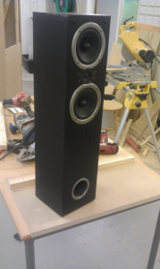

Made some holes for my speakers. Alot of testing with the router before i got i right.
Still have to make holes for the tweeters 8)
