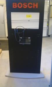

Stuff i already had:
-27 inch lcd tv (from old bosch display)
-Power connector  (from old bosch display)
-Lights (from old bosch display)

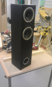

Not sure what to do on the corner of the cp later. Just cut the t-molding?
Made some holes for my speakers. Alot of testing with the router before i got i right.
Still have to make holes for the tweeters 8)
Time to take my project home to the garage. Most of the woodwork is done. Alot of dust to clean up today :o
« Last Edit: November 25, 2012, 05:54:21 pm by steinar-t »
