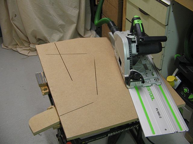

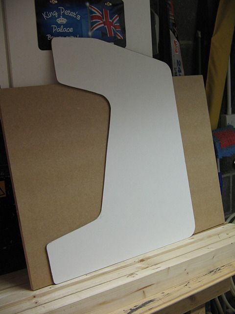

Early cuts with a little FESTOOL porn!!
CoryBee
  • Posts: 2093
  • Bopity Boopy
Re: Bartop Started!!!
« Reply #1 on: July 17, 2012, 08:02:29 pm »
Nice cuts, did you make or purchase that template?
jahilton2002
  • Posts: 308
  • Last login:January 17, 2026, 05:34:53 pm
« Reply #2 on: July 18, 2012, 02:48:22 am »
Its from scratch...... we are making two so made a template to match.  :cheers:

I like that shape!

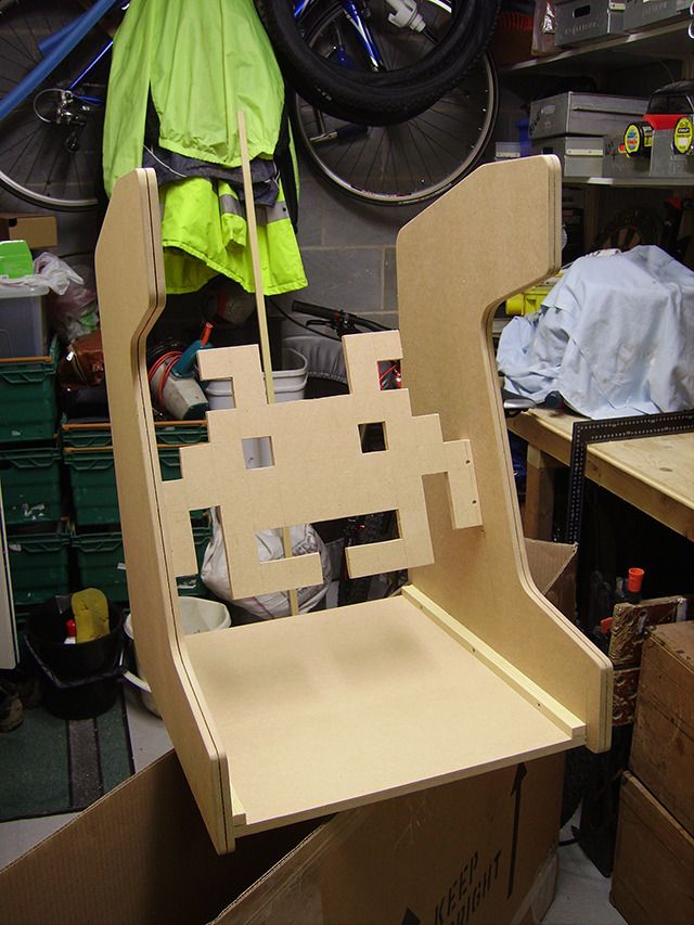

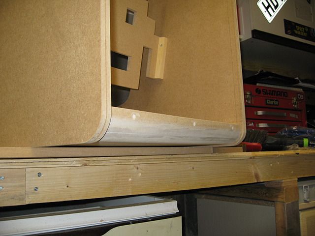

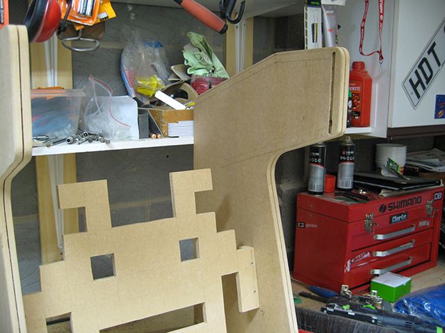

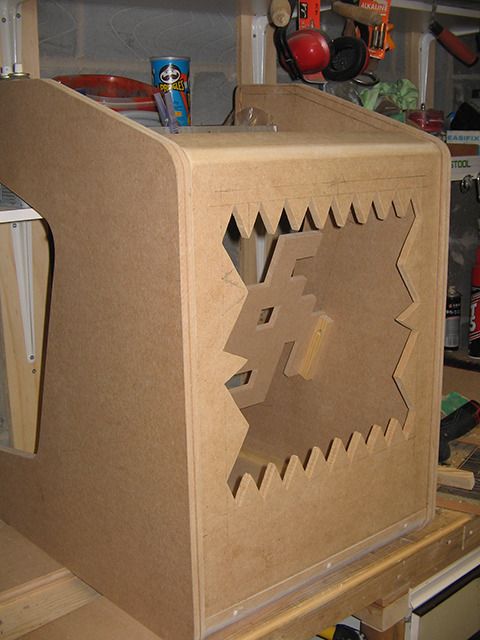

More pics, lets ROCK;
steveh
  • Posts: 340
  • Last login:January 29, 2024, 09:33:42 am
    • thecrazysteve.com
Bartop Started!!!
« Reply #7 on: September 23, 2012, 07:40:57 pm »
Wow love the space invader. Cant wait to see how this turns out
Sent from my iPad using Tapatalk HD
consolas
  • Posts: 99
  • Last login:January 08, 2016, 06:51:34 am

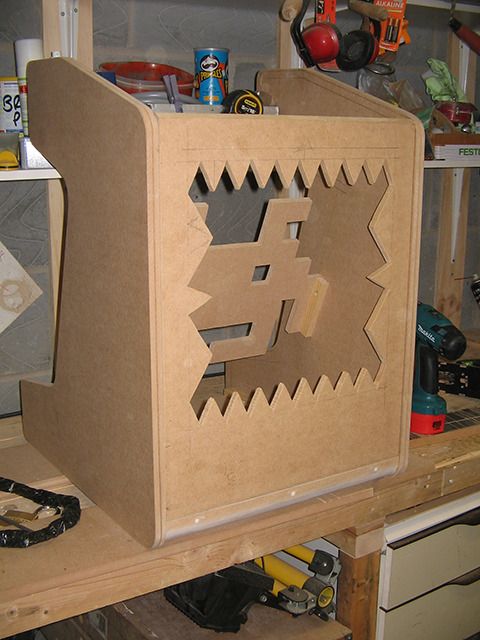

« Reply #8 on: September 26, 2012, 11:49:01 am »
Nice!!! I decide to use pvc and then I see things like this and I have to rethink everything! Is this mdf? Awesome space invader!!!

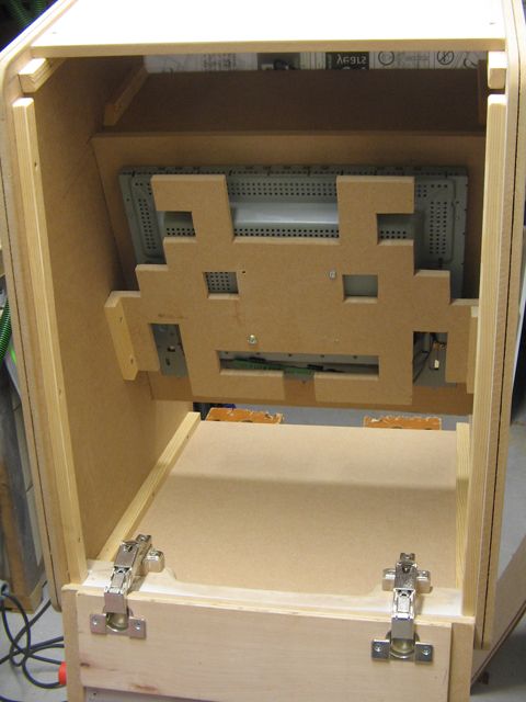

« Reply #9 on: September 27, 2012, 03:56:17 pm »
consolas
  • Posts: 99
« Reply #10 on: September 27, 2012, 03:57:45 pm »
Awesome. Is this MDF? How thick?
The invader is awesome, so perfect
Johns Uncle
  • Posts: 12
  • Last login:April 18, 2020, 12:20:50 pm
« Reply #11 on: September 27, 2012, 04:36:50 pm »
Hi consolas, yes it's all mdf sides are 18 mm to suit the T mold, and the rest is 12 mm just trying to keep the weight down.

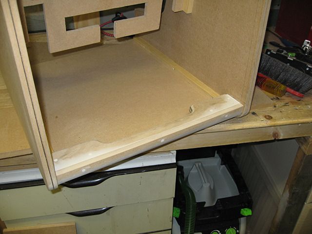

« Reply #17 on: October 22, 2012, 04:29:33 am »
More pics;

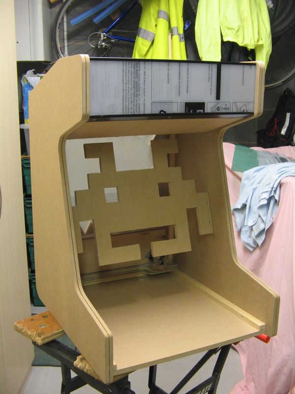

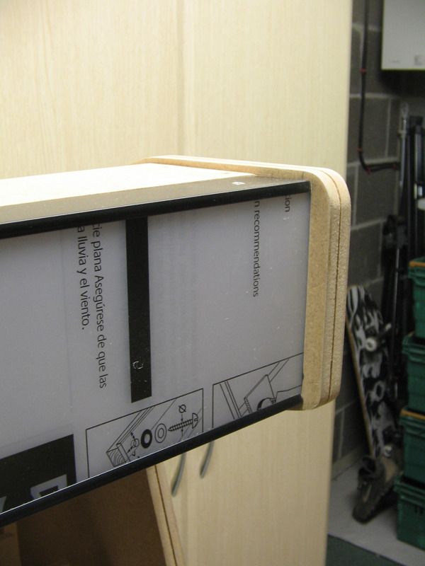

« Reply #19 on: October 27, 2012, 05:23:04 am »

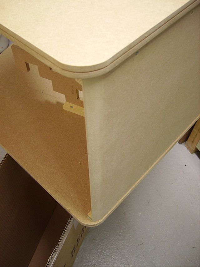

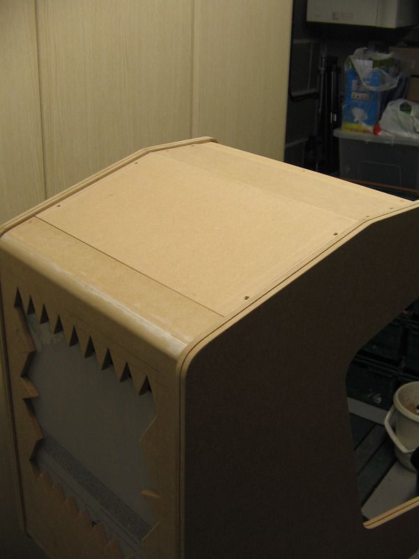

Taking shape now!

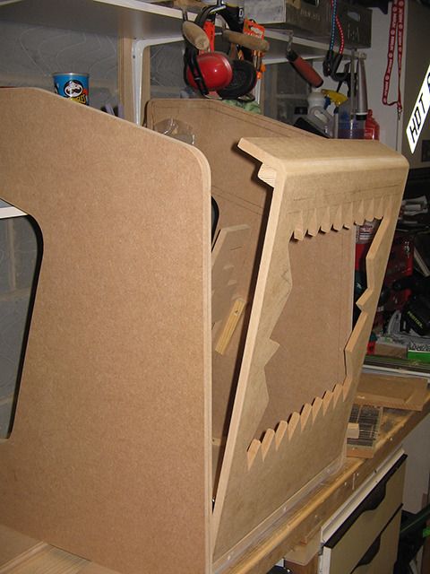

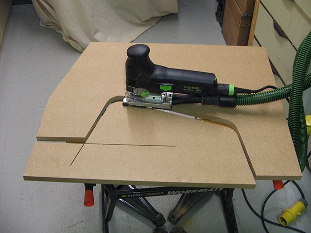

Awesome! Did you cut that space invader out with a jig saw? If so how did you make such perfect cuts?
Johns Uncle
  • Posts: 12
« Reply #22 on: October 27, 2012, 10:28:15 am »
hi boomerbrian, yes little invader cut out with a jigsaw, just took my time and used a really nice jigsaw !

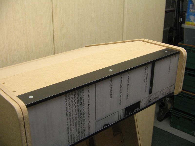

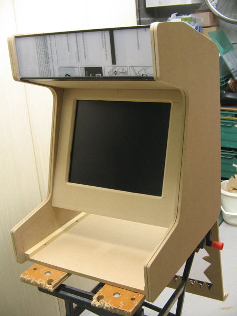

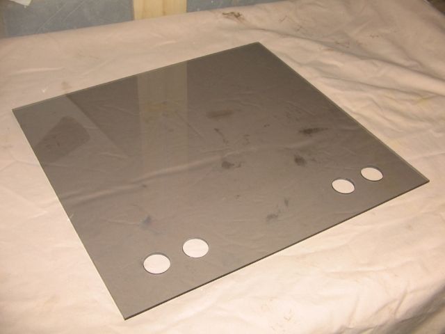

screen and bezel added;
jahilton2002
  • Posts: 308

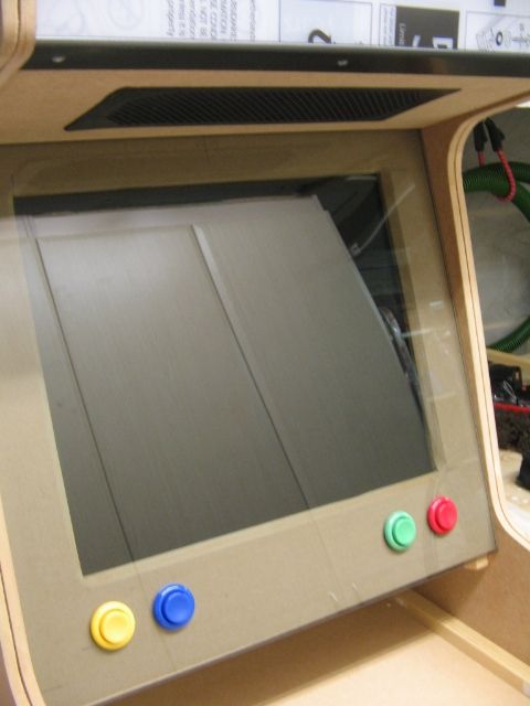

« Reply #25 on: February 01, 2013, 04:40:11 pm »

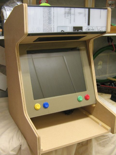

Added Glass and trial fitted buttons.....;

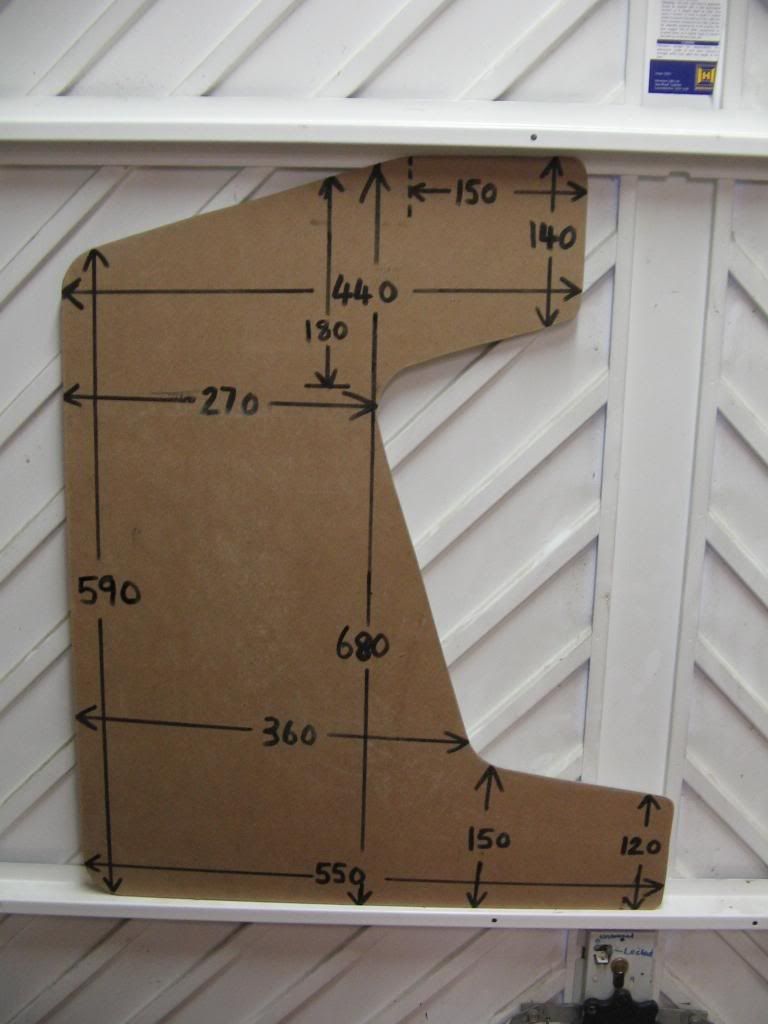

how about some pictures that show the side better, the dimension please!  looks great!! :applaud:
I have all the material to build my own bartop, but time and a good design were holding me back. love the shape of your bartop, just need a better picture from the side please.

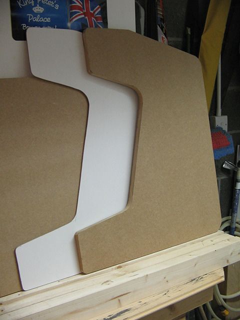

« Reply #39 on: April 06, 2013, 04:58:37 pm »

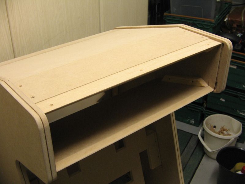

Side profile and dimensions.
we might keep this for a while as we hope to do as display stand at an upcoming expo event..... if we have enough interest we'd like to go into production...... but it will most likely just be bare bones cabs (excluding pc hardware).
at the moment we are just testing and prototyping really...... the cabs will tend to be custom-offs with some sort of theme.
« Last Edit: April 07, 2013, 03:28:21 pm by jahilton2002 »
