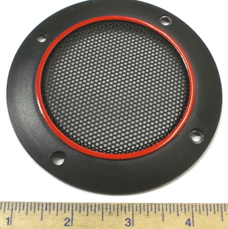

Finally found some small speaker grills here:
http://www.electronicplus.com/images/products/RBR-3SD.jpg
Will be painting the red ring black...
Cheers!
Cheers!
I've attached a couple pics of what the cab looks like with the aforementioned speaker grills installed.
