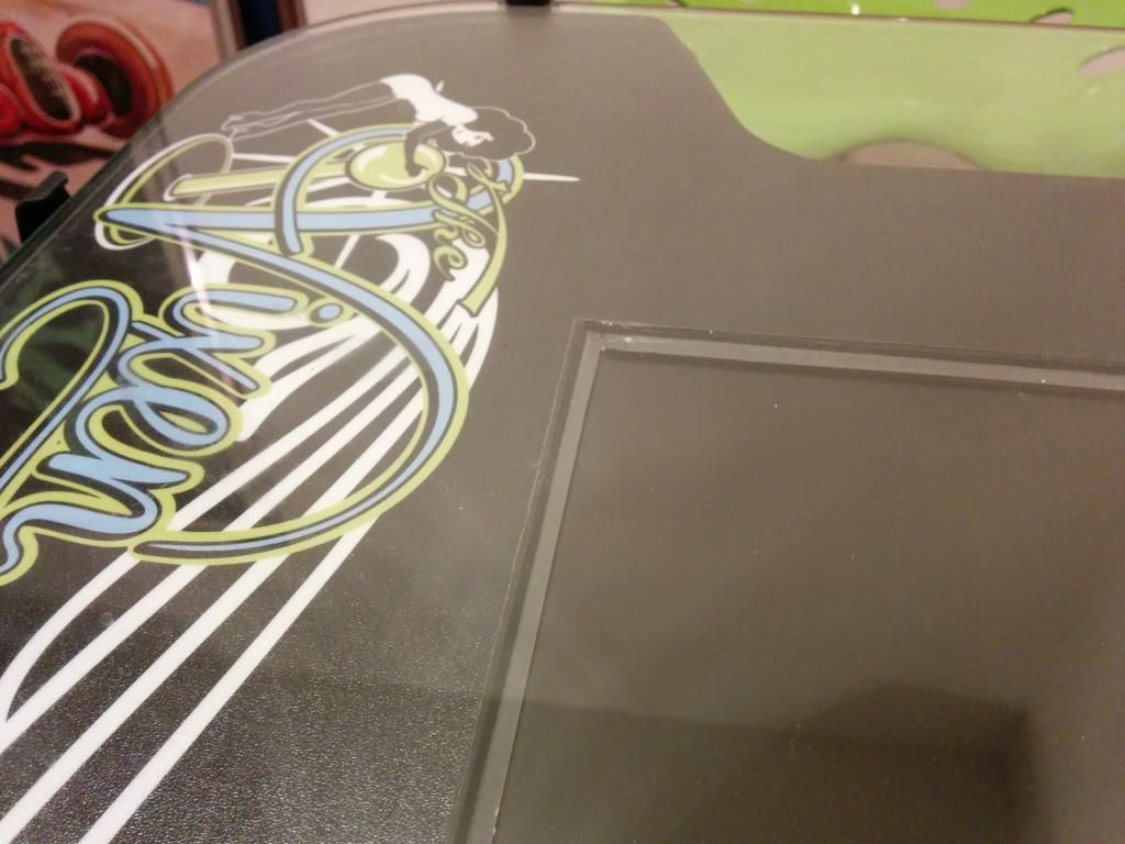

Just an update.  Remounted my monitor recently and wanted to share some pics.  The monitor used to sit 5/8"+ from the glass.  I decased the monitor and routed out the top so it now sits less than 1/4" from the glass. Huge improvement.  The cab has been great over the years and not much else has been done.
I can't keep the kitchen clean, why would you expect it to be clean in here?
