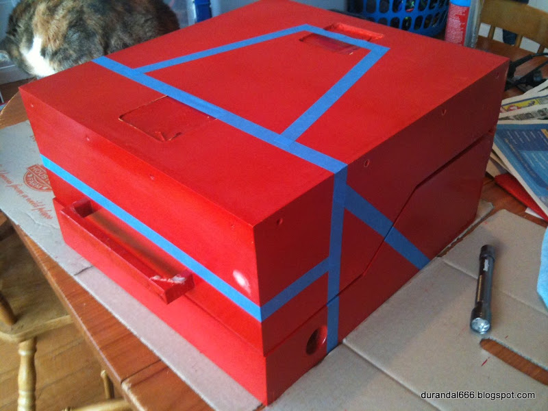

Bit of an update.
Done pretty much all the spray painting I'm gonna do for now. This sucker's got  4 cans of red on, and just finished the clear top coat
Spraying indoors really isn't an option, and the elements seem to be conspiring against me. Check out my comedy wind/rain breaker I slapped together!

Got my plexi and cp/marquee art coming in the post (hopefully next few days)
Did a quick paint job with masking tape to get a rough idea how cp will look.
I was planning on using some old Happ joysticks and buttons i had from very early control panel/box builds. (which will never posted here!)
However, I have recently discovered the heavenly joys that are Sanwa, so am ordering some more sticks and buttons this week
The 2 JFL balltops and buttons are from another project I'm working on, and just used them for testing, however I really like the look and think the colours work.
Any thoughts?
