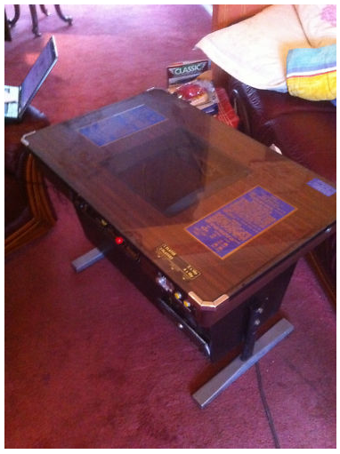

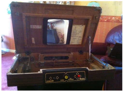

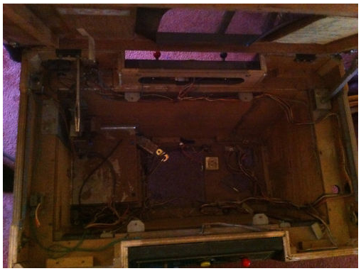

Got it home, stripped out the busted coin mech, coin box, old wiring and service switches - didn't find a penny ;)

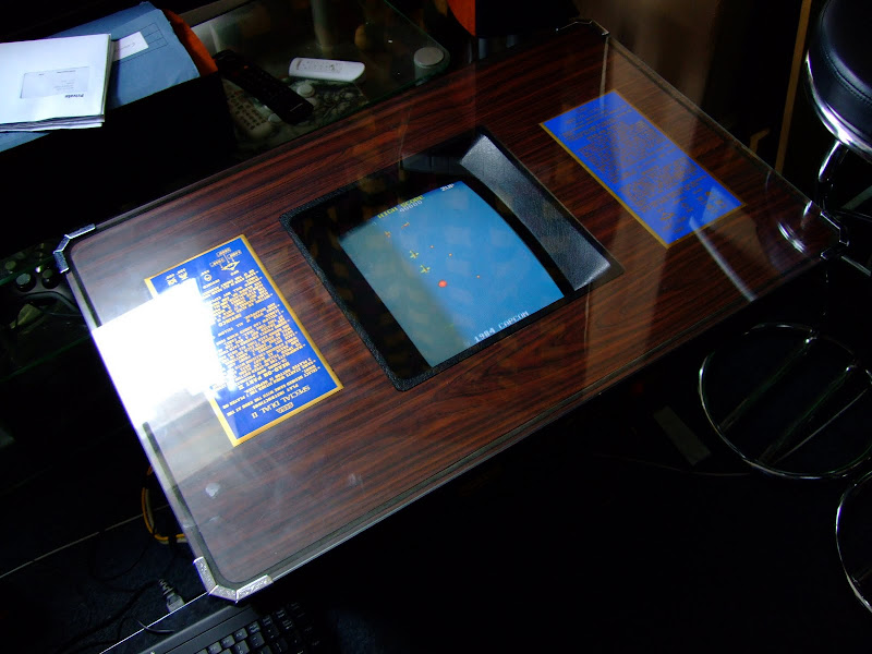

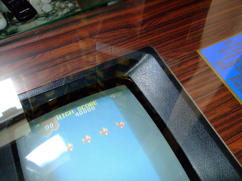

I have decased and dry mounted a panasonic 14" scart (rgb) TV and have it running via soft15k
TV is an almost perfect fit for the bezel and looks great!
Monitor needs to be raised about 1" to sit flush with the bezel.
Almost everything has fallen into place pretty easily, cant see any major issues with this project.
The only thing I'm not certain of is the control panels, at the moment there are 2 joysticks per player a 2way horizontal on the left, single fire button and a 4 way on the right.
I definitely want an 8 way on there and 3 fire buttons... need to have a think.

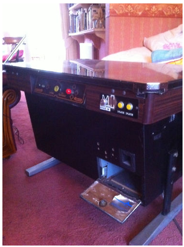

Hi, I was very happy with the overall condition for the price.

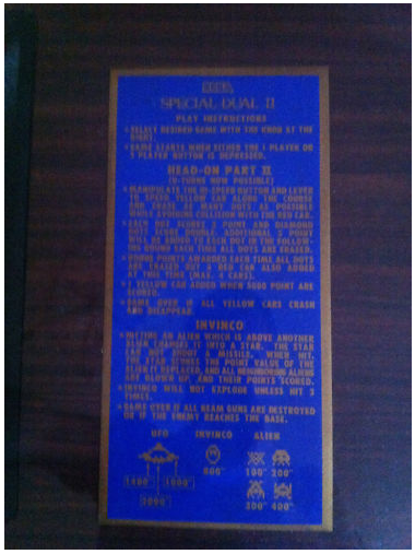

The cab is a Sega Special Dual 2 - a twin game system with Head On Part II + Invinco, manufactured in 1979, original controls had a 4 way stick for Head on and a 2 way for Invinco, sharing a single fire button.
As for design, its a typical UK cocktail in my eyes.  Circa 1980 this style of machine was everywhere I went, pubs, clubs, seaside arcades etc.

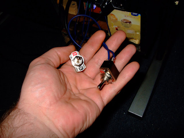

Old coin box door will become an admin panel, complete with lock (volume, gamelist management buttons etc)
volume dial sits there alone at the moment
This open area at the top next to the monitor will house a mouse, keyboard and remote control for the TV
Other side houses the PC
Speakers, air intake, harddrive mounted to the floor, chassis mounted to the wall
Power supply mounted to the inspection door
Innards

Panasonic 14" tv running at 15khz, driven by groovymame @ correct refresh speeds

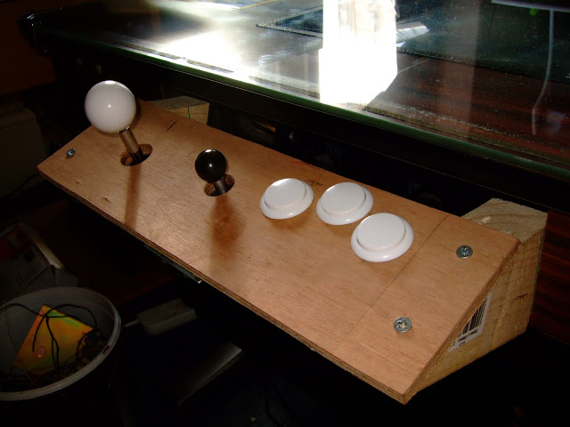

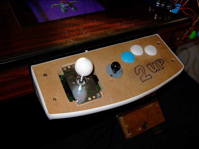

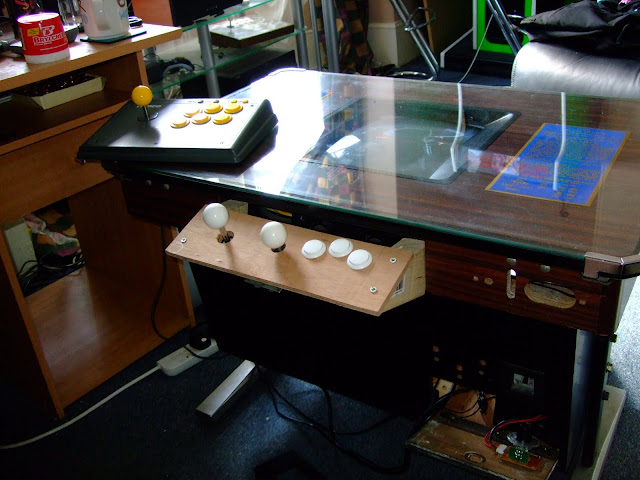

Out of the various prototype CP's this is about the most comfortable and workable.
Sanwa JLF, Sega 4 way, Sanwa buttons
I don't have it wired atm, but it feels pretty good blind playing.
I might use the original Sega ball tops for the 4 way, sanwa top in pic for comparisson.
I will set about building a couple of these next, moving the panel down about 10mm and in towards the cab about 25mm.
« Last Edit: June 25, 2011, 11:55:39 am by jimmy2x2x »

Just gotta ask...is a second joystick really necessary? I know having the dedicated 4-way is great for authenticity, and the 8-way is great for versatility, but having both always seems crowded.
jimmy2x2x
  • Posts: 1215
Re: Treasure Chest - Cocktail conversion
« Reply #20 on: June 25, 2011, 01:51:36 pm »
Its a good question and something I have been toiling over for a while, looks wise I can use the smaller balltop to minimize the impact of the 4 way, like this:
and for function I will map the 4 way and 8 way to different inputs so I you nudge the other stick it won't affect the game in progress.
For the game selection I have in this cab, I really need both - I still get stuck on diagonals playing mspacman with an 8 way, and a 4 way only cab is too limiting for my tastes.
Another huge factor for me is finances - I am really on a shoestring at the moment and I happen to have this hardware on hand.
I would like to explore some of the fancy u360 or similar sticks, but I can't afford to buy them if I am not certain they will be right for me.
I built this panel for my upright last year and was sure I wouldn't need a dedicated 4 way, big mistake on my part - so I want to make sure this cab can play a decent game of mspacman ;)
« Last Edit: June 25, 2011, 02:14:16 pm by jimmy2x2x »

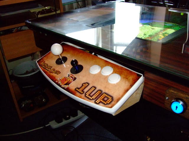

« Reply #25 on: July 03, 2011, 11:21:28 am »

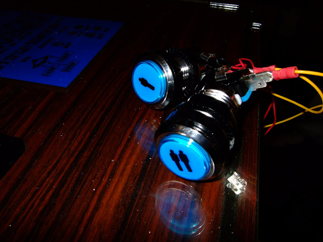

Made the coin/1 player / 2 player panel today
started with american white oak
cut out the front (already stained from here...)
and back
with buttons and bolts
another layer of stain tomorrow, then varnishing and its done.

Control panel shaped, plexi installed, t moulding installed
Illuminated player select buttons
Coin mech installed, complete with makeshift coin box and rough filling of existing holes!
Lots to do...

This is looking great! Love the neat controls panels. For the joysticks instead of mapping them to all separate inputs you could just wire the earth through a toggle switch which you could hide somewhere (underneath perhaps). I've done this on two of my projects. Just flick the switch for 4-way or 8-way. When one is selected the earth for the other is disconnected so it cannot affect gameplay if it's knocked by accident. It would save you having to mess with setups in Mame between 4-way and 8-way. It may be possible with a .ini file I'm not sure. I'm sure someone else could explain if it is.

Cheers, that is certainly an option.  Having to use one of two sticks is always a problem.
I will have a play around with it.

Another little in progress update
Think this will be the final front end layout, many thanks to forum user Sjaak for the sparkle animation ;)
Instruction card artwork installed
CP art installed
Switches fitted (1 for disabling quit game function, 1 for disabling coin reject for credit - forcing coin operation only)
Shot of cab as it stands
Hoping! to get it all finished for next weekend.
