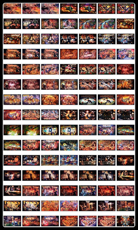

« Reply #134 on: July 14, 2010, 08:52:35 am »
I have taken highres backglass pics via tripod with my 10megapixel cam of original running pinball machines (2560res, 6mb each).
check out the preview pic... more to come soon...
You can download each backglass at
===> http://www.mediafire.com/backglasses <===
Available so far:
Attack From Mars
Black Knight
Black Knight 2000
Creature From The Black Lagoon
Congo
Cirqus Voltaire
Earthshaker
Elvira And The Pary Monsters
Elvis
Fathom
FunHouse
Flintstones
Fish Tales
Gilligans Island
Gorgar
Guns N' Roses
Indiana Jones
Jack Bot
Jungle Lord
Monster Bash
Medieval Madness
Monopoly
NBA Fastbreak
No Fear
Pinball Magic
Pin Bot
Revenge From Mars
Ripleys Believe It Or Not
Road Show
Rollercoaster Tycoon
Spiderman Black
Scared Stiff
Star Trek TNG
Super Mario Bros
Star Wars Data East
Terminator II
The Addams Family
Taxi
Theatre Of Magic
Tommy
Tales Of The Arabian Nights
Twilight Zone
World Cup Soccer
Whirlwind
White Water
Xenon
stay tuned! ;)

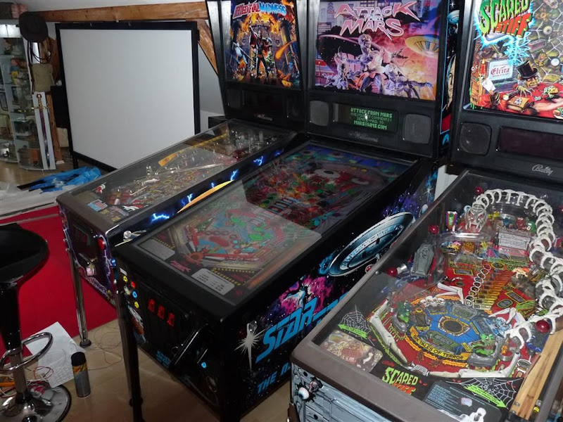

Re: 46" / 30" / 19" widebody fullscreen visual pinball project
« Reply #139 on: July 19, 2010, 10:08:04 am »
can you possibly do a side by side picture of MM and your Vpin running MM ? I know how deceptively real the vpin looks but what better thing to compare it to then an actual pin? Plus I think it'd be a neato picture.
chris77
  • Posts: 184
  • Instant C
    • visual pinball
« Reply #140 on: July 19, 2010, 11:00:24 am »
here we go ;)
cheers
chris
