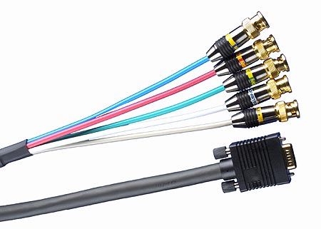

does that tv have r/g/b/h/v BNC inputs?
if so, planning to use a bnc break out cable like this?
will probably yield you the best results
ps im very jealous u managed to pick up a cube video monitor.  :)
i was looking for one for quite some time, found a pvm-2950 from a video editor friend that was kept around as a spare (low hours) but it seemed a bit too big for my blitz cab :(

It has plenty of options, as seen in the picture, I was planning on using the DB9 for my RGB with a vga to db9 converter, running soft15 found in software section here on the boards.

oh wow!  nice.
