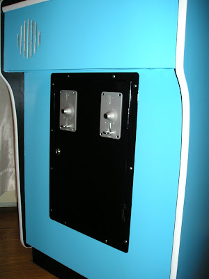

Oh yeah - here is a shot showing what I had to do to get the monitor to fit:
The purple outline is where the original mounting bracket was and it would have been sticking out of the back if we didn't remove it.  I'm like MacGyver or something.

You were certainly lucky to not just have Dad around...but Mom as well. I can only imagine the catatastrophe that may have been had you attempted this alone or just with Dad...
Where the electrical is secured, I am assuming you still have adequate clearance for the back panel?  It looks like just a 1/8" or so at the top right corner.

Thanks!  I was lucky that they were both able to help out - it basically killed their entire weekend but we got to spend time together which is always nice.  I honestly don't think I could have done this without them.  I am scared to death of electricity and exposed monitors so I didn't feel comfortable moving the monitor around and I especially didn't like the idea of modding it.
My dad had no fear and thought I was overreacting but I got on him pretty good a couple of times for not being careful enough around the suction cup thing and the exposed wires (the monitor hadn't been turned on in well over a month so I was pretty sure there was no charge left but you never know).  We spent all this time on the monitor mount and we didn't even know whether it would power on!
There is plenty of room for the back panel - the studs are about 1" in from the back edge leaving about 1/2" of space plus the thickness of the back door.   :cheers:

That mounting is very nice, but be aware that as heat travels upward, the lifespan of the monitor's chassis will be shortened if it's not mounted horizontally.

Thanks guys.  Hmmm... that's the first time I've heard about potential heat issues by mounting the monitor chassis against the side panel.  Hopefully the monitor will last a long time - good thing it is not glued in place and can be replaced if necessary.
Anyway, now that the monitor is in place I guess I can show off what it looks like from the front!
It looks great!   All of that hard work paid off.  :cheers:

OK, I probably won't have time to test the software for a few days at least but I can continue with the build.  I want to completely finish everything before messing around with the computer otherwise I'll never finish.
Next up - the coin door.  It was the one thing I didn't feel comfortable restoring myself. I could have taken a can of spray paint to it but I didn't want to risk ruining it. As far as I know there aren't any vendors out there selling Nintendo coin door reproductions which means there is a finite number of these things out there to be had. I was lucky - mine came with the cabinet and was in pretty good shape. No major dents or scratches.
As you can see the door had started to rust in several spots and the paint was bubbling all over the place. A local custom motorcycle shop has powdercoating capabilities so had them refinish it for me (as well as the bottom marquee retainer). It came out very nice and way better than if I had attempted to do this myself.
I ordered some #6-32 carriage bolts from Quarter Arcade to secure the door to the cabinet and they fit perfectly. I had to order 2 sets though since I needed 12 for the door and they only sold them in packs of 10. I also bought a $4 lock from Home Depot. Here's what it looks like installed:
I'm not sure why - maybe it was the lighting or the sweet finish on the door - but I can't seem to get a good picture of it. The door looks brand new and I couldn't be happier with the result.

And here it is - all installed and looking brand new:
The side art is next...   :banghead:
