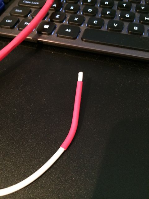

As did some heat shrink tubing to cover the wire hangers for the wall rack:

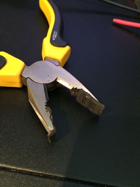

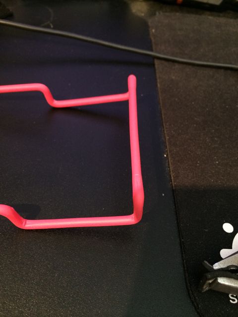

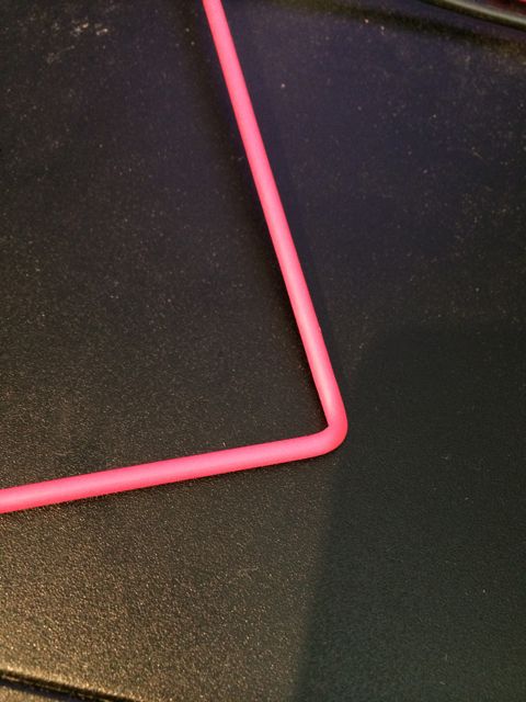

Started on the wall rack. Cut the backing board:
Put the heat shrink tubing on:
Bent it using pliers and craft foam to protect the tubing:
One headphone hanger:

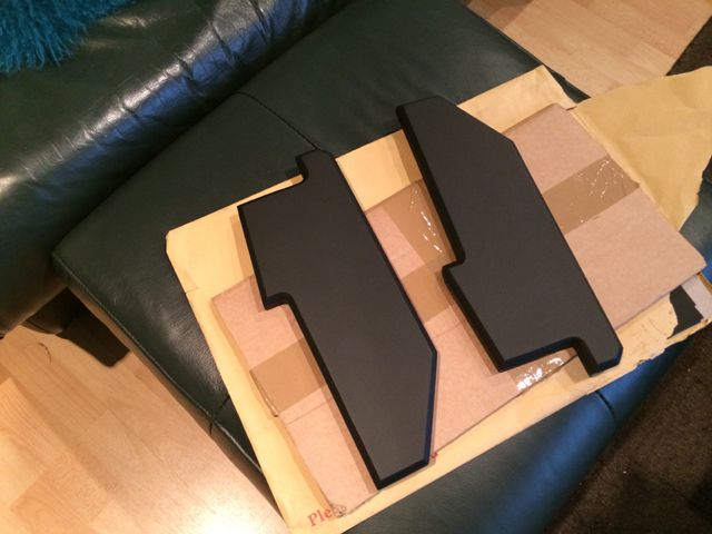

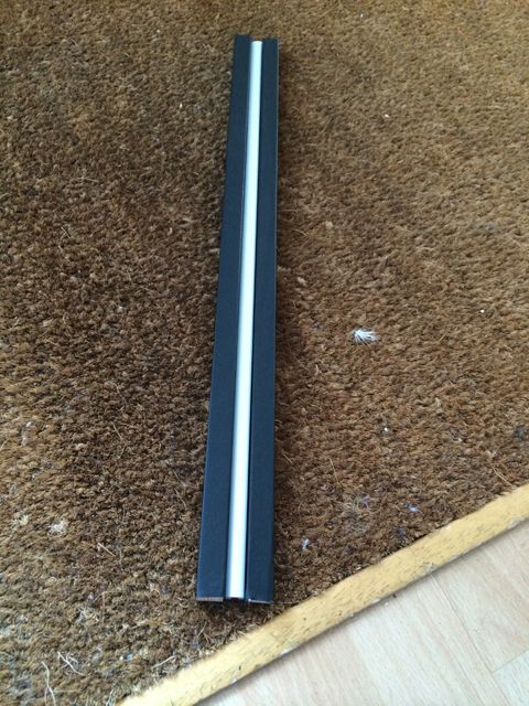

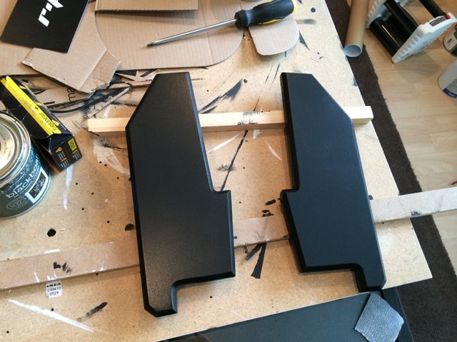

« Reply #323 on: May 31, 2014, 03:37:38 pm »
Filled, primed and applied 2 coats of flat black to the monitor sides:
Also fitted an aluminium bar to the lower section of the hood:

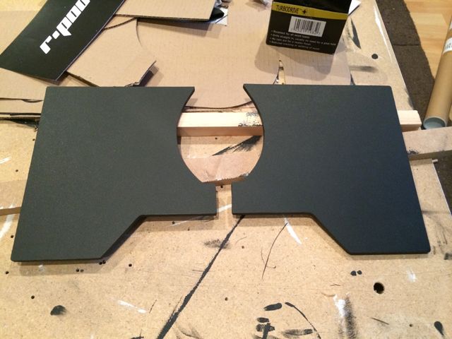

« Reply #324 on: June 01, 2014, 05:56:13 am »
 I'm making  panel with - yes you guessed it, an aluminium insert to sit under the wheel base:
The wood will be vinyl'd

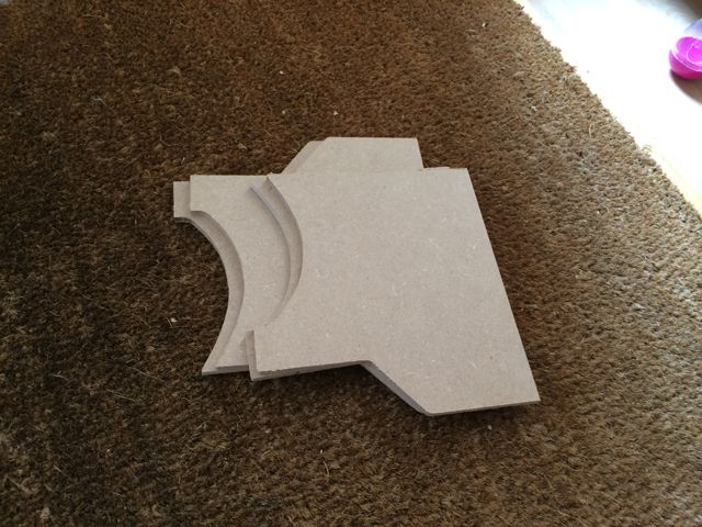

« Reply #326 on: June 01, 2014, 07:52:25 am »

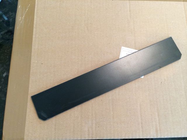

Cut some more dash panels - I'll likely modify the layout at some point in the future (Symprojects instrument gauges):

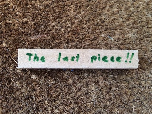

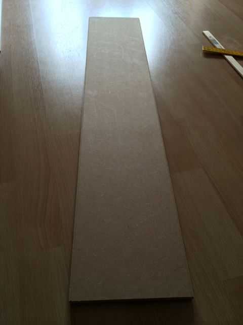

Guess what this is:
Click a pic for a video tour
ChanceKJ
  • Posts: 3229
Re: R-Pod MkII Racing Simulator, Vewlix style : Phase 6 - Accessories
« Reply #328 on: June 01, 2014, 11:41:15 am »
Wood?
SpaceHedgehog
  • Posts: 937
  • Almost done ...
« Reply #329 on: June 01, 2014, 11:43:06 am »
Yes ...
Hurrah
ChanceKJ
  • Posts: 3229
« Reply #330 on: June 01, 2014, 11:53:50 am »
Why isn't it milled all nice and fancy?  :(
Pretty anticlimactic.

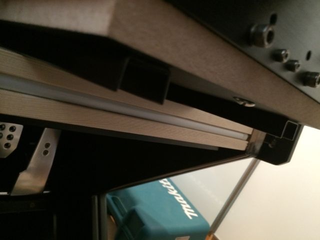

Here's the dashboard strip I made earlier now in-place:
The last piece is under the wheel shelf, waiting patiently to be sanded down. My wife likes the last piece because that means I can start clearing the house ...

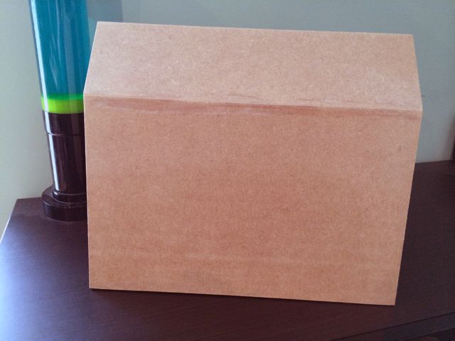

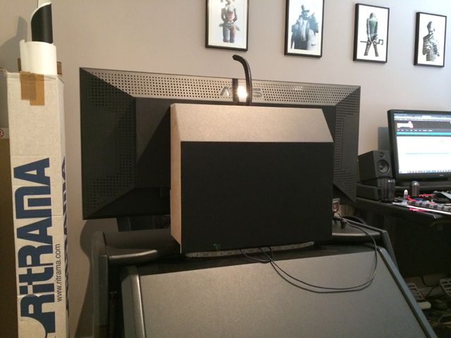

The back of the monitor hood is complete, just a blanking plate visible from the front to cover. Also just finished up with the initial prep for the dash panels. I've filled, sanded and painted the outer edges so everything is clean. These are covered with vinyl but will have the carbon fibre set in from the edge to make the effect more interesting (besides which, the sheet of carbon fibre is 1/2 cm too short to cover both panels):
A couple of bad pictures due to the lighting:
Front view of the monitor hood/blanking plate:

Compressable high density foam has been used to secure the monitor hood. This sits between the monitor posts and the inside of the hood. It provides a great deal of resistance to avoid the hood being accidentally knocked off. There's no chance that will happen now.
Hood in place:

Very impressive hood. :cheers: There's some weird, black sausage sticking up from it though.  :lol
I've gone for the Dipsy look :

I've been waiting for some 2mm plastic card to come and it's arrived. I've used this to create a blanking plate for the front of the wheel stem:
Cut to shape:
Covered (air bubble has since been removed):
Attached:

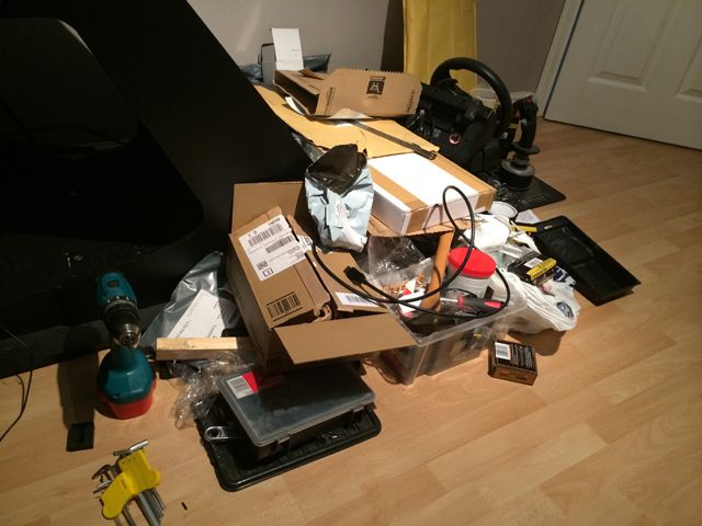

Now for some real progress :)
During the build, my room had deteriorated into this:
After 6 hours of serious tidying and organising, I managed to turn it into something habitable:
I can now relax a little and walk across the room.
