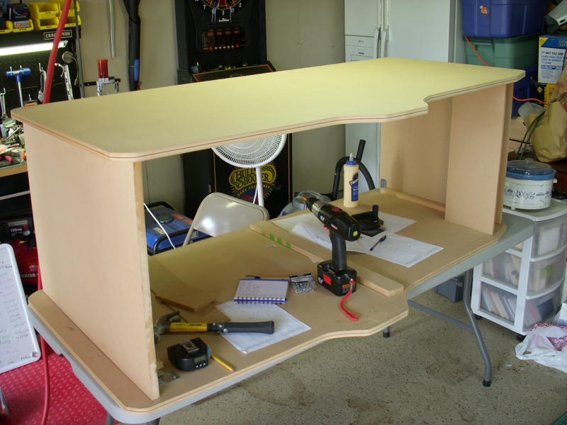

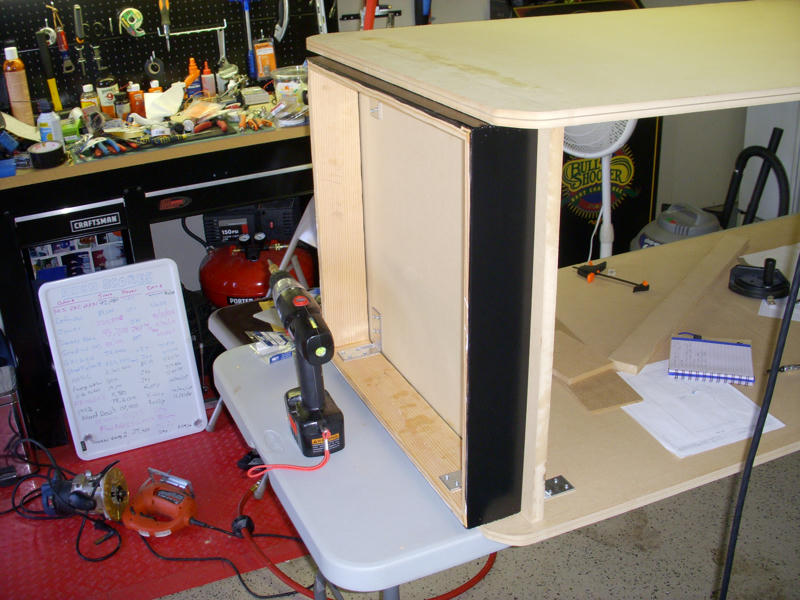

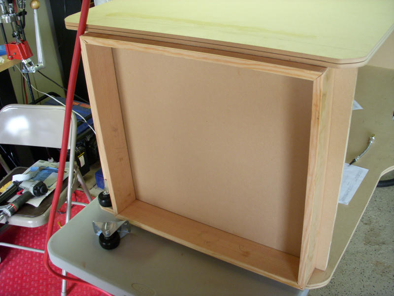

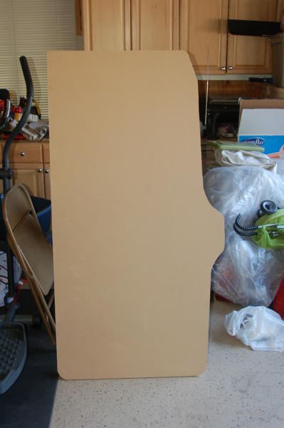

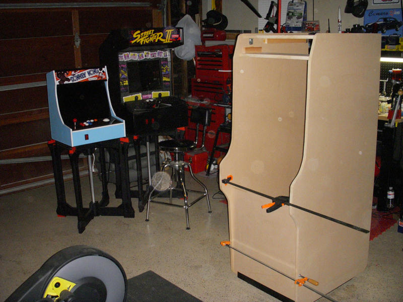

I started on my third cab a few days ago. Some of you may recall I just finished a Donkey Kong themed bartop a few weeks ago (http://forum.arcadecontrols.com/index.php?topic=95934.0).
Well, I had a gallon of blue Donkey Kong paint laying around, so I figured what the hell…let’s scratch build a full size DK cabinet.
Now, before everyone gets all heated over this…let me be clear…my skills are limited! So, I will do my best to make this thing look as close to real as possible, but based on my talents, and the fact that no one that will ever see if will ever know if it looks like a real DK or not (other than you folks!), I am just going to try and have fun with this. I got the plans from Jakobud and am trying to remain faithful to original dimensions where I can…but if I’m off a ¼” here and an 1/8” there….that is ok with me. I have seen some sick restores and scratch builds posted here and elsewhere and I commend any of you folks that have done that work because it takes some real skill to pull it off!
Ok…so this will be a MAME cab of course, with two player controls, six buttons each. I have the Mini-Pac, Sanwa ball top sticks, and buttons coming in this week. I am also going to add a Happ coin door and will rig it up to function off quarters (just because it sounds fun). Just won that on ebay and hope to see it by the end of this week as well. Once the cab is built I will order my art from mamemarquees.com and then begin paint.
I am still debating on the monitor. I usually use a 19” dell Ultrasharp LCD, but the size of this cab is begging for something a little bigger. I refuse to use a CRT due to weight and such…so maybe I will just get a 20” LCD for now.
Here are some pics of where I started and how far along I am so far:

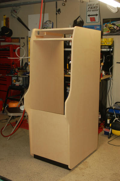

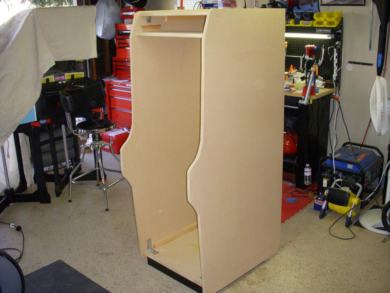

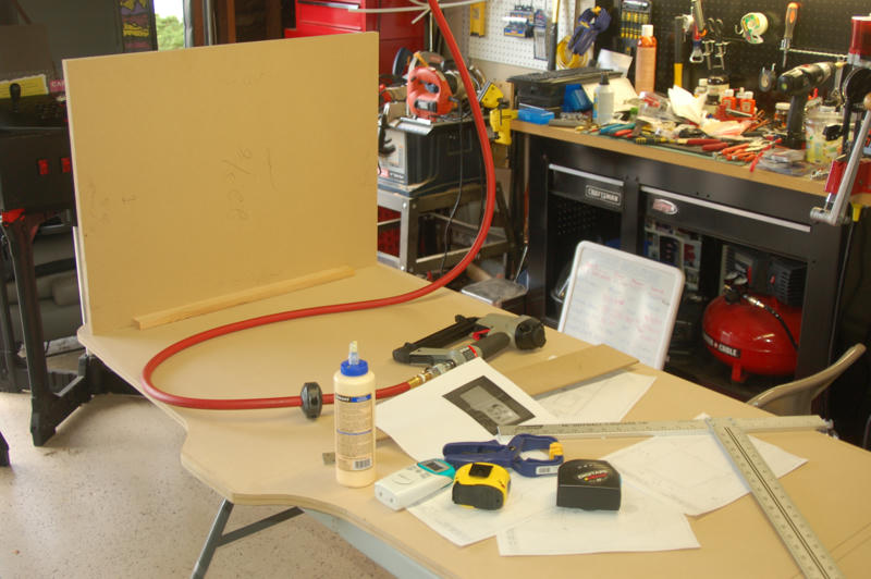

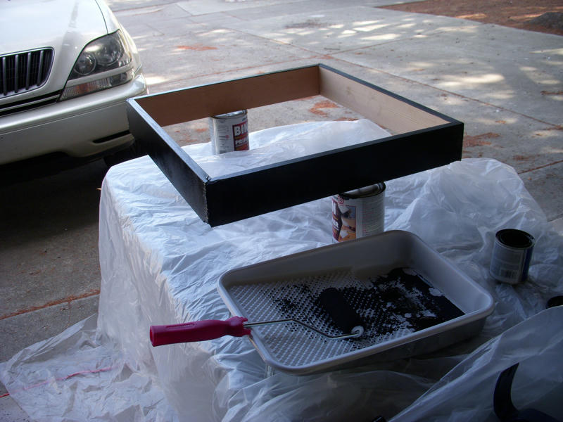

Side cut out of 3/4” MDF:
Attaching the bottom:
Attaching the left side:
Test fitting the base and casters:
Painting the base:
Base attached:
On her feet for the first time:
Test fitting the front panel…soon to be cut out for the coin door. Also you can see my other two cabs in the background:
And here is where I’m at today:
Coin door cutout is next, then front panel (with slots for speaker) and CP are next up.
Will try to keep putting updates out as I move along.
Jason

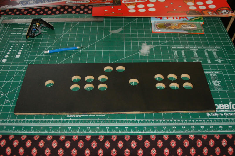

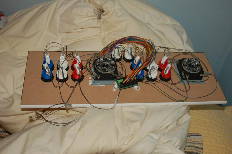

I just cut my CP out of 1/2" MDF. I am thinking of going 1/2" MDF with 1/4" of plexi on top (and artwork sandwiched between).
The question is....if I use 1/2" MDF plus 1/4" Plexi (for a 3/4" thick CP), and router my t-moulding groove dead center of the sandwiched pieces, will the 3/4" T-moulding I am using for the sides of the cab have a flush fit/look?
On my last cab I just routed the 1/2" MDF and used 1/2" T moulding, and then 1/8" plexi on top. The plexi edge is showing (i.e. the t-moulding doesn't cover it).
Will the plan I mentioned above work out or should I just leave the exposed plexi edge?
Hope I am making sense here.
Thanks
J

« Reply #7 on: September 15, 2009, 07:32:57 pm »
thats how i did my control panel..only i used 5/8" MDF and 1/8" plexi, 3/4" tmolding worked great

The t-molding is 9/16" all the way around - for my CP I went with 1/2" MDF + 1/16" ABS black plastic.  Worked great.
You are really doing a great job so far!   :cheers:
maybe on a real DK...but he made this one out of 3/4" MDF for the sides...so he will need larger t molding

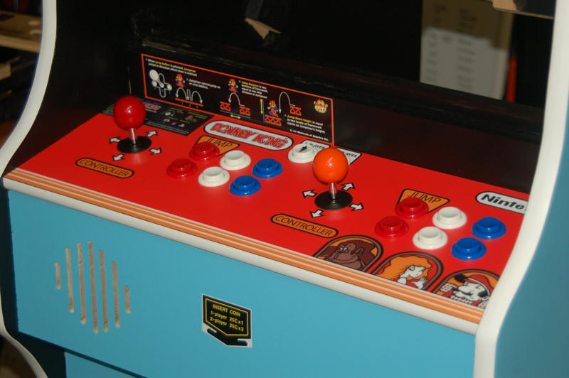

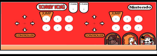

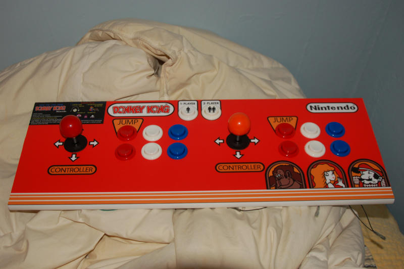

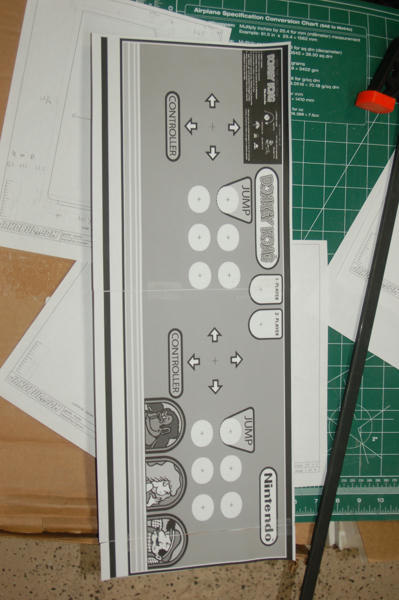

I cut my CP out yesterday and printed a black and white sample of the overlay I am considering (photo attached). I stole the art from an earlier thread on this site so thanks to the OP that provided it the first time.
I am happy with the layout and I think there is enough room for some comfortable two player play (CP width is 22 1/4").
I am considering removing the black instruction card that is in the upper left corner. I removed it with MS Paint (see attached color photo) but now the area in the upper left is sort of bare.
Any suggestions for what I can put there? Maybe another Nintendo Logo?  I thought maybe I could put some admin buttons (pause and escape) but what I originally was planning was hide those admin buttons underneath the speaker grill section (on the 2 1/2" piece that joins the front panel and the speaker panel).
I am interested in your opinions on this...
Why not leave it for appearance and just change the content to match your own requirements? That way you make it look that much more authentic but still have it meet your unique requirements.

The problem I am having is that when I print the artwork out to my scale the content of the black instruction section in the upper left is not legible. I used this same artwork for my bartop and you can't read what the instructions say.
I figured on this new cab I would just remove it all together.
Maybe the problem is that I am not printing it to a high enough quality. On my bartop I just had kinkos print the artwork out for me. Maybe if I send the file off to mamemarquees.com and they print it, the instruction card will be legible...
I'm just not sure and don't want to spend $20 to $30 to have it printed and find out it still doesn't look good!   ???

Good point although it's probably only the resolution of the original image...im sure a re-scanned/better capture would be fine but your statement is correct and if you prefer the aesthetics without the image then just stick with that :)

Honestly, if I were you I'd do a complete redesign of the CP art instead of trying to shoehorn bits from the original into a 2 player 6-button layout which was never intended.  You could keep the colors and even the style but I would do more than just rearrange existing graphics.  With Photoshop you are only limited by your imagination - for example, you could actually make the three characters in the lower right much larger but sort of transparent and overlapping the button holes... I don't know.
The art is probably the most important part of any cab so I wouldn't rush into anything.  There are a lot of talented people in the artwork forum - maybe ask around there?   :cheers:

i have the control panel overlay, and instruction cards in high quality PDF format if that would help you...see attached.  I'm sure there are some good vector versions around too...
i agree with Javeryh..since you arent sticking with the original controls, dont limit yourself with the artwork.  i just started working on making a new instruction card for mine...i want to keep the controls panel original, but i think  i am going to make a custom instruction card to explain how to work everythign on my cab.

Unless there is somebody out there with the exact same idea as me, that is my CPO that I made up.  I have a super high quality copy available in PDF form that is over 9GB that you are more than welcome to.  I got mine printed at MameMarquees, and the card is 100% clear and legible.
Also the extra white line at the bottom is to simulate T-Molding, my CP is metal, and it looked better this way than trying to Glue on real T-Molding, it is the exact same dimensions, so it blends perfectly.  If you give me your measurements, I can resize it to exactly what you need.  Mine is 22 1/4" long as well, and it's a comfortable but snug fit for two players.  As long as you are playing with someone who won't get piffed if you brush shoulders from time to time in the heat of the game.

Chicken McNobody,
Yes...I stole your design. You are THE MAN and your cab is what inspired me to have a full size DK replica but have it run MAME with the 6 button layout!
If you could share the full file with me somehow, I would really appreciate it. I am going to work with Scott at Mamemarquees for my artwork so I would grately appreciate if you could share your CP file with me...then I can just order the marquee, bezel and side art all together from Scott as a package.
My CP dimensions are 8" by 22 1/4". I will be doing T-Moulding so I don't need the same extra white line as you had on your layout.
Thanks so much for offering your help...everyone on this forum is so helpful...it's a great group of guys on here!

I can E-mail it to you, just PM your E-mail address to me, and I should have that all worked up within the next couple of days.
I have a question though.  Since I had the metal control panel, I faked the idea of the original CP with the artwork being slightly smaller than the CP panel itself (hence the black border.)  I wasn't going to do anything involving the top plexi layer.  In other words, the CPO is the entire size of the CP area, rather than it being smaller and resting on top of the black painted piece of wood.
Which way would you prefer to have it sized?  The reason I went with Metal is because the way the guy who started the cab had done it that way.  I could have done wood, but it would have involved tearing apart the inside brackets to move them a little lower for a flush fit.  I was OK with the metal since I could in the end make it look how I wanted.
Maybe some others can chime in here and let me know what the border dimensions should be, or you could figure it out based on your needs.

CPO file sent, let me know if it works out for you. . .
I flattened it as a JPEG rather than send it out as a PDF, since that way it is only almost 4GB Vs. Almost 10GB.  My E-mail is cheap and only allows up to 4GB attachments right now, so I would have send it from a different source if you would prefer the PDF.  But hey, up until about a year ago, the had a 1GB cap, so it is getting better.

I was able to put the back together on my cab today. I did a top piece with handles, a bottom piece, and the door which has a Happ barrel lock with key.
I also bought the smoked lexan for the bezel, but it was to wide and tall to fit in the cab, so I routed a bit off the sides with my flush trim bit.....and now it is not wide enough and I have an ugly gap! So it's back to Tap Plastics tomorrow for yet another bezel.

Quick update:
Monitor has been mounted.
Primer and paint done.
T-moulding applied.
Need to start on the CP. Just received the CP artwork from Scott at Mamemarquees. I hope to have the marquee and side art this week as well.

Got alot of work done today so I thought I'd share some pics.
I managed to get the side art on last night, and today I cut my CP (big thank you to Chciken McNobody for his help on the artwork!), I installed the overlay and all the buttons. I am in the middle of wiring up the mini-pac right now. I also put on a few more of the decals (like the instruction card above the CP and the coin sticker by the speaker grille. Also mounted the marquee today...
Tomorrow I will work on the bezel and hopefully get this thing running by the weekend.
CP prior to overlay install:
Rear of the CP showing the MiniPac and wiring (to be completed):
CP:
Test fitting the CP in the cab:
A shot with the monitor in place. I am using some foamboard to surround the monitor. I will eventually make a bezel to cover the Dell logo and power button on the monitor:
Will post some more shots once I get the bezel in place.
Jason

Looks like the cp image turned out great for you, is everything clean and legible?
Glad I could help with the file.  I won't deny it warms my arcade heart to see my hard work, looking great on somebody elses hard work.

It came out great, the instruction card is 100% clear and ledgible. Thanks again!
