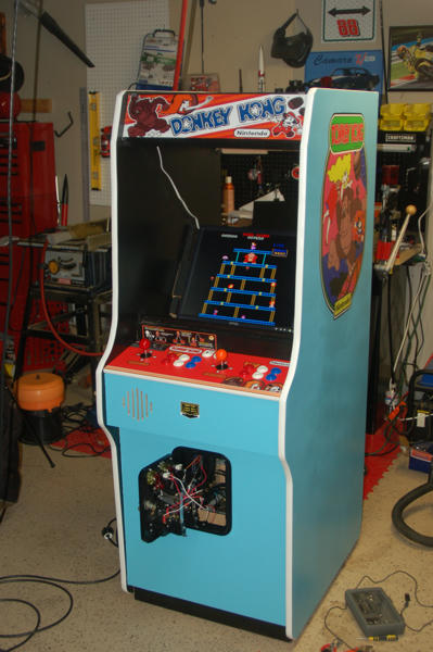

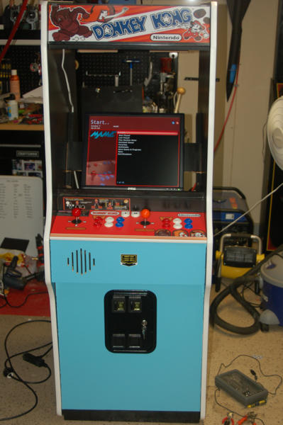

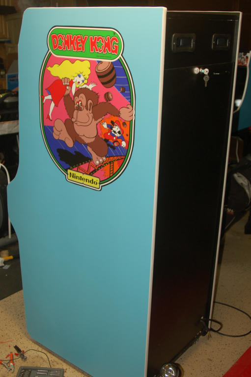

I wanted to post some updated pics.

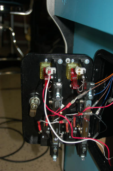

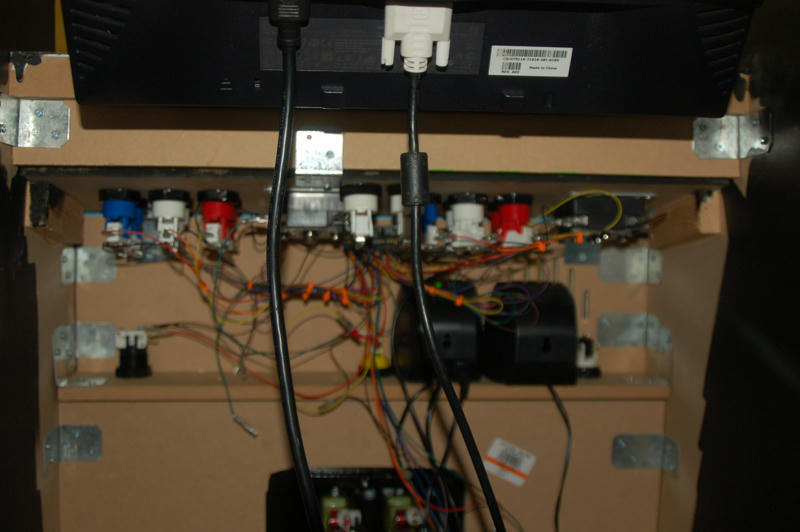

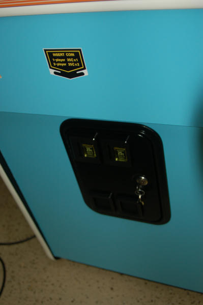

I got the coin door wired up after multiple attemps on both the lighting and the mechs. One mech worked fine, the other didn't. Turns out I did a crappy crimp job on a couple of my wires on the Coin 1 mech. Fixed that then starting messing with the lights.
I didn't understand that daisy chaining the lights had to be done a very specific way. I basically came out of the molex connector on my PSU (12V line) to a wire that I split into two leads...one for each light (12V plus ground). When I fired everything up, the lights worked...but when I shut down the PC, it tripped my GFI on the outlet in the garage.
I rewired the lights so as to properly daisy chain them (12V and ground straight to the 1st light, then out of that connection and into the second light) and all was well.

Here are some updated photos:
Rear shot with the door installed:

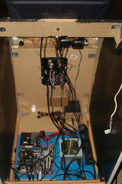

Interior shot (what a mess) with the PC and coin door wiring:
Coin door from the outside:
Back of coin door (prior to fixing my wiring woes):

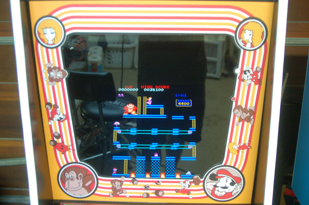

Running some DK. Need to get a bezel around that monitor so it doesn't look so naked:

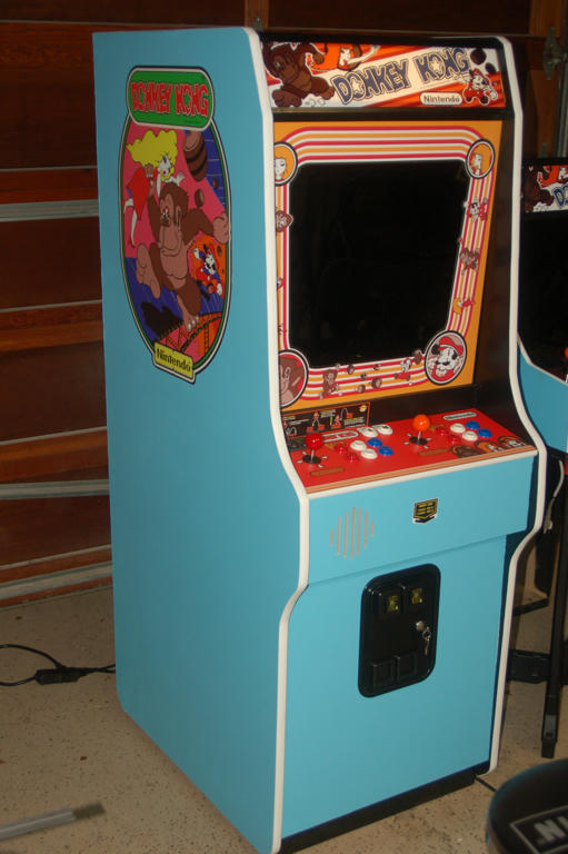

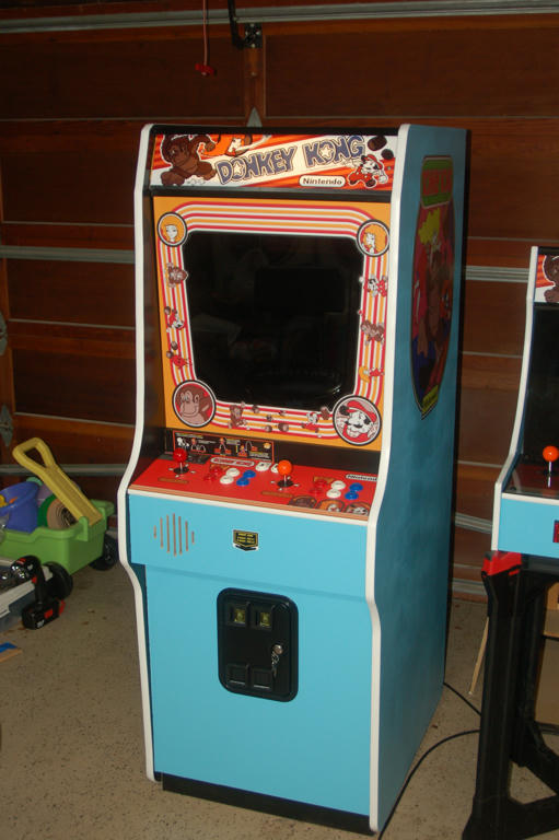

Ok after a long wait for my bezel artwork, my cab is now 99% complete (I say 99% because I have a few upgrades to make like accessible usb ports for my NES and Genesis modified controllers).
Here are some shots now that I have the bezel art in.
The flash on this shot makes the bezel color look faded but it's not...it's very bright....

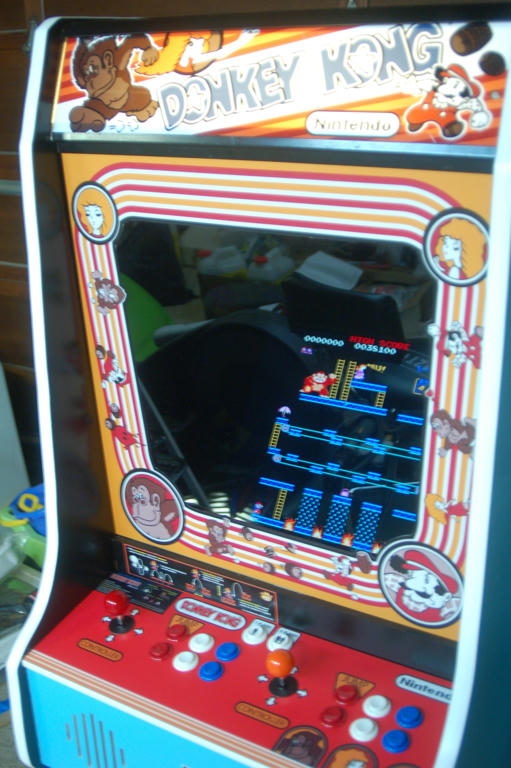

Got a pic of the bartop and fullsize side by side?
Sure, here is a pic....kinda blurry but it gives you an idea of the bartop size vs. the full size cab.
