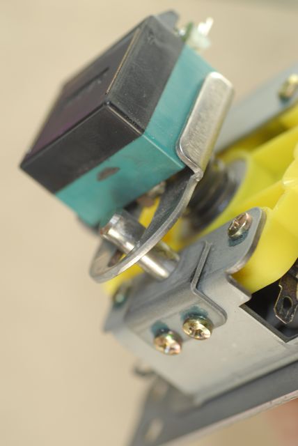

after a very long search I was able to find this very small optical encoder that I think I can get to fit a 9mm U360 shaft, I'll just need a slightly longer shaft
anyone know there to get a longer shaft(Bottom part) that will fit the U360
http://www.usdigital.com/products/e4p/

This is not the best option since its not a self-contained unit. You would need to find a way to locate the stationary part a fixed distance from the optical wheel, at all times. I cant think of a way.
A better option might be the Avago HEDR542X series.
But you would still need to prevent the outer part from turning while still allowing it to move with the stick. Not an easy task.
Andy

Andy,
not sure what you mean by a self contained unit?
it seems like a self contained unit to me
it seems almost mechanically identical to the Avago HEDR542X, what's the difference?
I'm probably missing something really obvious
you just slide the E4P over the shaft
you do need to have a non-spinning part to attach it to
one thing I like about the E4P is that is available in different resoultions, so for example you could get either a 180 or a 360 both of which are divisable by 8 and 12 so you can get an exact match to rotary games that have 8 or 12 positions
the vago HEDR542X is only available with a 200 resolution, only evenly divisable by 8, not by 12 although thats a pretty minor thing

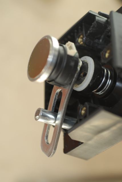

so I'm doing what has already been done with other rotary sticks by using a fixed pin and a collar to go around it, it's used in both happs (mechanical and optical) and the SNK, like this Ikari stick:
U360 with us-digial encoder and fix position pin
I've already got the rotary part working (played both Ikari, and 50 calibre last night without a hitch, even worked as spinner in tron and passable in tempest (I did have to adjust the sensitivity for each game in Mame)
but I'm still working on incorporating the top fire
as I said I got that to work earlier but had to do by preventing the shaft from spinning so that obviously that won't work here, but I'm workin' on it
thanks for the input,
Bender
« Last Edit: April 08, 2008, 02:16:28 pm by Bender »

Looks good!
How are you maintaining the gap between the optical disk and the PCB with the sensor?
Andy
Bender
  • Posts: 1919
Re: Ultimarc U360 hack to add rotary function, *found an encoder*
« Reply #11 on: April 08, 2008, 09:25:11 pm »
Looks good!
Andy
the top half of the encoder housing (the bottom two pieces in the diagram above) is attached to the metal collar, the optical disk is press-fit onto an extension of the joystick shaft, then the bottom part of the housing (top piece in diagram) clips onto the top with the optical wheel in the center.
The optical disc is reflective with black lines printed on it so there is only a sensor on the top, you don't actually need the bottom part of the housing except to keep stuff out

To productionize this would mean getting new chrome-plated shafts made but this is not a great issue since we already have replacement longer shafts being produced so this is just a variant.
The U-shaped brackets were expensive to tool-up so we would need to think about which way to do this, possibly spacers would avoid new tooling.
Either the fixed pillar or the flat slotted plate or both would need to be made from nylon or some plastic as metal-metal contact here would not be good.
Andy
