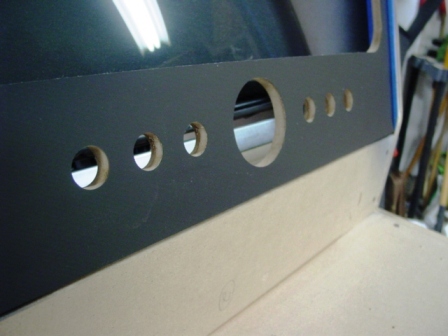

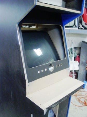

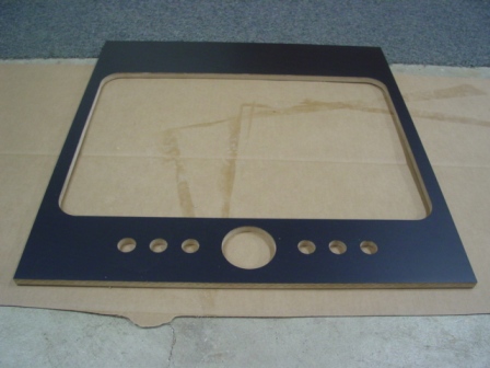

I made up my mind what to do with the monitor bezel ...sort of. I wanted the monitor to have a laid back style because of it's size but I didn't want the cabinet's overall look to reflect it.
This is what I came up with.
The center hole in the above bezel is for the volume and audio controls and indicators. The holes to the left and right are for admin functions but they are not going to be arcade switches. More on that in a later post.

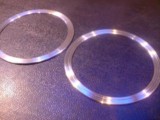

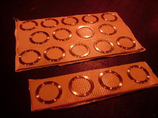

Franco has been kind enough to offer his services to this project. He is by far the nicest and most helpful member I have had the pleasure to work with. He pumps out some incredible stuff at very reasonable rates.
Here is a peek at what Franco has been doing lately.

Excellent looking cab. I really love that bezel. Is that 1/2" MDF or something else?
Charlie Brown: I'm still hoping that yesterday will get better.
mountain
  • Posts: 1205
    • Mountain Jukeboxes
Re: Mountain's Fantasy Cab
« Reply #50 on: June 30, 2008, 06:59:23 am »
You are correct, the bezel is made from 1/2" MDF.

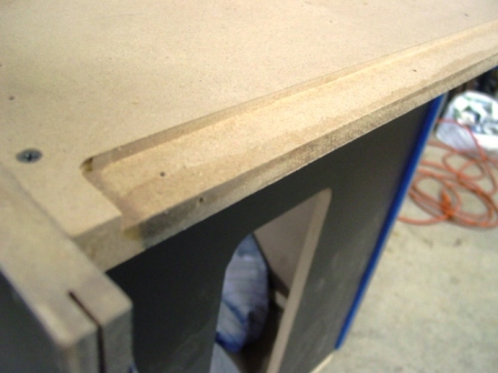

This cabinet has been sitting in my garage, in the way, since I stopped working on it 3 1/2 years ago. Well, I have had the itch to get it done lately so I drug it inside to complete it.
I have redesigned the monitor bezel. Having a CNC now, I can do it a lot better, and a lot faster. Here are the first cuts, still on the table.
I left the center material attached in order to give a nice solid base for the hand routing of a 45 degree bevel around the openings.
The lower opening is for an admin switch panel. Once I finalize the design, I will do the reguired machining for the back side.
I also got the neon lighting installed under the cabinet. It puts a nice glow under the machine.

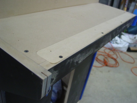

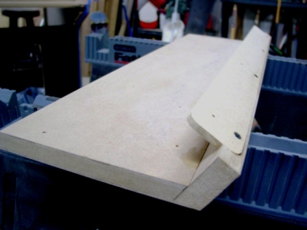

I finally was able to get some work done on the cabinet this weekend. The monitor bezel is done other than final paint and some wiring. There will be backlit lettering below the admin buttons. I made "light pipes" that will take the LED light and evenly distribute it to the text. More on that later.
Here is a shot of the current state of the cabinet. The control panel top is cut and ready for some artwork. The acrylic overlay is done too. The plan is to complete the control panel next weekend and move back to the monitor bezel.

The WG 9200 plastic bezel and custom bezel fitted to the cab.

The admin panel that fits in the opening right below the monitor has been a slow work in progress. I finally got it figured out and snapped some shots.
I machined the basic frame out of 1/4" aluminum.
I am using some proprietary capacitive touch sensors (discontinued product at my work, given to me by my boss) for the control of these functions: Pause, List, Coin, and Exit, as well as the power button. The parts below will go together with the .040" acrylic first, then the art work, paper diffuser, and milled .075" acrylic for the LEDs. The pockets in the acrylic are for the circuit board for the capacitive touch sensors. I have yet install the LEDs in the acrylic, but I'm confident these buttons will be evenly backlit when all together. Otherwise it is on to plan B.
