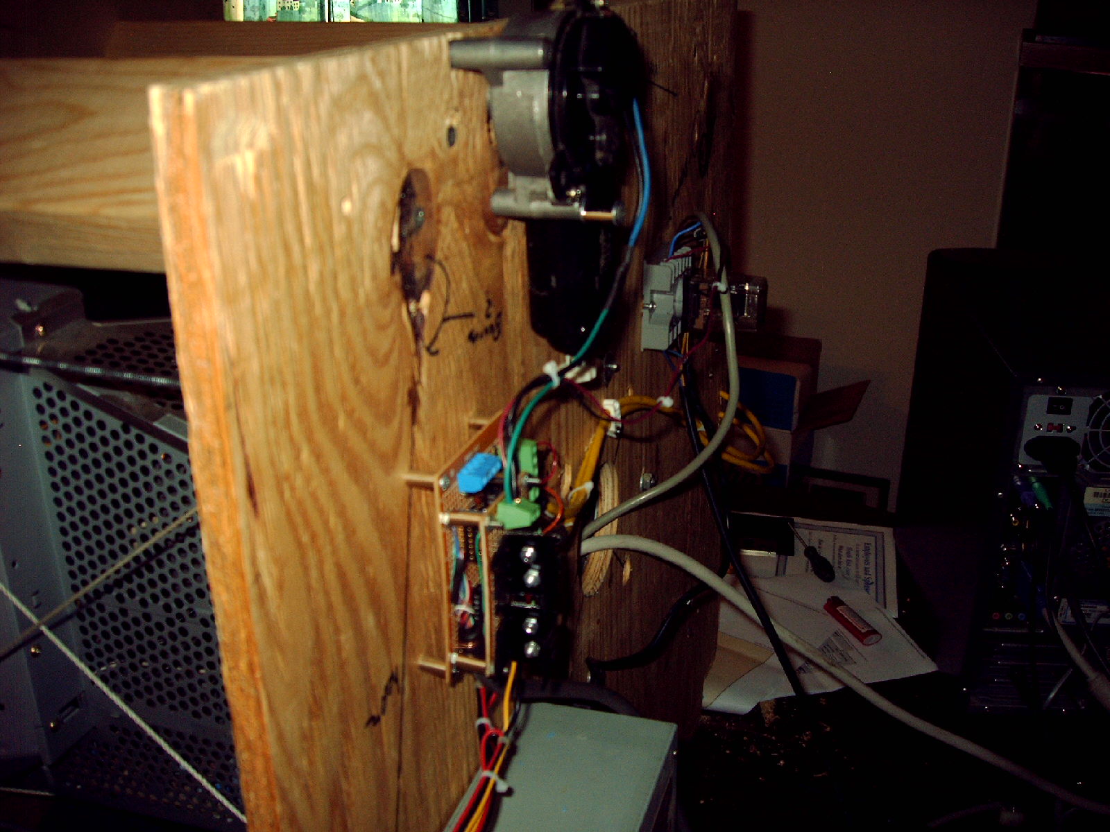

Anyway, I hooked up my isolator board to test a mala plugin for Loadman that he is developing.
I got the fever again. This project must be finished!
I have some time off from work next week, so I plan to cut out the circles of mdf that i plan to mount the monitor to.
I am going to have to rewire my isolator board. I need the inputs powered on all the time so I can use loadman's plugin to start the mala screen rotated with the monitor position on startup.
Still need bearings or rollers. May go with cheap roller skate wheels.

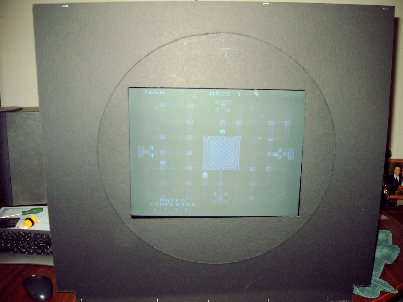

First of all a look at the front, horizontal position.
I dont have plexi glass in front of the screen yet, that is coming.

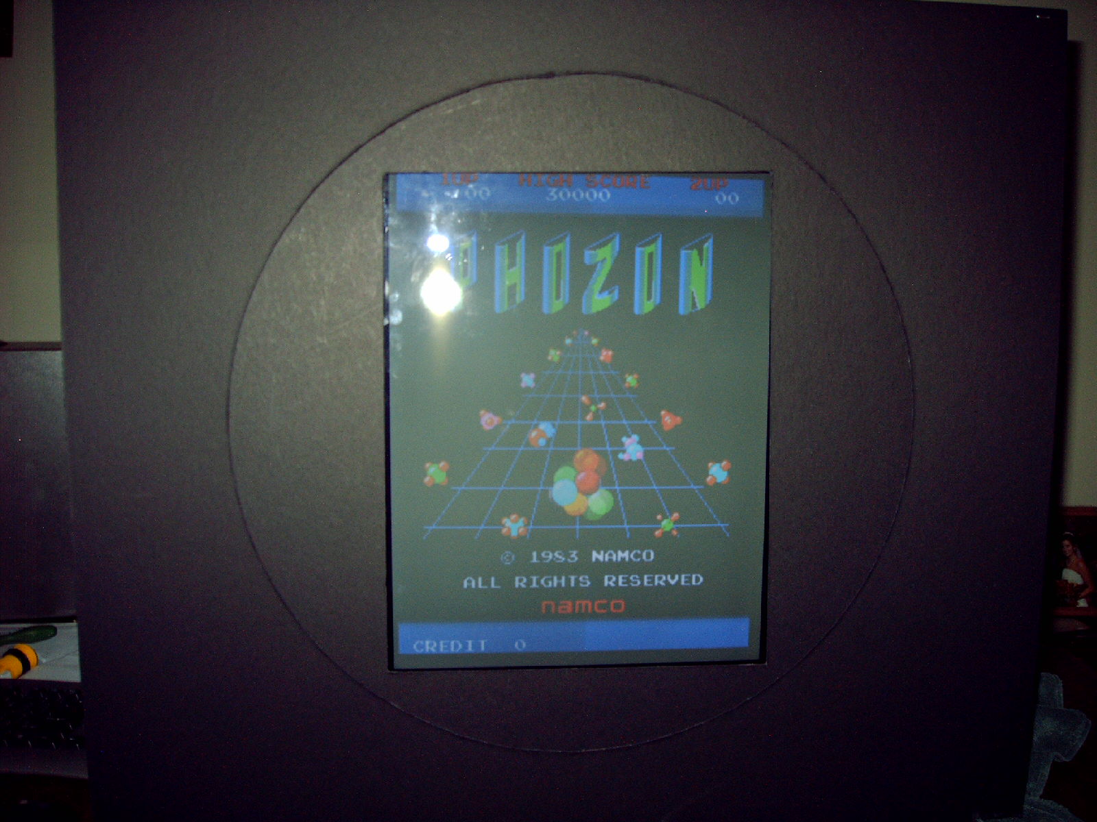

Here is the front, in vertical position:

And here is the other side of the back, you can see teh motor mounted to teh plywood and teh H drive and interface board mounted below it.

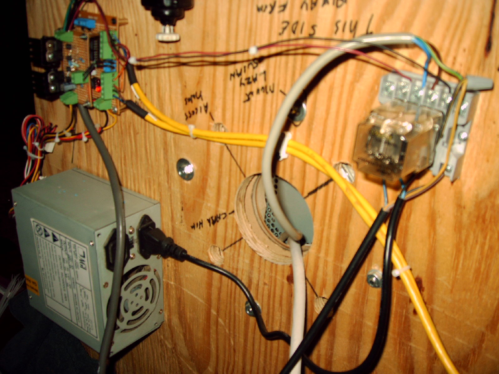

Here is the back, with the monitor off relay mounted and wired into the monitor power cable.
You can also see an AT type power supply.

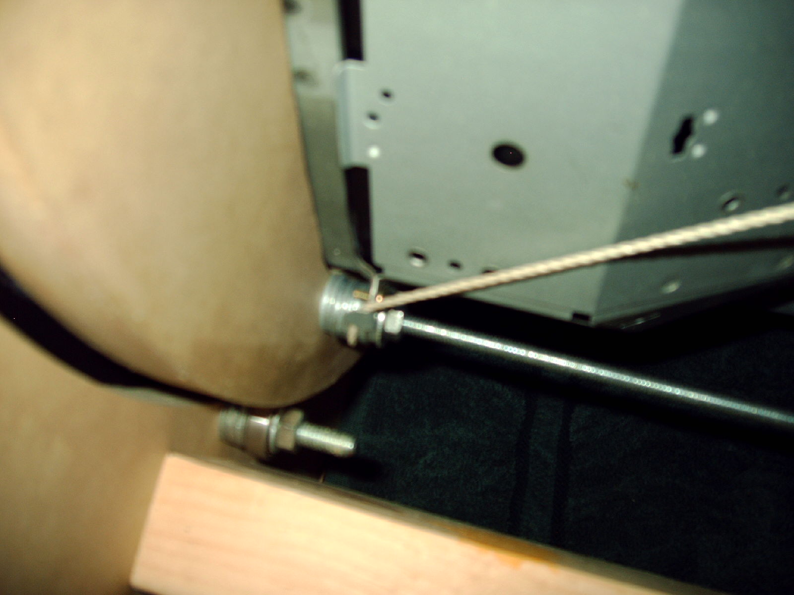

Here is one of the skateboard bearings, with the front MDF disk riding against it.
I used 5 bearings on the front disk, and two on the back.

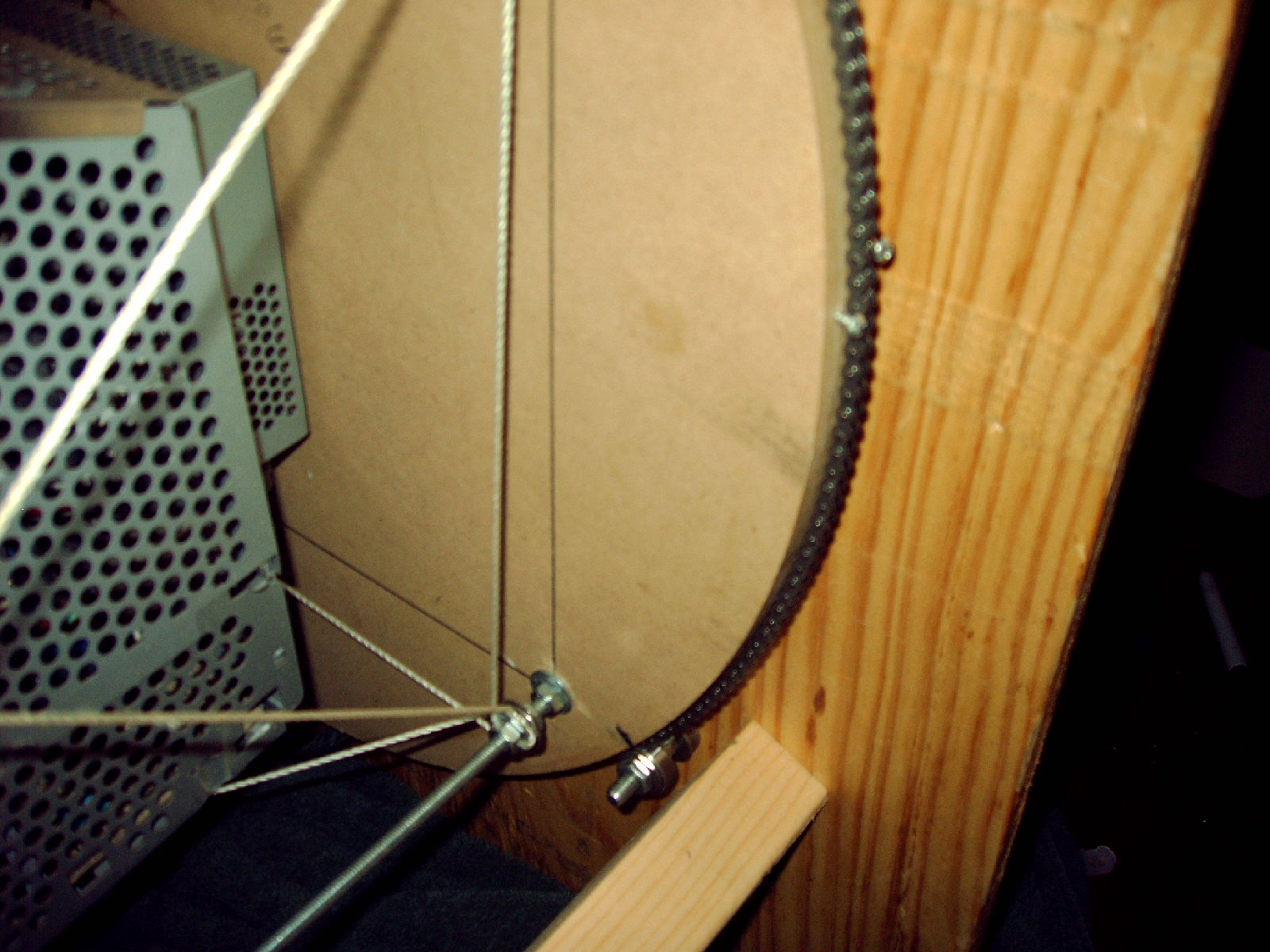

And here is one of the back bearings, riding against the back MDF disk.
Notice the #25 chain attached to the perimeter of the disk.
This is how the motor turns the disk.
The end of the chain also provides a mechanical stop when it gets to the bearing.

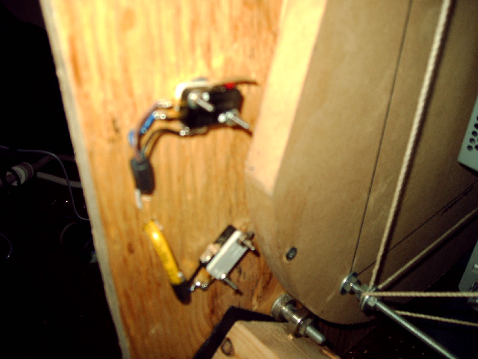

Here are the limit switches. These are paddle micro switches, like the kind used on some joysticks.
I put a screw through the MDF disk to strike the switch paddle when the desired position is reached.
The switches are wired back to the isolator board mounted on the back.

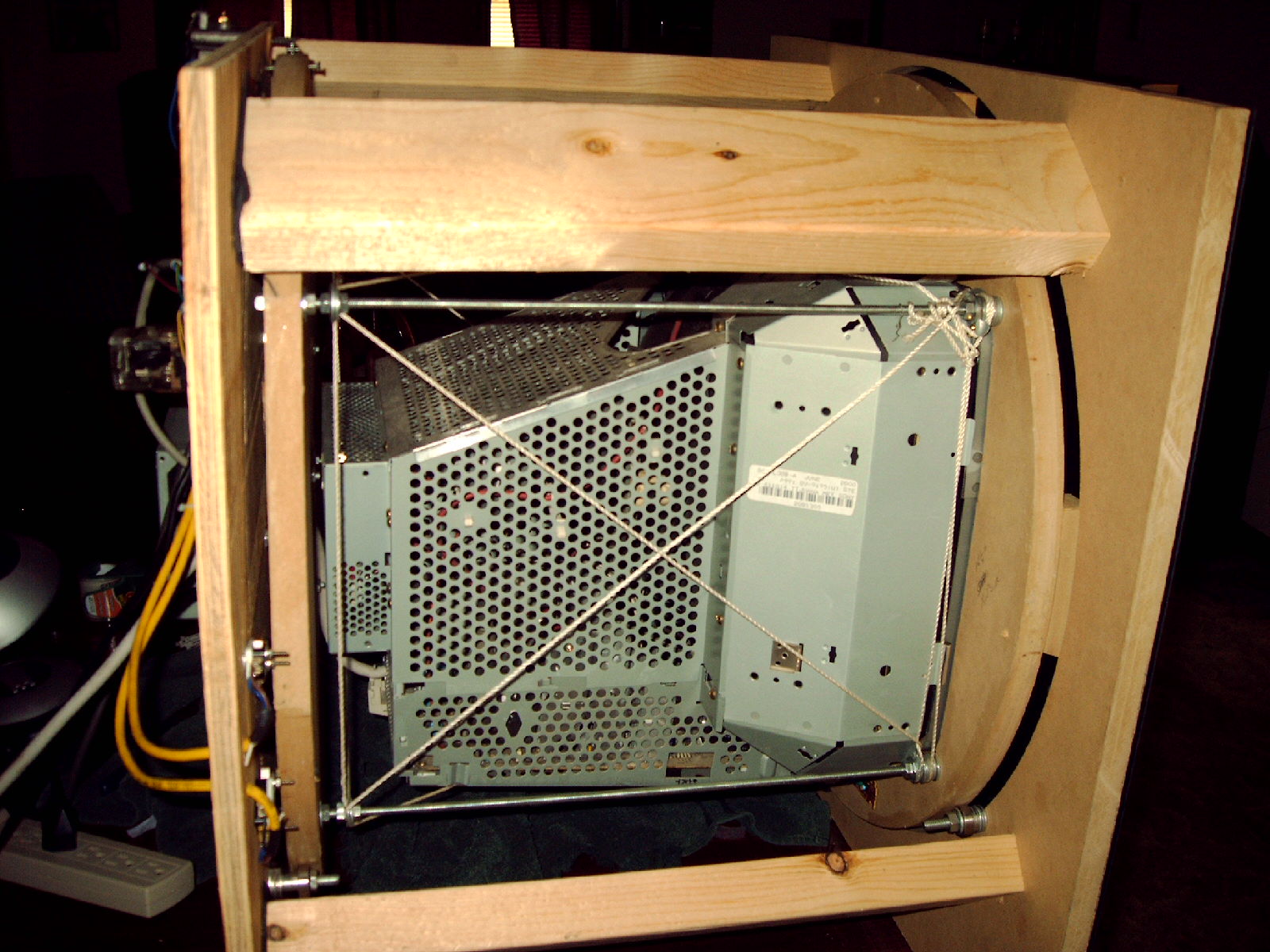

And here is a side view. The monitor is sandwiched between two round MDF disks.
The disks are attached with 1/4" all thread bolts.
I had to use nylon cord as bracing to keep the disks from twisting when turning.
This worked out better than I expected.
You can also see in the last picture a block mounted to the front disk.
I cut out a circle of black poster board, then cut out the monitor screen in this disk.
This disk attaches to 4 of these blocks.
You can see this setup better in the first two pictures.
