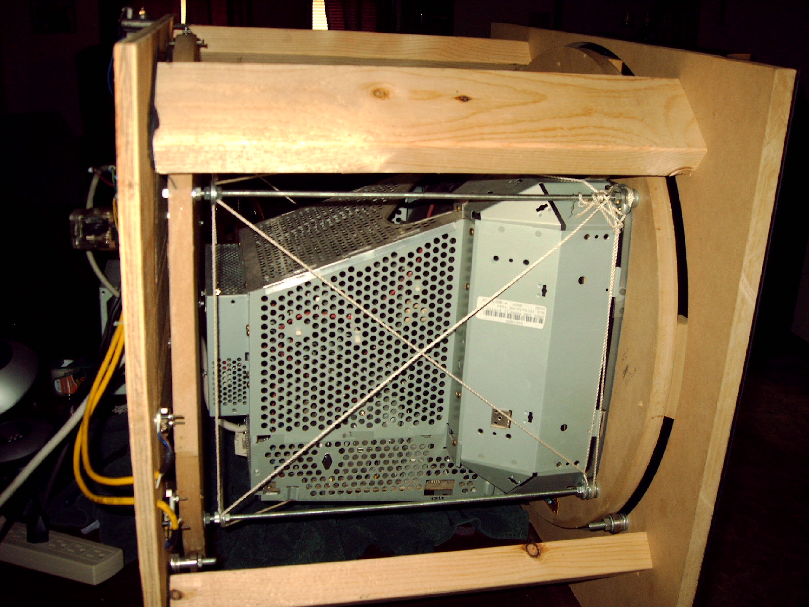

Re: Rotating monitor construction *Cutting in circles*
« Reply #168 on: March 26, 2008, 08:18:35 pm »
Ok, I made a rig to allow my router to cut out the circles I need for my rotating project.
First I laid out my dimensions.
I marked the holes for the lazy susan bearing, and the 4 holes for the monitor to bolt to. And of course a center hole.
I stacked the marked board on top of another.
I then drilled a 1/4" hole in the center through both boards. I then ran a 1/4" carriage bolt through both.
Counter sunk a hole in top board for 1/4" nut.
I also drilled the holes for the lazy susan bearing through both, installed 4 screws in the holes to fasten the two boards together. Counter sunk the screws in the top board.
heres another shot of the lazy susan bearing. The nail marks one of the monitor mounting spots.
Next a got a piece of mdf wide enough to mount the router to.
It was actually about 1-1/2" wider than the base of the router.
I drilled a 1/4" hole in the center, then stuck the router bit through the hole.
Next I marked the base of the router.
Next I routed out about 1/4" so the router can set down into the wood. base is pretty snug.
I then mounted two 3/4" conduit clamps to hold the base of the router. The 1/4" bolts for the clamps are counter sunk on the other side of the wood.
I then bored out the router bit hole to 1-1/4". This gives more room for dust to get out.
The router clamped to the wood.
Next I flipped the rig over and marked the location of the inside edge of the router bit.
This will give me a reference to measure my circle's radius.
Notice how the conduit clamp bolts are counter sunk.
Next I measured from the inside side of the router bit to get my mark for the pivot hole.
My circle needs to be 23" diameter, so I measured 11.5" radius.
Ok, rig is mounted to the board to be cut.
It pivots good. Im happy.
First cut is finished. I went about a 1/4" deep first. Vacuumed the slot and allowed router bit to cool.
Three passes later and Im done with my first circle. Measures exactly 23" diameter.
Now, first cut on the bottom piece.
This circle will be in the back of the monitor, and the lazy susan bearing will mount to it.
The scrap I had wasnt enough to make two complete pieces. This circle will have a flat spot. I may not be able to make it work, if not, I will have to buy a new sheet of mdf and cut another one.
Here are both pieces finished. Mickey seems pleased.
Next: Got to cut out the monitor hole in the first piece.
I like the circle cutting jig. Its got a special place on the wall of my shed. i know I will be using it again.
Edited for spelling and grammar.

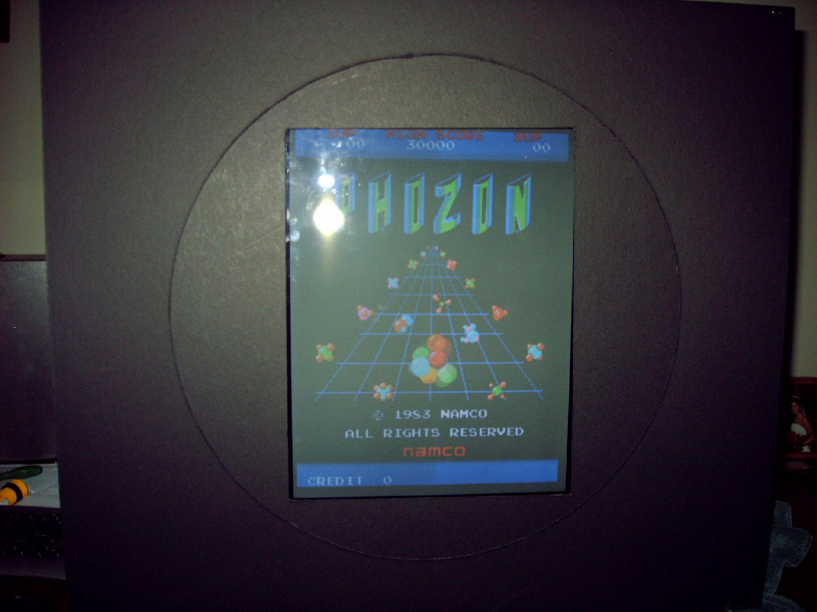

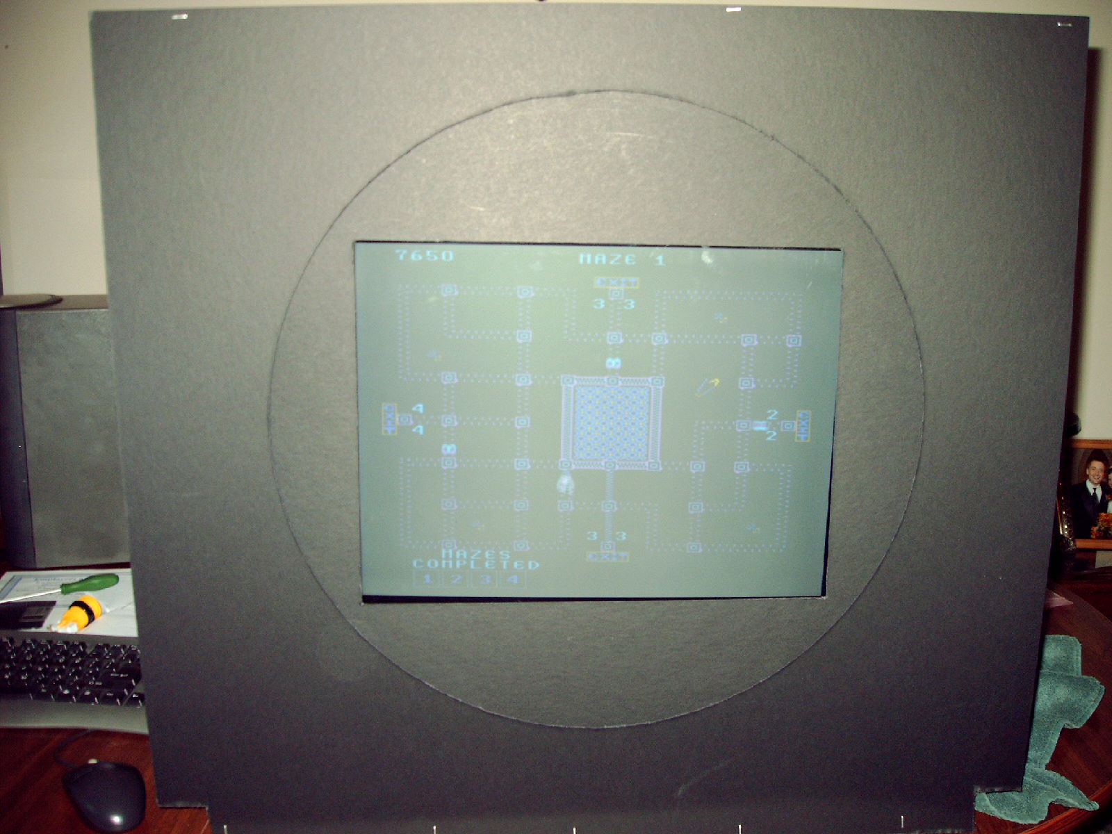

First of all a look at the front, horizontal position.
I dont have plexi glass in front of the screen yet, that is coming.
Here is the front, in vertical position:

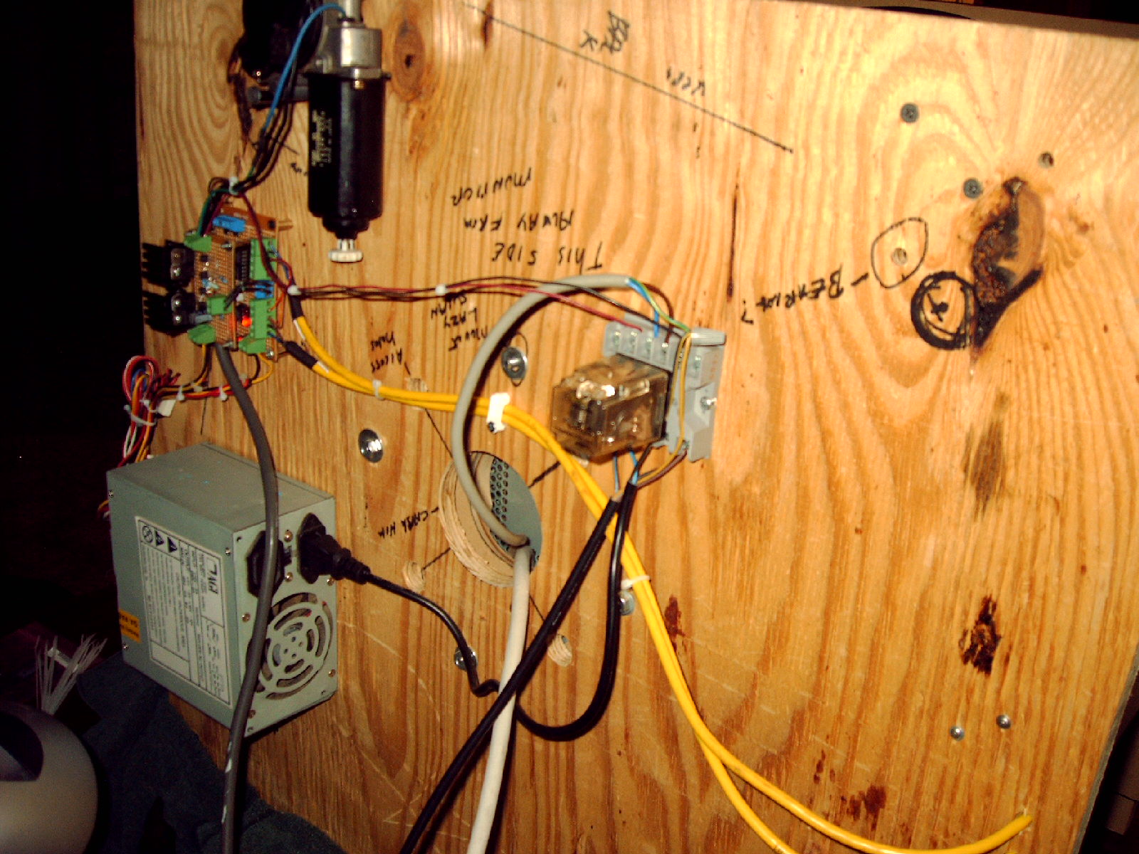

Here is the back. i went with plywood for the back, you cant see it, but there is a lazy susan bearing between the ply and the back circle of MDF.
The hole in the middle is to let the cords exit, and to allow air to flow to the back of the monitor.

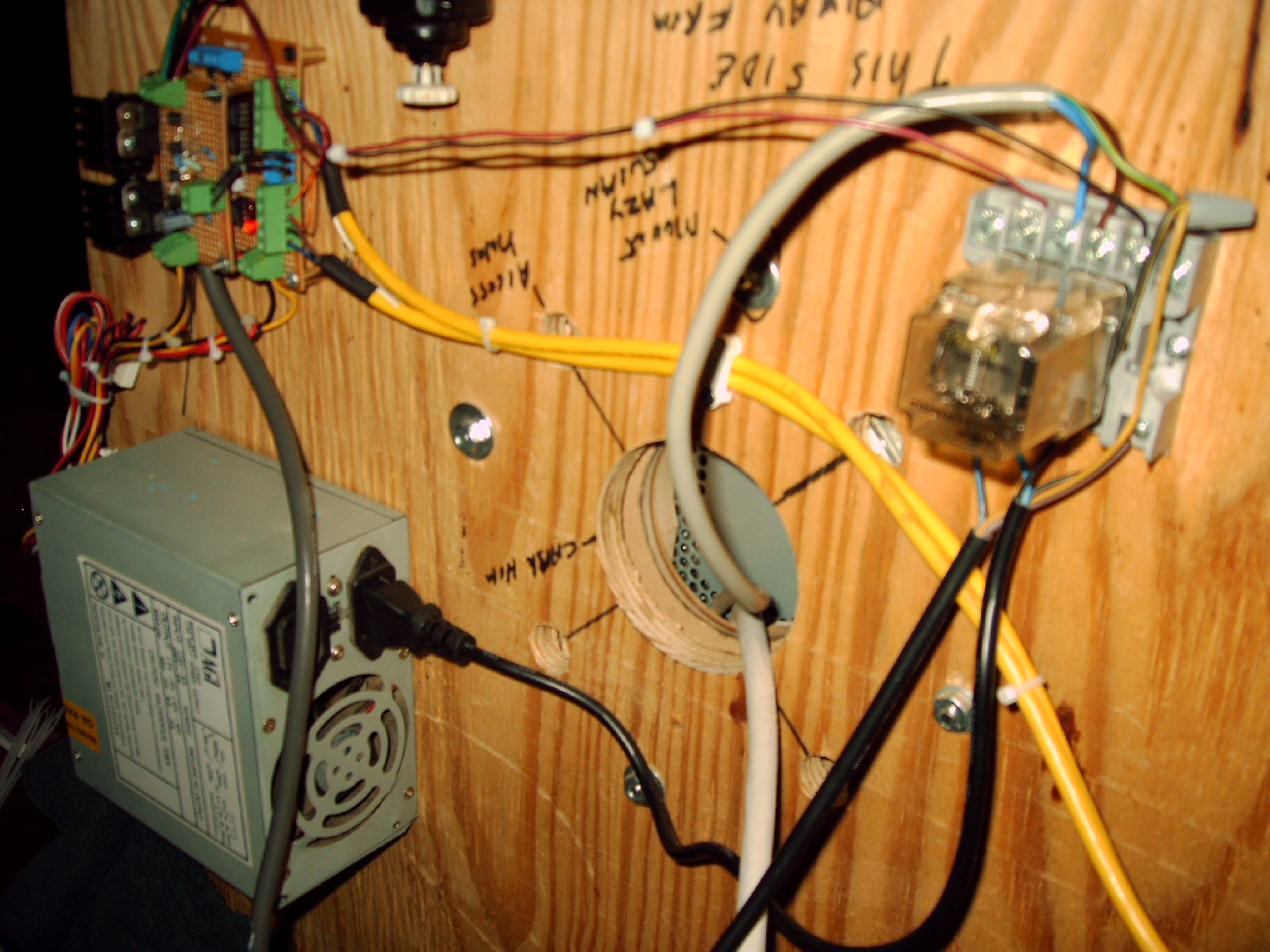

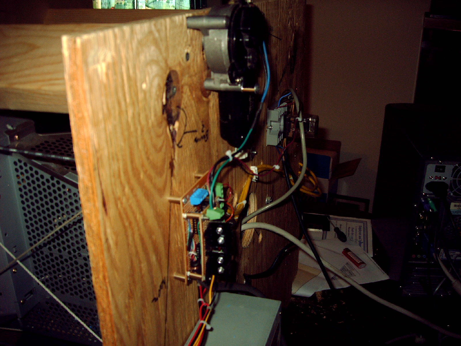

And here is the other side of the back, you can see teh motor mounted to teh plywood and teh H drive and interface board mounted below it.
Here is the back, with the monitor off relay mounted and wired into the monitor power cable.
You can also see an AT type power supply.

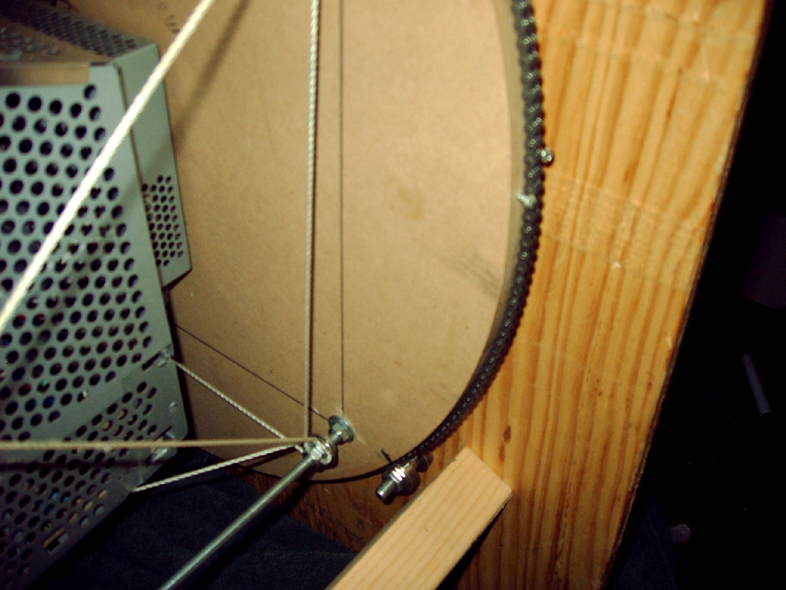

And here is one of the back bearings, riding against the back MDF disk.
Notice the #25 chain attached to the perimeter of the disk.
This is how the motor turns the disk.
The end of the chain also provides a mechanical stop when it gets to the bearing.

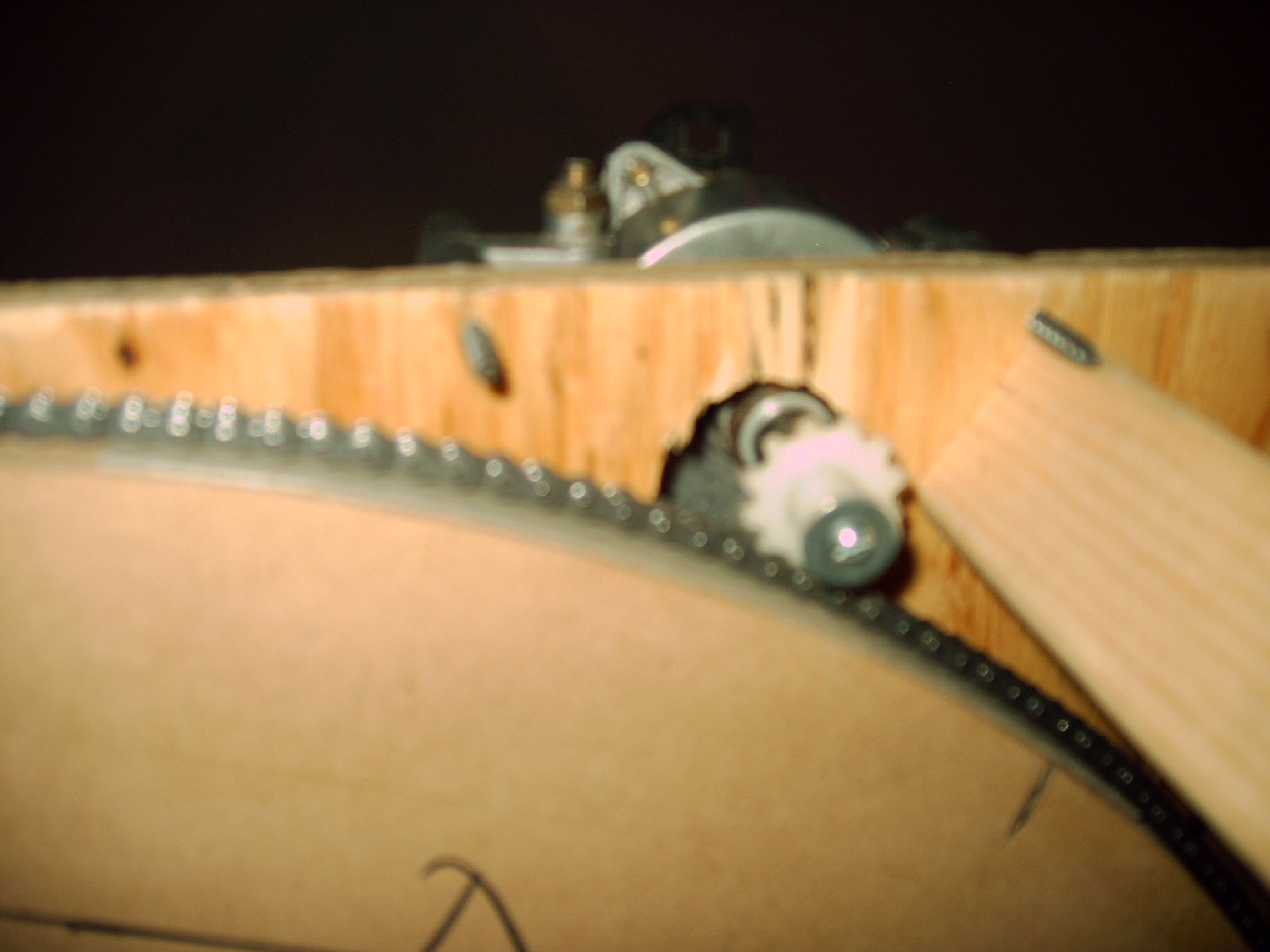

Here is the motor drive. The nylon sprocket rides in the chain, and pulls the MDF disk clockwise and counter clockwise.
This setup works well, but it is a little noisey.

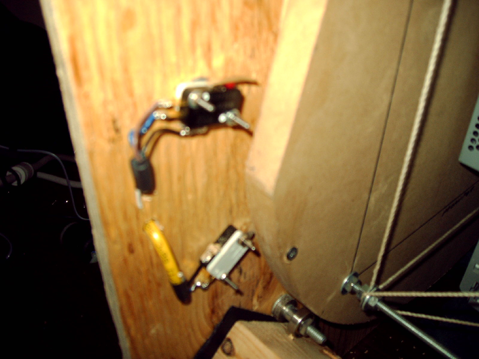

Here are the limit switches. These are paddle micro switches, like the kind used on some joysticks.
I put a screw through the MDF disk to strike the switch paddle when the desired position is reached.
The switches are wired back to the isolator board mounted on the back.

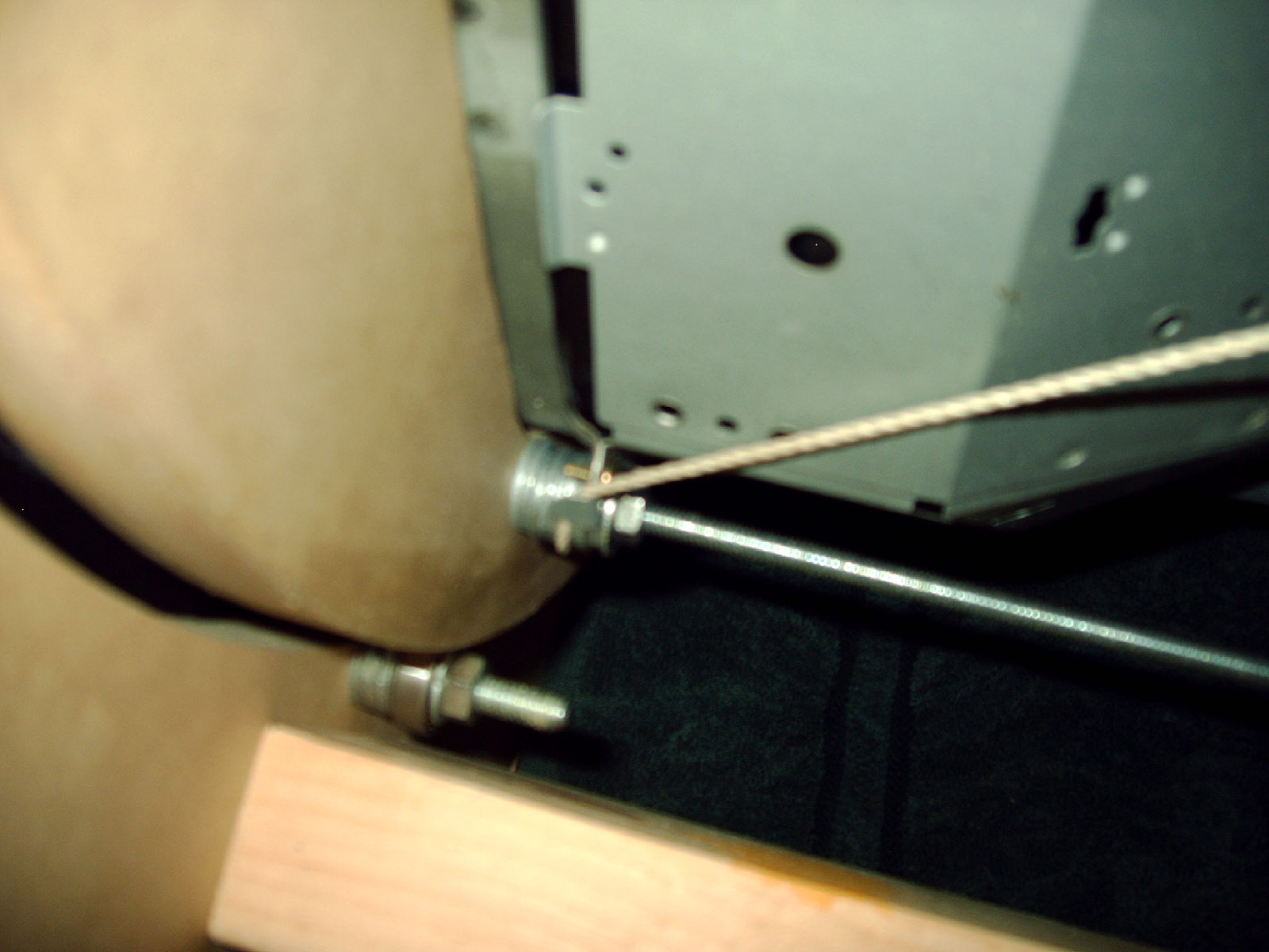

And here is a side view. The monitor is sandwiched between two round MDF disks.
The disks are attached with 1/4" all thread bolts.
I had to use nylon cord as bracing to keep the disks from twisting when turning.
This worked out better than I expected.
