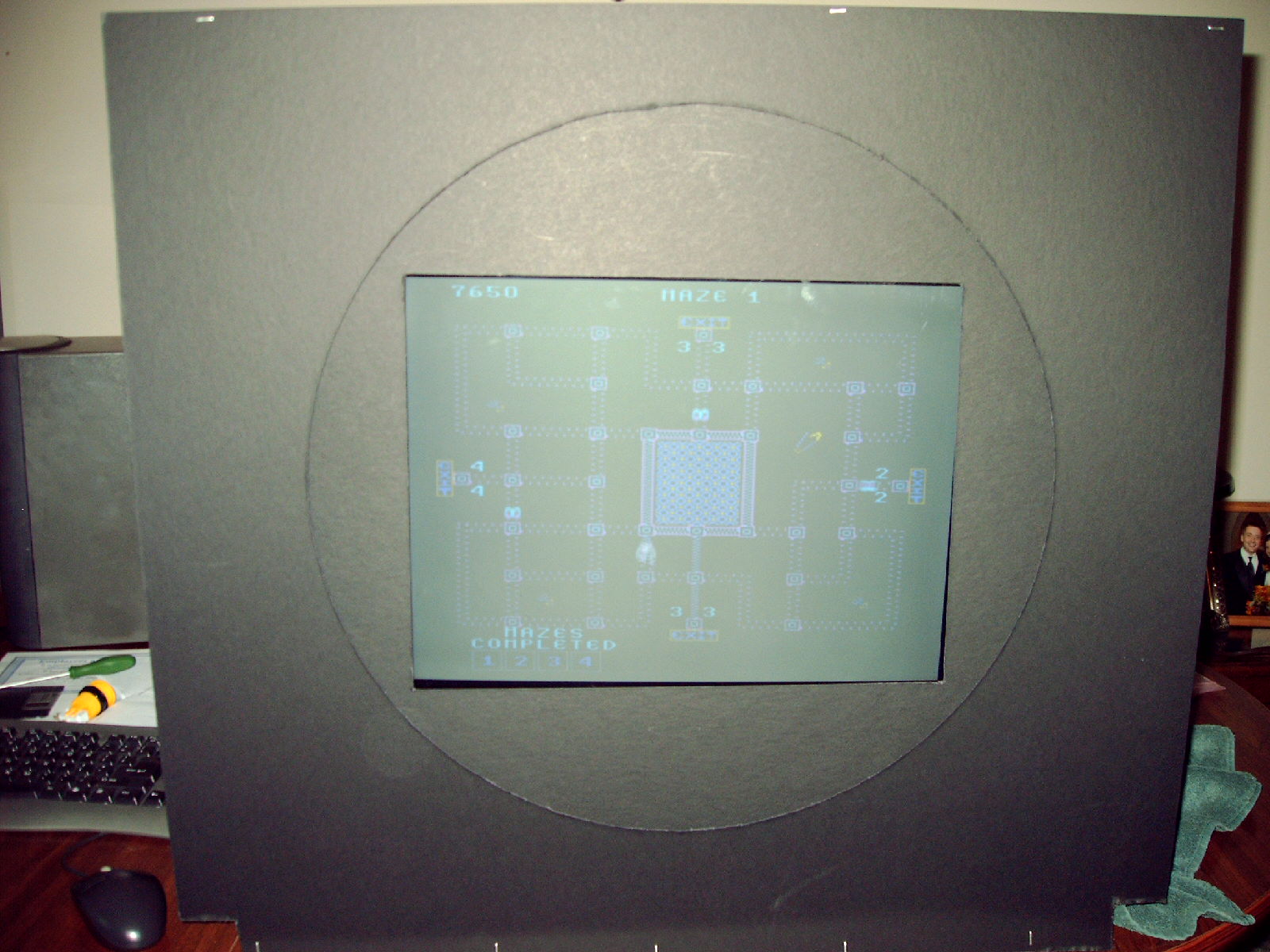

Re: Rotating monitor construction *Monitor plate test fit*
« Reply #174 on: March 27, 2008, 05:17:20 pm »
I didnt get a lot done today. been threatening thunderstorms all day.
I did get the holes to mount the monitor drilled in both circle plates.
I intend to run four bolts through the first plate, through the monitor mounting tabs, and through the back plate.
Here are some pics of the monitor plate mounted to the monitor, so I could mark it to cut out for the screen
This is a pic of the side of the monitor (camera was turned sideways.) you can see the line I made with a sharpee marker.
Here is the front of the monitor plate. I attached it with 1/4" carriage bolts.
I put paper towels over the screen to protect it from scratches.
And here is the side. You can see the black mark. This is where I will cut for the monitor to fit into the plate.

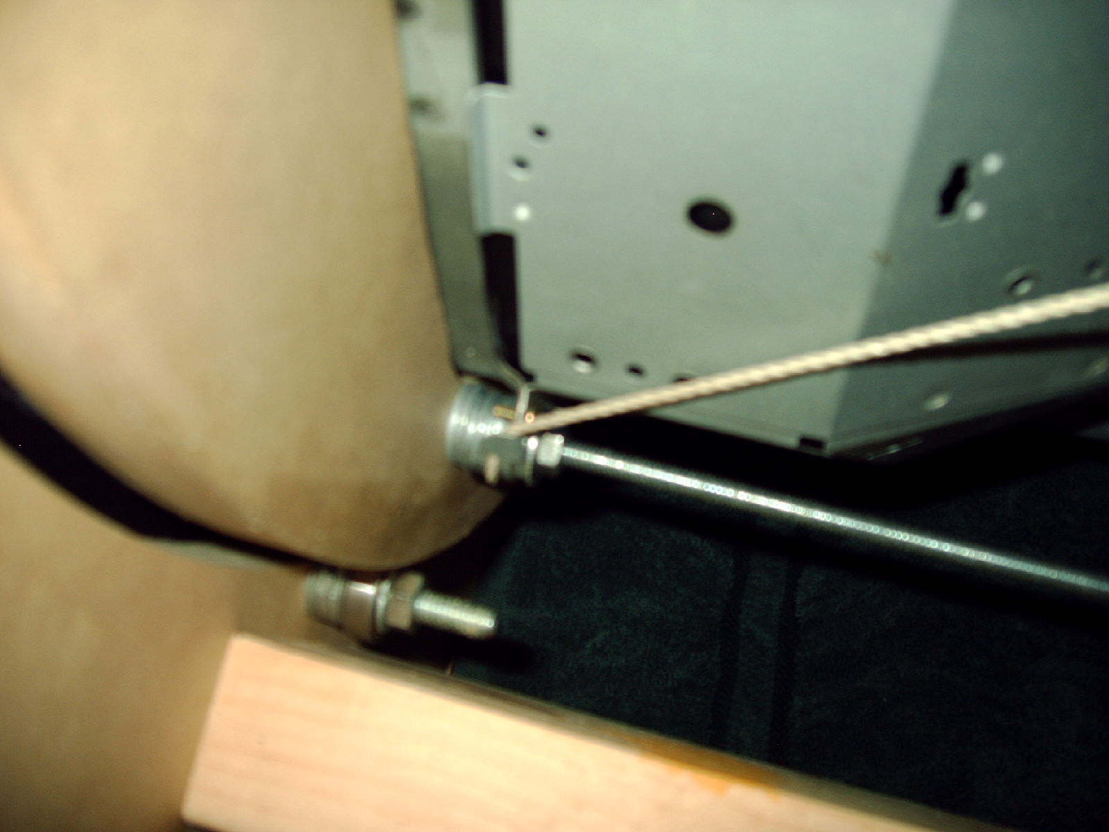

I am planning to use just the bearings, But Ive run into two problems.
The bearing shafts are going to be very close to the edge of the wood, due to the 1/4" slot between the disc and the monitor board.
And the bearing I.D. looks like it might be metric. A 5/16" bolt has too much play, and a 3/8" bolt doesnt fit.
So I got to take the bearing into work tomorrow night and try some metric bolts to get the right size, then I got to see if I can find some metric all-thread. I dont want to have to machine a piece, but I may have to, if i use these bearings.

Well, I have something like that planned. But since Im using a pretty heavy CRT, I dont know about the slot. It may weaken the wood.
But I picture is worth a hundred words, so as soon as I get it laid out I will post some pics.
Those bearings I bought are giving me fits. The ID is slightly larger than a 8 mm bolt.
I checked a hardware store, and they didnt have any 9mm bolts, and 10 mm is way to big.
I checked at work and we have 8 and 10, no 9.
Whats up with that??
Anyway, does anyone have specs on these bearings? I cant seem to find the ID anywhere on the net.
I sure hope I dont have to make something on the old lathe. I was hoping to keep this project "parts you can get at the store".

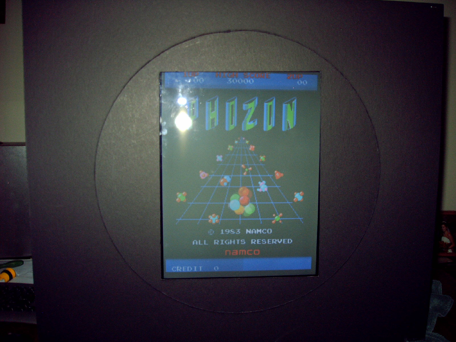

First of all a look at the front, horizontal position.
I dont have plexi glass in front of the screen yet, that is coming.
Here is the front, in vertical position:

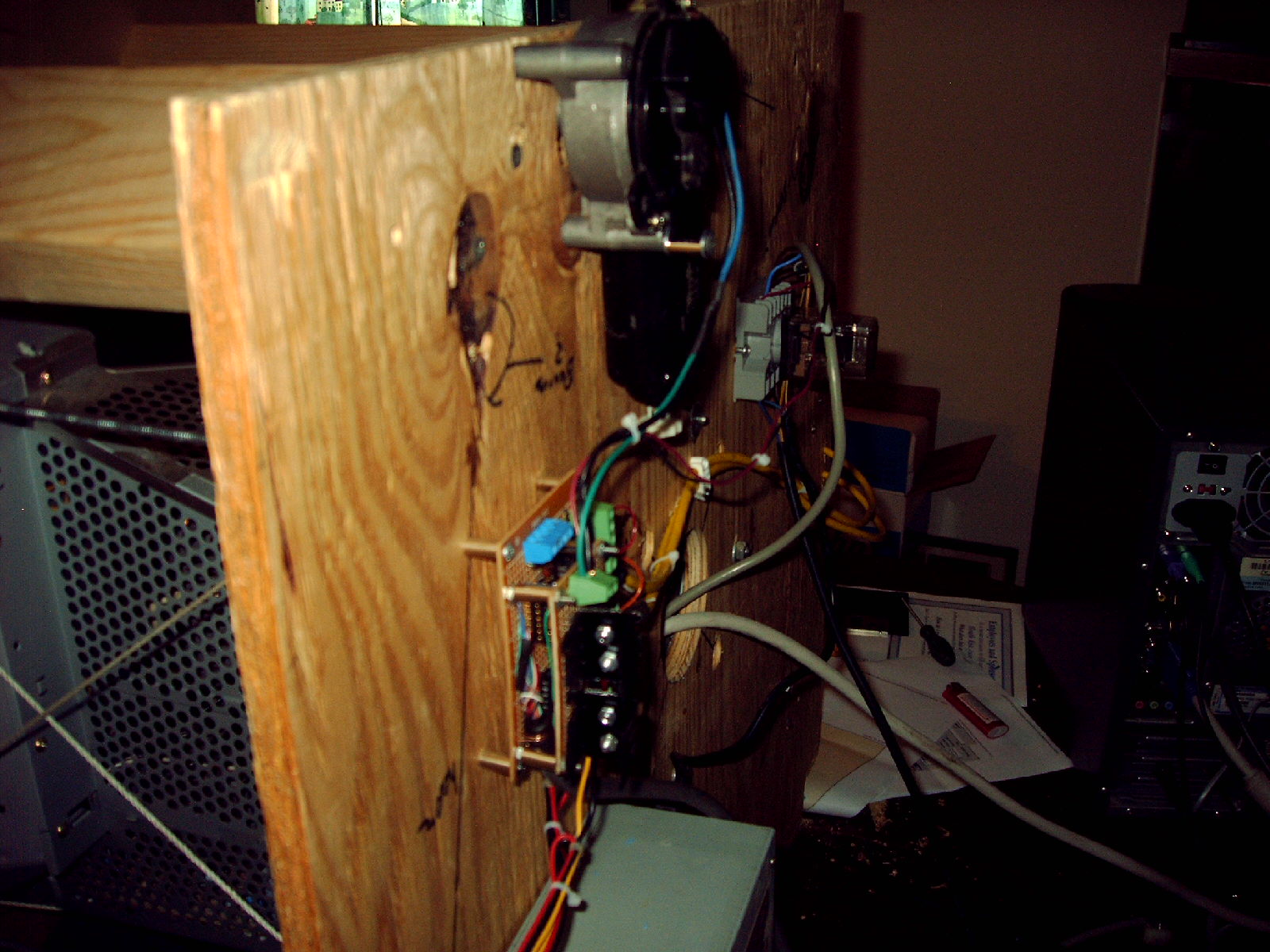

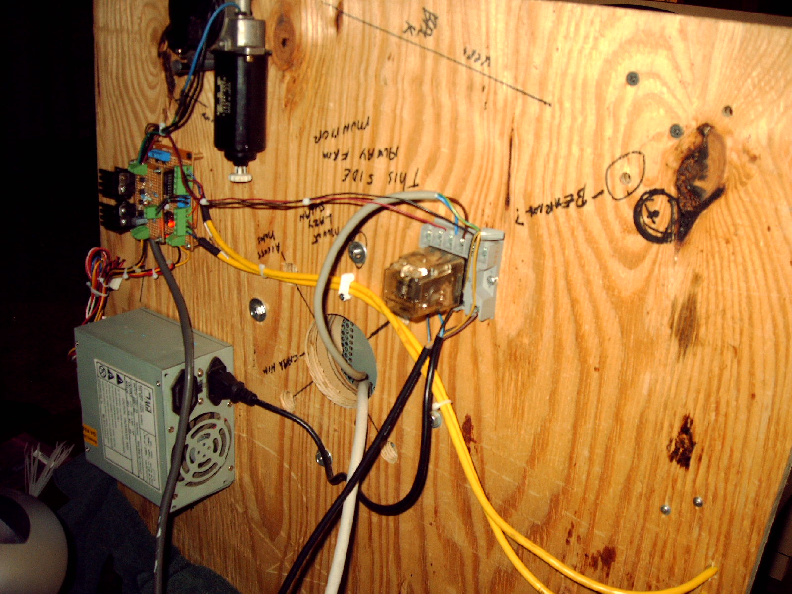

Here is the back. i went with plywood for the back, you cant see it, but there is a lazy susan bearing between the ply and the back circle of MDF.
The hole in the middle is to let the cords exit, and to allow air to flow to the back of the monitor.
And here is the other side of the back, you can see teh motor mounted to teh plywood and teh H drive and interface board mounted below it.

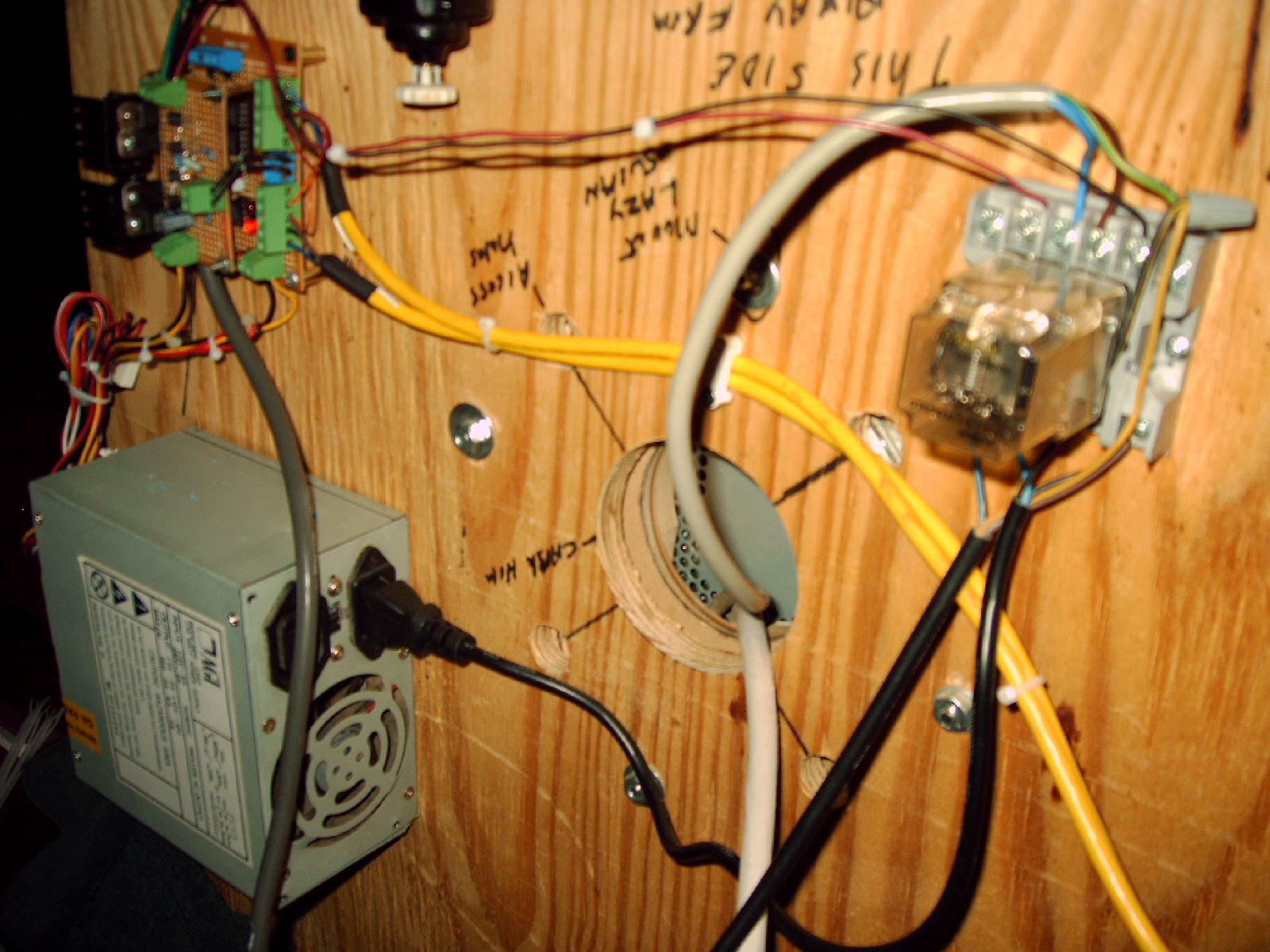

Here is the back, with the monitor off relay mounted and wired into the monitor power cable.
You can also see an AT type power supply.

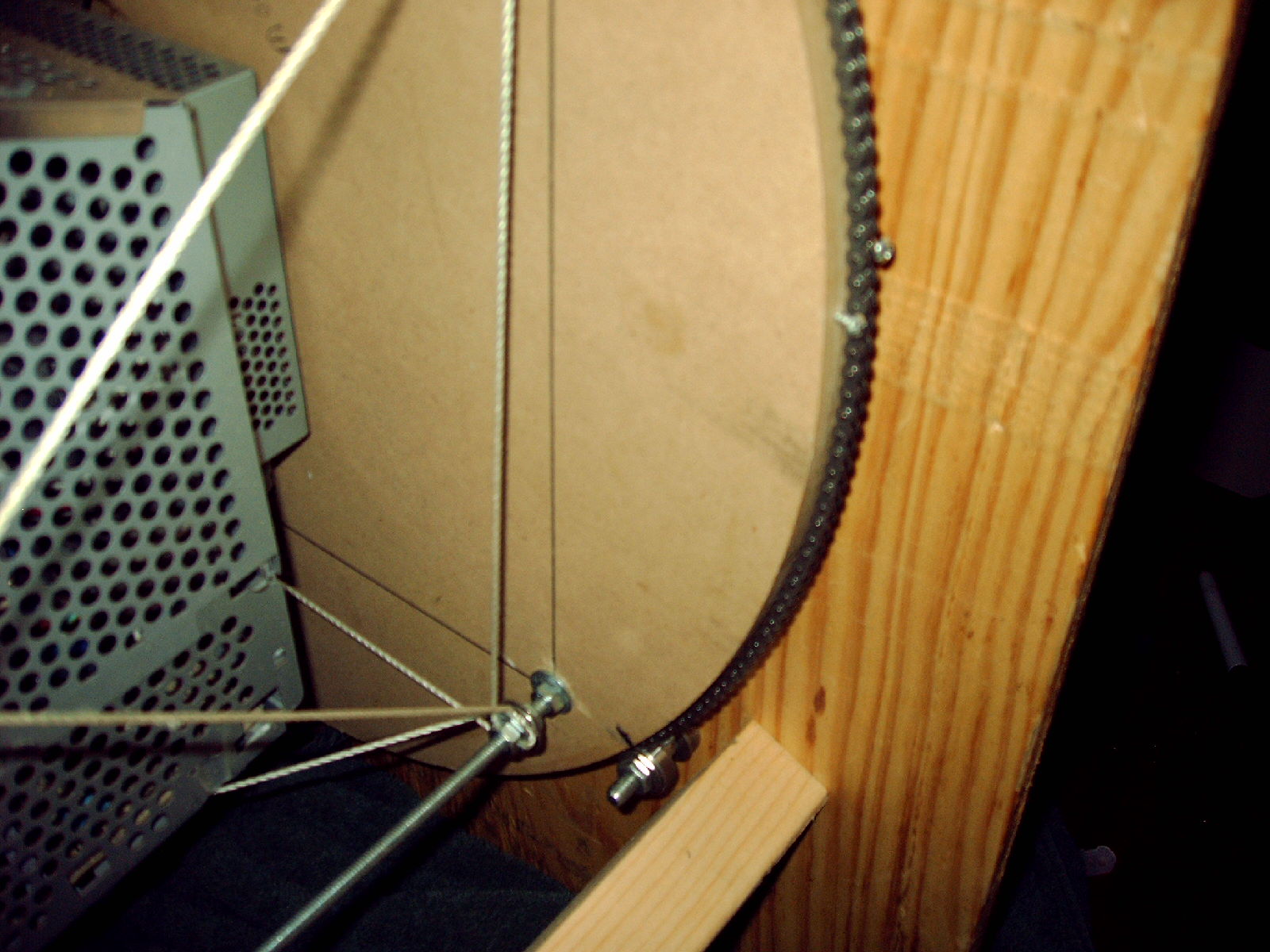

Here is one of the skateboard bearings, with the front MDF disk riding against it.
I used 5 bearings on the front disk, and two on the back.
And here is one of the back bearings, riding against the back MDF disk.

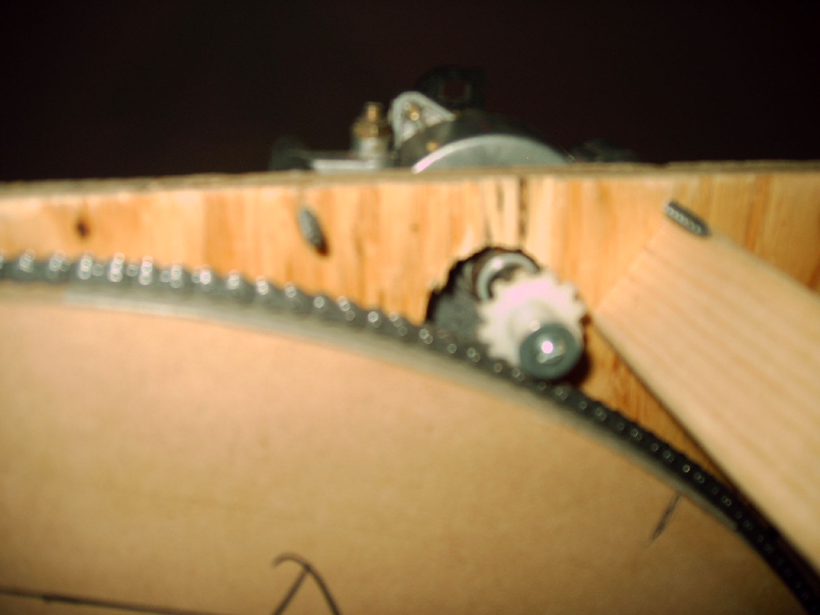

Notice the #25 chain attached to the perimeter of the disk.
This is how the motor turns the disk.
The end of the chain also provides a mechanical stop when it gets to the bearing.
Here is the motor drive. The nylon sprocket rides in the chain, and pulls the MDF disk clockwise and counter clockwise.
This setup works well, but it is a little noisey.

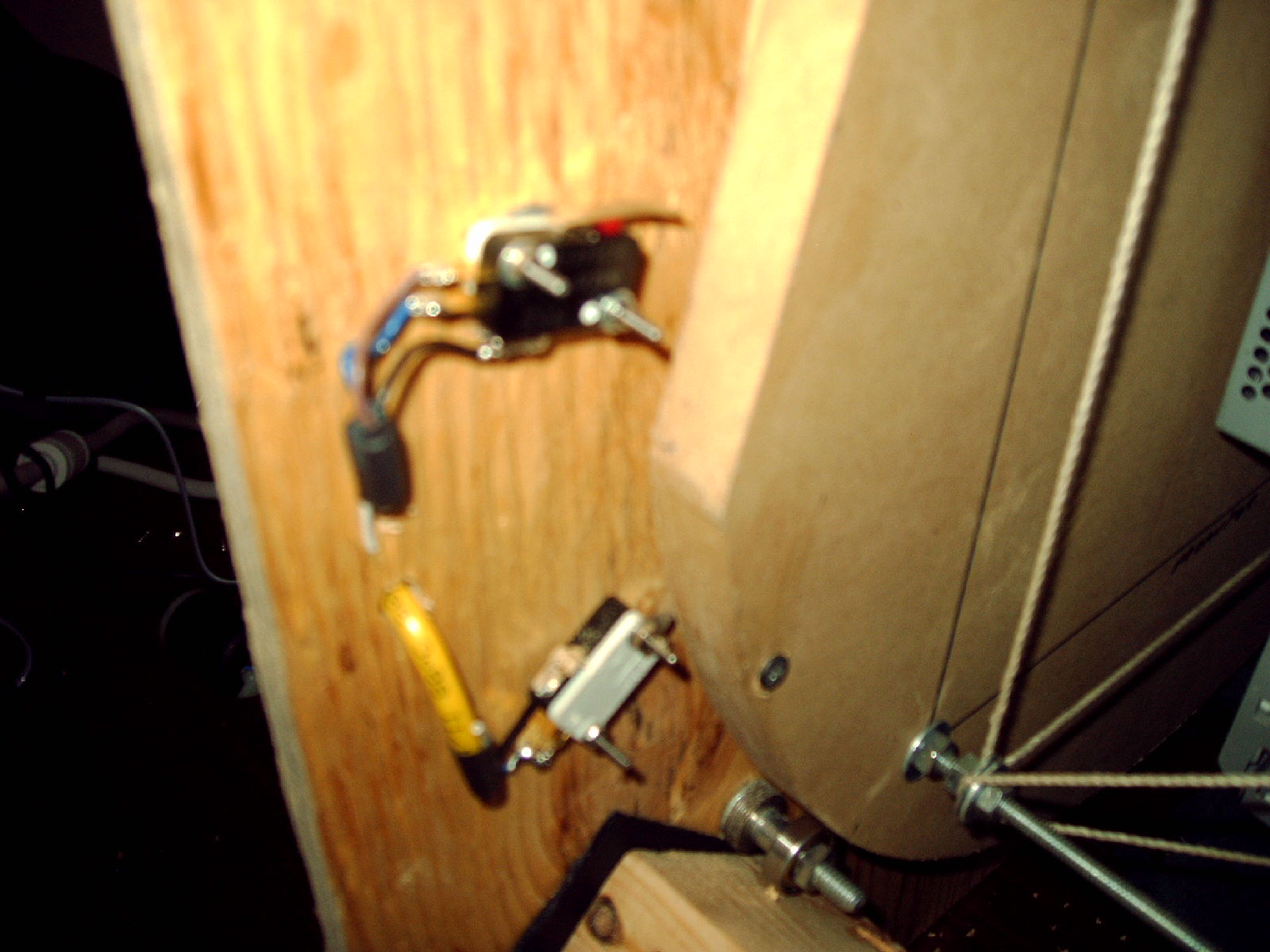

Here are the limit switches. These are paddle micro switches, like the kind used on some joysticks.
I put a screw through the MDF disk to strike the switch paddle when the desired position is reached.
The switches are wired back to the isolator board mounted on the back.

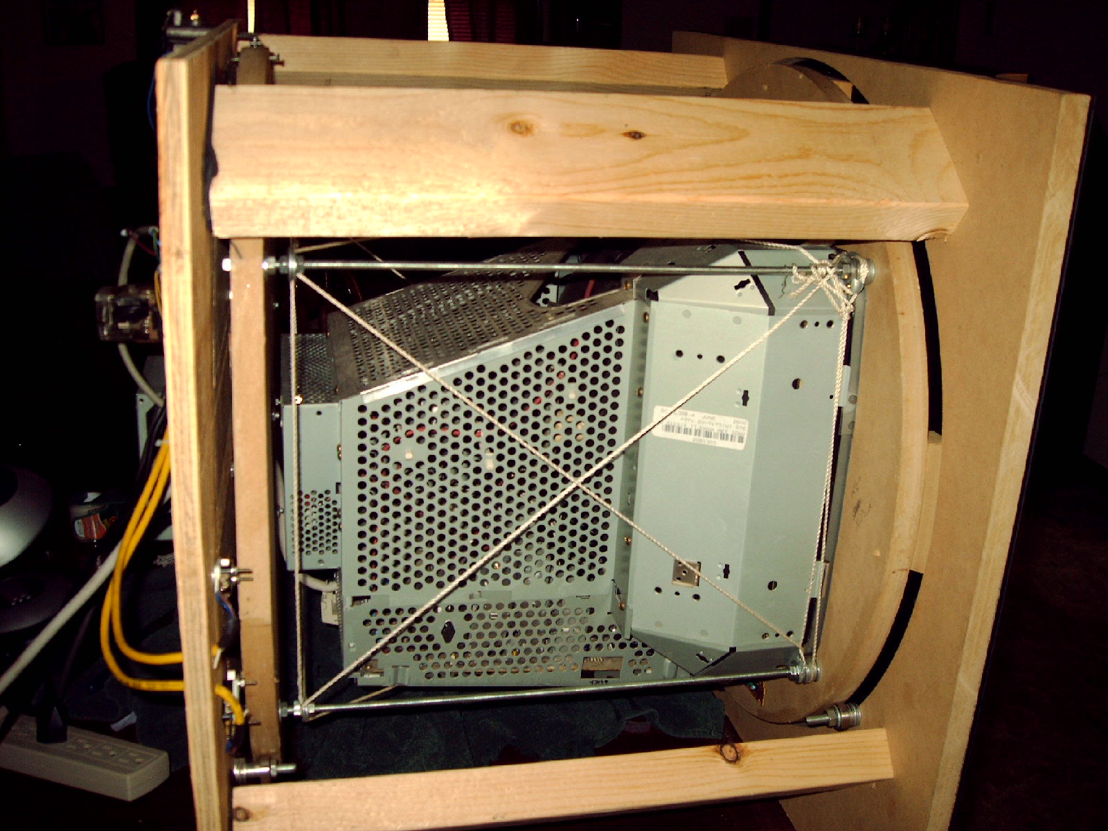

And here is a side view. The monitor is sandwiched between two round MDF disks.
The disks are attached with 1/4" all thread bolts.
I had to use nylon cord as bracing to keep the disks from twisting when turning.
This worked out better than I expected.
You can also see in the last picture a block mounted to the front disk.
I cut out a circle of black poster board, then cut out the monitor screen in this disk.
This disk attaches to 4 of these blocks.
You can see this setup better in the first two pictures.

The monitor off relay turns off the monitor while it is rotating.
I had provided an output for this relay, but it is not working, I think it may be a bad opto isolator.
Rather than to take the H drive off the isolator board to gain access to the chip, I just wired the 12 volt relay to the H drive output. This works good because Im not using speed control.
