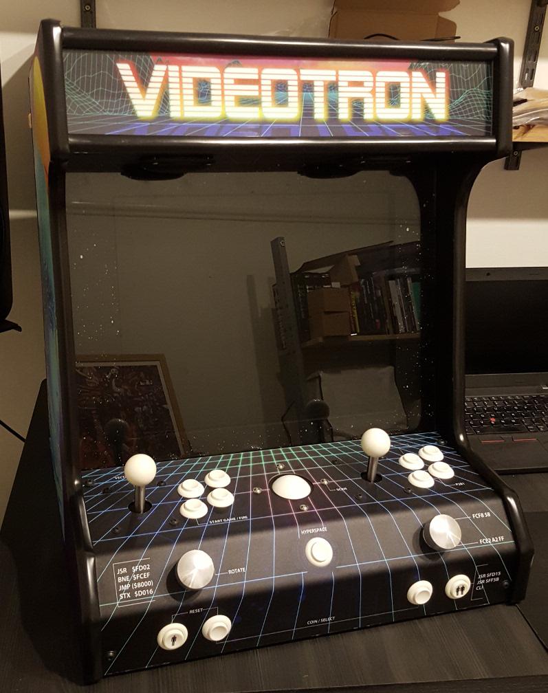

So it's more or less finished, this is how it turned out - nothing like how it started, LOL.  It had about a bazillion theme changes, lots of hours in the garage prepping panels for paint or artwork, but lots of fun.  Thanks everyone for your advice and feedback during the build - I learned a lot, as always.  The full thread follows these pics...
And here's a video tour...

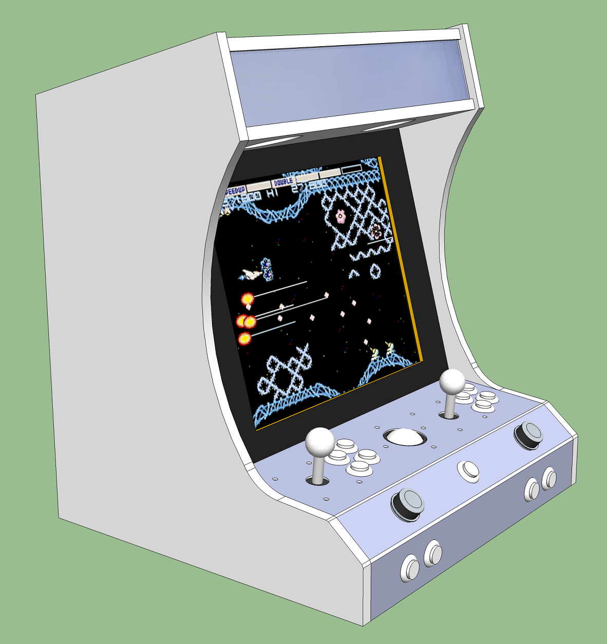

While my other "long term" Jimbovision cab project is continuing slowly (I'll update the project thread soon), I've started another shorter-term project for my kids - a bartop arcade running Retropie.  My aim is to be able to give this to them as a gift at Christmas.
Goals: -
  • Control panel for 2 player Arcade/MAME games with a trackball and spinners
  • 8bitdo controllers for retro console/computer games
  • Storage Space for 8bitdo controllers and mini-racer wheels

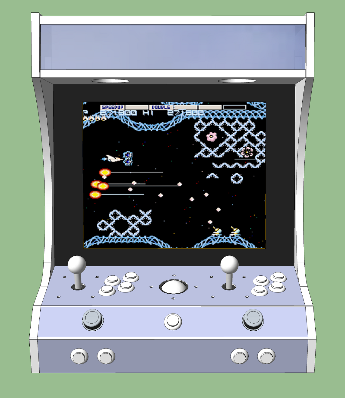

I have designed it in Sketchup...
I've chosen 2 x Dominux8 leaf switch joysticks. I'm so impressed with the Dominux8's on my existing cab that nothing else would do for this build.  I wanted a trackball for Centipede/Missile Command/Marble Madness/etc, so have gone with a Happ 1/4" one.  The spinners are TurboTwist2's along with 5" Mini-Racers for Super Sprint and similar.
I chose 4 buttons per player as we don't play fighters and it would have made the Bartop wider than I'd have liked.  I've added a "Hyperspace" button between the spinners for Asteroids, Defender etc.  I think I can just about play Defender OK with this CP layout.  Front panel has 1P Start/Coin and 2P Start/Coin buttons.
So that's MAME... for console/computer games (mainly NES/SNES/PS1/Megadrive/N64/C64/Speccy/Amiga) I've bought a couple of 8bitdo SN30 Pro controllers.  Happy playing these with controllers rather than the arcade controls (well, maybe except C64/Speccy/Amiga will use the CP controls).

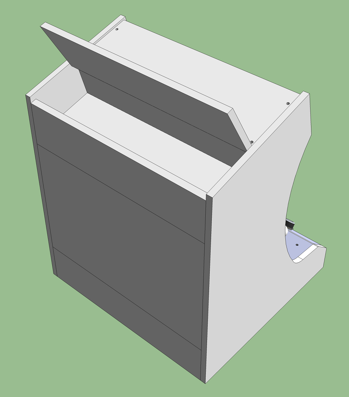

I wanted a storage box behind the marquee to store the 5" mini-racer wheels and the 8bitdo controllers.
The monitor is a Dell 19" (£30 GBP on ebay). It's a 5:4 monitor with 1600x1050 (I think) resolution.  Even with the RetroArch CRT shaders applied the games look great and run very smooth on this monitor - even scrolling seems smoother than I've seen on other newer LCDs. 4ms response time and seems to have very little input lag.  The Benq gaming monitor I tried recently absolutely sucked (very choppy scrolling) compared to this old beauty.
I'll have a Raspberry Pi 3 B+ inside, and have got an Adafruit 20W amplifier to power the 3" speakers.  Plan is to have an IPAC2 as the keyboard controller.
The control panel will be 2.5mm thick mild steel, bent in 2 places so the spinner panel sits around 45 degrees.
I haven't got a theme in mind yet, clearly something to go with my chosen name "The Arcade Time Machine".  I don't know why I called it this, other than I think it'll be cool when the kids ask "Dad, can I play on the arcade time machine?" :)  Ideas for theme/artwork welcome (buttons/trackball/balltops that are coming are white).
Size is 530mm wide, 500mm deep, and at highest point (top/front of marquee) 640mm tall.
Just waiting for controls and materials to arrive, then I'll get cracking.

Had a first stab at artwork today, with a crude attempt of texture mapping in sketchup to see the concept in situ....
I'm happy with the general idea... I can't change the colour of the controls now as they're already bought.  I'd still like to fit in what B.A.R.T. stands for somewhere (Bartop Arcade Retro Terminal) but I'm not sure where.... marquee?
After I got the kids to design some art for the side panels, we all decided it would be really cool to go with my friend's suggestion and paint them with 'black' blackboard paint so they can use chalk (or chalk pens) to change the side art whenever they want :).
Not sure what to do with the bezel around the monitor.  Black currently, and it will be covered in grey tinted glass... but perhaps it should also have some artwork on it under the glass... ?
Any ideas/critique welcome!  :cheers:

So I've got started painting the bits of the bartop that need it.  First up are the side panels.  I needed to paint the parts of the insides of the side panels that are visible.  This is the areas to the side of the screen, all around the edges, and inside the storage box on the top area behind the marquee.  I'd followed Ond's video for this as I am really a complete novice painting anything!  I have posted to his thread here decribing my experience.
First off I filled the areas that I needed to with Isopon P38 body filler. (I've been told this is pretty much identical to "Bondo" as I could not find that over here in the UK).
I needed loads of filler near the end grain where the saw made a mess of the cuts...
After 3 coats of High Build Primer (from Halfords), and lots of sanding between coats, I get it to this stage: -
Lots more work then with 1 coat of grey primer, and 3 coats of high gloss black paint (again all from Halfords), wet sanding in between, and some final goings over with Maguire's Ulitmate Compound... I finally see the results of my hard work and I'm very pleased.
I made some mistakes during this, and some areas are less than perfect, but it's definitely good enough for me, and I learned a lot so the next panels that get the same treatment WILL be perfect! :)
Next up I think I'll be affixing the mounting blocks to the side panels, and preparing the other panels with paint.
