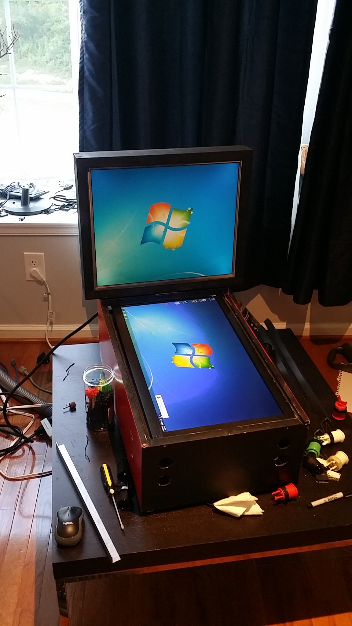

Everything ran pretty great so I decided to get started on the back glass screen. Found a nice 4:3 19" LCD in my pile, decased it, trimmed the metal as much as I could then built the bottom of the box:
Perfect fit!

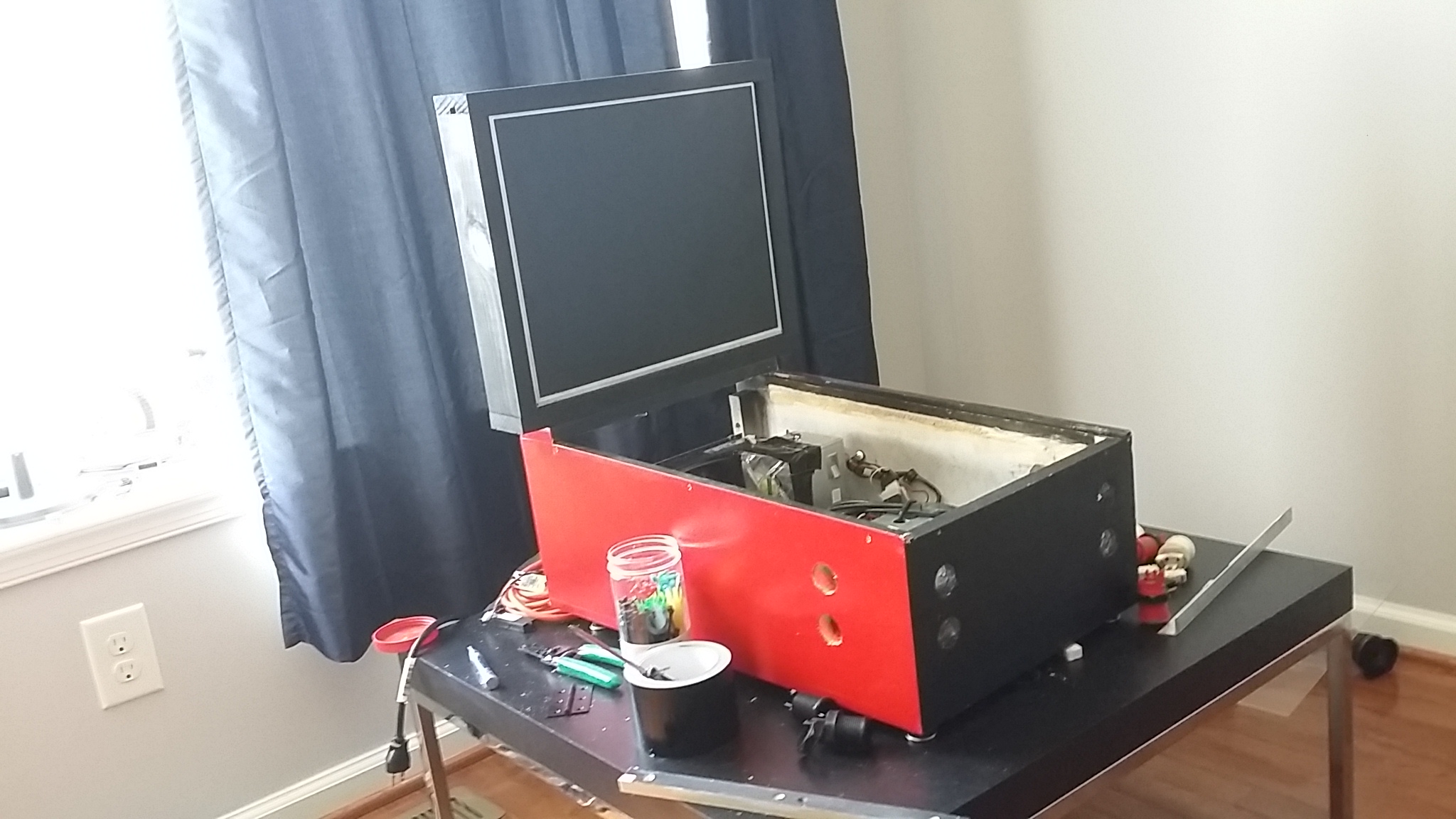

Then I cut the top part, and put a groove in it for the frame (I'll bondo the groove on the outside)
Box is done!
Peg board backing, for both ventilation and cause it was yet another piece of scrap wood to use up
back home we go from my Grandfather's wood shop!
and here she is free standing. The back box will be hinged in the front with a latch in the back. There are holes from the bottom into the back box for wiring.
I will start putting the guts back in and trying to keep the wiring as tidy as possible. the Plan is to tuck as much power and video cable into the back box as possible to get the air flowing through the base of the pin cab.

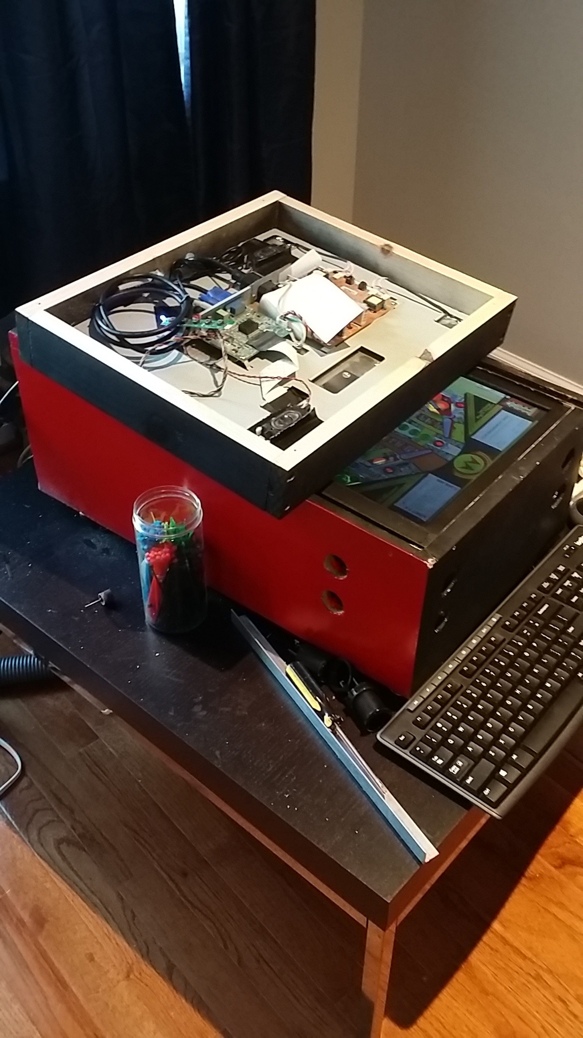

Pulled everything one last time, and restuffed the guts:
Mounted the backbox with LCD. It is still going to be bondo'ed and repainted, just not yet

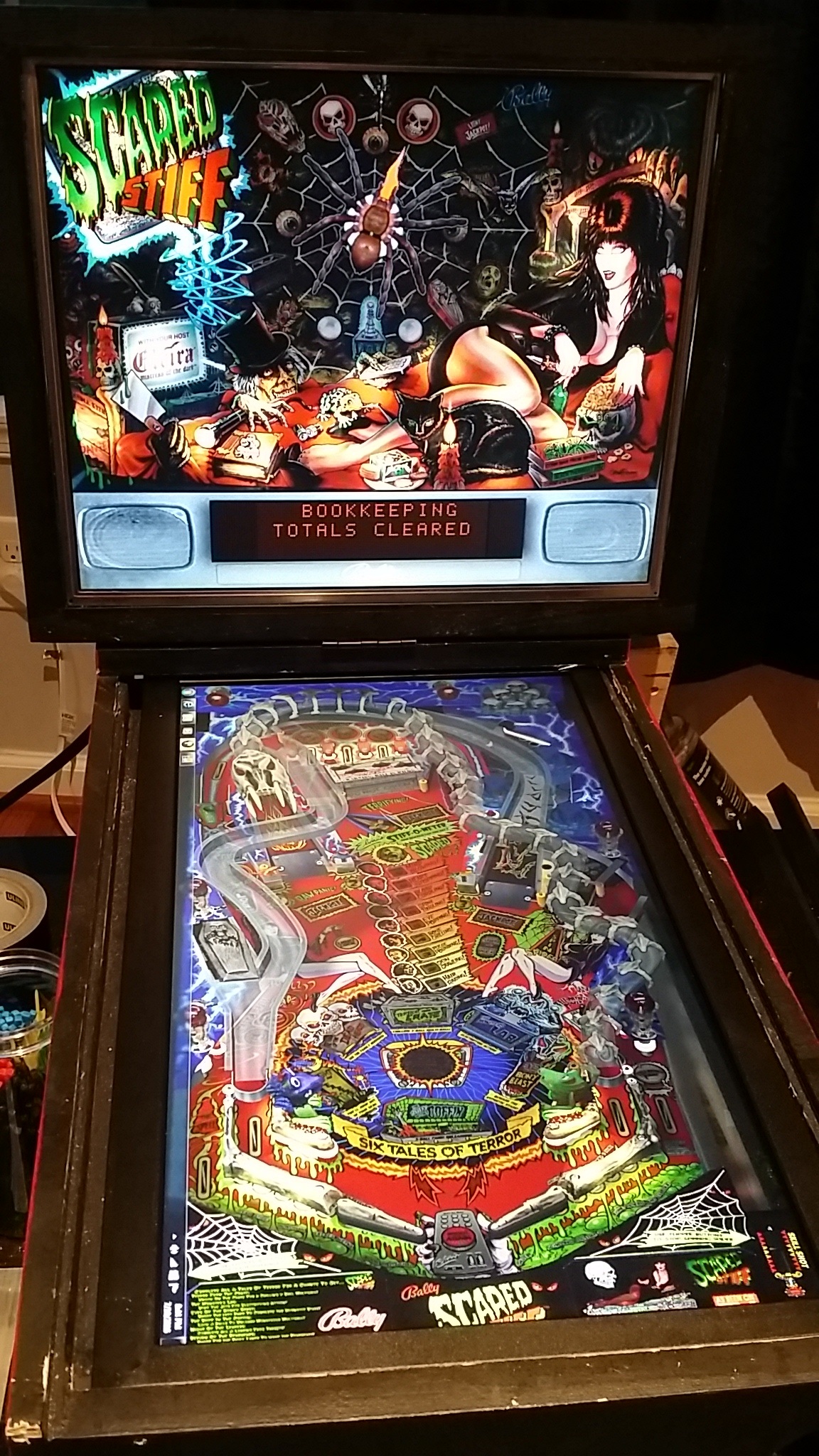

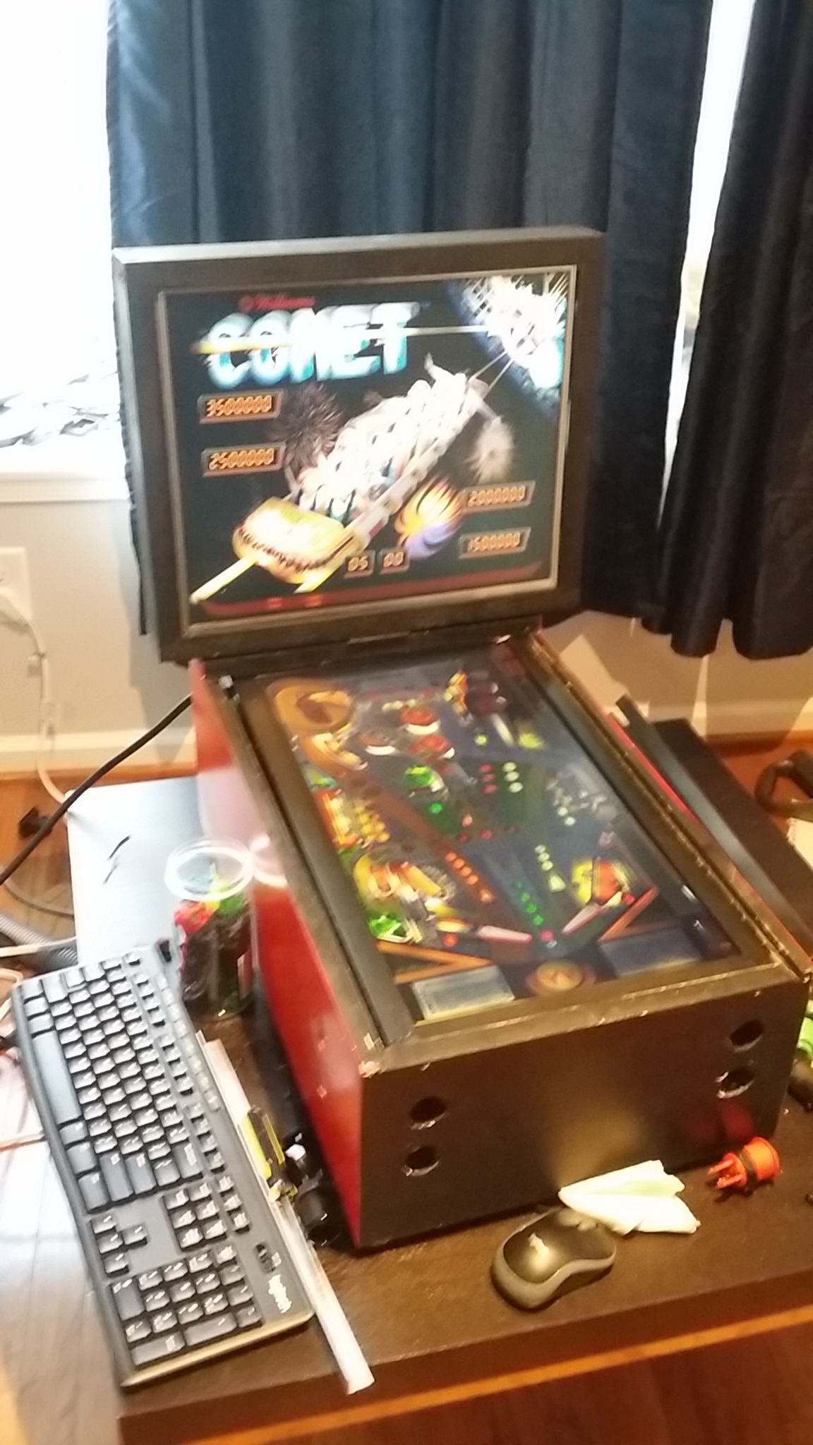

Both screens on:
Figured since Comet is the first pin I ever owned, it should be the first one fully set up!
Sacred Stiff shown, the backglass is fully interactive with the game, the spider spins to pick the bonus when you make the skill shot
Backbox folds down, just like a real pin!

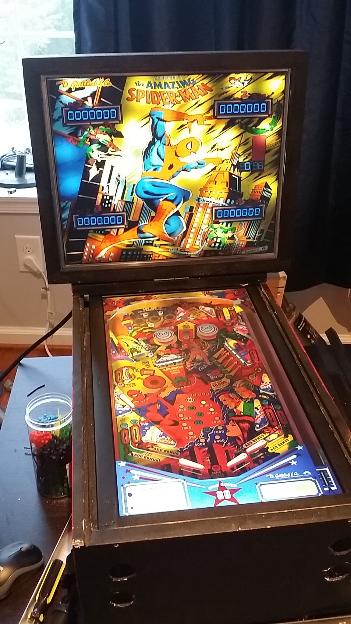

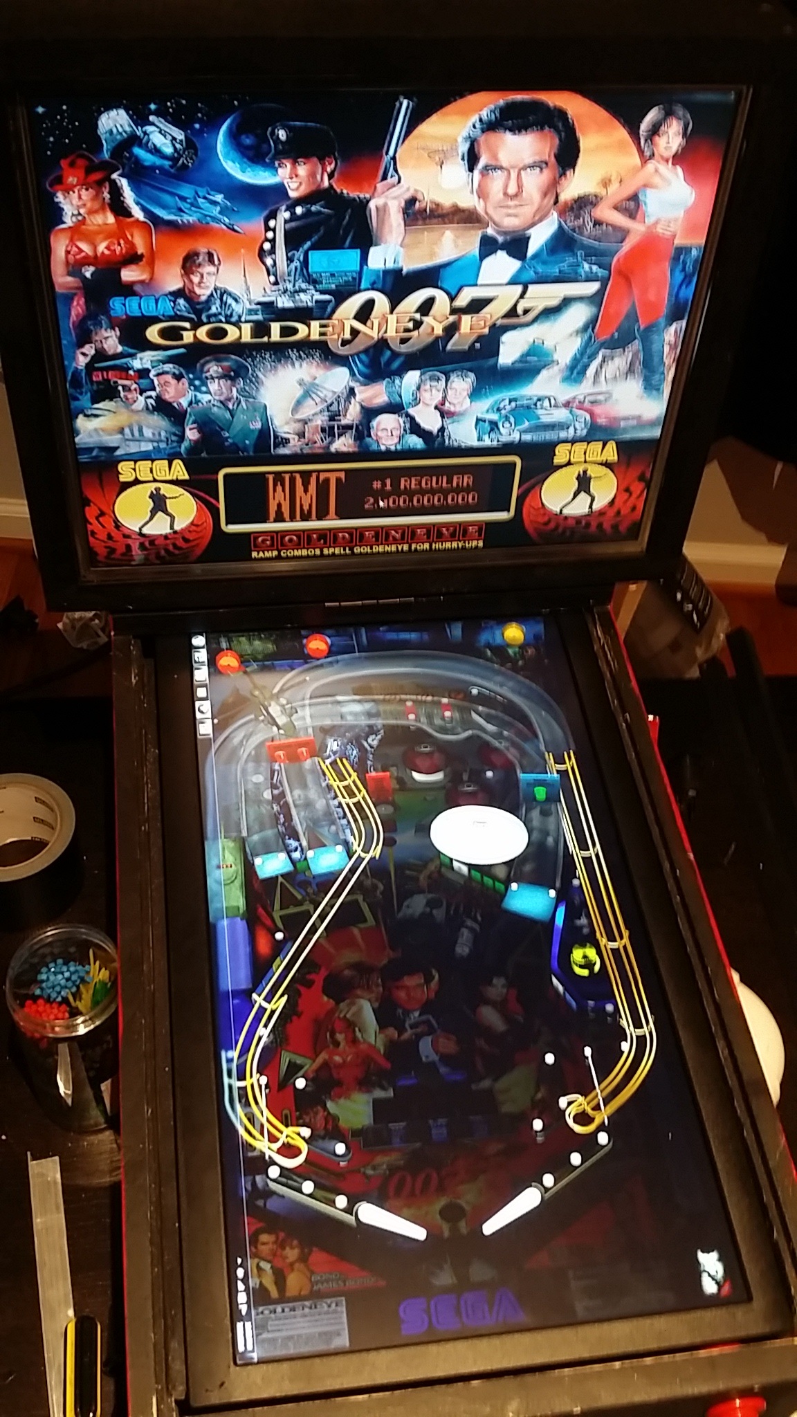

Gratuitous game shots:
Spiderman:

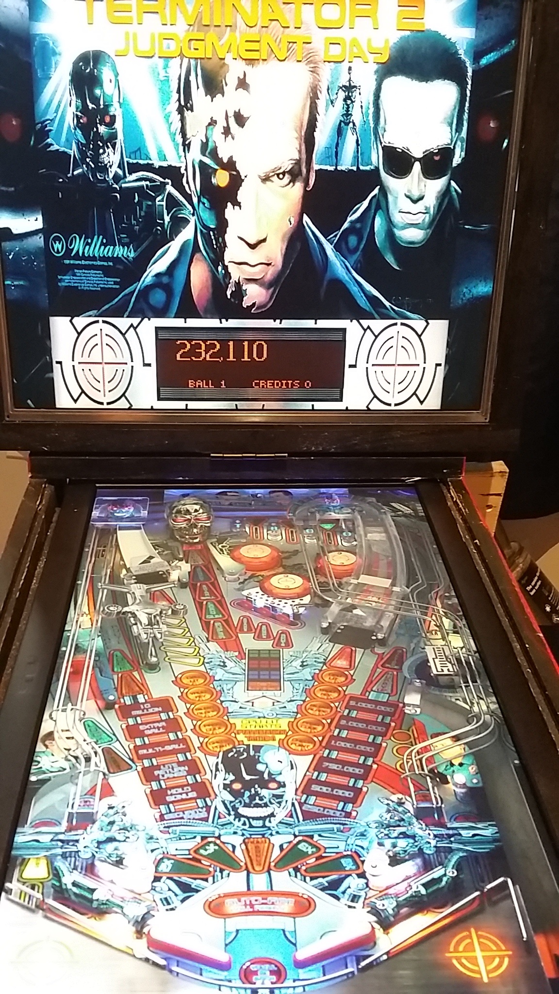

Terminator 2: (one of my favorite tables!)
and some goldeneye:
BONUS VIDEO MODE!
Here's a very short YouTube video of it running Terminator 2, just showing the DMD working on top of the backglass art on the second screen:

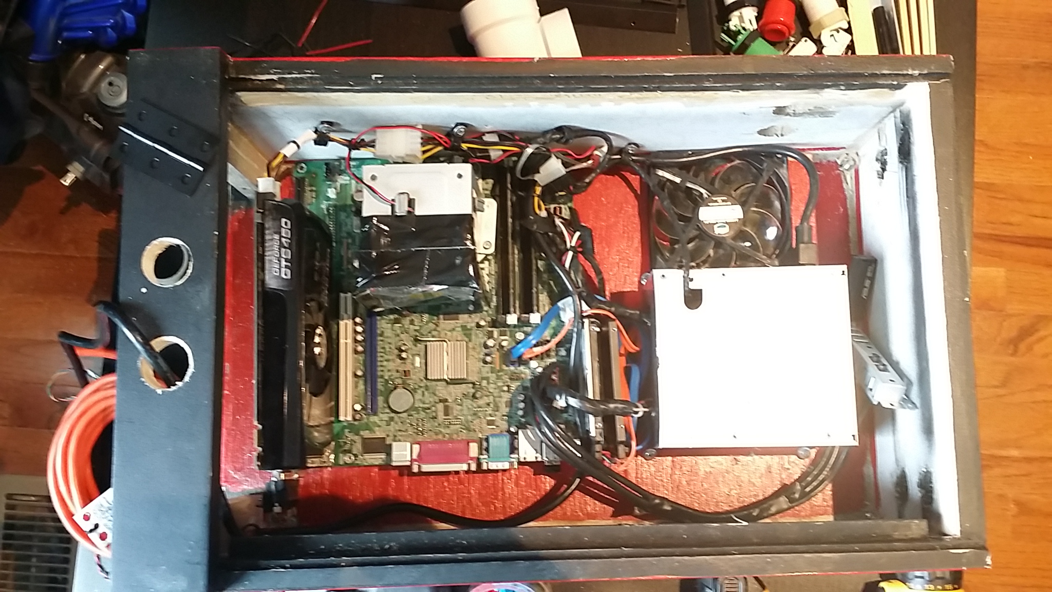

This is what the insides look like meow.
Might get shorter SATA cables and whatever else I can do to free up as much room as possible.
I spliced all the power cords together, wire nutted them off, then taped over. Im also going to be removing the front USB panel (its curled up in there somewhere) and just getting 2 short USB extenders since I dont need the extra ports, the devices just dont fit between the  mobo and the side of the cab.
