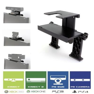

Any aimtrak users have any cleaver ideas on how to get your sensor bar to stay in place on top of your tv? I've tried scotch tape, double sided adhesive tape and electrical tape and because the TV slants a little inside the cabinet, the sensor bar over time comes off and falls. Beyond annoying. I have velcro tape but then there's an inch between the top of TV and where sensor bar the sensor bar sits, which might be the best of the worst options. Any thoughts (besides buy a sinden gun😜)? Thx
argonlefou
  • Posts: 1088
  • Last login:Yesterday at 02:18:27 am
Re: DemulShooter (Dual light gun on DEMUL, Model2, Dolphin, Silent Hill, etc...)
« Reply #1816 on: October 20, 2019, 03:53:11 pm »
I got this in my local supermarket for nothing totally by chance :
It's perfect and I can put both PS4 camera and aimtrak sensors
Thx Argon! I'll check it out.
