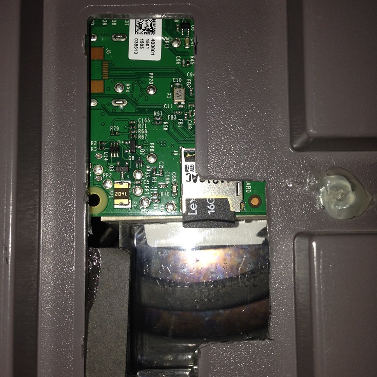

I started thinking about how to access the SD card on the Rpi, in case it ever gets corrupted and needs to be replaced.
The NES has an expansion port of some kind on the bottom. There is an easily removable access cover, but then there is a blank plate that has to be removed. Nothing s sharp knife couldn't handle.
Here is a pic of the bottom of the case, with the access door removed (red dot) and the blank plate removed (blue dot).
I placed the RPi in the bottom half to check for clearances. I placed the power switch assembly back in for clearance check.
I also have a USB plugged laid in the approximate place. This will be for the cheap NES USB controllers to plug into. Of course there will be two, this is still a work in progress.
I think this idea will work pretty good. If SD card needs to be changed, just flip case over, remove the cover and take the card out through the hole. It wont be easy, but that could be a blessing, since teh card should not have to be normally removed.

« Reply #1 on: August 03, 2015, 10:25:18 am »
I like the idea.
Putting the RPI in that spot would make it really hard to change out the SD card, not that you will be changing the card much.  Maybe put the access in the cartridge slot?

This should be a fun project. I made a little console from an Atari Flashback 2 and it turned out great. I upgraded it to the RPi2 when it came out. The Pi2 is much noticeably faster!
Looks to me like the memory card could be accessed easily from that expansion port cover the way you did it. Definitely watching this one. :cheers:

Yeah, Vidiot, I think it will be fairly good to get the SDcard out. Im thinking of cutting up a Tic-Tac box or something and gluing it to the inside to act as a pan to prevent the card from falling into the case if it is dropped while removing or inserting.
Thanks Jedi Master, Im still pretty new on the RPi also, so I will be relying on the others on here that are experienced when I set the Pi up (which I should be doing pretty soon.)
Hi reptilelink. I will not be putting a CP on this, but I do plan to use the USB Nintendo controllers that you can find on ebay pretty cheap. I suppose you could put together a CP with a usb keyboard encoder, but Im not sure how that would work with the Pi.
Hi Peabo, I thought about putting the butt end of the Pi in the game cartridge door, but Im wanting to put a couple of USB plugs there, and maybe a Ethernet connector.
I was thinking that accessing the card through the bottom might discourage exploring hands from pulling the card out.

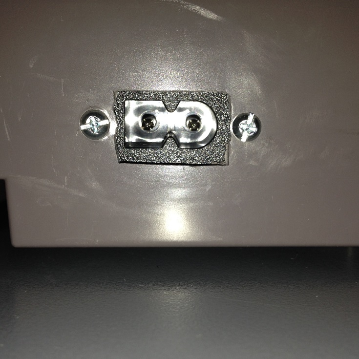

Been thinking about how to do the controller USB plugs. I had a panel mount USB female plug with a short cord and a male plug on other end.
I thought I would try this:
First I trimmed down the rubber part of the plug to form a flange about the same thickness as the flange on the original nes connectors.
I then ground top and bottom of the metal front plate of the usb plug to about the same length as the nes controller flange.
Here is a pic after my modifications, sorry didn't get a before pic. Edit: I do have a picture of this usb plug before chopping it, look at last pic in the first post.
I then inserted the usb plug through the front of the case, in the hole where the original controller plug fits.
I then installed the connector retainer plate and it worked pretty good. It is snug and wont push in or pull out.
The only thing I don't like is the space around the usb plug. I will have to cut a piece of black poster board or thin plastic to cover the space.
Now I got to find another USB plug like this one for the player two slot.
So far I haven't cut up the case, so I could change my mind and try something else, but so far this is looking pretty good to me.
EDIT: as you can see in pic two, I did cut one of the mounting posts that was blocking player two usb plug (or will be when I do that one). This post was part of the original circuit board mount, so i shouldn't need it.
I used a pair of diagonal cutters to get it out of the way, plan to clean it up with a dremel later.

I was going to mount the HDMI and the power entry block in the spot where the original power and AV converter plugged in, but there is simply not enough room.
So I decided to move the power entry to the right of the case.
Due to the mausberry switch, power cord connector, and HDMI cable taking up so much room on the Pi, I had to move the Pi towards the back of the case.
This meant I had to cut out part of the expansion slot opening to allow access to the SD card.
I also glued a tab to allow me to use a mounting screw in that corner of the Pi.
I used the tab off a Tic Tac box (you guys thought I was kidding about using a tic tac box, didnt you?)
I also found that the wall wart power supply fits rather nicely in the NES case, utilizing the mounting posts.

Mounted the power entry connector. Not as pretty as I would have liked, but I need more practice cutting out plastic.
Also mounted the HDMI output connector. It's a little crooked, may straighten it up later, but may leave well enough alone.

Mounted the modified tic tac box as a drop pan.
I also lost the tab I glued earlier. When I tried to drill a hole in it, it popped off. I think three bolts will hold the board anyway.
That cement glue is not like the glue I recall using on model cars when I was a kid. I guess drug users and glue sniffers are messing it up for everyone.
I glued the tic tac box, and a piece of cardboard on the side of it.
I also glued a piece of wooden popsickle stick across the top to keep the SD card from falling inside the case when inserting or removing it.
Not trusting the model cement, I went over it all with hot glue.
Here is how it looks from the bottom. The card will be easy to swap out.
