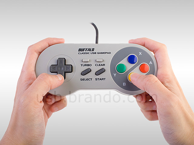

Just a quick note. This is one of the controllers I plan to use for this project.
It is a USB SNES controller (on ebay).
I plan to use this because it has the D-Pad (joystick), a pause button, a start button, and 6 action buttons.
This should work with NES, SNES, and Mame. (using the pause button as credit button for mame.)
And probably most other emulators.
Can i pull this off with RPi? I dunno, but going to find out.

That works just fine on a Pi, I'm using an actual SNES controller with a USB adapter and it works great.

The Buffalo Classic holds up about 1000x better than those no name controllers on ebay.

I like that buffalo controller, may have to get me two, but for now Im going with the already purchased ebay cheapies.
But it may not be long until Im forced to get better controllers. The cheapies don't look very rugged.

Just tried it on my TV and sound works just fine. (HDMI).
Ive been wasting a lot of time playing "Quake Arena". But I have to unplug my SNES USB controller and plug in a mouse to play correctly.
Guess I need to drag out my USB Controller with Dpad, analog thumb stick and the works.
Right now I have Retro Pie controlled by the SNES controller, I need to set it up to work with keyboard too, this swapping between controller and mouse is for the birds.
Of course if my panel mount USB cables ever get here I will have two more USB ports.
