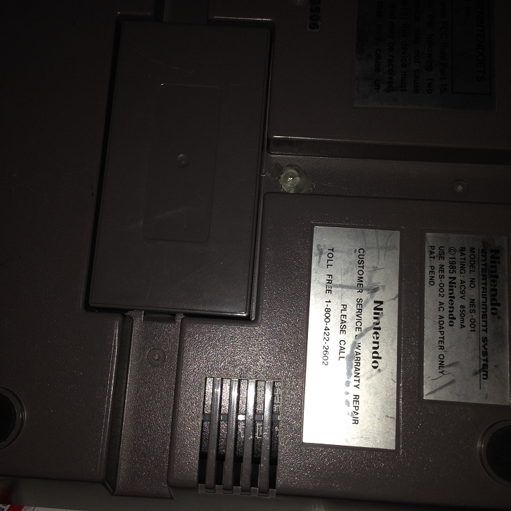

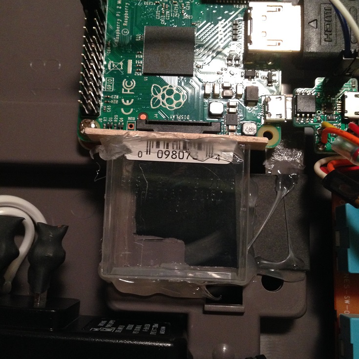

I started thinking about how to access the SD card on the Rpi, in case it ever gets corrupted and needs to be replaced.
The NES has an expansion port of some kind on the bottom. There is an easily removable access cover, but then there is a blank plate that has to be removed. Nothing s sharp knife couldn't handle.
Here is a pic of the bottom of the case, with the access door removed (red dot) and the blank plate removed (blue dot).

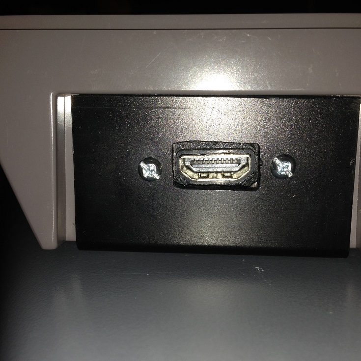

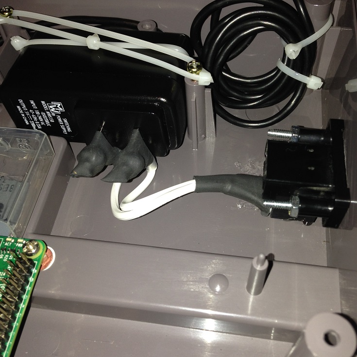

I placed the RPi in the bottom half to check for clearances. I placed the power switch assembly back in for clearance check.
I also have a USB plugged laid in the approximate place. This will be for the cheap NES USB controllers to plug into. Of course there will be two, this is still a work in progress.
I think this idea will work pretty good. If SD card needs to be changed, just flip case over, remove the cover and take the card out through the hole. It wont be easy, but that could be a blessing, since teh card should not have to be normally removed.

Looks to me like the memory card could be accessed easily from that expansion port cover the way you did it. Definitely watching this one. :cheers:

Yeah, Vidiot, I think it will be fairly good to get the SDcard out. Im thinking of cutting up a Tic-Tac box or something and gluing it to the inside to act as a pan to prevent the card from falling into the case if it is dropped while removing or inserting.

Hi Peabo, I thought about putting the butt end of the Pi in the game cartridge door, but Im wanting to put a couple of USB plugs there, and maybe a Ethernet connector.
I was thinking that accessing the card through the bottom might discourage exploring hands from pulling the card out.

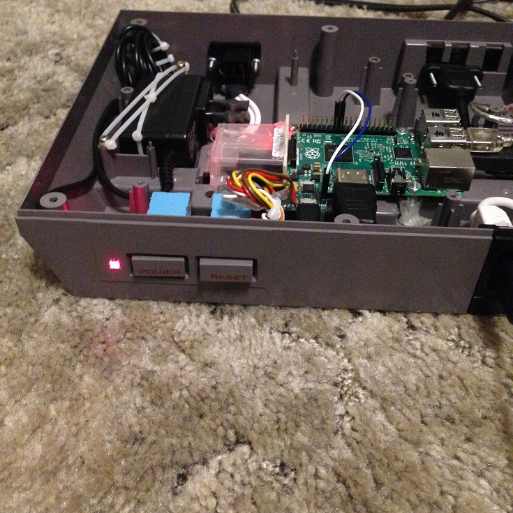

Ok, put the USB connectors on the back burner for awhile and been playing around with the mausberry switch circuit.
This switch came with no wiring diagrams and I cant find hookup diagrams on the net, except for the simple power switch and reset switch connections to the circuit.
I have not found how to hook up the LED on the NES.
All I have found is people tying it back into the I/O on the Pi.
The circuit has a pad for LED, but only one.
I turned it on and measured voltage and got about 2.5 volts between the led pad and the - pad for the reset button.
I hooked up the on the NES: orange to the led pad and white to the - reset pad. I also placed a 50 ohm resistor in the orange wire.
The led lit up pretty good. So I though it would be simple. Red and Brown wires connect to the SW pads, Yellow to reset pad, white to LED pad, and orange to the other Reset pad.

Just a quick bump to say that I have the NES switch module, board, circuit, whatever, soldered into the mausberry switch circuit.
Here is the required eye candy:
I wound up using a 51 ohm resistor in the white wire, it was the closest I had to a 50 ohm. I also covered the resistor with clear heat shrink.
It comes on when I press the ON switch, and the LED lights up.
I have got to download the correct code to allow the mausberry to shutdown correctly.
I currently have PiPlay on the sd card and the commands that mausberry website says to use to download and install the script is not working. I think I need to go with a different Pi setup. This is all new to me, whats that old saying about old dogs and new tricks?

I glued the plate I made into the cart slot on the top of the NES case.
Here is a shot of the back side.
I first used model cement. I glued the part I had cut out so that the plugs will be facing outward. I then cut a smaller strip and glued it in the space at the bottom.
The top half of the cover is turned upside down in this pic.
I also glued 3 cut off qtips (cotton swab sticks), to the sides and top to help brace it.
I didnt trust the cement all that much (they dont make it like they used to), so I went around the whole thing with hot glue.
And here is a view from the front. I mounted the NET connector, still waiting on the USB connectors to get here.
Now I am concentrating on mounting HDMI & PWR on the bottom case back, and AV RCA connectors on the bottom side.

This meant I had to cut out part of the expansion slot opening to allow access to the SD card.
I also glued a tab to allow me to use a mounting screw in that corner of the Pi.
I used the tab off a Tic Tac box (you guys thought I was kidding about using a tic tac box, didnt you?)

Mounted the power entry connector. Not as pretty as I would have liked, but I need more practice cutting out plastic.
Also mounted the HDMI output connector. It's a little crooked, may straighten it up later, but may leave well enough alone.
I used another piece of the black plastic project box.
Mounted the modified tic tac box as a drop pan.
I also lost the tab I glued earlier. When I tried to drill a hole in it, it popped off. I think three bolts will hold the board anyway.
That cement glue is not like the glue I recall using on model cars when I was a kid. I guess drug users and glue sniffers are messing it up for everyone.
I glued the tic tac box, and a piece of cardboard on the side of it.
I also glued a piece of wooden popsickle stick across the top to keep the SD card from falling inside the case when inserting or removing it.
Not trusting the model cement, I went over it all with hot glue.
Here is how it looks from the bottom. The card will be easy to swap out.

I got more work to do with this setup, turning the power button off does not shut the Pi down.
Here is how I wired the power connector to the power supply.
I soldered lamp cord to the power connector terminals, then used ring crimp terminals on the power cord ends.
Then using 4-40 bolts and nuts, I fastened the crimp terminals to the power supply plug prongs, which had holes in the ends.
I then put heat shrink over both prongs for insulation.
I fastened the power supply down with wire cable ties. the power supply is located over a vent so it should stay cool.

BTW, If any of you guys decide to build one with SD card access through the expansion slot cover, I highly recommend you incorporate a catch pan (AKA hacked up Tic-Tac box).
I have dropped the micro SD card twice and the pan worked just fine. It caught the card and made it very easy to retrieve.
Not patting myself on the back (well maybe I am), but I have to say it was one of my better ideas.
Also, side note, the mausberry switch circuit works great!
