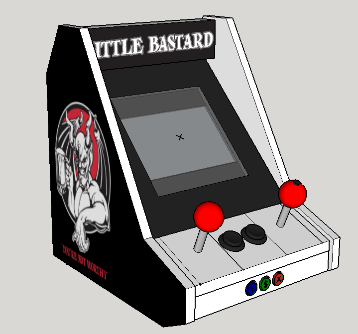

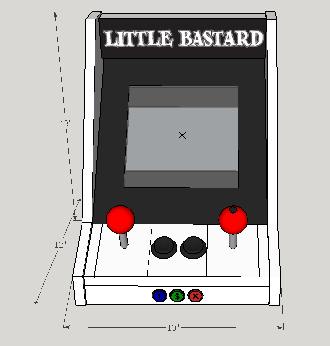

I've been planning on doing a second bartop to fill in some of the gaps in games I like to play, and recently picked up one of the 7"Winbook windows tablets for $60.  After playing with it a bit thought it could be made into a nice little mini bartop, and to go one step further it's going to have an automatic rotating display.  I've been asking questions around, have parts ordered, and been working on a sketchup model.  I will be going the direct drive servo route such as byancey did on his here.
The shape is based off the Zaxxon/Super Zaxxon cabaret cabinet, fairly simple, but not like everything else out there.
So here is the front view, single player, dual joystick, yes a button top ball joystick because... Battlezone

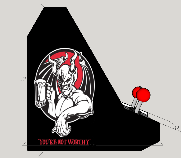

Here is the side view showing the theme of the cab, artwork still a work in progress, but k.i.s.s. is what I'm going for.

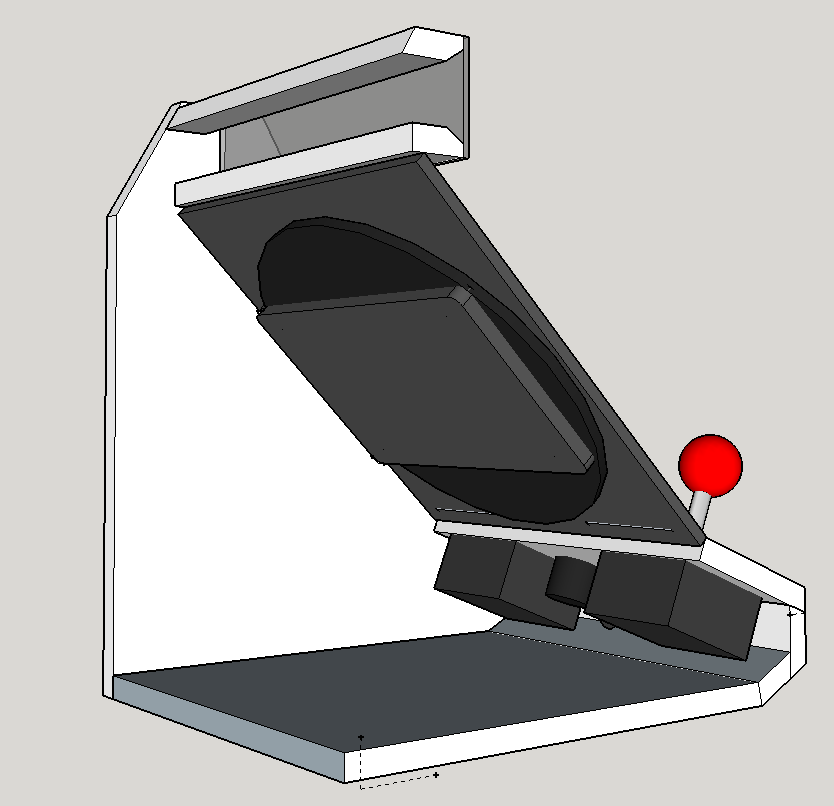

A 3/4 rear cutaway view showing the rough design for the tablet mount and rotating bezel piece.  Will be a round bezel behind the front rectangular one.
And finally a overview shot.

Question for the peeps.  does anyone see a reason for more than the 2 buttons I have on there?  I may be able to squeeze a third on there, and maybe a 4th if I stack them tight.  What will I be missing out on?  This is going to be setup with dual 8-way joysticks, my other machine is setup for 4-way.
My Projects:
  • Posts: 9734
  • Last login:Today at 04:23:32 am
Re: Little Bastard - a mini rotating display bartop
« Reply #5 on: January 14, 2015, 08:40:07 pm »
A quick review of the dual joystick (2/4/8-way digital, not analog) games list here yields only four with more than 1 button:
* Assault -- 2 buttons
* Cyber Troopers: Virtual On -- 4 buttons per player
* Sarge -- 2 buttons per player
* Vindicators -- 4 buttons per player
Thanks for the list Scott.  I was more thinking of single stick 8-way games as I do plan on running Zaxxon, Xevious, 1943 etc on here as well.  Will I really just miss out of the fighting games of which I never really played much?

Evidently I'm still not good at taking progress pics.  Attached are a couple I found showing the monitor/tablet setup.  Parts are from:
Servocity
  • HS-485HB Servo Product 33485S
  • Hub Servo Shaft Combo Product 525122
  • 1/2 inch Bore Flat Bearing Mount Product 535118
Pololu
  • #1350 Micro Maestro 6-Channel USB Servo Controller
In the assembled attachement you can sort of see how it is put together.  The aluminum plate that is attached to the servo shaft sandwiches the tablet with wood spacers to the round 5mm plywood bezel (back side shown).  Hope that makes sense.
My Projects:

What method did you use to transfer the arrogant bastard logos?
BorgDog
  • Posts: 436
« Reply #22 on: February 24, 2015, 02:42:25 pm »
Well, after I finished putting the satin clear over the stain I thought of using the ink jet transfer method which would have been cool, maybe next time.
Instead this is just a simple print on full sheet "clear" Avery labels which are actually more translucent.  Using the same sheets for my simple printed marquee, print mirrored stick on back of plexi.  I actually like the effect, kind of a weathered/aged look on the wood, probably not for everyone though.
