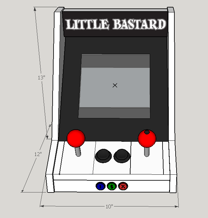

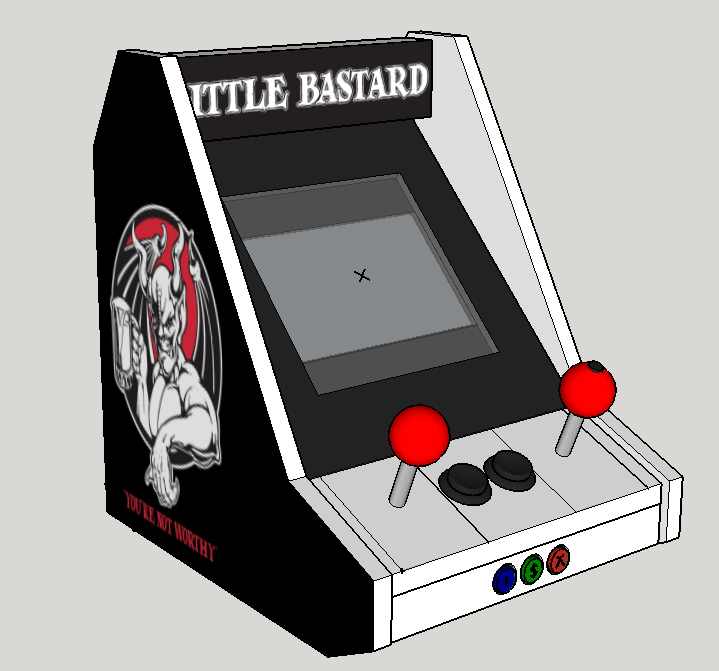

I've been planning on doing a second bartop to fill in some of the gaps in games I like to play, and recently picked up one of the 7"Winbook windows tablets for $60.  After playing with it a bit thought it could be made into a nice little mini bartop, and to go one step further it's going to have an automatic rotating display.  I've been asking questions around, have parts ordered, and been working on a sketchup model.  I will be going the direct drive servo route such as byancey did on his here.
The shape is based off the Zaxxon/Super Zaxxon cabaret cabinet, fairly simple, but not like everything else out there.
So here is the front view, single player, dual joystick, yes a button top ball joystick because... Battlezone

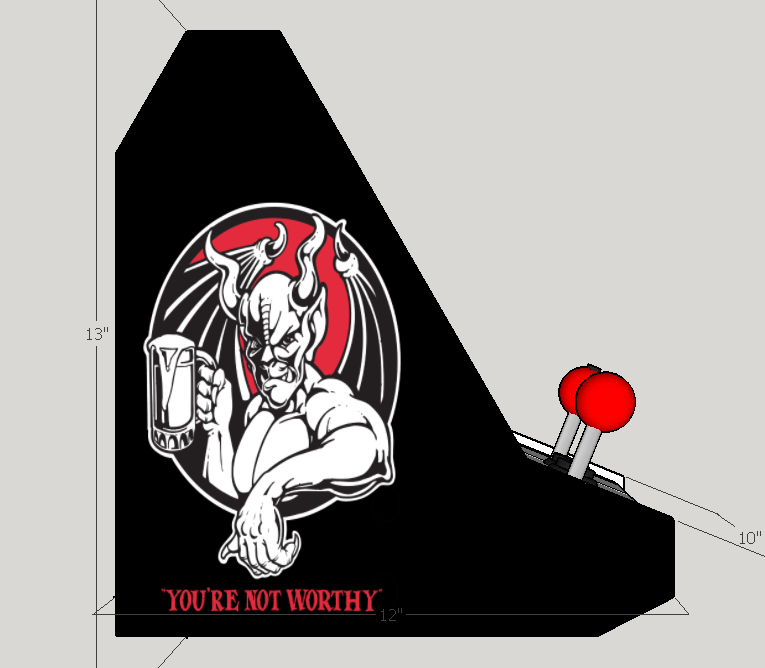

Here is the side view showing the theme of the cab, artwork still a work in progress, but k.i.s.s. is what I'm going for.

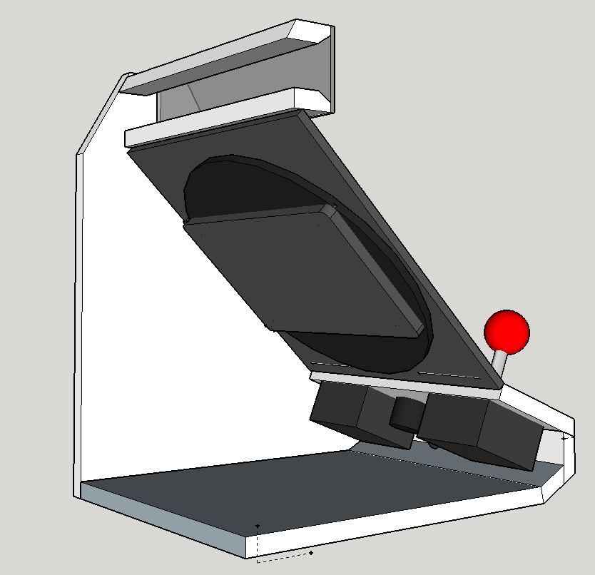

A 3/4 rear cutaway view showing the rough design for the tablet mount and rotating bezel piece.  Will be a round bezel behind the front rectangular one.

Evidently I'm still not good at taking progress pics.  Attached are a couple I found showing the monitor/tablet setup.  Parts are from:
Servocity
  • HS-485HB Servo Product 33485S
  • Hub Servo Shaft Combo Product 525122
  • 1/2 inch Bore Flat Bearing Mount Product 535118
Pololu
  • #1350 Micro Maestro 6-Channel USB Servo Controller
In the assembled attachement you can sort of see how it is put together.  The aluminum plate that is attached to the servo shaft sandwiches the tablet with wood spacers to the round 5mm plywood bezel (back side shown).  Hope that makes sense.
