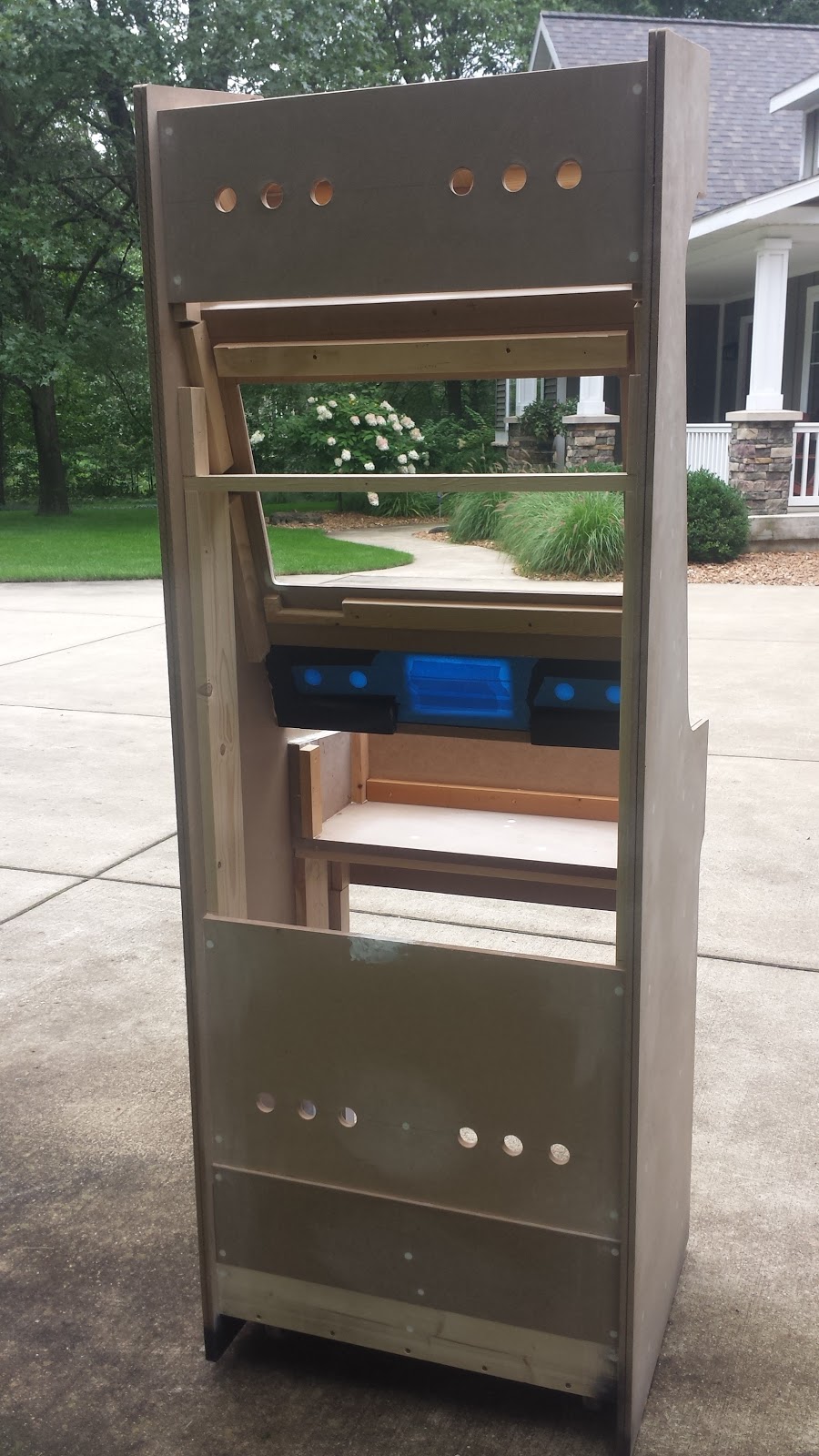

Re: "Avengerless Avenger" - [8/24/15] Cabinet Assembly Still Underway
« Reply #95 on: August 24, 2015, 05:02:14 pm »
Most of the screw holes are filled.  A few still in-progress.  Also, remembered that the reason I bought MH Ready Patch in the first place was that it's supposedly good for filling gaps between MDF boards (derp).  It acts a lot like bondo.  So, I'm working on filling those gaps, too.
Trimmed 1/4" off the bottom of the side panels for clearance.
Routed the T-molding channel.  If you look closely, you can see a few inches where the slot is a bit wider because the bit walked out of the router a little; and I had to re-route it centered.  I'm hopeful that the correctly-centered slot on either side will hold it adequately in place.
Started the marquee box, and attached a couple MDF panels on the back (not really visible in this pic).
Also, painted the bottom panel, so I could permanently attach the wheels and stand the cab back up.
Before I paint the rest of the cab, I need to:
* Finish attaching the back panels
* Add furring strips to support the front/rear access doors
* Finish building the lightbox for the marquee
* Develop the mounting system for the CP (I have magnets.  Lots of them. The same mounts will need to be duplicated on top of the cab, where I can swap out the flat KB/mouse panel.)
With any luck, I should be ready to paint after next weekend. Which is good, because Winter is Coming.

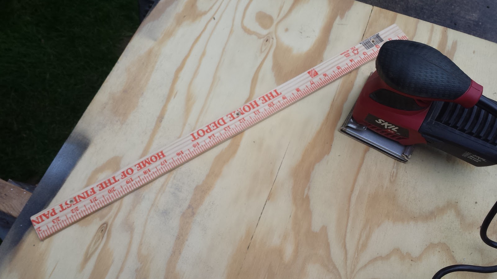

Got everything assembled, for the most part.
Very basic lightbox made from scrap wood I had lying around.  Couldn't really make it completely enclosed, since it's pretty tight on space, and it needs room for the buttons and whatnot when the control panel is mounted on the top.  Will be lit with LED tape (drilled a hole to make room for the power cable).  I was going to use a fluorescent bulb, but just didn't have enough room for it.
Found the retainer strip I'll mount above the monitor to keep the screen glass in place.  It's just a 90-cent ruler from Home Depot, cut to size with screwholes drilled and countersunk.  Also filed a taper on the top edge of the back, so it sits flush with the speaker panel above it.
It had markings and indentations on both sides, so I took my power sander to it.  Should work just fine.  It'll get painted black to match the cab.
Drilled some vent holes in the back.  While I did this, I dropped the drill and took a chunk out of one of the MDF panels.  So, there's another spot to patch up.  I think I might put another 8" of fixed panel on the back before I paint back there.  That way, the access door won't be quite so enormous (and I think I'll still have plenty of room to reach the components in the back.
Masked off the admin panel and the parts I'd already painted on the bottom...
And now I'm priming it.  Using a spraycan for both sides of the front sections, with all the random nooks and crannies.  It's crazy how rough MDF gets when you spray it with primer.  So, lots of sanding to do.  I have a gallon of Kilz and foam roller/brushes for the rest.
Ignore the bowing in the MDF below the marquee.  You don't see that.  And you'll see it even less once the marquee retainer goes on.

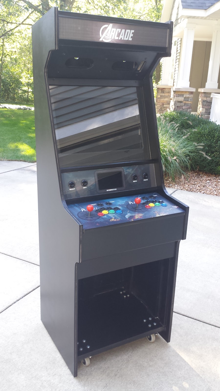

Two coats of primer on. Black satin paint starts going on tomorrow. The waiting between coats is killing me.

First coat of Rustoleum Black Satin Paint.
Any recommendations on how long one should wait before sanding oil paint and applying the second coat? The can says fully cured in 24hrs, but I'm skeptical.

Re: "Avengerless Avenger" - [9/16/15] Painting Complete
« Reply #111 on: September 16, 2015, 08:14:22 pm »
Paint's done (except for the control panel, which will immediately get covered up with overlay and T-molding)
Marquee plexiglass mounted using clear plastic wall corner guards. Attached to the cab with screws + EZ-Loks. After taking the photo below, I took off the corner guards and painted the inside surfaces with black spray paint (which is currently drying).
Rear door attached using a pair of 12" piano hinges. Currently just taped shut until I screw on the window sash lock that'll keep it closed.
The plastic retainer clips that'll hold the speaker cover on had to be hammered into place. Unfortunately, that hammering completely dorked the joints I'd patched between the speaker panel and the panels above and below.  Luckily, the lower joint is totally covered by the monitor glass retainer. The top joint, I'll need to fix.

Re: "Avengerless Avenger" - [9/21/15] Control Panel Assembled
« Reply #112 on: September 21, 2015, 07:13:10 pm »
Making more progress...  Printed some temporary marquee art on paper and installed it.
CP art applied, T-molding attached, and controls installed...
I bought magnets with the intention of using them to keep the CP secure, but I honestly don't think I need them.  It sits perfectly in place with just a furring strip attached to the bottom to keep it from sliding off the front of the cab.
The control panel can also be moved to sit on top of the cab.
I cut a flat panel from a piece of 3/4" melamine-coated shelf.  This can be swapped with the CP to provide a surface for KB/mouse gaming.  It's only temporarily white.  It'll get vinyl art applied when I order the side art.
