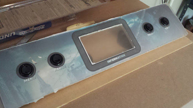

I cut myself a template to rout the inset for the joystick.
It actually worked.  Imagine that.  Unfortunately, the joysticks are just slightly off center as they come through the hole that's drilled.  Despite all the painstaking effort I put into making sure the cutout was centered on the pilot hole, my lack of a drill press meant that the pilot hole on the back was slightly skewed from the front.  I think I'm going to need to tweak the CP art a bit so this isn't quite so obvious.
Then I widened the cutout so I could rout the inset in the back of the admin panel where the screen will sit.
After routing the inset, I cut a piece of plexiglass to match the admin panel, slowly drilled pilot holes and then button holes through both the plexi and MDF at the same time, and then routed the edges of the plexi to match the MDF.  This turned out much better than expected.  Here's the admin panel with the plexi on top of it.
Using my cutting template to test out the art.  I think I need to widen the screen opening a bit on the left. (The white parts around the screen will be black on the actual art.  This was just my cutting template.)
Checking to make sure the screen fits in the final product.  It's all blurry because there are still 3 layers of protective decals in place between the plexi and the screen.

This build is looking nice.
That admin panel with the 7" display is slick looking

Thanks, mgb...
Unfortunately, the joysticks are just slightly off center as they come through the hole that's drilled.  ... I think I'm going to need to tweak the CP art a bit so this isn't quite so obvious.
Phew!  Dodged one bullet, at least.  I sampled my art from the cutting template on the finished control panel, and luckily the dust washer covers enough of that compass/directional pattern that it's not obvious that the joysticks are slightly off-center.  I was afraid that some of the inside corners would show up, and others would be hidden.  (And that green button really is centered on the art.  The paper just got a little loose under it when I was putting in the buttons.)

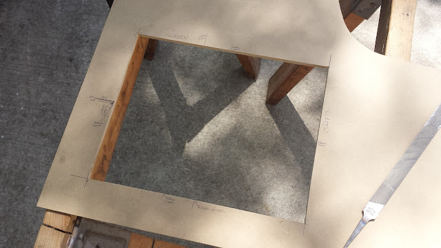

After spending an hour-and-a-half laying out my monitor bezel's dimensions, then proceeding to ruin it beyond repair, I came to a conclusion tonight
Eff this stupid bottom-bearing router bit.

Attempt #2 on the monitor bezel.  I almost made it through without an error, but then my template slipped as I was rounding out the last corner.  Annoying, but easily manageable.
Getting closer and closer to where I can start assembling everything.  Woo.

I didn't really show how the 7" admin panel screen is secured in yesterday's photos.  I guess I'm easily impressed by my own over-engineering, so here are a couple more photos...
I used my router to create an inset (hard to see when everything is painted black), so the screen is closer to the front of the admin panel than the 1/2" MDF it's made of.  Also, I've decided that I love EZ-Loks, and plan on using them all day long.  They're used here to secure the screen retainer, I'll use them on the joysticks, the marquee retainer, the speaker & monitor retainer straps, and the main screen's glass retainer.  And pretty much anywhere else I can think of.  100 of them only cost $5, so I'll get my money's worth.
The PCB for the 7" screen is held in place by "L type PCB feet" that you can buy at Ultimarc / GGG.  I bought enough feet to secure 8 different PCBs for 8 bucks on FleaBay.
The 7" screen (with the protective film still in place)  is stuck to the other side of the 1/4" MDF retainer with velcro tape.  This way, when I remove the retainer, everything comes off in one easily-manageable piece.
Here's the admin panel with the bottom trim piece in place (which will get painted with the rest of the cab).  Here I'm giving it a quick test run.  I'm not terribly impressed by the viewing angles on this screen.  Hopefully it's okay at the angle I have it set up (and maybe it'll look a little better without the screen protector still on it).  EDIT 10/17/2016: Almost a year later....  I realized that by flipping the 7" display upside-down, it is now perfectly viewable.  Before, I had to stoop down to see it.  Took a bit of Dremeling to get it in there after-the-fact; but it's much better now.
