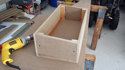

I think I'm finally to a point where I can start posting this bad boy.  My plan is to start cutting over the New Year's holiday.  (2/5/15: Nope.  Maybe someday when it finally thaws outside.)  Might as well post now so somebody can kick me before I do something stupid, since I'm new at this and all.
My cab is going to be a 6ft tall stand up with a 23" LCD monitor.  I've thrown together a Sketchup drawing, and I think I'm happy with the design now.  The large front panel under the CP box will have inset hinges and will open to give me access to the PC and a shelf to hold things like keyboard, mouse, controllers, etc. (2/5/15: Nixed the shelf.  I'll actually store stuff in the box under the CP.  Directly below the CP box there will be a fixed panel with a USB hub integrated into it for USB console controllers.  Below that the door to access the PC from the front.)
The CP will be detachable, and can be interchanged with a flat panel attached to the top of the cabinet (inspired by markc74's Blip cab).  My intention is to swap in the flat panel when I want to play non-arcadey KB/Mouse games on the PC.  The CP is 5/8" pine overlaid with 1/8" plexiglass; and the flat panel will be painted 3/4" MDF. (2/5/15: CP will be 3/4" MDF overlaid with printed polycarbonate from GameOnGraphix)
Underneath the main monitor, I'm including an admin panel with a secondary 7" LCD that'll display the instruction card for the game being played.  The admin panel will be overlaid in plexiglass.
My first step will be to build a frame.  It's made up of 1x4 boards with a 1/2" MDF base.  The base is 24" wide and 20" deep.  I honestly don't think the frame will provide a ton of structural support; the 3/4" MDF making up the sides and much of the front/back will probably do most of the work.  That being said, I think I may still make a couple tweaks to make it a little more structurally sound, like making those side boards on the underside extend all the way to the front of the base, and adding some cross-braces to the vertical boards.  It'll all sit on 3" casters (fixed wheels in the back, swivel casters with brakes on the front). The door in the front will also make it easier to reach the brakes on the swivel casters.
Still haven't designed the CP, but I think I still have a couple months before I really need to get to that part.  Kind of waiting to see what Andy has in store for the I-Pac boards in late January.  I'm thinking I'll take advantage of the X-Input adapters, which I assume might make the cabinet a little more Steam Game Library-friendly.
Anyhow, I've been playing a lot of Borderlands lately, and I've taken a liking to the comic book / cel-shaded look.  I think my design will be similar to that, but not based on any specific game.  Honestly, I don't think I want to give it a name.  Just some kind of cool, very minimalist graphics on the marquee, sides, etc..

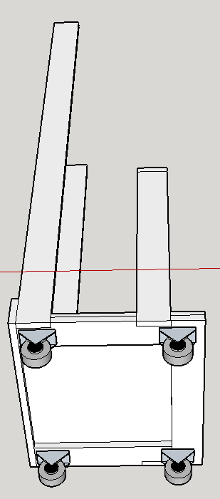

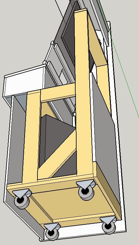

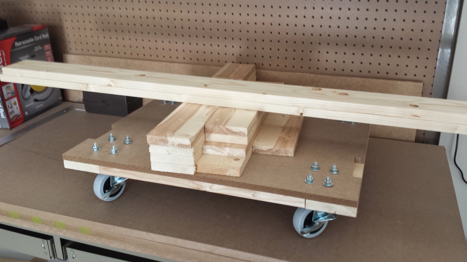

Redesigned the frame.  I think that's a lot more structurally sound than what I had.
Also bought myself a speed square so I could get some nice square cuts; and also bought a spare 2x4ft sheet of 1/2" MDF so I could make a sawboard, since I don't have a table saw at my disposal.
Let's do this!

« Reply #2 on: December 31, 2014, 03:10:31 pm »
You really don't need a frame to make it sound. If you look at original cabs, NONE of them have any internal framework.
And I've never been a fan of 7" insert screens, but I do have to say, I like how you've integrated yours. It helps get rid of all that wasted space under the monitor. The way you intergrate it with your artwork will really make or break it. Keeping an eye on this one.  :cheers:

Re: RxBrad's Nameless Cab - SketchUp drawings, about to start cutting
« Reply #3 on: December 31, 2014, 03:21:22 pm »
Yeah..  I know. Might as well build it like a tank, I figured, so I know it'll live through whatever abuse comes at it.  :bat
That, and I'm paranoid that it'll be topheavy & tipsy, so the frame adds a little junk in the trunk.
As much as anything, it makes it a less likely for me to build the cabinet and have it end up not being square.
« Reply #4 on: December 31, 2014, 03:24:11 pm »
It's not very fun moving a tank. Original cabs were held together with brackets like these.
« Reply #5 on: December 31, 2014, 03:28:42 pm »
OK.  Maybe a wimpy little sissytank then.  :)  I'm only using 1x4's, so the frame is actually fairly light.
I actually spent 5 minutes at the Home Depot this afternoon hovering over a bin of similar brackets trying to decide if I wanted to use those instead of furring strips.  My cheaper side got the best of me, and I decided to stick with the furring strips.
rablack97
  • Posts: 2215
« Reply #6 on: December 31, 2014, 04:44:36 pm »
Old maximus pulled it off.....
However, furring strips, screws and woodglue will do just fine sir....
The internal structure you got goin on is overkill, it will be a tank though and beotch to move.......Looks good though.

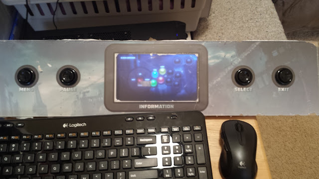

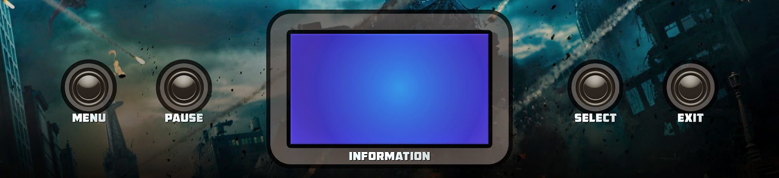

Spent most of my day fiddling with Photoshop.  Managed to get a control panel, admin panel, and marquee out of it, though.  Obviously, I've scrapped the cel-shaded theme, and ended up on more of an Avengers-style cab.  Without any actual Avengers.  The "Avengerless Avenger Cab"?
Whatever..  Here's what I have.  I can't help but think that the admin panel is missing something, but I can't quite figure out what.  It might get a redesign.
Dude, I ---smurfing--- COMMEND you to the nth on your art style choices. Less CAN be more sometimes. Yes!

I have to admit I was pretty damn impressed by the artwork too.   :cheers:
What do you use to drive the little information screen?  I'm guessing its like game instructions and what not?
Thanks..  I can't help but think that I'm breaking some unspoken rule by putting a big generic "The Arcade" on the marquee, but I like it.
Now I need to figure out what to do for side art.
It's a 7" screen that most people apparently use for Raspberry Pi setups, but it also has an HDMI port for use on a PC.  Here's a link.  And, yeah.. my plan is to have it show the instructions at the very least.  Maybe have it rotate with game info/history/other stuff.
EDIT:  Just noticed that there's now a higher resolution version for the same price.  And with a black bezel.  Nice.

Keep it minimalist. I love the use of an environment instead of a generic collage of 'roided out characters trying to look as tough as Hans and Franz.  That's so played out... this is fresh and innovative.

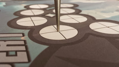

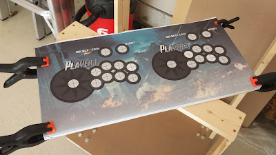

I just realized that I have access to an inkjet plotter.  Woo.
Okay.. so I may have gotten a little overexcited and printed the version with the buttons which won't really work for my CP.  But I can use it to get a good idea of the scale.
This does lead me to a question, though...  What's the best way to go about drilling the CP.  My ultimate plan is to get my CP printed by GameOnGraphix.  Would it be best to clamp the wood, plexi, and art from GoG all together and drill through all three layers at once?  Or should I separately cut the holes in the art using an X-Acto knife?

If you let GoG print on polycarbonate you don't need plexi on top. Order a drill template when you order the CP at Gog. Use the drill template to mark the holes to drill. Drill with Forester bit or Spade drill. Afterwards apply the CP. You can use bottom lighting to align the printout. Use a sharp knife (e.g. x-acto) or use your router to flush trim the holes.
Is it bad to cover the printed polycarbonate with plexi?
I know for a fact that I want plexi over the admin panel under the monitor, because I don't want that 7" screen uncovered.  Should I consider getting my CP art printed on some other material?.  (I'm pretty sure that anything off the inkjet printer at work is going to fade over time, so I probably don't want to use that for the final product.)
AzureKnight
  • Posts: 474
GoG has two options for printing, based on whether or not you are using plexi.  I went with the non-adhesive backed option that sits under the plexiglass.
Their printing quality is top notch.  I am very happy with the work they did for me.  I did add the print template and I would HIGHLY recommend it.
For drilling I used the print template to drill the wood CP.  I then clamped the plexi to the CP and used that as a guide to cut the plexi.  I would NOT recommend doing it in one shot, you will destroy the plexiglass.  In fact if you haven't cut plexi before I recommend you get some scrap (the corners?) and practice.
The last thing I will add is that the plexi does hide some of the art.  I'm overdue to add some photos to my build thread but the lower lighting in my basement, coupled with the plexiglass glare has rendered some of the detail on my CP art a lot less noticeable than I would have liked.  Since you do have a printed copy you might want to look at it in the lighting under your plexi before ordering the final art.

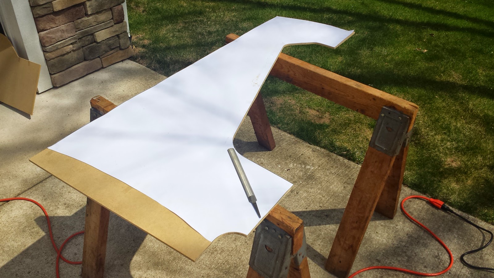

The weather continues to be a steaming pile of winter poo, so no actual construction has happened yet.  I have been playing around with the software I'm using, and I've managed to get the secondary display working how I want using GameExtender/GameEx.  I used CPWizard to create a PNG of the controls for each game.  Then I tell GameExtender to look in the folder where I store all of those PNGs, and display the one that corresponds to the game I'm playing.  That 7" monitor is surprisingly good quality for $50, and seems really well-suited to a project like this.  I'll try to post a picture sometime in the next few days.
Anyhow..  I think you've convinced me to use 3/4" MDF for my CP and NOT use a plexi overlay.  Those GoG CPs just look too nice to cover up.  The admin panel will still have a plexi overlay, but honestly there's not really much to the art there, so if something is concealed a little, I won't worry too much.

EDIT:  Hmm..  I really need to add something to the top half, where there's just a bunch of empty black space.  Or maybe just leave it blank.  *shrug*  We'll see.

Obligatory SketchUp render with art applied.   8)
It's a fairly complete version, just missing the speaker grills and the USB hub below the CP.

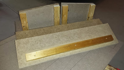

Finally got a chance to start building my cabinet this weekend!
First off, I made myself a double-barreled sawboard for my circular saw (works using both edges of the saw).  I'll spare the details, since there's already a sticky for sawboards; but I go into more detail in my blog.
The base was cut from 1/2" MDF, 19.25" x 24" (this 24 inch width is the factory cut width of the 2x4ft MDF sheets I'm using throughout this project).  Reinforcing 1x4 boards are glued with Gorilla Glue and screwed to the bottom.  Before attaching the 1x4's, however, I had to cut notches with my jigsaw for the vertical attachment points on the frame (visible in the second picture below).
Two fixed-wheel casters are bolted to the back, and two swivel casters are bolted to the front (where the brake can be easily accessed when the cabinet door is opened.  When attaching the swivel casters, I had to make sure that there was clearance for them to spin with the brake both engaged and disengaged.  The holes were drilled using a slightly larger diameter than the guide holes in the actual casters, to allow a little bit of error in the hole placement.  The casters are only loosely attached for now, because they'll need to come back off when I'm ready to paint.  Also, the swivel and fixed casters were slightly different heights, so I had to use washers to even them out.
I also cut all of the boards necessary for the frame using my trusty speed square.  And that's all the time I had to work on my project this first weekend.

"Avengerless Avenger" - [4/20/15] Frame Complete; Side Template
« Reply #36 on: April 20, 2015, 09:28:33 am »
Continuing to make slow progress.  Finished the frame.  Realized that the braces connecting the front and back posts would have absolutely no purpose once the sides were attached, so I got rid of them.
Then I made a wooden cutting template for the sides using 1/4" MDF.  I only templated the top 2/3rd, since everything below that involves just a single vertical cut.  This allowed me to use a single 2x4ft sheet of MDF.  Next weekend I'll cut the sides with my router's duplicating bit.
I started by printing a full-scale outline of the side and taped it to the MDF.  I cut out template with jigsaw, and used a straight file to straighten the lines and make the cuts better mimic the paper template.
For the sharp corners on the front/top, I traced around a metal washer, and used the outline to file the corners rounded.

Re: "Avengerless Avenger" - [4/20/15] Frame Complete; Side Template
« Reply #37 on: April 20, 2015, 11:07:26 am »
OK, confession time.  I've never actually used a router before.  Looking at another thread, I just noticed that, apparently, there are top-bearing and bottom-bearing flush trim bits.
I bought a bottom-bearing bit.  Will this be a problem?  The bit has a 1-inch cutting depth, and I'm using it on 3/4" MDF with a 1/4" template.
EDIT:  Okay.. it looks like it'll work.  Although I think I might've preferred the top-bearing.
« Last Edit: April 20, 2015, 11:40:08 am by RxBrad »
stuckpixel
  • Posts: 119
« Reply #38 on: April 20, 2015, 12:54:52 pm »
Bottom bearing will work just fine -- you just need to put your template _under_ the piece of wood you're going to be routing.
A little awkward, but it works fine.
I'm keeping my eye on this one - like the concepts and design.

Bucking the trend, and not using Hyperspin. Here's my GameEx theme I put together...
stigzler
  • Posts: 983
    • Mago Arcade
Liking your build + spooky - using GameEx myself and also have a 7" info display in exactly the same position on mine! One thing though - have you cut the monitor bezel yet? If not, really do consider installing two 7"ers instead. Wish I'd done this on mine + with how cheap you can get them (just the driver board and oem screen) drop in the build ocean. Then you can have op cards (special moves etc) on one and game controls on the other.
I've taken a bit of a detour over the past 8 months just to get the second display showing customizable game controls for emus as well as for mame with  CPWizard. Knocked together something to do this:
https://cpwizbiz.codeplex.com/
Just thought I'd share given you've got a similar setup.
(nice GE theme btw ;) )
Nope.  Haven't cut that part yet.  It rained all weekend, so I didn't get any build done (again), except for marking out where furring strips will go.  It's sooo tempting to throw a second third screen in there, but I'm still on the fence.  As is it, this cab has ended up costing me almost twice what I expected it to.
Side note...  A few weeks ago, I managed to download some particularly persistent adware onto the PC for my cab while trying to find a fix for 60fps Sega Genesis emulation on Windows 8.1.  So, after repeatedly clearing adware (Red AdBlocker, Yellow AdBlocker, Superduper AdBlocker, etc), and having it pop up again after every reboot, I gave up and reinstalled Windows.  And that's how I spent the majority of this rainy weekend: reconfiguring software.
EDIT: Also, revisiting CPWizard and seeing if I can use that to display info on the 7" screen instead of GameExtender.  I may have to take a look at that program you threw together.  Seems promising for the console emulators.

More baby steps.  It's almost as if the world is trying to keep this cabinet from happening...  So far, I have the control panel box mostly-assembled, most of the front panels cut out, and I'm starting on cutting out access holes for speakers, screens, USB ports, etc...

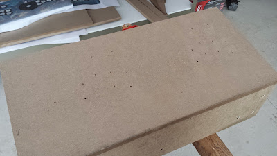

I started by cutting out the six sides of the control panel box, and attaching furring strips to keep them together.  I screwed and glued the strips on, screwing through the MDF and into the furring strips (since the wood of the furring strip will do a better job gripping the threads at the end of the screw than the MDF).
Then I glued & screwed all the pieces together.  The top is not attached, since it will be detachable on the finished product.  And the back panel isn't actually screwed on for now, because I need to be able to access the underside of the top panel to formulate some kind of latching system.
Control panel box.  Is strong like bull.

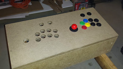

Next step is to prep the top panel for joysticks and buttons.  I printed a full size version of the control panel graphics, and clamped them to the top piece.
Then I center punched all of the holes.  I want these holes to be drilled as accurately as possible, so I'm taking my time.
With the holes center punched, I removed the graphic template, and used a small drillbit to drill pilot holes.

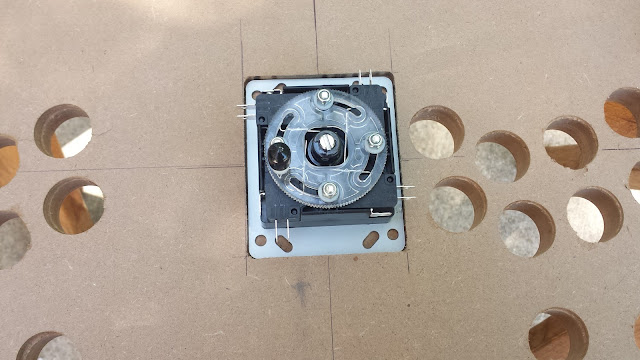

For the joystick attachment, I'll need to rout out part of the underside for the joystick mounting plate.  I marked this out now, since it'll be a lot easier to find the center of a tiny drilled hole than a 1-1/8" hole.
Now to drill the holes for the buttons and joysticks using a 1-1/8" forstner bit.  I started with one of the joystick holes, since any mistakes will be covered up by the joystick washer.  Good thing, because genius-me tried drilling the first hole with the drill in reverse, and the bit jumped out of the pilot hole.  So, I had to flip the board over and drill the hole correctly, starting from the back.  Like I mentioned, the error will be hidden by the joystick washer; but I'll still want to patch it up with wood filler so the control panel graphics attach smoothly to the surface.
After drilling a couple holes, I noticed that the bit was tearing chunks out of the underside as the bit came through the MDF.  So, I started drilling about 1/4 of the way through the bottom first, then flipping the board over and drilling through the top.  This seemed to go more smoothly.
After getting the holes drilled, I tossed in some buttons and a joystick to see how they fit.  Nice.
After getting most of the front panel pieces cut out, now I'm starting to make templates to rout out the access holes for the various components.  Here's my start on the speaker cutouts.  Measure twice / cut once is definitely a rule to live by for me, because I always screw up the measurements the first time (hence all the scribbled out lines).
« Last Edit: June 15, 2015, 09:51:36 am by RxBrad »

Nice work so far. I always put a scrap piece of wood underneath whenever using a forstner bit on MDF. Otherwise you'll get massive blowout. With a scrap piece under it, you'll be able to drill all the way through and into the 2nd piece for a really clean cut every time.
(Edit: THANKS!) I thought about that, but didn't have any big enough scraps handy, so I resorted to the bottom-drilling method.  This also had the added benefit of reducing the effect where, once you drill through the MDF, you accidentally slam the drill chuck into the top of the piece of wood (something that wouldn't be an issue if I had a drill press).

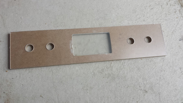

I cut myself a template to rout the inset for the joystick.
It actually worked.  Imagine that.  Unfortunately, the joysticks are just slightly off center as they come through the hole that's drilled.  Despite all the painstaking effort I put into making sure the cutout was centered on the pilot hole, my lack of a drill press meant that the pilot hole on the back was slightly skewed from the front.  I think I'm going to need to tweak the CP art a bit so this isn't quite so obvious.
Then I widened the cutout so I could rout the inset in the back of the admin panel where the screen will sit.
After routing the inset, I cut a piece of plexiglass to match the admin panel, slowly drilled pilot holes and then button holes through both the plexi and MDF at the same time, and then routed the edges of the plexi to match the MDF.  This turned out much better than expected.  Here's the admin panel with the plexi on top of it.
Using my cutting template to test out the art.  I think I need to widen the screen opening a bit on the left. (The white parts around the screen will be black on the actual art.  This was just my cutting template.)
Checking to make sure the screen fits in the final product.  It's all blurry because there are still 3 layers of protective decals in place between the plexi and the screen.

RxBrad
  • Posts: 188
  • Last login:May 31, 2023, 12:41:00 pm
  • I like burritos.
    • bit.ly/1GDVYUu
    • RxBrad.com
Thanks, mgb...
Unfortunately, the joysticks are just slightly off center as they come through the hole that's drilled.  ... I think I'm going to need to tweak the CP art a bit so this isn't quite so obvious.
Phew!  Dodged one bullet, at least.  I sampled my art from the cutting template on the finished control panel, and luckily the dust washer covers enough of that compass/directional pattern that it's not obvious that the joysticks are slightly off-center.  I was afraid that some of the inside corners would show up, and others would be hidden.  (And that green button really is centered on the art.  The paper just got a little loose under it when I was putting in the buttons.)

I got my CP/AP overlay from GameOnGrafix. I like how the print quality turned out. I'd darkened the image a little and added a subtle etched-on-brushed-metal look to it, and I think it came across pretty well.
There's a stripe where the adhesive backing didn't quite go on smoothly, which left a bump, but luckily not a crease in the art. So, I guess I need to be careful that no gunk gets in there before I apply the art.
Also, for something that's supposed to be polycarbonate coated, I guess I expected the material to be a little more rigid. I don't really have anything to compare it to, but the material seems more like I would've expected regular vinyl to feel. It's fairly soft and pliable. Since it came to me rolled up, I have some pieces of MDF holding it flat in hopes that it'll uncurl a little.

Attempt #2 on the monitor bezel.  I almost made it through without an error, but then my template slipped as I was rounding out the last corner.  Annoying, but easily manageable.
Getting closer and closer to where I can start assembling everything.  Woo.

Cut out a speaker grill that'll be wrapped in speaker cloth. Then clamped it to the speaker panel and drilled holes for where the grill attachment doohickies will go.
Also started attaching wood strips to the back of the monitor & speaker panels to keep all of the electronics fixed on place.  And started gluing and screwing batons to the pieces so I can start assembling everything.

I didn't really show how the 7" admin panel screen is secured in yesterday's photos.  I guess I'm easily impressed by my own over-engineering, so here are a couple more photos...
I used my router to create an inset (hard to see when everything is painted black), so the screen is closer to the front of the admin panel than the 1/2" MDF it's made of.  Also, I've decided that I love EZ-Loks, and plan on using them all day long.  They're used here to secure the screen retainer, I'll use them on the joysticks, the marquee retainer, the speaker & monitor retainer straps, and the main screen's glass retainer.  And pretty much anywhere else I can think of.  100 of them only cost $5, so I'll get my money's worth.
The PCB for the 7" screen is held in place by "L type PCB feet" that you can buy at Ultimarc / GGG.  I bought enough feet to secure 8 different PCBs for 8 bucks on FleaBay.
The 7" screen (with the protective film still in place)  is stuck to the other side of the 1/4" MDF retainer with velcro tape.  This way, when I remove the retainer, everything comes off in one easily-manageable piece.
Here's the admin panel with the bottom trim piece in place (which will get painted with the rest of the cab).  Here I'm giving it a quick test run.  I'm not terribly impressed by the viewing angles on this screen.  Hopefully it's okay at the angle I have it set up (and maybe it'll look a little better without the screen protector still on it).  EDIT 10/17/2016: Almost a year later....  I realized that by flipping the 7" display upside-down, it is now perfectly viewable.  Before, I had to stoop down to see it.  Took a bit of Dremeling to get it in there after-the-fact; but it's much better now.

Most of the screw holes are filled.  A few still in-progress.  Also, remembered that the reason I bought MH Ready Patch in the first place was that it's supposedly good for filling gaps between MDF boards (derp).  It acts a lot like bondo.  So, I'm working on filling those gaps, too.
Trimmed 1/4" off the bottom of the side panels for clearance.
Routed the T-molding channel.  If you look closely, you can see a few inches where the slot is a bit wider because the bit walked out of the router a little; and I had to re-route it centered.  I'm hopeful that the correctly-centered slot on either side will hold it adequately in place.
Started the marquee box, and attached a couple MDF panels on the back (not really visible in this pic).
Also, painted the bottom panel, so I could permanently attach the wheels and stand the cab back up.
Before I paint the rest of the cab, I need to:
* Finish attaching the back panels
* Add furring strips to support the front/rear access doors
* Finish building the lightbox for the marquee
* Develop the mounting system for the CP (I have magnets.  Lots of them. The same mounts will need to be duplicated on top of the cab, where I can swap out the flat KB/mouse panel.)
With any luck, I should be ready to paint after next weekend. Which is good, because Winter is Coming.

Very basic lightbox made from scrap wood I had lying around.  Couldn't really make it completely enclosed, since it's pretty tight on space, and it needs room for the buttons and whatnot when the control panel is mounted on the top.  Will be lit with LED tape (drilled a hole to make room for the power cable).  I was going to use a fluorescent bulb, but just didn't have enough room for it.

As I'm waiting for paint to dry, I was thinking...
8 buttons... :whap
I really have this laid out for Street Fighter IV PC with the Xbox360 controller button colors... Which might get about 2% of the playtime I put into it.
I think I might rearrange the colored buttons into the bottom row in NeoGeo layout. Then make the first 3 columns of buttons the arcade fighter buttons.

Making more progress...  Printed some temporary marquee art on paper and installed it.
CP art applied, T-molding attached, and controls installed...
I bought magnets with the intention of using them to keep the CP secure, but I honestly don't think I need them.  It sits perfectly in place with just a furring strip attached to the bottom to keep it from sliding off the front of the cab.
The control panel can also be moved to sit on top of the cab.
I cut a flat panel from a piece of 3/4" melamine-coated shelf.  This can be swapped with the CP to provide a surface for KB/mouse gaming.  It's only temporarily white.  It'll get vinyl art applied when I order the side art.

Sell me on using a flat surface for KB/Mouse vs just having a pull-out drawer? What are the pros?

The way I'm doing it, the KB/mouse are at optimal height and angle. Drawers are often placed awkwardly.

Will try to get a better photo when there's better lighting, and update the first post on this thread with it.
The marquee is lit with LED tape.  I also added a male/female plug to the external power switch, so I could more easily remove the PC from the cab.
My speakers have started humming in the last few days.  Still need to troubleshoot a bit, but I suspect that they don't like the marquee LED power supply being on the same power strip.  Not sure what I can do about that.
All I have left is to apply the vinyl & T-molding to the keyboard/mouse surface, and then attach a lip on the end of that same surface so nothing slides off the front of the cab and onto the floor.

Have you ever noticed how, once you finish a cab, you end up playing it for hours and forgetting to post the final photo?  Forgive the potato quality.  My phone really doesn't want to take a good photo of this down in my basement.
All done.  And I even got a stool to sit in front of it from my wife for my birthday.  Now if I could only convince her that this belongs upstairs, and not in the unfinished basement.
Marquee lit and unlit. You can see the flaws in the printing from Souldraw on the lit version (horizontal smudge on the right side).  On the unlit version (look on the left side), you can kind of see the bubbling between the printed layer and the glossy lamination layer.  Maybe I'll replace it.  Maybe not.:
And here's the flat panel I can swap in for keyboard/mouse gaming.  I thought I was going to need to add a lip on the front to keep stuff from sliding off, but the "matte" vinyl surface has just enough friction to keep that from being a problem.
« Last Edit: November 17, 2015, 07:49:04 am by RxBrad »

If I'd have bought a top-bearing bit in the first place, I could have avoided so many of the mishaps I've run into.  Trying to awkwardly position templates underneath your work where you cant see them; or trying to balance your work on scraps so it's level.  This all just leads to trouble.  :banghead:
Sure, this thing worked great for trimming the plexi to fit my admin panel, and it will probably work well to trim my CP/AP graphics to fit.  But aside from that, it can go eff itself.
Friends don't let friends try doing template work with bottom-bearing flush trim bits.
Grrr.
I use bottom bearing trim bit also, but I use it on my router table which mounts upside down making it a top bearing trim bit

Almost a year later....  I realized that by flipping the 7" display upside-down, it is now perfectly viewable.  Before, I had to stoop down to see it.  Took a bit of Dremeling to get it in there; but it's much better now.
So, just a reminder to everyone to check the viewing angles of their monitors.  They might look better mounted upside down.
