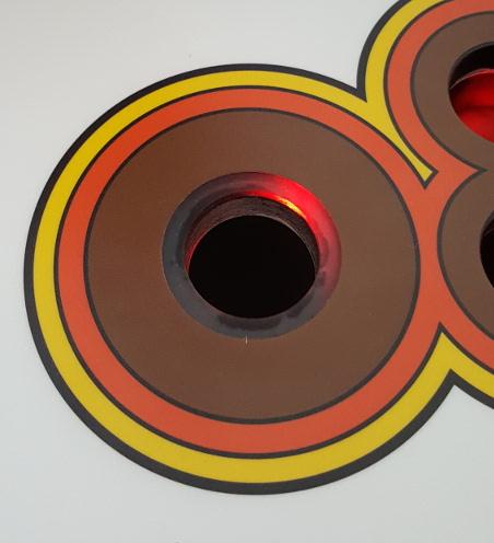

Ok so first proper update in ages...
I needed to get the spinners out since I forgot to paint underneath them... raw plywood colour is not nice as a backdrop for edge-lit plexi.  2 spinners needed to come out on the spinner panel.  Dremel to the rescue...
Finally got them both out, and sanded the panel flat(ish)...
Then painted the bit I forgot!
Then glued them back in, filled and sanded flat ready for painting...
I also had the same issue with the Defender joystick, where the gold/brassy colour of the joystick housing bled through the edge-lit plexi looking ugly.  So, out with the defender joystick too...
And painted it...
Put it back in, sanded and filled ready for painting again...
I have now got the defender panel painted up, and the CPO applied :)
I'll be re-painting the spinner panel next, and applying that artwork.  Then FINALLY all panels will be done, and ready for wiring.  I'll try and get that done in 2017!

Woo!  Finally got all 3 panels with CPO applied and ready for wiring.  Major milestone. :)
I assembled the rotating unit just to check everything still fits nicely, and it does!...
2/4 way panel
  • Defender joystick on the far left
  • Pac-Pro leaf-switch joystick in the centre
  • Electric ICE 2 concave buttons
  • All controls are LED-lit
  • Panel of choice for Defender, Asteroids, and all 2 and 4-way games
Driving/Spinner/U360 panel
  • TurboTwist 2 spinners
  • Ultrastick 360 in centre
  • Panel for 1p or 2p driving games, spinner games, U360 games (sinistar!) etc.
8-way panel
  • Dominux8 leaf-switch joys
  • U-Trak translucent trackball
  • Panel for all 8-way games, 2p joystick games, Robotron!, all trackball games (perhaps Amiga games too that use a mouse, ScummVM games, etc.)
It's been a long time getting here but at last now I can start planning the wiring. :)

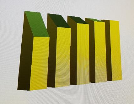

Plan B... make some clear acrylic "Light Rods" out of casting resin with tapered/angled tops that direct the light more appropriately. You can see the idea here...
First we 3D printed some formers to put in the moulds to make the light rods.  We printed a few at different angles to test which worked best.  Then we made some silicon moulds from them...
Then we poured some clear casting resin into the moulds (after coating them with mould release agent) and set the LEDs into them (4 diffused, 5 clear).

Here's how they turned out this morning.  Pointy LEDs... lets hope they work...
Jimbo
  • Posts: 1014
    • Wood Finishes Direct
Re: JIMBOVISION: Rotating CP [spinner led trauma]
« Reply #197 on: August 10, 2018, 08:49:55 am »

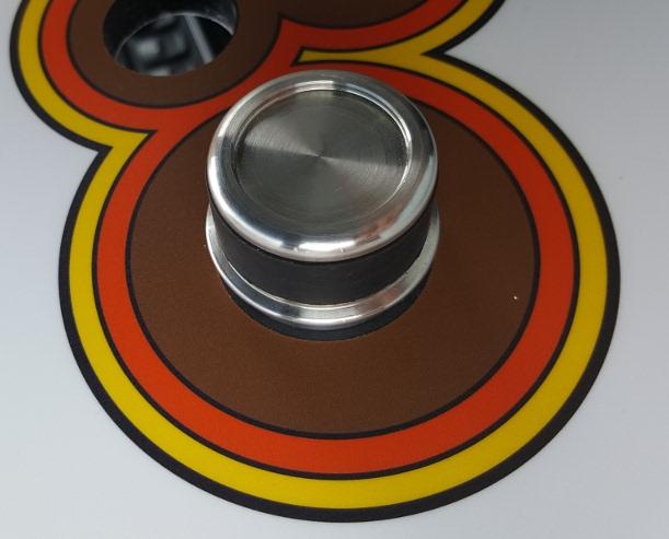

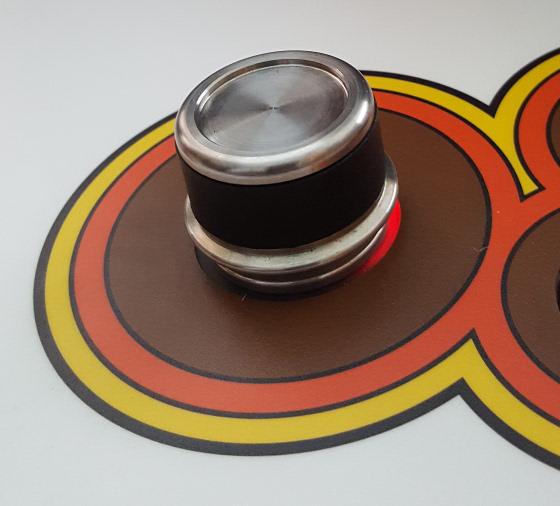

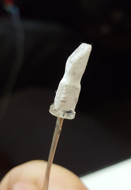

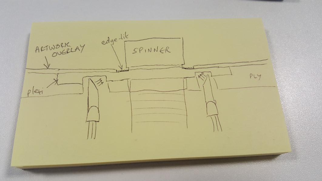

I think we've solved the issues with lighting up the spinners (and joysticks for that matter) :D
The lightpipes we made were from 3d printed formers, which we made a mould from and filled with casting acrylic - we tried 5 different steps of angle for the light to exit... 5, 15, 30, 45 and 60 degrees: -

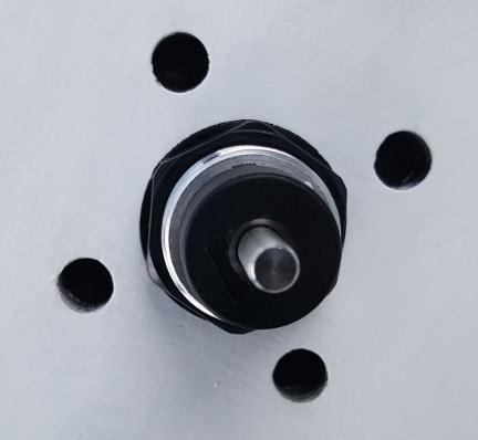

The top area I'm trying to get lit is a small ring around the spinner base...
Here's the underside so you can see where the LEDs go in (x 4):
And here's a crude cross-section drawing to help explain things: -
You can see the light needs to go up at a diagonal angle to get to the roughed up bit of plexi for good edge-lighting.  Previous attempts failed to direct the light properly and the plexi ended up very dim - even in a dark room.
So we tried each one but the 60 degree one was the best.  This has been covered in tipex apart from the angled bit on the top where the light escapes...
You can see even in daylight, with just 1 LED at low current, the light shines nicely when pointed with the 60 degree light-pipe :)
Aaand... with the spinner in...
FINALLY happy we can edge light these babies nicely :)

Drnick
  • Posts: 1642
  • Plodding Through Life
« Reply #198 on: August 10, 2018, 08:50:58 am »
I would say put some heatshrink tubing on them to help contain the light but it may be fiddly as balls, maybe a paint dip would probably be easier, just getting frog tape on the bit you want to keep clear would be fun.
 :)  And then whilst typing this I see you edited and have already tipexed :)
