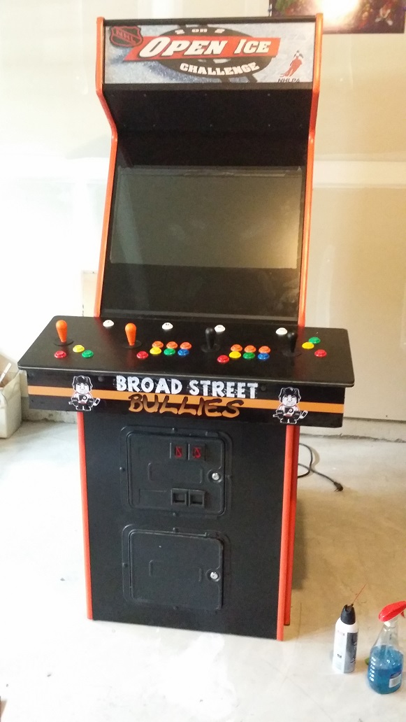

If I had to do it over again I would not have installed a Flight stick on my panel.  I only use it for Tron and Mad Planets.
Simpler is better.  Although I love my Frankenpanel, I only build simpler designs nowadays.
D
Wilimnot
  • Posts: 7
  • Last login:December 05, 2014, 12:51:56 am
IMO, if you're building it for fighting games, go with 8 buttons and arrange them like the x arcade sticks.
  • Posts: 4779
  • Last login:October 28, 2025, 11:06:27 am
As far as Ambidextrous buttons go, I originally designed my 4-way to have 2 buttons on either side.  Sounded great at the time, but to be honest, I NEVER use the buttons on the left.  I ended up converting them to mouse buttons instead.  Upon refection, I could have eliminated the ones on the left and used the buttons on the right as mouse buttons instead.  Then I could have simply re-mapped them in MAME for buttons 1 and 2.  Then they would have served 2 purposes.
D
so, here is my panel:
I saw your question about spinners and racing and everything, and it sounds like you're falling into the "one cab to do everything" routine. Don't design your panel around playing everything, design it around playing everything you like.
My design is based on NBA Jam/NFL Blitz/ NHL Open Ice, and in fact uses the CP box from an NBA Jam. I adjusted the vertical placement of the sticks to put them all on the same horizontal line.  This allows me to play 2 player smash TV , Total Carnage, and Karate Champ. While not great by todays standards, I have fond memories of those games, and making them playable was literally no sacrifice, so I adjusted my design to allow those games to be played.
