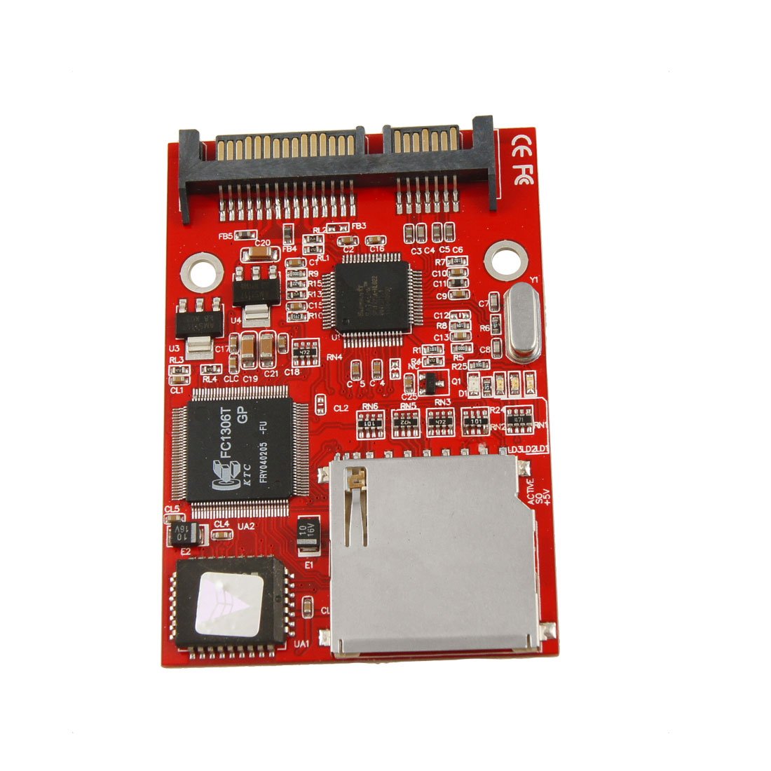

Quote from: specs from amazon
Description and Fearure:
100% brand new and high quality
Makes SD/MMC flash memory card be a super compact, cost efficient, anti-shock, low power consumption, no acoustic noise and fast access time HDD/SSD
Enables IT engineers and embedded technology enthusiasts to use SD/MMC card as a normal SATA HDD/SSD.
Provides an alternative for data storage and transfer or test for motherboard & sound/display/memory card, etc.
Ideal for some devices that required a fast and easy bootable device such as POS
Be a SD/MMC card reader/writer.
Compatible with SD Memory Card specification 1.1, MMC specification 2.0 & SDHC Memory Card specifications
Supports up to 32GB SD card capacity.
Supports up to 22MB/sec data transfer rate.
One 7+15 Pin SATA male connector and one standard SD slot.
bootable, install OS and application on SD card.
Compatible with DOS, Windows 98SE, Me, 2000, XP and Vista, Linux, MAC OS
easy installation and no driver required.
Board is fully assembled with 2 fixing holes.
Mini Board design and no space wasted.
Package contens:
1 x SD SDHC MMC to SATA Adapter Converter Card Supports Up To 32GB SD Card Capacity
I'm going to ponder this for awhile.

I don't have that new version, but I do have an older IDE to CF card adapter (only 4 GB CF card installed) for a Win98se/DOS based PC that I pieced together.  I wanted a silent solution to the noisy whirring of the old IDE 3GB spinning drive.  It worked out great for me.  Plug and play and it was reliable.
The updated version should not be that different.  However, I hear that the memory has a limited number of read/write life?  I don't think solid state hard drives have that same issue.  My solution was to simply buy and extra CF card and clone it, then put it safely away.
That said, I did notice that it was slightly slower than the IDE drive.  (It was running on an old Pentium II though).  But for me the silent use was worth it, since the performance difference was minimal.  You may see the same performance decrease on the newer adapter but YMMV.

Just because SD is a solid state technology does not make it anything like an SSD.  To compare the two is to compare floppy disks to hard drives.  The controller is the primary reason for the performance difference, but it goes further than that.  SSD's have extra capacity and functions in the controller to account for memory that fails, SD controllers don't because SD is not made to have dozens or hundreds of writes per day, it is made to store a file and that is about it.  This is one reason windows is so bad on a slow storage device - there are dozens of reads and writes every few seconds that have to be done to make Windows run.  If those are slow, the OS will be slow.
It was mentioned already and I would second it - SSD's have come WAY down in price in the last year, and the smaller ones are super cheap and literally 20 times faster (which will translate to an extreme performance gain, especially in any windows based OS).  Unless you were simply given the adapter and a high capacity SD card for free, there would be no reason to choose an SD over an SSD.
Just because the adapter is using the SATA bus doesn't mean it will run at SATA speeds.  Just like your CD Rom drive won't run faster just because it is on a SATA bus.  Expect faster performance from the SD adapter than you would get with a CD Rom, but slower than a regular mechanical HDD.
