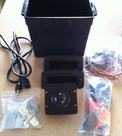

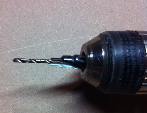

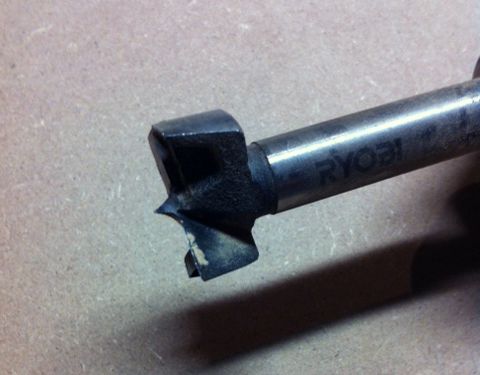

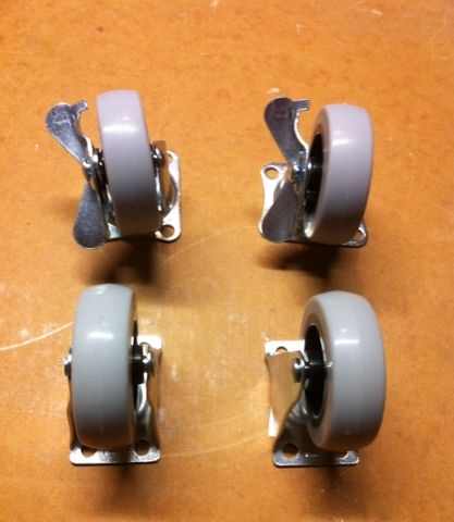

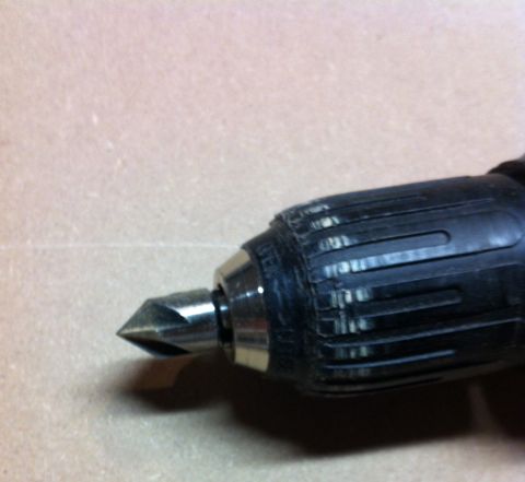

For this build I'll be using the Jakobud plans. In reading these forums I've come across comments that these plan dimensions are not 100% authentic, but I think they will be plenty close enough for me. I'll be using 3/4" MDF for the cabinet construction. Considered 5/8" to keep the weight down a bit, but none of the local big box home improvement centers carry that size, so 3/4" it is.
Made a run to Home Depot today to get some supplies for the cabinet construction. Forgot to swap cars with my wife before she left for work so I was not able to get the MDF panels (not going to fit in a Corolla!). Picked up some other materials which included:
titebond yellow glue
Drywall screws, 1-1/4" to attach poplar cleats to MDF
Spax screws, to attach MDF panels
wheel casters
poplar strips, 3/4" x 1.5" in random lengths to use as cleats
poplar boards 3/4" x 2.5" for base

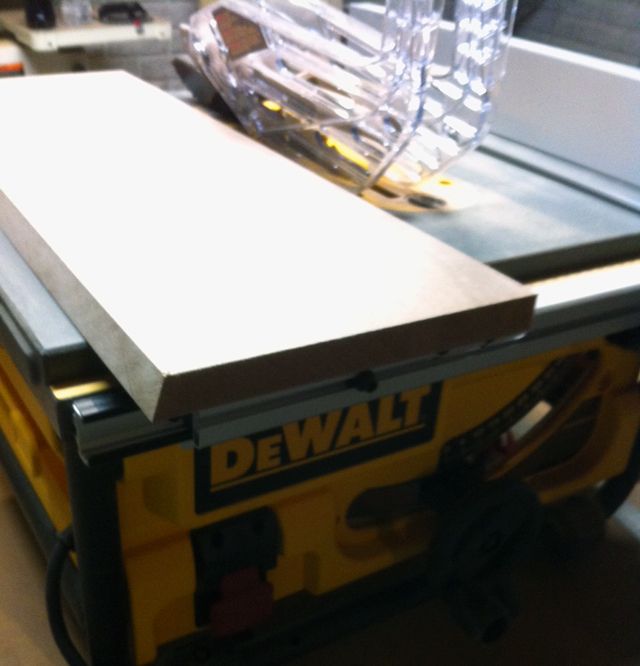

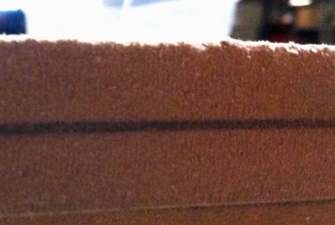

I did some research into MDF fasteners. In the past I've used drywall screws with pretty good results, but found something called SPAX at Home Depot. Supposedly designed specifically for MDF. It says no pre-drilling required, but I can't imagine how effective that will be having worked with MDF before. Will probably pre-drill anyway, but thought I would give the Spax screws a try.
Also picked up 4 wheeled casters. I know the original Donkey Kong cabinet did not have this, but being able to easily move the cabinet was a feature I wanted to add. There will be two swivel casters at the front and two locked casters in the back, so hopefully it will be easy to move around. The wheels will be inside the black base surround and protrude about 1", but when placed on carpet I think they will be hidden and the cabinet will look like it is resting on the base.
Spent ~$45, Total Cost to date: $45

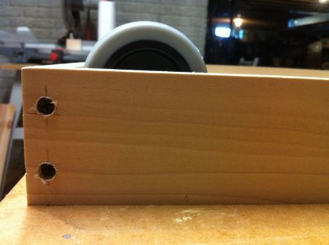

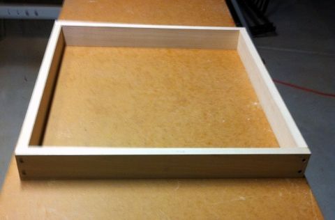

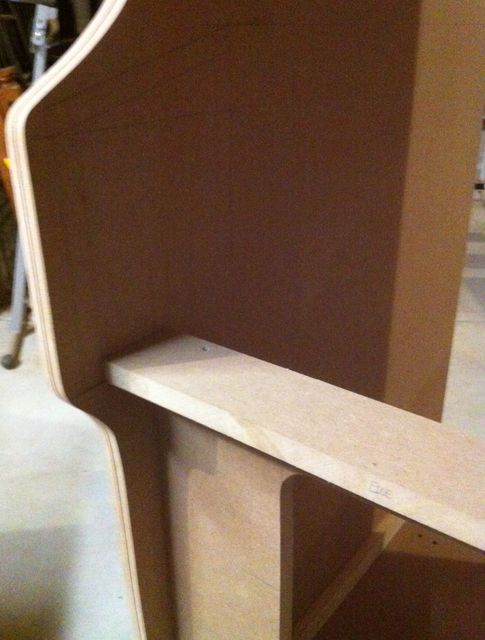

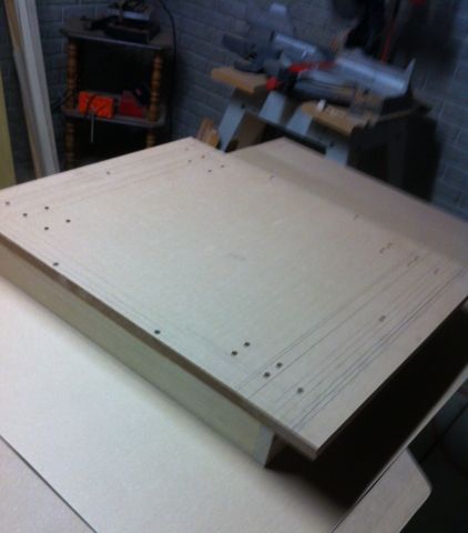

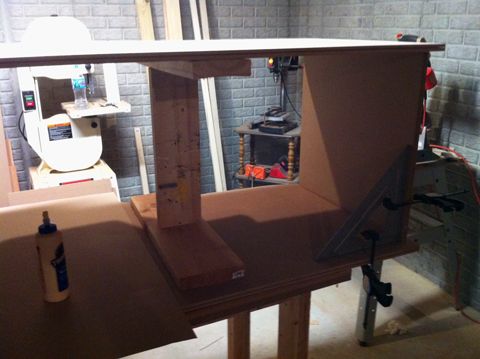

I had a bit of time before work, so why not get started building the base. The Jakobud plans call for 2-5/8" material, but Home Depot only had 2-1/2" poplar boards. Poplar is a good choice here - strong, cheap and paints well. The slight change in dimension was an easy choice compared to buying something wider and ripping to the "correct" width without a table saw. I considered making some nice 45-degree miter cuts for the base, but didn't feel I could get accurate enough angles with a chop saw or circular saw. Decided to go with a basic butt joint.
Simply cut boards to length with the chop saw, drill some pilot holes and fasten with some drywall screws and yellow glue. I countersunk the screw heads and will later cover with bondo and sand flush before priming and painting.
The wheels will extend around 1" above the base, but the carpet will hide some of the wheel and give the appearance that it is resting on the base (I hope).

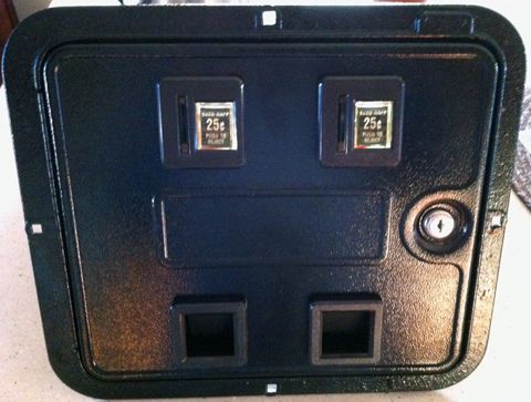

PS Start looking for a coin door now.  They are rare.

So I've noticed! Been keeping an eye out for one for a while but haven't found anything yet. Been going back and forth in my mind what to do about the coin door. Refurbish an original (assuming I'm able to find one) install a new one (which won't look 100% original but I don't think most would know the difference) or forgo the coin door completely in favor of some artwork. The graphic designer in me says go with some artwork where the coin door should be. Not sure what direction I'll end up going.

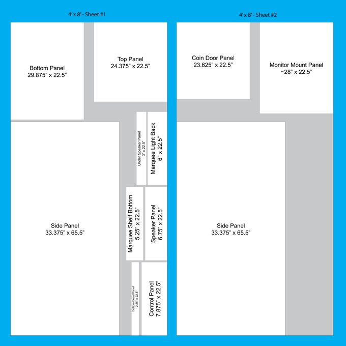

What's a benefit of working at a commercial printer? Access to large format printers. Made for easy work for creating a side panel template. Scaled jakobud plan to actual size and less than 5 minutes later, viola!
Otherwise a minor setback, my wife's Ford Explorer is in the shop and won't be able to pick up MDF panels today. Was hoping to have them for this weekend :-(

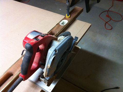

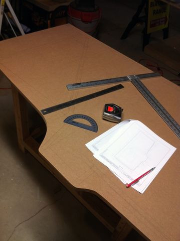

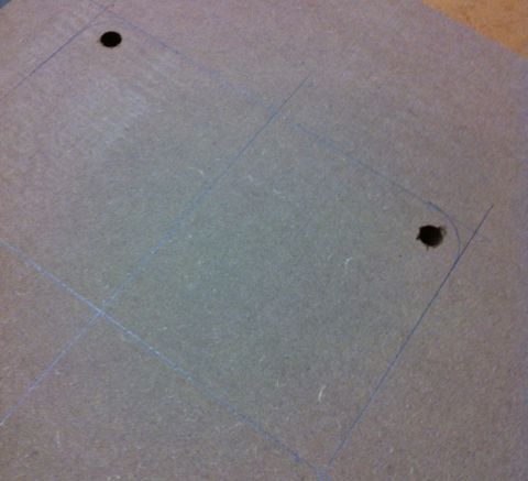

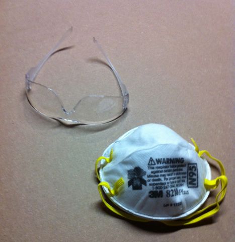

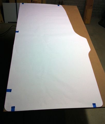

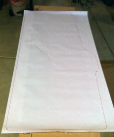

Now that I have the sheets of MDF, I started work on the cabinet today. First a public safety announcement. Cutting and sanding MDF will create a plume of fine dust that will cover everything within about a 15' radius once all the airborne particles settle out. It will cover everything. A garage or driveway (weather permitting) is an ideal place to work. If that's not an option, cover up the things you don't want cover in dust with plastic if possible. Most importantly, keep the MDF out of your lungs and eyes. A basic set of protective shop glasses and mask can be had for minimal cost, like under $10.
Working on the side panels first. Use the nice straight and square factory edge of the MDF sheet for the back and bottom of the side panel. Squared off the top of the piece to 66-1/2" using a circular saw and a straight edge clamped to the piece of MDF as a cutting guide.
Cut out the paper template and tape into position on the sheet, then trace with pencil.
If anyone is planning a Donkey Kong build and needs the template, let me know. I can fold it up and drop it in the mail to you. Hate to just toss it away, might be useful to somebody.

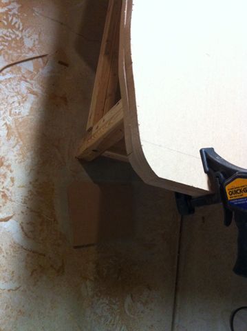

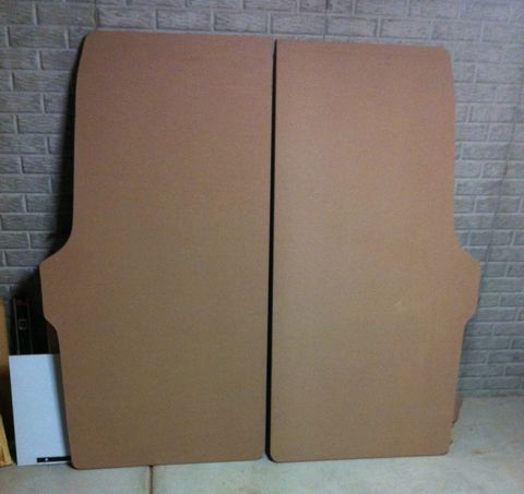

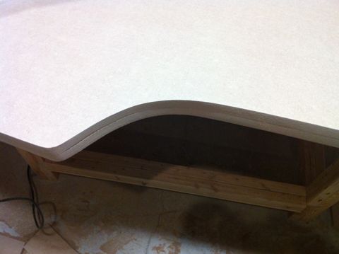

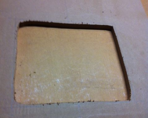

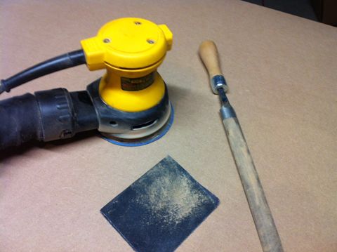

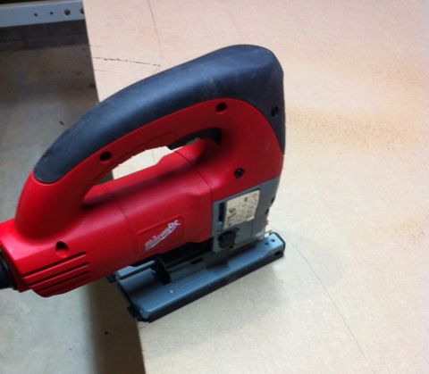

Time to start cutting. A jigsaw is the tool of choice to cut the curves in the front of the side panels. Used a "wood" blade on the jigsaw, make sure to make relief cuts so the scrap pieces fall away in smaller chucks rather than a single large piece that could break off.
Try to cut a bit just outside of the trace line. My jigsaw skills were a bit rusty, and the cuts weren't as good as I would have liked. The better you are at cutting the less sanding you have to do. After cutting out both sides, clamp them together for sanding. This will allow you to do both at one time and will provide a larger surface area that will make it easier to keep the edges square.

Time to clean up my amateurish cutting. Tools used for this step are an orbital sander (for straight sections) a wood file (to smoothen rough sections) and sandpaper (for curved sections).
Edge sanding MDF is pretty quick and easy, took only about 30 minutes to smoothen out my poor cuts. A quick tip, you never want to sand the faces of MDF and remove the "skin", just the side edges.
I felt like I accomplished something today, two completed side panels!

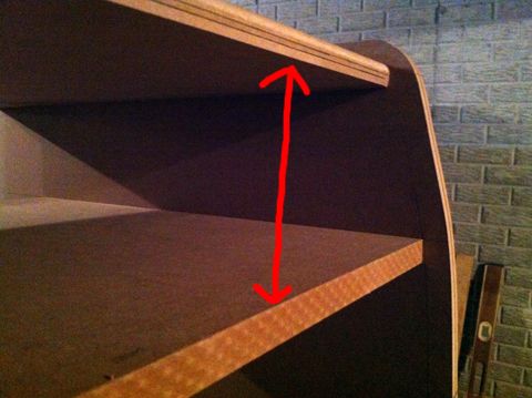

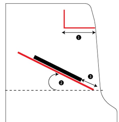

Getting ready to start the cabinet assembly. In looking over the Jackobud plans, there seems to be a few missing dimensions. Does anyone know what these might be?
1. For the marquee light box shelf, how deep is it?
2. What is the angle that monitor is mounted at?
3. How far back is the setback of the monitor?

« Reply #38 on: January 16, 2014, 06:52:30 am »
1. 22"
2. 40 degrees
3. The tube is 3 3/4" away from the bezel block and a tad higher. (see pic)

« Reply #41 on: January 16, 2014, 02:12:34 pm »
Spent some time transferring the layout from the Jackobud plans to the cabinet sides. As the old saying goes, "measure twice and cut once". A large drywall T-square was very handy - use the straight and square sides as a reference.
Made a full size mockup of the bezel and marquee last night at work. Just a cheap inkjet print attached to a piece of cardboard. Important that the cabinet fit these two pieces in their correct size.
Hope to start assembling the cabinet this weekend!

I have one more measurement question, #4 in the updated image below. The distance from the front of the marquee to the back where the light would mount.

« Reply #43 on: January 16, 2014, 06:11:53 pm »
4. 5 3/4"

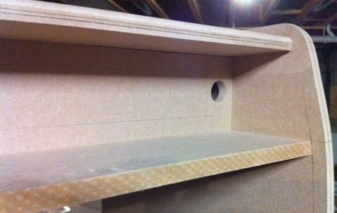

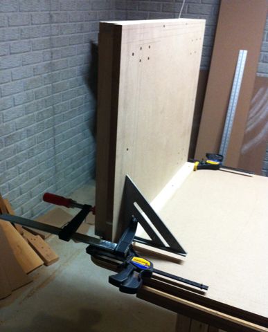

Got a bit of work done this weekend, but not as much as I would have liked :-(

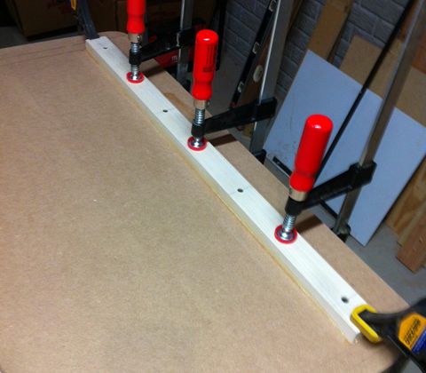

Cut bottom cabinet floor shelf to size and attached to base skirt. Drilled holes for wheels, to be attached later.
Cut top shelf to size and used round-over router bit to match profile of top marquee bracket.
Attached bottom shelf cleat to both cabinet sides.
When fastening MDF, used some yellow Titebond glue and screws. Drywall screws for MDF to poplar attachment. Pilot holes are recommended, a countersink drill bit will make a pilot hole for the screw and a recess hole for the screw head (later to be covered with bondo) in one simple step.
MDF has a tendency to tear-out on the underside of the hole, so a slight recess using a straight countersink bit will help eliminate that and make for a nice tight joint.
Time spent ~3:00, total time to date 6:30.

Clamping your cleats probably isn't necessary if you position them correctly.  The screws will act as clamps and hold your cleats in place.  Also check out these countersink bits from Dewalt.  They are a lifesaver and you don't need to keep switching between drill bit and countersink bit.  A tad expensive but I've had mine for over a year and they are well worth their weight in gold.  Keep at it everything looks nice and clean.
AND QUIT COUNTING YOUR HOURS!!!    :lol

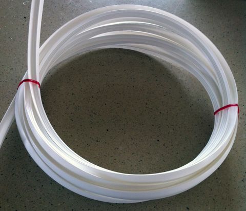

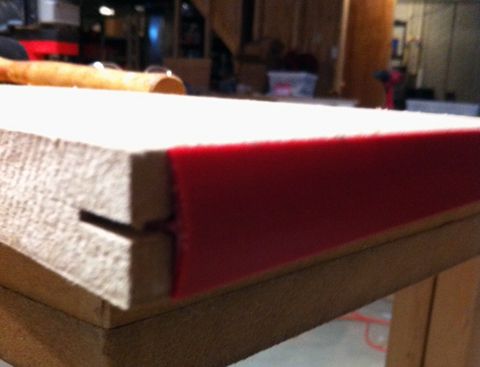

On Monday the T-molding arrived. On a Donkey Kong cabinet, the cabinet side edges and the front edge of the control panel gets the white colored t-molding. I ended up ordering from t-molding.com. It is sold in 20' coils, purchased 3/4" to match the width of the MDF I am using to build the cabinet. Was not able to find a definitive answer on if 20' was enough the complete a cabinet (it seems it is), but given the relatively cheap cost (compared to the cost of shipping), I went ahead and ordered 2 coils (40') to be safe. I can always use any leftovers on a future project.
It wasn't until after I placed my order that I learned that the original DK cabinet had a flat profile t-molding compared to the rounded profile I ordered. Turns out this is no big deal at all for me, as I plan to make a few modifications to my cabinet anyway, but for those of you looking to be as authentic as possible, take note. It turns out that t-molding.com has the flat profile also. Note it is 9/16", I am assuming this is the material thickness of an original DK cabinet?
Cost for 40' t-molding+shipping ~$30, total spent to date: $145
« Last Edit: January 22, 2014, 01:37:25 pm by PixelPaul »

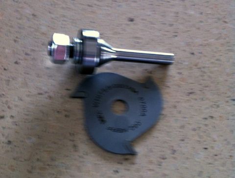

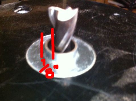

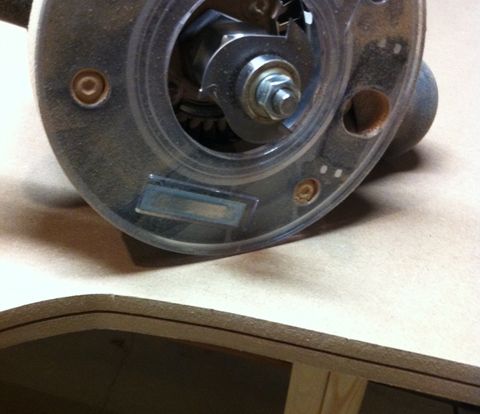

The t-molding gets installed in a grove that is made with a router using a slot-cutter bit. One of the reasons I ordered from t-molding.com is that they also sold Whiteside router bits. As a hobbyist woodworker I have learned over the years that Whiteside router bits are as good as it gets. Always buy the best tools you can afford and you won't be sorry.
A slot-cutter router bit is usually sold as two parts: the shank and the cutter head. The cutter can be swapped out for different sizes while using the same shank. T-molding.com made it easy to select the correct sized cutter based on the size of the t-molding you were using.
The shank and cutter head ship in different packages, so you will have to assemble. There are two washers, a bearing and a nut on the shank. Assemble as shown in the picture. You don't need to fret about having the top nut being super tight. Tighten best you can with a wrench and the nut will self tighten itself when the router is started, it will not come flying off.
Very important note about installing the cutter head on the shank. Look at the photo above and note the direction of the carbide cutters. It is a common mistake to install the cutter head on backwards. You will know you have if when trying to router the slot you smell burning or need a lot of force to push the bit through the wood. When installed correctly, the slot cutter should cut like a hot knife through butter.

Cutting the slot is actually a very simple process. You will however want to practice on a scrap piece of wood first. Since I am using 3/4" MDF for the cabinet, we want the slot cut exactly in the center, so 3/8" for my application. Draw a center line at 3/8" on a scrap piece of wood.
Adjust the router bit height on the router so it aligns with the center-line and make a test cut. A nice touch from the folks at t-molding.com, they included a half dozen scrap pieces of molding to "test" with on the practice cut. T-molding gets tapped into the slot with a rubber mallet and is perfectly centered. Ready to route the actual cabinet.
Next just clamp the cabinet sides on a flat surface and follow around the edges with the router. The bearing on the router bit shank will guide you along the cabinet edge as the cutter creates the slot to the correct depth. A simple and quick process. T-molding won't get installed until the very end, but the slots is done.
Duh! Just realized I forgot to the do the front edge of the control panel (don't even have it cut yet). Save some time and trouble and do the control panel piece at the same time as the sides while the router is setup. Oh, and by popular demand I have stopped tracking my time   :)

Great work so far! Your top marquee piece of wood routing is unnecessary, neat, but the originals don't have that, it may cause an issue with the top marquee metal mounting flush , maybe not :)
Paul - The preceding picture shows how the original DK cabs were built regarding the marquee.  I don't think you should have a problem if you test fit everything.  The top marquee retainer should hang low enough to catch and hold your marquee glass.  Words of wisdom on test fitting also.  If something doesn't fit don't force it.  Or you could break the male end of your usb port off of your encoder like I did last night.   :banghead:  Oh well.  Back to painting for a week.   :D
I also sent you a pm about a certain part you may need in the foreseeable future.
Thanks for the photo. I have the marquee and bezel clips on order and waiting their arrival. Not going to start cabinet assembly until I can confirm it will all fit together correctly.

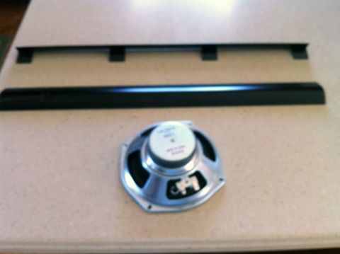

Another package arrived today, this time from twistedquarter.com. Contents:
Coin bucket (I think an original DK cabinet had a wooden box?), power cord, 4-way joystick, handles for back of cabinet, CP buttons, wiring kit and clips for control panel.
Also ordered a coin door with mechanicals. I know, all you DK purists will call "foul", this is not the coin door from an original cabinet. Seems like those are getting harder and harder to find. I thought about getting a new coin door that has the elongated shape more like the original, but in the end I decided to go with this one so I would have some room underneath it for some artwork.
Total spent on this order: $153, total spent to date: $298

Received another order late last week (it was like Christmas all week!), this time from Mikes Arcade. Ordered the top marquee bracket, bottom marquee/bezel bracket and speaker.
Cost of this order ~$70, total spent to date $368.

« Reply #63 on: January 27, 2014, 06:11:16 pm »
Finally started the cabinet assembly this weekend. Wasn't sure what was the best way to assemble...on the floor or standing up? Decided on top of the workbench, nice and flat and a good working height. Assembly is pretty basic stuff - drill some pilot holes, a little yellow glue, screw and clamp.
Clamped base with rafter square, trying to keep things nice and square.
Same process with cabinet top.
An extra hand would have been useful, but the wife was not home and I didn't want to waste a work day. Used some scrap 2x6 pieces to make a "I" support to hold the other cabinet side while I positioned, drilled and squared things up.

Looking good.  It is always exciting to see the main carcass go together.   :cheers:
I don't blame you on the coin door.  I just overpaid for one for my Fix-it-Felix build.  Not sure if that was smart or not but like you said they are getting hard to find.
Let us know how you like that joystick from Twisted Quarter.

Thought I would continue the construction by working from the top-down. I figured most important was to get the marquee and bezel to fit correctly, and if I had to fudge some dimensions later on, no big deal. Hit my first snag in the build thus far, not sure if this is an error in the Jackobud plans or something I'm figuring wrong. I was going to install what I call the marquee shelf, which according to my plans says should be 5.2" down from the cabinet top. Did a dry fit with it in that position, but then it seems the gap is to big for the marquee. The bracket that holds the bottom of the marquee and the top of the bezel should mount from the bottom of the shelf, correct? I don't have the actual marquee yet, but made a mockup based on the dimensions show at Mikes Arcade as 22-3/8" x 5-7/8". Can somebody confirm what the measurement should be from the underside of the cabinet top, to the top surface of the marquee shelf.
jdbailey1206
  • Posts: 2656
Re: Donkey Kong scratch build, my first cabinet!
« Reply #66 on: January 28, 2014, 09:22:58 am »
If the marquee is 5 7/8 then I wouldn't let the space between my the bottom of my top piece of mdf and the top of my bottom piece exceed that amount.  I posted a picture of how it should sit.  I will bet you money too if you look at any picture of the marquee that space between the bottom of Nintendo icon and bottom of the actual marquee should be equal to the top space of your bottom marquee holder if that makes sense.
Sorry for my ghetto picture too.  Me art good.   :)

...this is not the coin door from an original cabinet. Seems like those are getting harder and harder to find. ...
Here's one: http://www.ebay.com/itm/Nintendo-Coin-Door-/331114555471 and there are now some really good reproductions.
And these mechs are almost like the real ones, but really cheap, im sure you can find them in the US as well

The bottom part of the marquee box looks to thick. When the bottom bracket is installed the tip of the marquee bracket is level to the box so that it doesn't cast a shadow when lit. You may need to notch out the bottom of the marquee box so that the 4 mounting tabs for that bracket allow it to be at the right height to avoid that shadow.
The measurement you were asking about 2 posts up is 5 1/8".
In the last week or so I've seen 4 original Nintendo coin doors for sale on klov all for around 50 bucks. They are still out there.
good day.

Confident enough now that I have the marquee shelf in the correct position, let's continue. Working on the marquee shelf and back piece. Drilled a hole with a forstner bit, which gives a nicer hole when compared to a spade bit.
Make the hole just big enough for the fluorescent light plug to fit through. Attached the shelf and back with some yellow glue and screws.

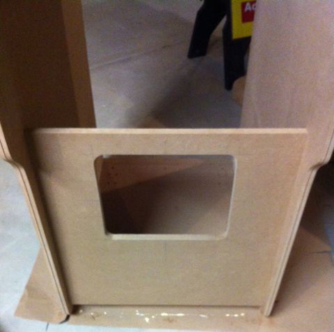

Next on to the the coin door panel, essentially need to cut out where the coin door will fit. There are a number of ways to accomplish this, the easiest would be just to cut the hole with a jigsaw. The opening doesn't need to be perfect, as there is a ~3/4" "lip" around the coin door that would mask some sloppy cutting. But this is where my OCD kicks in, I need to do better even though no one would ever see it.
Trace the size opening needed onto the wood, and drill a hole in each corner to start the jigsaw.
Cut out the opening with the jigsaw to within about 1/8" inside the line. No style points here, I'll clean it up with the router.
I made a template out of some heavy duty cardboard, oversized 1/8" larger than the final hole size. Center template over opening and tape into position.
Installed a bushing on the plunge router with a 1/2" spiral bit. The outside edge of the metal bushing collar will trace around the template edge while the router bit cleans up the wood edge. Made three passes, lowering the bit 1/4" each time.

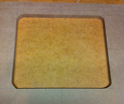

A nice smooth opening when completed, coin door fits perfectly. No additional filing or sanding needed!
Drill some pilot holes, some screws and yellow glue and the coin door panel is in position. Took a bit longer than it needed to, but my OCD has been satisfied.
« Last Edit: February 05, 2014, 02:25:18 pm by PixelPaul »

On with the build....I was strolling through the Home Depot tool aisle a few weeks ago and saw a Dewalt benchtop saw on clearance, marked down from $369 to $229. Used some HD gift cards I had accumulated over time, and left the store with the new saw for only $80 out of pocket. I'm sure it has its limitations compared to a full size cabinet saw, but for the price it sure beats using a circular saw and straight-edge like I have been. It made easy work in cutting smaller pieces like the underside of the speaker panel.
Rippped to length on the new saw, glue and screw into place.

Next, on to the piece that holds the bottom of the bezel and contacts the control panel. Needed some material that is thicker than 3/4" stock for this piece. Thought about laminating two pieces of MDF, but the edge surface would not be very smooth for painting. Could have used a 2x4 or 2x6 but might be susceptible to twisting or warping. Had some extra 1x6 poplar laying around so I decided to use that.
Cut two pieces to rough length and laminate with lots of yellow glue and clamps.
Allowed 24 hours for glue to dry, then ripped both sides on the table saw for a nice smooth edge and crosscut to length. Now on to the router table to cut the dado for the bezel. Used a 1/4" spiral router bit, made multiple passes until it reached a depth of 1/4". The groove needs to be 5/16", so had to offset the fence a bit and take an extra pass to get the required width.
Decided to cut a slot for the control panel, which contacts this piece. This is not really necessary, but I thought that it would look better if the CP slides into a recess for a nice clean fit. Back to the router table, this time using a 3/4" mortising bit. The fence on my router table would not slide back far enough to accommodate the position I needed, so I just clamped a straight-edged board to use as a fence.
Decided to knock off a bit of the front edge, so used the router with a 45 degree chamfer bit. An original DK cabinet does not have this, but thought it would look better.
Position the piece in the cabinet, and attach with some dry wall screws through the side panels.

The control panel held in place by some latches on the underside. These latches will attach at the sides. Wanted to make a surface with better holding strength that the MDF side panels, so once again used some scrap 1x6 poplar. Cut an angle on the chop saw to match the slope of the control panel and attached to cabinet sides with some yellow glue and drywall screws. Also added an additional piece below the CP slot to provide some additional contact area for some extra support. Ripped a bevel to to once again match the angle of the CP and attached with drywall screws and yellow glue.
Next cut the piece of MDF for the control panel. Need to cut a bevel on the edge that slides into the groove, did that on the table saw. Also need to cut a slot for the T-molding on the opposite side. Should have done this when I routed the T-slots on the cabinet sides, but forgot about this piece.
