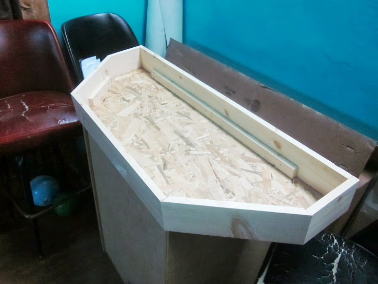

here are my boys helping to glue the sides of the control panel box together.
here is the control panel box sitting on the pedestal base
another shot of the control panel box.  I have since drilled a 2 in hole in the bottom for the wires to run through and screwed the box to the pedestal. i also put some wood filler in the cracks where the boards join together to fill in the tiny gaps.  i didn't take a picture of it since then though...
i still have a lot to do, but it is nice to at least make a little progress....next up, cut the top of the control panel and start drilling holes

it took longer than i anticipated, but i got the control panel overlay cut and installed tonight.
first of all, i installed the hinge for the control panel..
 i also installed a chain to keep it from opening too far
i laid out the overlay
cut out the holes with a razor knife
installed the plexiglass, buttons, joysticks
installed t molding around panel
tomorrow night i need to put another coat of paint on the bottom of the cabinet, then then install the tmolding on the rest of the cabinet.
i am so very happy with how this is turning out.
