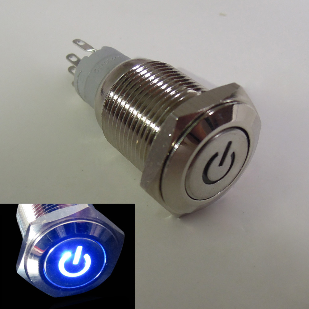

how but this one for power (planing to use smart power strip) and set this button  to turn on all the system......... :timebomb:
I want one of those, badly.  I had the hardest time finding them with the power image on them, I was only able to find them with the ring and a solid metal button.

« Reply #21 on: August 15, 2013, 01:58:37 pm »
   http://www.ebay.com/itm/16mm-12V-BLUE-Led-Lighted-Push-Button-Metal-Momentary-Switch-for-Car-Boats-DIY-/271107000518?pt=LH_DefaultDomain_0&hash=item3f1f3c88c6
