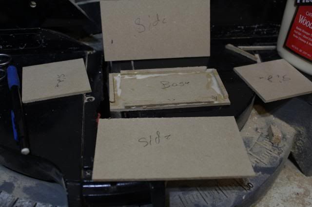

One of the main reasons I wanted to get root level access was so I can save the Mame4Droid files and the roms on the phones memory so I don't waste one of my SD Cards for such little space. There will be probably 10 - 20 games on it I think.

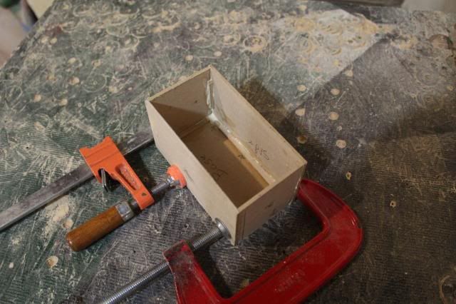

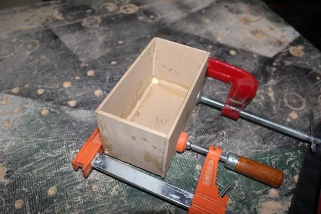

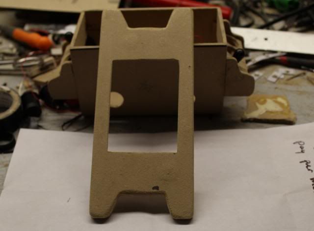

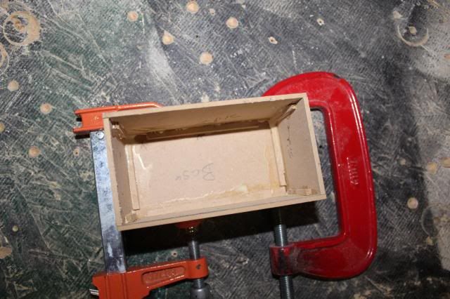

Build pictures
The top panel of the cabinet will be roughly 6 inches in length. And the base about 5 1\2 inches.
The top will also be two pieces of the thin MDF I got
Base cabinet pictures - the little pieces to the right are the supports

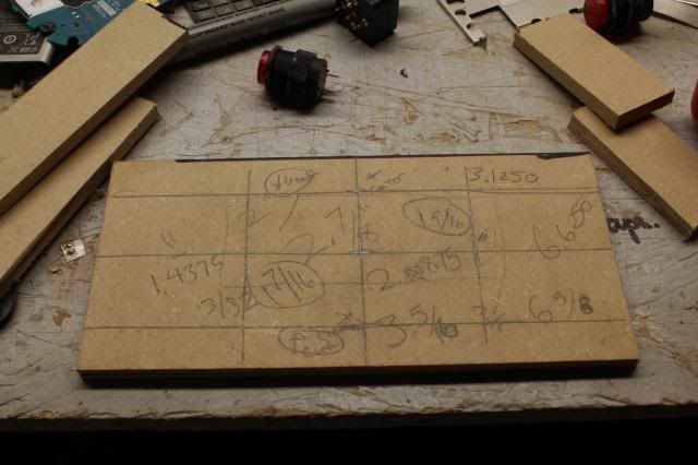

Assemble
Figuring out the dimensions for the top panel - It is a pain to do the math for such small measurements
Using the same technique I used on my full size cocktail build to cut the screen section out
The flush trim bit on the router is obviously too big for the job so I improvised and used my new dremel to follow the guides. Adjusted it so it sits just on the empty part of the bit.
Voilla!
Cleaned up the edges with the jigsaw's smallest blade and did some more measurements

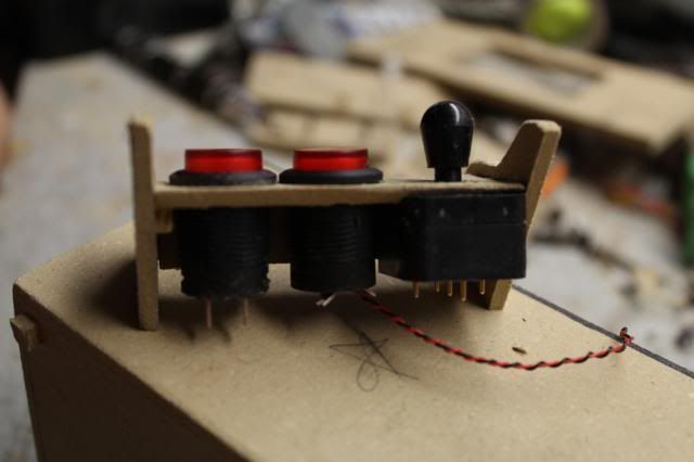

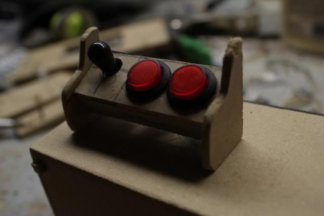

Itsy bitsy teeny weenie control panel thingy
Everything will get a good sanding with a high grit before paint is applied
Holes drilled
Fits snuggly
Since I am under-mounting the joysticks I need to "route" out some space so it is more flush - This was accomplished with an exacto-knife
After tracing all CP parts for player two it is time for assembly
Voilla!
Here you an see where one of the buttons had been converted to LED via SMD parts (more on this, and pictures,  later)

Not sure why you aligned the joystick with the top of the buttons instead of the bottom.   :dunno
Won't the vertical side block a 2-finger-grip on the stick?
Re: Petite LED Cocktail
« Reply #27 on: June 08, 2013, 11:37:47 am »
I'm betting it's going to be a thumb on top of the stick "grip".
« Reply #28 on: June 08, 2013, 12:28:29 pm »
I'm guessing that bottom alignment would put the body of the base of the stick pocking out a mm or more past the face of the CP and raising the buttons would not be a good solution either.  Increasing the size of the whole attachment would solve the problem but create others in terms of scale.
  • Posts: 9752
  • Last login:Today at 06:04:22 pm
« Reply #29 on: June 08, 2013, 01:21:29 pm »
You nailed it -- checked one with the micrometer and it's closer to the front edge than I originally thought.

Player two's CP assembled
Top piece cut in a similar fashion as the full size
Routed out space for the screen to sit flush (used the full sized router for this, very....very carefully)

Quick picture of things put together, paint is drying now. Soon will mount the screen and electronics will be soldered up.
Anyone got any good ideas on how I should secure the acrylic to the top??
